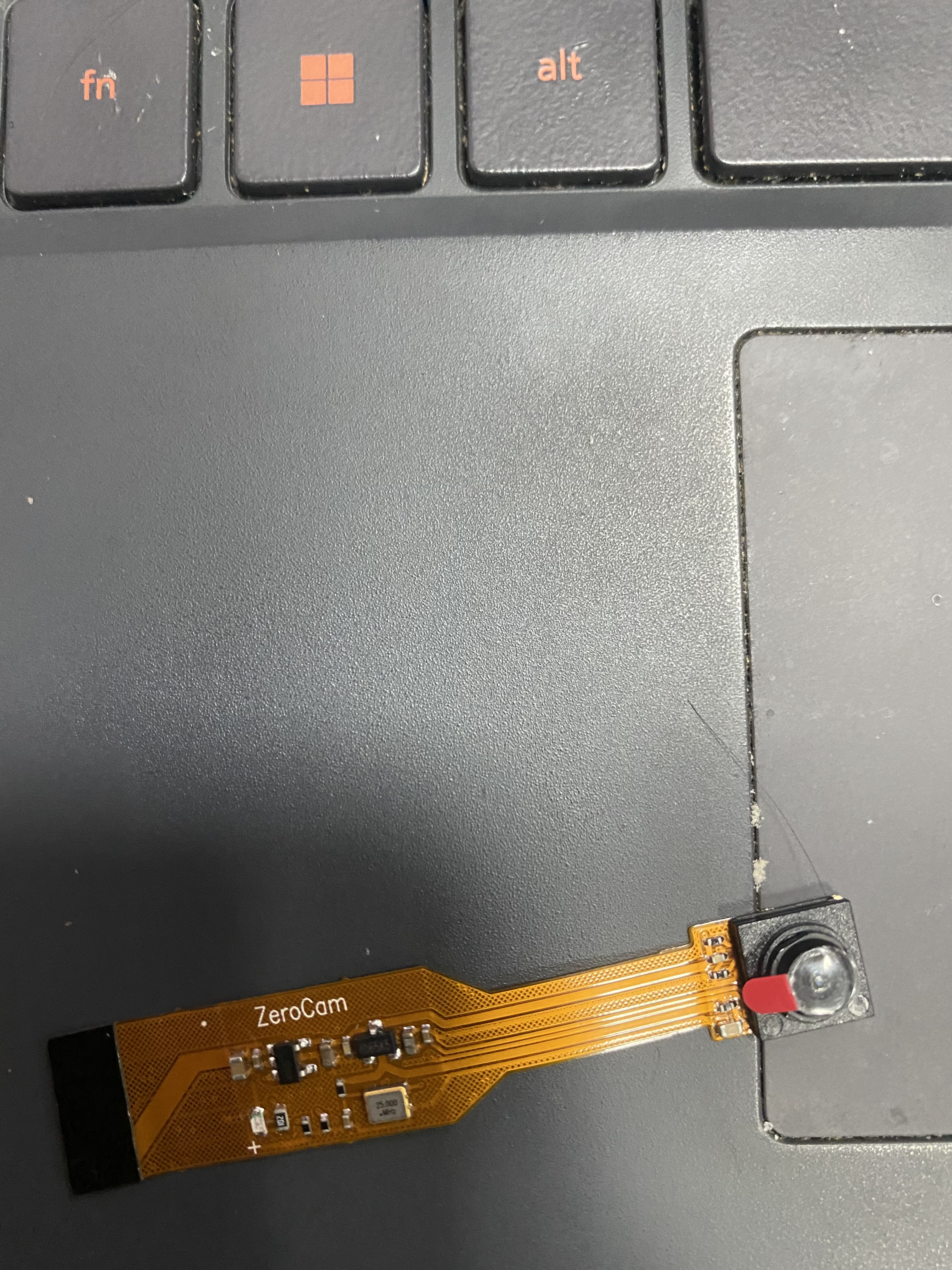

请问为什么在22排线上插ov5647的摄像头就无法启动,是还要自己适配摄像头吗

ov5647摄像头软硬件版本信息CanMV-K230_sdcard_v1.8_nncase_v2.9.0.img.gz
COM21:
OpenSBI v0.9
vicap_mcm_initRT-SMART Hello RISC-V.
msh />press 'q' to exit application!!
mirror mirror is 0 , sensor tpye is 52
[tuning] dev: 0
acq_win.width: 1920
acq_win.height: 1080
pipe_ctrl: 4294967289
sensor_fd: 11
sensor_name: gc2093
buffer_num: 0
buffer_size: 0
[tuning] chn: 0
out_win.width: 800
out_win.height: 480
bit_width: 0
pix_format: 5
buffer_num: 10
buffer_size: 576512
yraw_size: 0
uv_size: 0
v_size: 0
block_type: 1
wait_time: 500
chn_enable: 1
VsiCamDeviceCreate hw:0-vt:0 created!
gc2093_sensor_power_on, iic read chip id err
kd_mpi_sensor_power_set, error(-1)
sensor_reg_list_write err, [0x03fe] = [0xf0]
kd_mpi_sensor_init, error(1)
kd_mpi_isp_sensor_init, sensor open failed(1)
kd_mpi_isp_sensor_set_test_pattern failed(12)!
kd_mpi_isp_connect, vsi connect failed(13)!
kd_mpi_isp_init, isp connect failed.
kd_mpi_vicap_init, isp init failed.
sample_vicap, kd_mpi_vicap_init failed.
<3>[4] [Func]:vb_is_blk_valid [Line]:1133 [Info]:id 0, phys_addr = 0, pool_phys_addr = 100ec000, pool_size = 2882560
phys 0x180000, size 0x79000
你好,这个需要检查摄像头模组的电压与板子是否匹配,以及线序是否匹配
