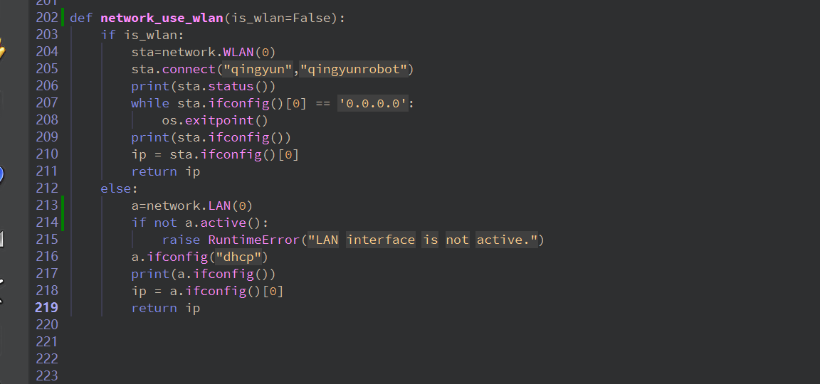

在K230开发版,插入一个USB转网口的转换器,通过网线与交换机连接,尝试连接网络失败
01科技K230 windows 烧镜像 mispython环境 IDE 4.0.7
File "", line 636, in
File "", line 215, in network_use_wlan
RuntimeError: LAN interface is not active.
MPY: soft reboot
交换机有四个口
尝试指定LAN口 a=network.LAN(0) a=network.LAN(1) a=network.LAN(2)
def network_use_wlan(is_wlan=False):
if is_wlan:
sta=network.WLAN(0)
sta.connect("qingyun","qingyunrobot")
print(sta.status())
print(sta.ifconfig())
ip = sta.ifconfig()[0]
return ip
a=network.LAN()
if not a.active():
a.ifconfig("dhcp")
print(a.ifconfig())
ip = a.ifconfig()[0]
return ip
