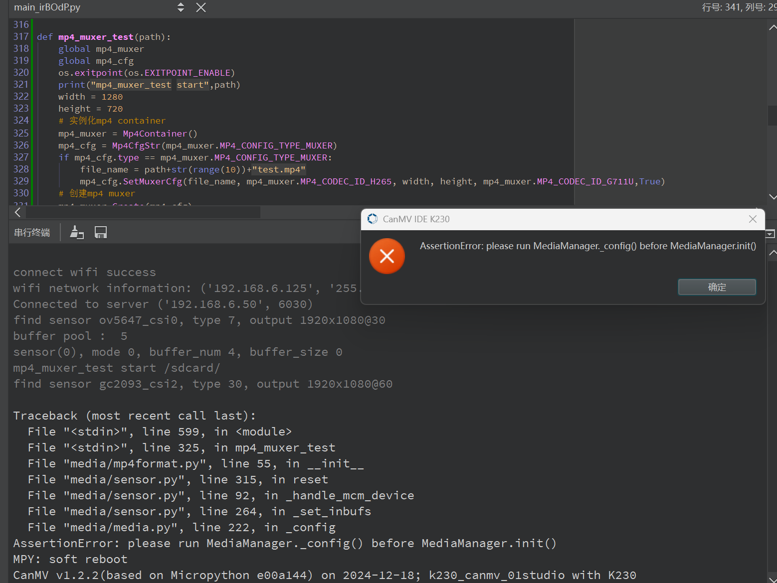

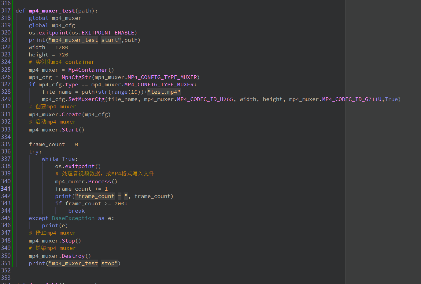

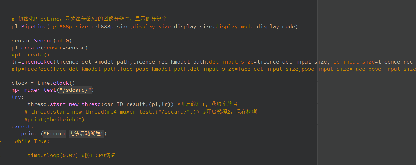

由于目前MP4保存视频默认打开sensor2 摄像头,且无开放接口,因此我用了两个摄像头,sensor0检测,sensor2保存视频, 将demo作为一个方法去执行的时候,出错
K230 01科技 mispython
connect wifi success
wifi network information: ('192.168.6.125', '255.255.255.0', '192.168.6.1', '192.168.6.1')
Connected to server ('192.168.6.50', 6030)
find sensor ov5647_csi0, type 7, output 1920x1080@30
buffer pool : 5
mp4_muxer_test start /sdcard/
find sensor gc2093_csi2, type 30, output 1920x1080@60
File "", line 599, in
File "", line 325, in mp4_muxer_test
File "media/mp4format.py", line 55, in init
File "media/sensor.py", line 315, in reset
File "media/sensor.py", line 92, in _handle_mcm_device
File "media/sensor.py", line 264, in _set_inbufs
File "media/media.py", line 222, in _config
AssertionError: please run MediaManager._config() before MediaManager.init()
MPY: soft reboot

单独运行这个存视频的demo是正常的, 我感觉是虽然是两个摄像头,可能也共用了某些东西,

def mp4_muxer_test():
    print("mp4_muxer_test start")
    width = 1280
    height = 720
    # 实例化mp4 container
    mp4_muxer = Mp4Container()
    mp4_cfg = Mp4CfgStr(mp4_muxer.MP4_CONFIG_TYPE_MUXER)
    if mp4_cfg.type == mp4_muxer.MP4_CONFIG_TYPE_MUXER:
        file_name = "/sdcard/test.mp4"
        mp4_cfg.SetMuxerCfg(file_name, mp4_muxer.MP4_CODEC_ID_H265, width, height, mp4_muxer.MP4_CODEC_ID_G711U,True)
    # 创建mp4 muxer
    mp4_muxer.Create(mp4_cfg)
    # 启动mp4 muxer
    mp4_muxer.Start()
    frame_count = 0
            # 处理音视频数据,按MP4格式写入文件
            mp4_muxer.Process()
            frame_count += 1
            print("frame_count = ", frame_count)
            if frame_count >= 200:
                break
    except BaseException as e:
        print(e)
    # 停止mp4 muxer
    mp4_muxer.Stop()
    # 销毁mp4 muxer
    mp4_muxer.Destroy()
    print("mp4_muxer_test stop")
