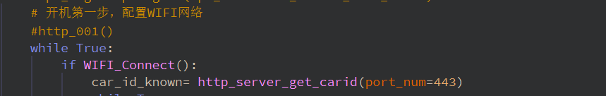

http 通讯 问题
Viewed 248

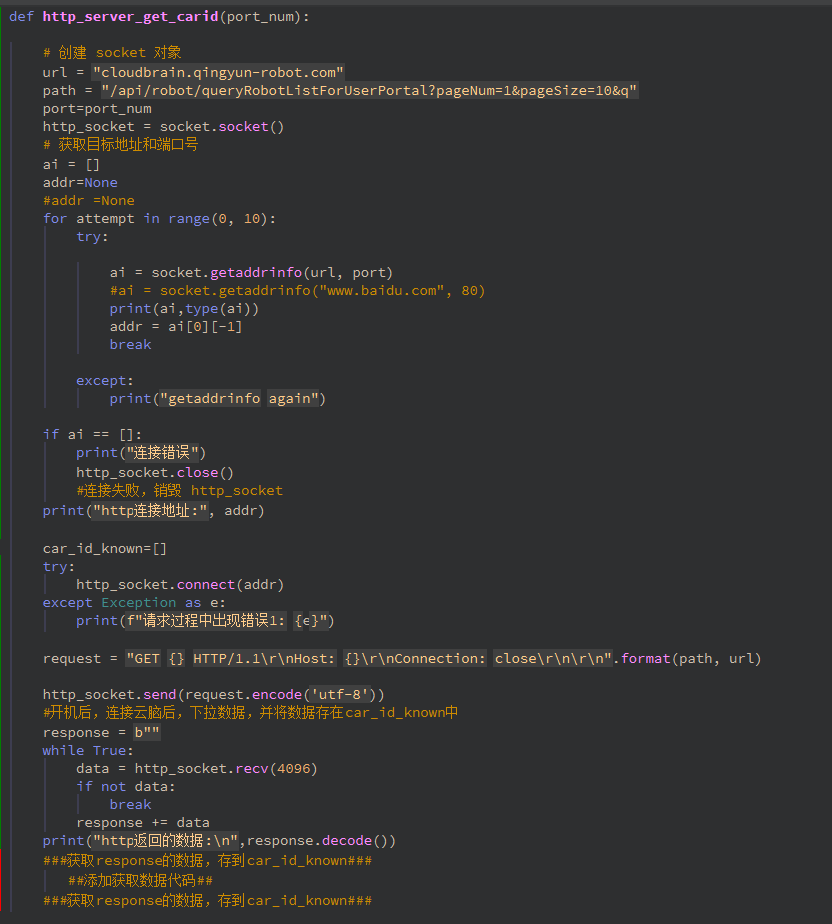

http请求网页数据,没获取的想要的数据内容
希望获取到网页连接的数据

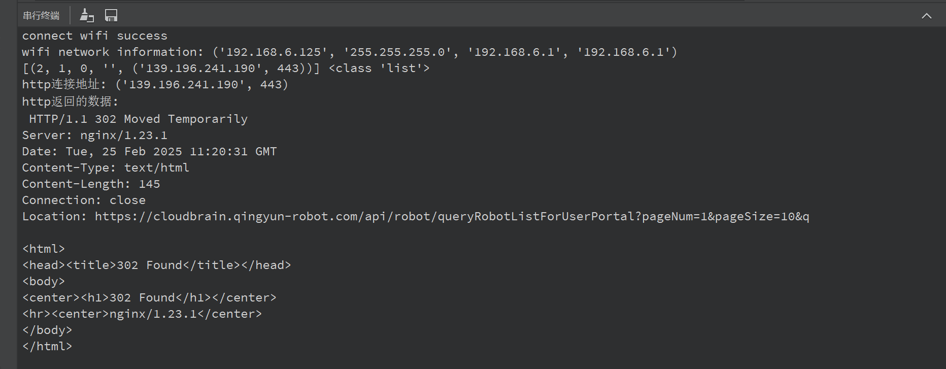

MPY: soft reboot
connect wifi success
wifi network information: ('192.168.6.125', '255.255.255.0', '192.168.6.1', '192.168.6.1')
[(2, 1, 0, '', ('139.196.241.190', 443))] <class 'list'>
http连接地址: ('139.196.241.190', 443)
http返回的数据:
HTTP/1.1 302 Moved Temporarily
Server: nginx/1.23.1
Date: Tue, 25 Feb 2025 11:20:31 GMT
Content-Type: text/html
Content-Length: 145
Connection: close
Location: https://cloudbrain.qingyun-robot.com/api/robot/queryRobotListForUserPortal?pageNum=1&pageSize=10&q
302 Found
nginx/1.23.1 `尝试解决过程`

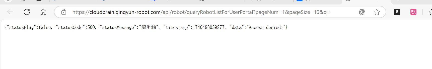

网页链接内容打开显示的实际内容:
get请求 返回的实际内容:
你好,302这种http status code需要自己去实现跳转。或者使用其他得库
