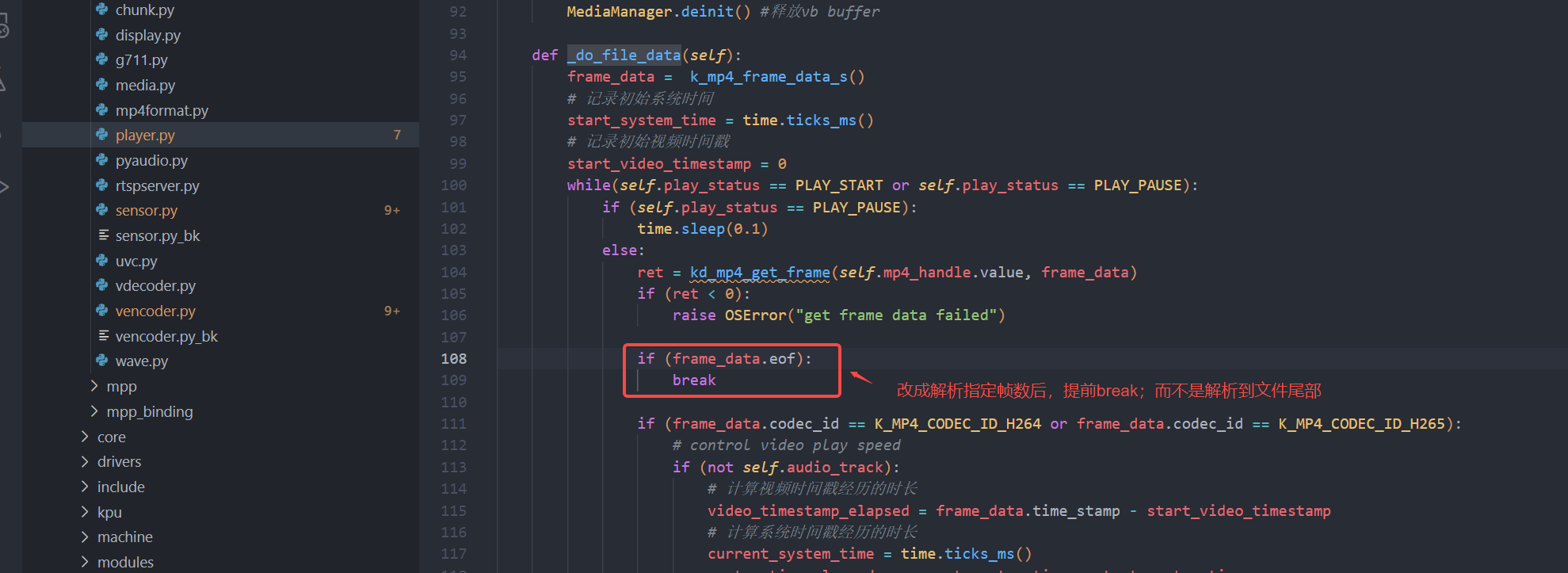

    def _do_file_data(self):
        frame_data =  k_mp4_frame_data_s()
        # 记录初始系统时间
        start_system_time = time.ticks_ms()
        # 记录初始视频时间戳
        start_video_timestamp = 0
        while(self.play_status == PLAY_START or self.play_status == PLAY_PAUSE):
            if (self.play_status == PLAY_PAUSE):
                time.sleep(0.1)
                ret = kd_mp4_get_frame(self.mp4_handle.value, frame_data)
                if (ret < 0):
                    raise OSError("get frame data failed")
                if (frame_data.eof):
                    break
                if (frame_data.codec_id == K_MP4_CODEC_ID_H264 or frame_data.codec_id == K_MP4_CODEC_ID_H265):
