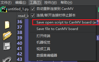

By pressing run button in CanMV IDE, I can succesfully run the python code.
But after restarting K230, I again need to press run button in CanMV IDE. Python code not starting automatically on boot.
How to upload main python code into K230?
Please follow the steps shown in the image to save the script intended for auto-start. After powering on the device again, do not connect to the CanMV IDE; the script will automatically start.
