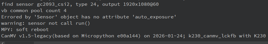

k230使用auto_exposure提示no attribute

    sensor.auto_exposure(False)
    sensor.exposure(10000)

庐山派
CanMV_K230_LCKFB_micropython_v1.5-legacy-0-g413737f_nncase_v2.9.0
你好,请下载最新的daily build.
