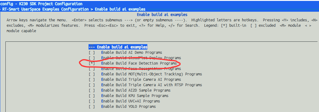

经过多次认证,自行编译镜像,只要图像输出和摄像头采集均运行异常,
但官网下载RtSmart-K230_LCKFB_rtsmart_v0.7-0-g0946d74_nncase_v2.9.0.img运行正常
庐山派,k230_canmv_v1.1
RT-Smart SDK0.7

你好,请问你这是编译的哪个demo?
examples/ai/face_detection
