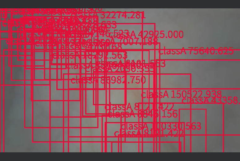

运行demo里的yolov5_det_video检测效果很好
自己训练的pt文件转kmodel就乱检测且几秒后卡死
total took 307.74 ms
total took 48.20 ms
total took 46.02 ms
total took 57.47 ms
total took 47.77 ms
total took 64.22 ms
total took 57.81 ms
total took 84.17 ms
(之后就卡死了,复位后才能连上)

max_box 调小也是卡死,模型转换用的https://github.com/imHuangke/Onnx-to-Kmodel
.To_kmodel.py --target k230 --model "runs/detect/train3/weights/best.onnx" --input_width 320 --input_height 320 --ptq_option 0 --dataset_path "E:\DeskTop\X50out\images\train"
庐山派
CanMV_K230_LCKFB_micropython_local_nncase_v2.11.0
自定义2.11得固件是为了移除example例程和加了几个自定义的py文件,对此应该没有影响吧,之前2.9得时候没有这种问题
你好,你这个看着像是解码的问题,你可以检查一下onnx的yolov5的输出,k230的YOLOv5支持的是一个输出的格式。
