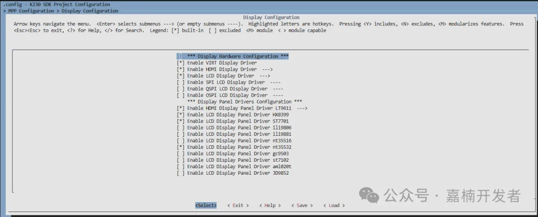

  • 运行时查看支持的屏幕可以使用list_connector查看支持的屏幕
msh />list_connector
Connector Type List:
        TYPE  NAME                              RESOLUTION    FPS
           0  VIRTUAL_DISPLAY_DEVICE               0x0           0 fps
    68711360  HX8399_1080_1920_DSI_V1           1080x1920       55 fps
   605274512  ST7701_480_800_DSI_V1              480x800        59 fps
   605274539  ST7701_480_854_DSI_V1              480x854        62 fps
   605274432  ST7701_480_640_DSI_V1              480x640        59 fps
   605217040  ST7701_368_544_DSI_V1              368x552        60 fps
   757006876  LT9611_1920_1080_HDMI_V1          1920x1080       30 fps
   758055452  LT9611_1920_1080_HDMI_V2          1920x1080       60 fps
   756679016  LT9611_1280_720_HDMI_V1           1280x720        60 fps
   757727592  LT9611_1280_720_HDMI_V2           1280x720        50 fps
   758776168  LT9611_1280_720_HDMI_V3           1280x720        30 fps
   756351216  LT9611_640_480_HDMI_V1             640x480        59 fps
  • 如果没有你需要的屏幕,需要make menuconfig打开驱动
