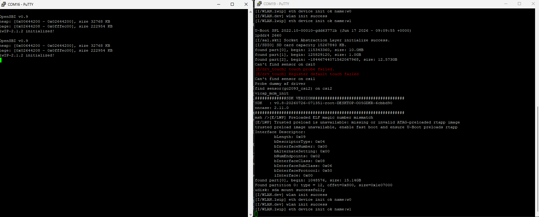

左边是OpenSBI绑定了UART3,右边是RT-SMART绑定了UART0
可以看看这笔改动,估计有影响,https://github.com/canmv-k230/opensbi/commit/ea1ceab9f0af65251e4a5c7d943a1cfa5e9002d6
