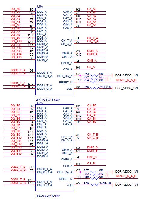

The schematic of the K230 DDR PHY and each DRAM chip must be consistent with the reference schematic, including power decoupling capacitors.
LPDDR3#
The circuit design of LPDDR3 refers to Figures 3-8, 3-9, 3-10, and 3-11. Figure 3-8 K230 LPDDR3 Circuit Figure 3-8 K230 LPDDR3 Circuit Figure 3-9 K230 LPDDR3 Power Circuit Figure 3-9 K230 LPDDR3 Power Circuit Figure 3-10 LPDDR3 Chip Power Circuit Figure 3-10 LPDDR3 Chip Power Circuit Figure 3-11 LPDDR3 Chip Circuit Figure 3-11 LPDDR3 Chip Circuit
When using LPDDR3:
  • The schematic of the DDR PHY and each DRAM chip needs to be consistent with the reference design, including power decoupling capacitors.
  • The DDR_ZN pin needs to be connected to a 240Ω (1%) calibration resistor to ground.
  • The DDR_RESET pin is left floating.
  • The chip has a built-in VREF circuit for the DDR controller, so the DDR_VREF pin needs to be left floating.
  • The LP3_VREFDQ voltage of the LP3 chip is 0.8V, and it is recommended to use 100Ω and 200Ω (1%) resistors for voltage division.
  • The LP3_VREFCA voltage is 0.6V, and it is recommended to use 1kΩ (1%) resistors for voltage division.
  • The CA, CS, CKE, CLK, and ODT pins of the LP3 need to use 100Ω resistors to pull up to DDR_VDDQ_1V2 and ground.
LPDDR4#
The circuit design of LPDDR4 refers to Figures 3-12, 3-13, 3-14, 3-15, and 3-16. Figure 3-12 K230 LPDDR4 Circuit Figure 3-12 K230 LPDDR4 Circuit Figure 3-13 K230 LPDDR4 Power Circuit Figure 3-13 K230 LPDDR4 Power Circuit Figure 3-14 K230 LPDDR4 Reference Voltage Circuit Figure 3-14 K230 LPDDR4 Reference Voltage Circuit Figure 3-15 LPDDR4 Chip Circuit Figure 3-16 LPDDR4 Chip Power Circuit Figure 3-16 LPDDR4 Chip Power Circuit
When using LPDDR4, note:
  • The RESRT_N pin is directly connected to the corresponding pin of the chip.
  • When using LPDDR4 chips with K230, the VREF voltage is 0.6V, and it is recommended to use 1kΩ (1%) resistors for voltage division.

  • For the DDR chips used by the K230, the power supply must be on the same power network as the main chip.
  • Modules with the same voltage requirements can use the same power source if the voltage accuracy and current requirements are met. For applications with low precision requirements, analog modules like ADCs can also be connected to the power source used by digital modules after isolation.
  • The K230 integrates a DDR_Vref power supply for the chip’s DDR controller. For external chips, the reference design for the LPDDR3 VREF power supply is shown in Figure 3-39.
Figure 3-39 LPDDR3 Chip Vref Circuit Figure 3-39 LPDDR3 Chip Vref Circuit
It is recommended to use resistors with an accuracy of ±1%. The reference design for the external LPDDR4 VREF power supply is shown in Figure 3-40.
Figure 3-40 LPDDR4 Chip Vref Circuit Figure 3-40 LPDDR4 Chip Vref Circuit
The reference design for the K230D DDR module VREF power supply is shown in Figure 3-41.
Figure 3-41 K230D Version DDR Vref Circuit Figure 3-41 K230D Version DDR Vref Circuit

4.1.1 DDR Design#
Impedance Control: Single-ended DDR 50Ω, Differential (clock clk, data dqs) 100Ω; Crosstalk Requirements: Follow the 3W rule; Length Matching Requirements: Ensure the same number of vias for the same type of signal lines, and avoid more than 2 layer changes for vias; The internal DDR routing length of the chip is shown in Table 4-1. When routing on the PCB, ensure that the total length of internal and external routing meets the length matching requirements. It is strongly recommended to refer to the design of the K230 EVB, including routing and capacitor selection and placement.

Table 4-1 Internal DDR Trace Lengths
Within LPDDR3 byte groups, DQ can be swapped, but DQ swapping is not supported between bytes or between byte groups. For LPDDR4, DQ can be swapped within byte groups, DQ swapping is not supported between bytes, but byte swapping within channel groups is supported.
It is recommended to follow the EVB swap order for routing. If you modify the swap during your own design, you need to adjust the DDR training code. Please contact FAE in advance.
Figure 4-1 DDR Trace Spacing Design Rules Figure 4-1 DDR Trace Spacing Design Rules
Figures 4-2 and 4-3 show the length matching design requirements for LPDDR3 and LPDDR4 respectively. To ensure stable operation at higher speeds, it is recommended to design according to the requirements listed under “Recommended Routed Skew Limits”.
LPDDR3 Section:
Figure 4-2 LPDDR3 Length Matching Design Rules Figure 4-2 LPDDR3 Length Matching Design Rules
LPDDR4 Section:
Figure 4-3 LPDDR4 Length Matching Design Rules Figure 4-3 LPDDR4 Length Matching Design Rules
