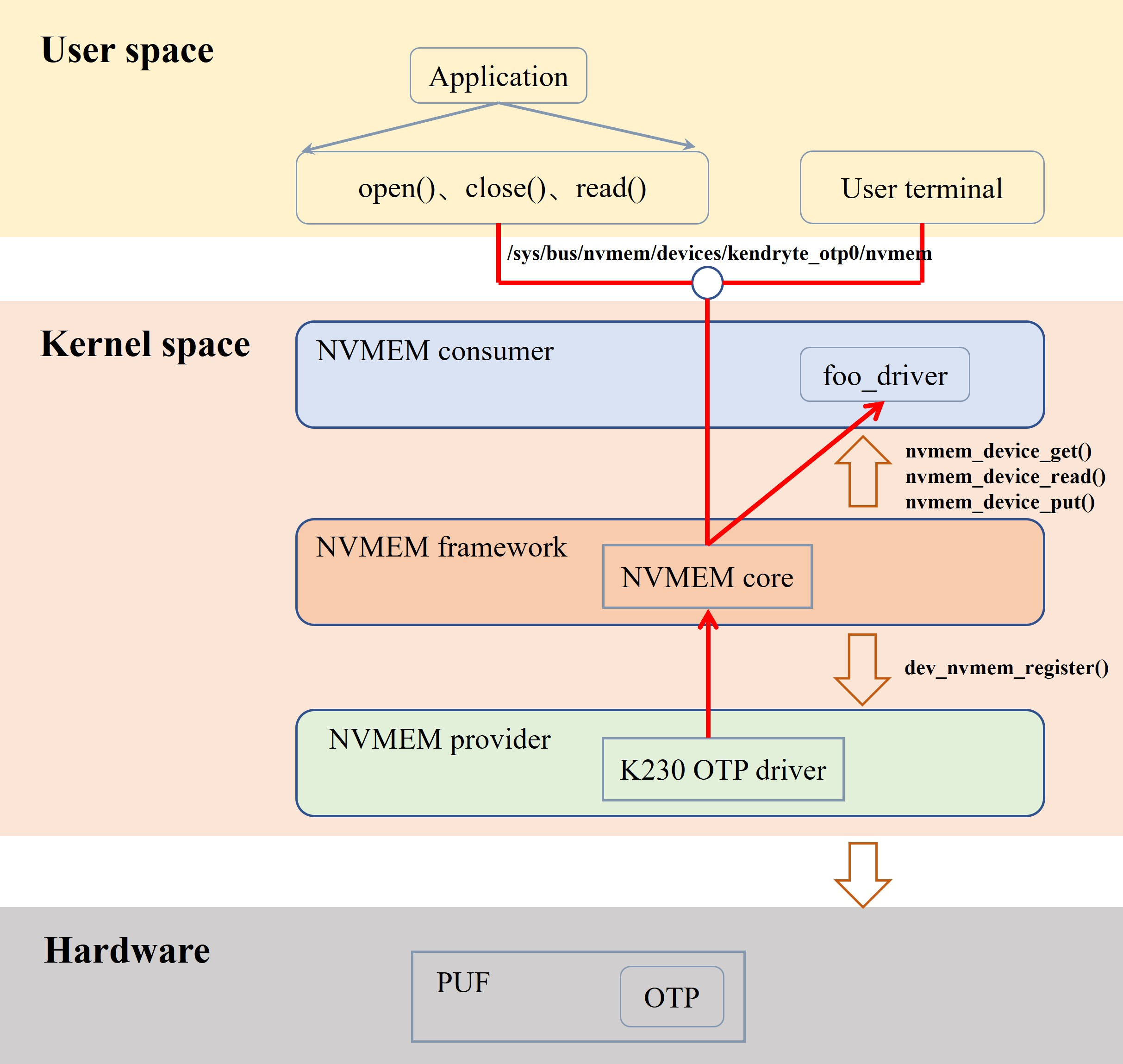

OTP 集成在安全模块 PUF 中,为整个 SoC 提供安全存储功能,保护根密钥和启动代码等关键数据不被攻击者破坏。小核侧 OTP 驱动主要提供读功能,可读区域为包括生产信息在内的 24Kbits 空间。Linux 侧 OTP 驱动挂载在 nvmem 框架上,具体的框架结构如下图所示:

2.6.1 sysfs 文件系统#
|-- nvmem
|-- of_node -> ../../../../../../firmware/devicetree/base/soc/security/otp@91214000
|-- type
|-- uevent
启动 Linux 之后,运行下列命令:
[root@canaan ~ ]# hexdump -C -v /sys/bus/nvmem/devices/kendryte_otp0/nvmem
00000000  ff ff ff ff ff ff ff ff  ff ff ff ff ff ff ff ff  |................|
00000010  ff ff ff ff ff ff ff ff  ff ff ff ff ff ff ff ff  |................|
00000020  ff ff ff ff ff ff ff ff  ff ff ff ff ff ff ff ff  |................|
00000030  ff ff ff ff ff ff ff ff  ff ff ff ff ff ff ff ff  |................|
00000040  ff ff ff ff ff ff ff ff  ff ff ff ff ff ff ff ff  |................|
00000050  ff ff ff ff ff ff ff ff  ff ff ff ff ff ff ff ff  |................|
00000060  ff ff ff ff ff ff ff ff  ff ff ff ff ff ff ff ff  |................|
00000070  ff ff ff ff ff ff ff ff  ff ff ff ff ff ff ff ff  |................|
00000080  00 02 00 00 50 02 00 00  00 01 00 00 00 00 00 00  |....P...........|
00000090  00 00 00 00 00 00 00 00  00 00 00 00 00 00 00 00  |................|
000000a0  00 00 00 00 00 00 00 00  00 00 00 00 00 00 00 00  |................|
或者,利用 dd 命令:
[root@canaan ~ ]# dd if=/sys/bus/nvmem/devices/kendryte_otp0/nvmem of=/tmp/file

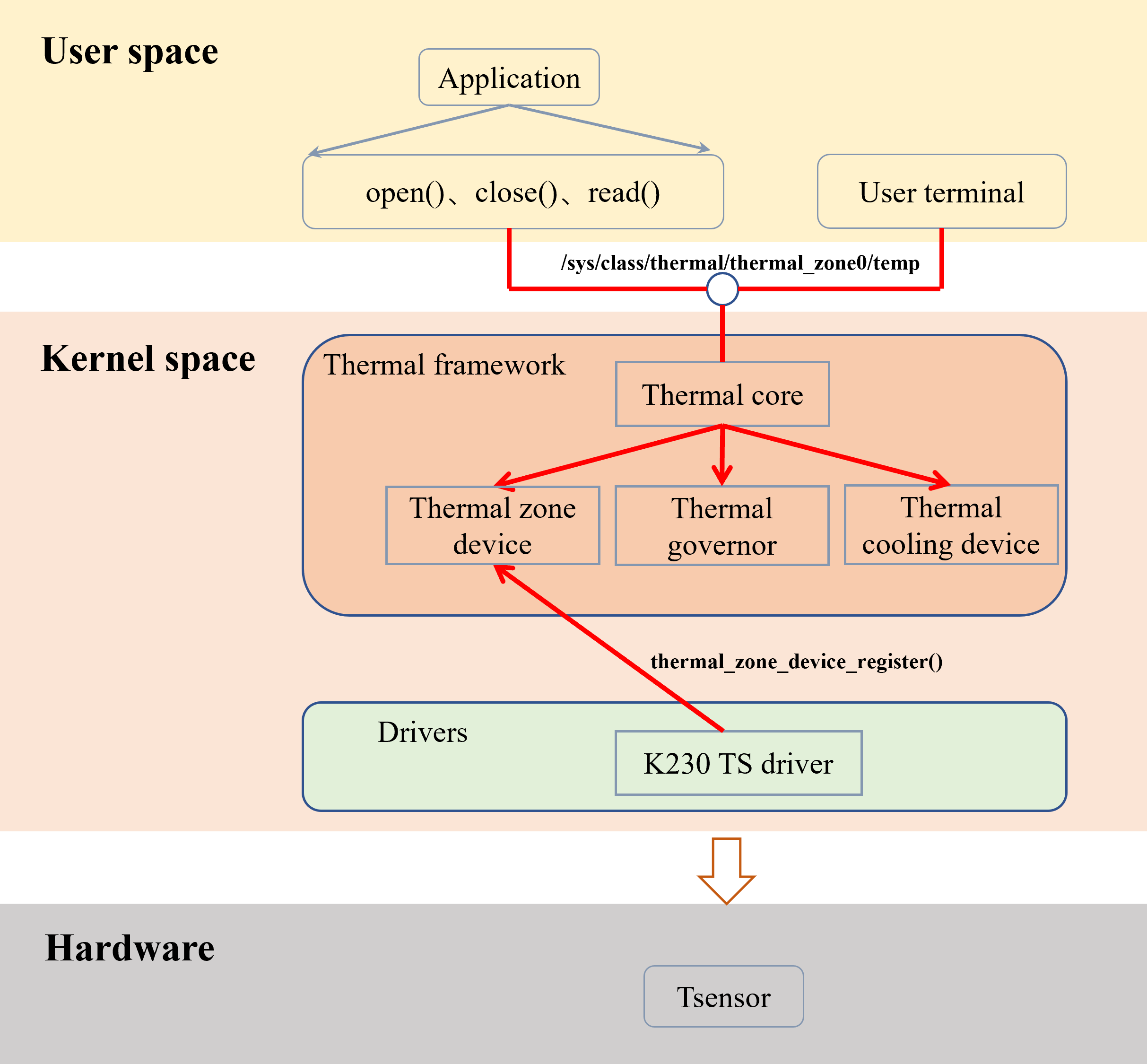

2.7 TS 使用参考#
2.7.1 sysfs 文件系统#
|-- available_policies
|-- integral_cutoff
|-- k_d
|-- k_i
|-- k_po
|-- k_pu
|-- mode
|-- offset
|-- passive
|-- policy
|-- slope
|-- sustainable_power
