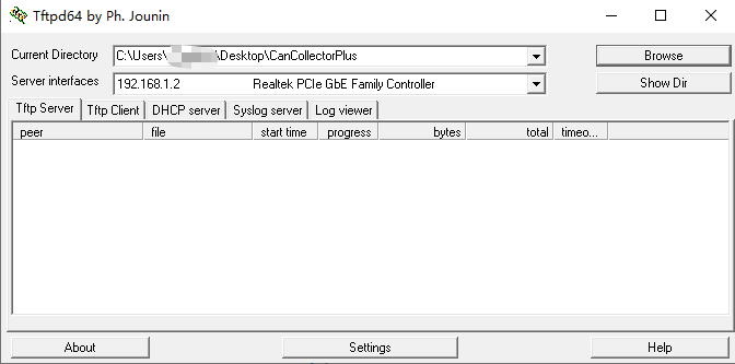

For LAN copying, first install tftpd64, available at: https://pjo2.github.io/tftpd64/
Connect the PC and the CanMV-K230 development board with an Ethernet cable.
Start tftpd64 and configure the directory for the files to be transferred and the service network card:

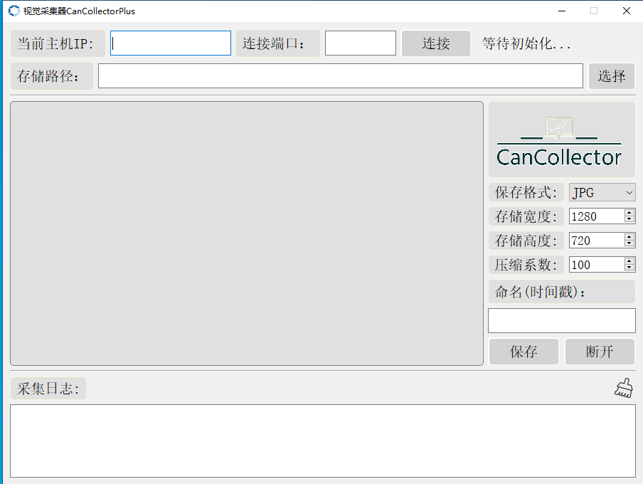

After starting the interface, set the current PC’s IP and port, and set the storage path for collected images:

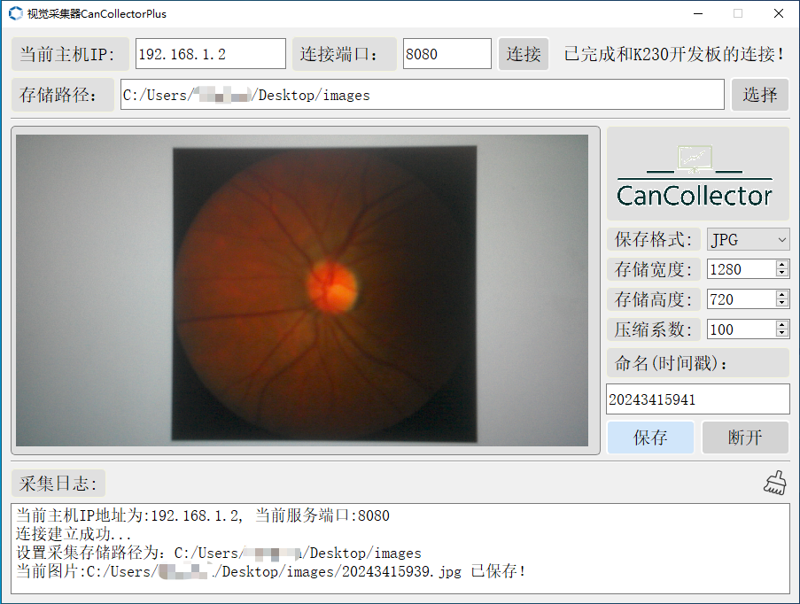

Configure the host IP and port on the PC side, or directly click the connect button to use the default configuration to establish a connection between the PC and the K230. The left side will display the K230 video stream in real-time.
Configure collection parameters, select suitable images, and click the save button to complete the collection. The collected images will be saved in the selected directory.
Collection Example:
Save Results:

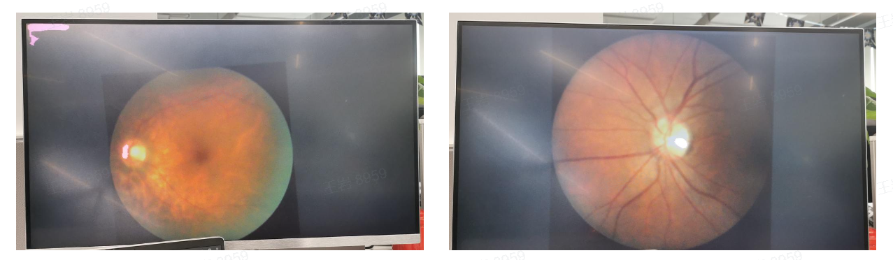

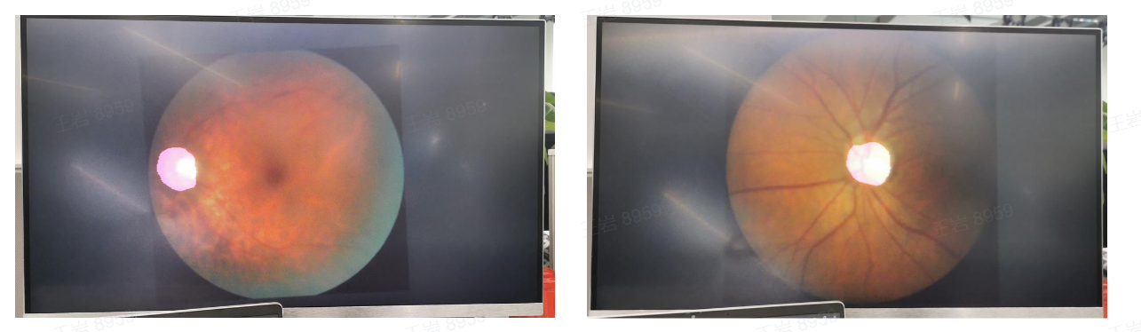

For the task of eye disease segmentation, the deployment results of models trained using public datasets and those trained using data collected with CanCollectorPlus are compared as follows:
The deployment effect of the model trained with public datasets is shown below:
The deployment effect of the model trained with data collected using CanCollectorPlus is shown below:
From the comparison above, we can clearly see that the model trained with public datasets performs poorly, whereas the model trained with data collected and annotated using CanCollectorPlus can more accurately segment the central lesion area during deployment.
