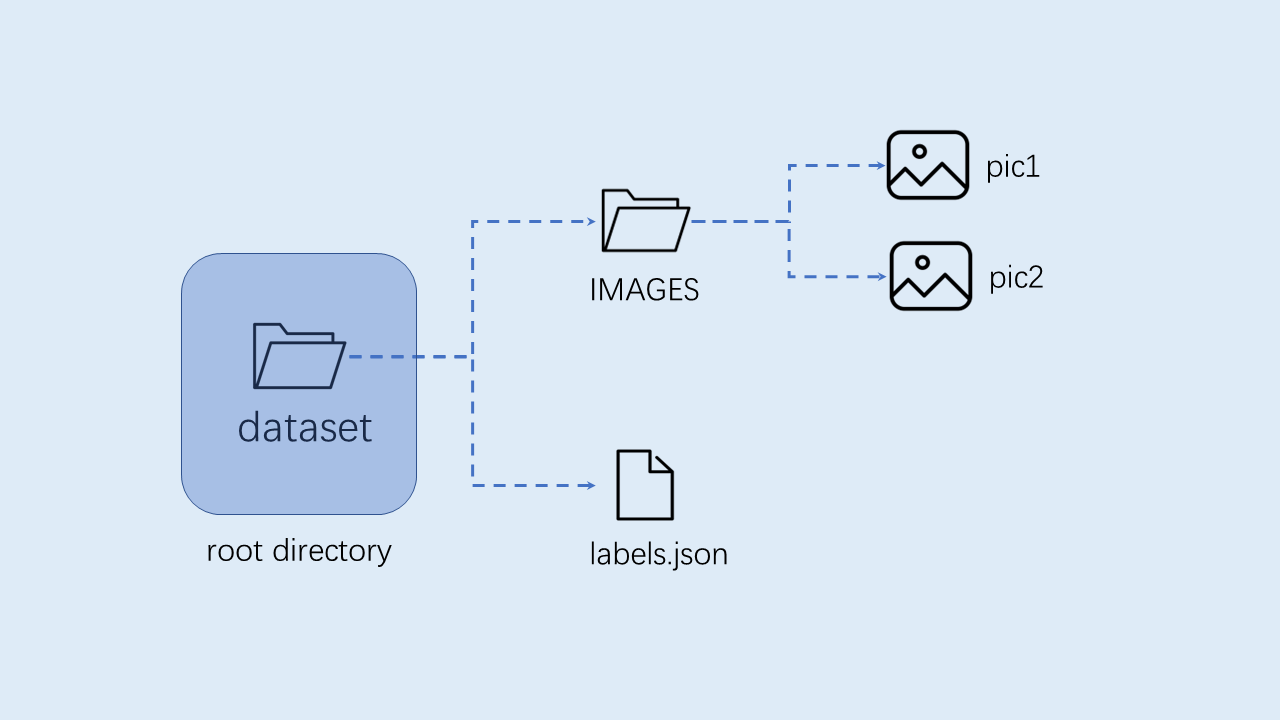

10.1.2 Data Preparation#
Organize the custom dataset for the image classification task as shown in the following format:
dataset_frame
Note: The image classification dataset must be organized in the above format.

10.2.2 Data Preparation#
Organize the custom dataset for the object detection task in the following format. The root directory includes subdirectories named after class names, and each subdirectory contains all image samples of its class.
Object Detection Data Structure

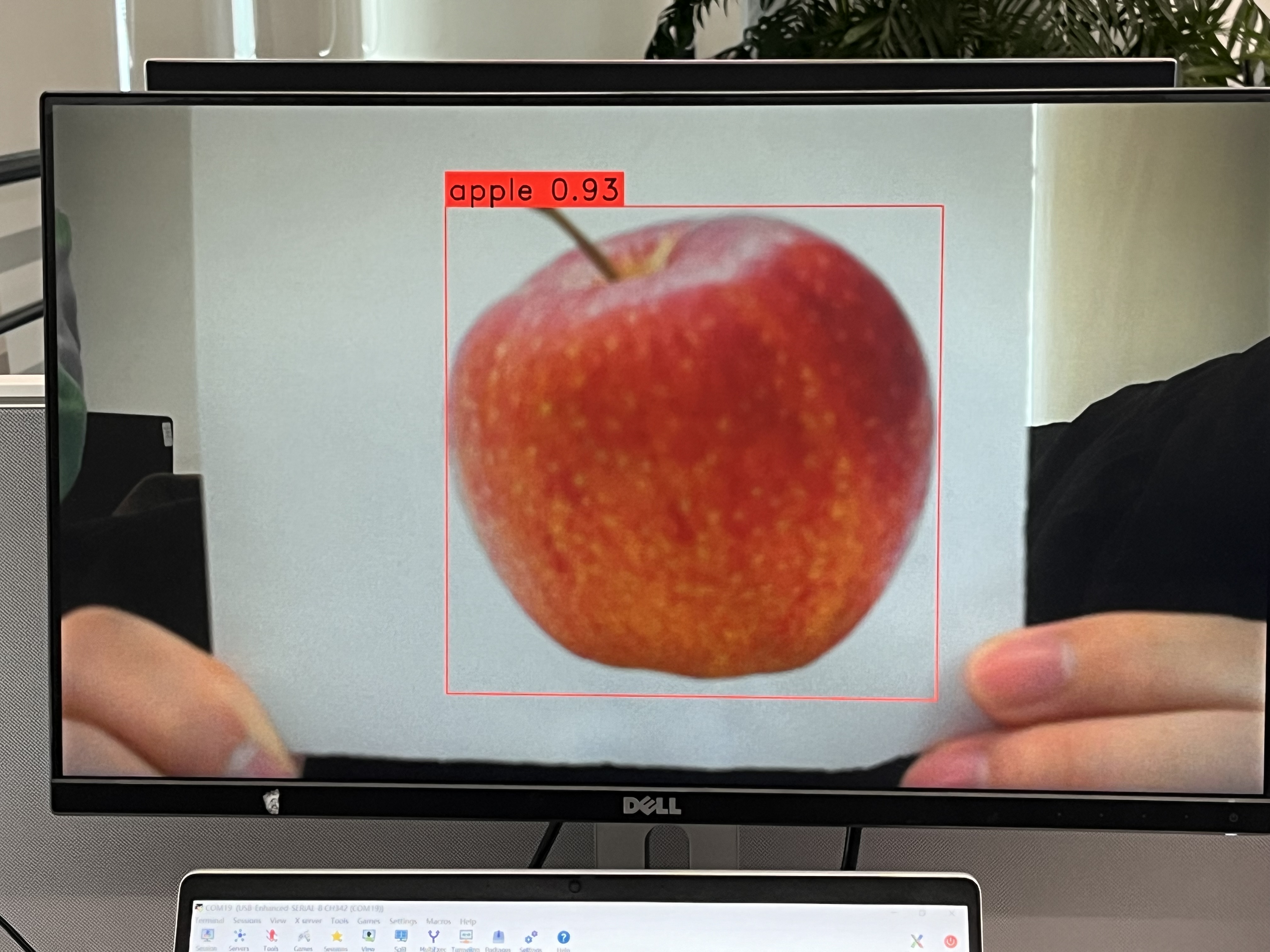

10.2.7 K230-side Deployment#
10.2.7.1 Board-side Deployment Process#
According to the file copying process provided in the previous section, copy the files prepared for the model training and testing part and the elf file prepared for the C++ code compilation part to the development board. The Linux+RT-Smart dual system is in /sharefs, and the pure RT-Smart is in /sdcard. Create a folder test_det:
test_det
 ├──best.kmodel
 ├──deploy.json
 ├──main.elf
To perform static image inference, execute the following code (Note: The code needs to be executed in the large core):
# Linux+RT-Smart
cd /sharefs/test_cls

For camera video stream inference, execute the following code:
main.elf deploy.json best.kmodel None 2
10.2.7.2 Board Deployment Results#
Static image inference illustration:
Static Image Detection Inference
Video stream inference illustration:
Video Stream Object Detection Illustration
