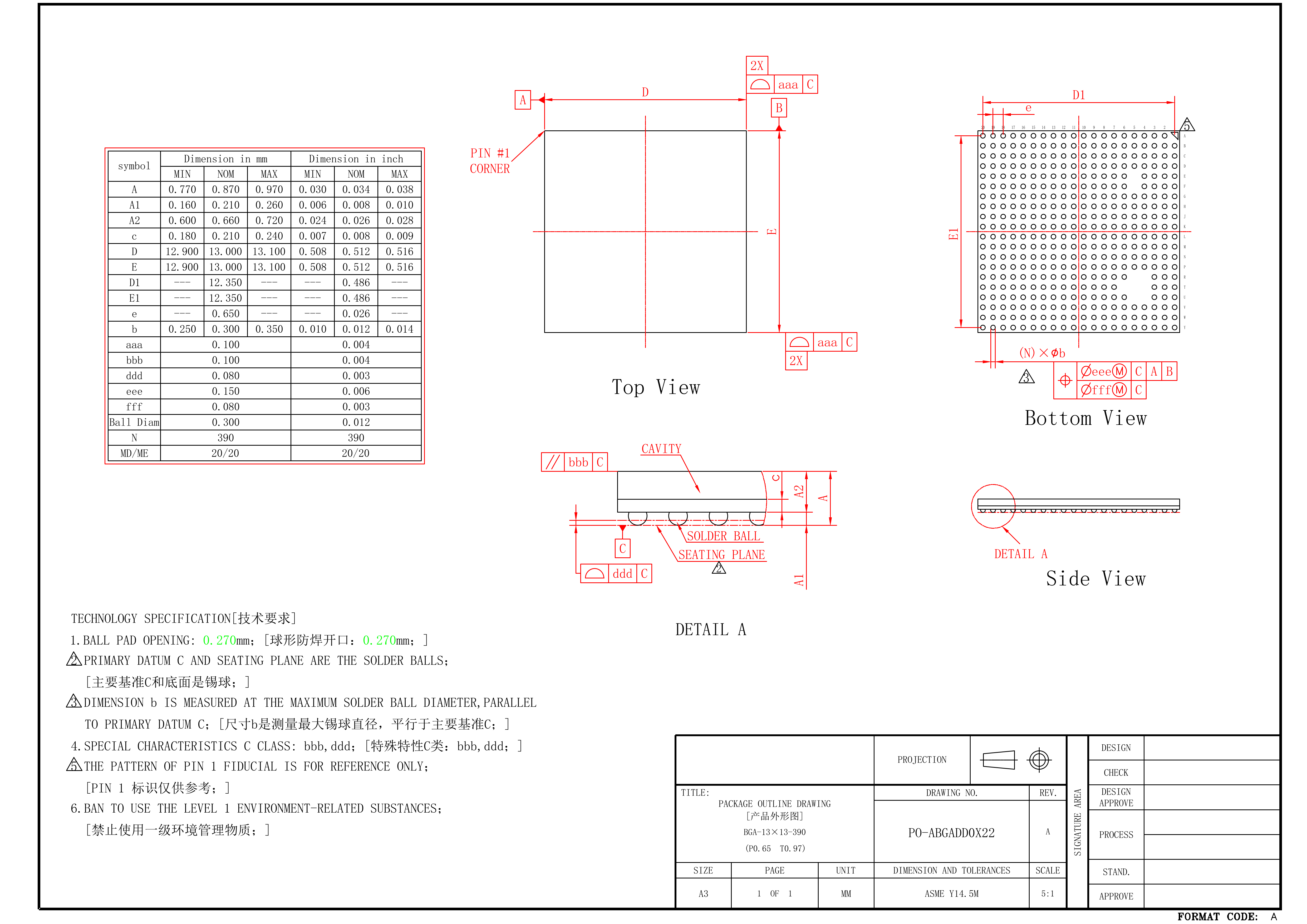

Block Diagram#
K230#
Figure 2-1-1 K230 Package
K230_package

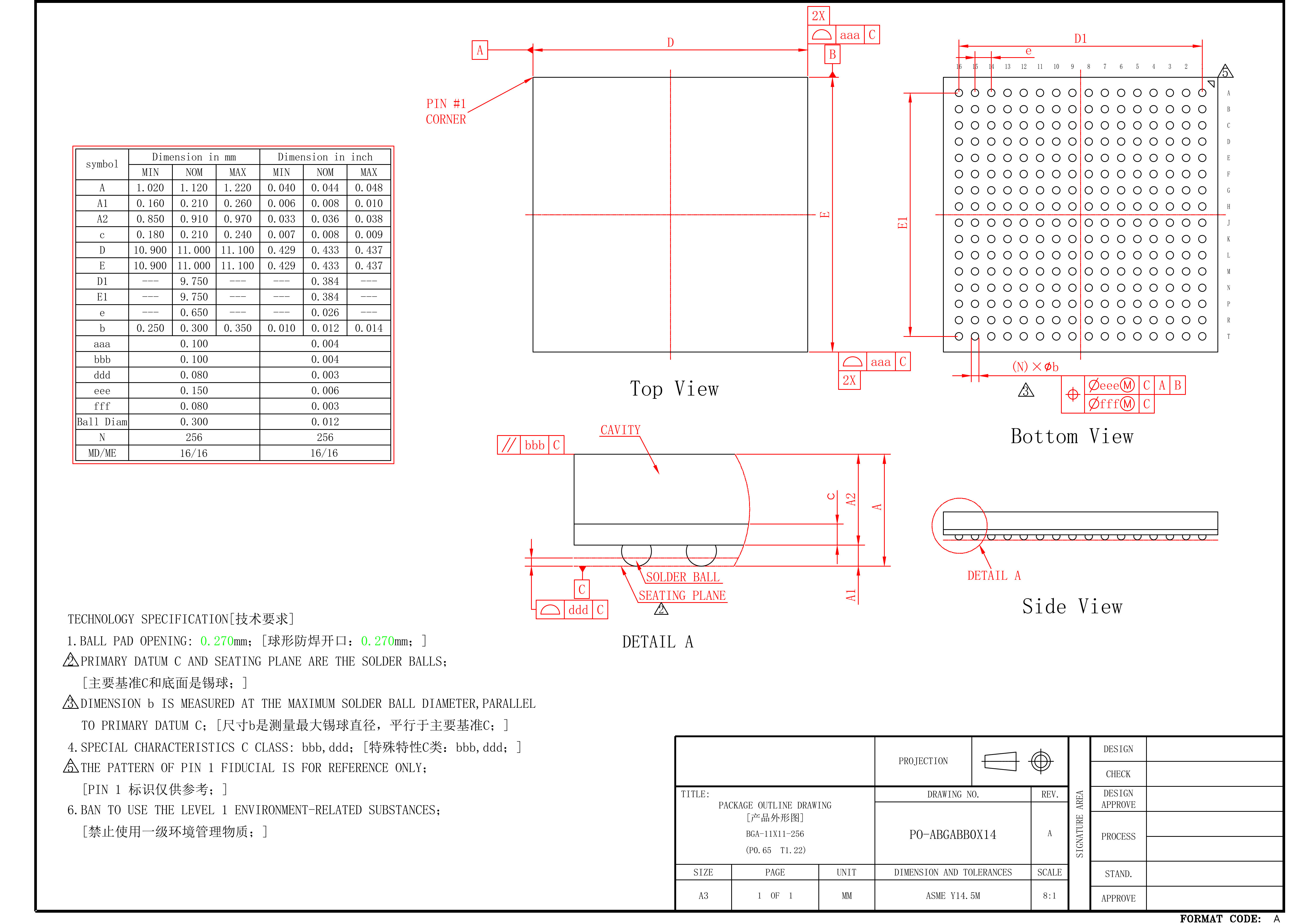

K230D#
Figure 2-2-1 K230D Package
K230_package

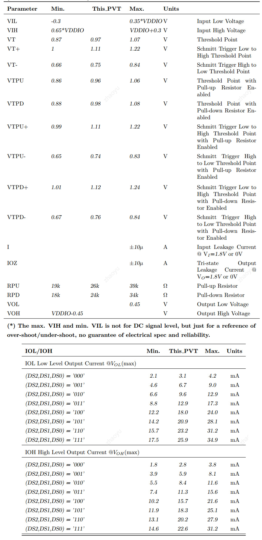

DC Characteristics#
GPIO_ecectric
