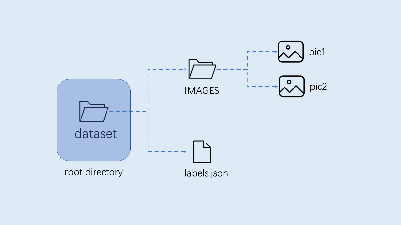

Organize the custom dataset for the image classification task as shown in the following format:
dataset_frame
Note: The image classification dataset must be organized in the above format.

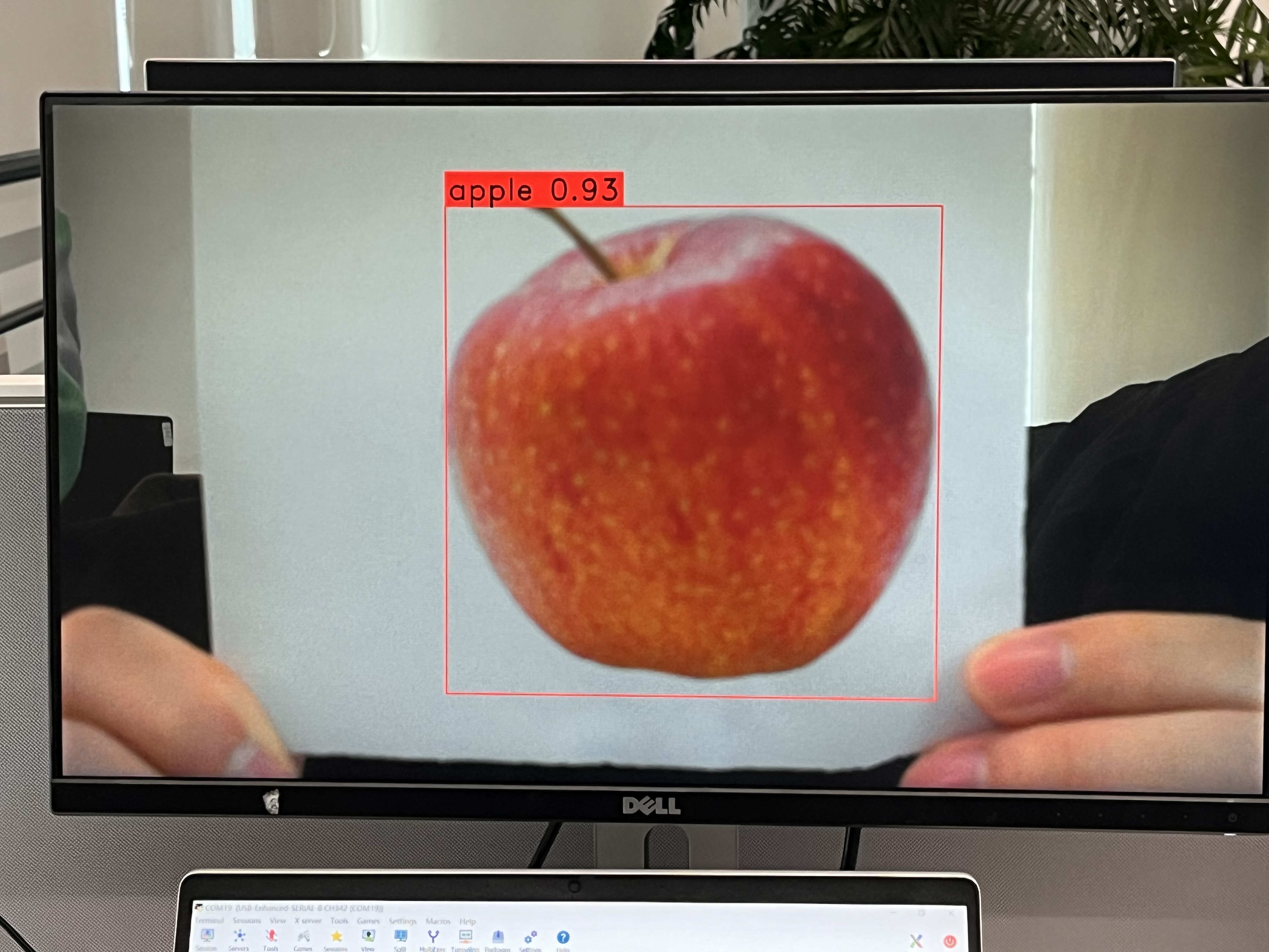

For camera video stream inference, execute the following code:
Board Deployment Results#
Static image inference illustration:
image_inference
Video stream inference illustration:
video_inference

Data Preparation#
Organize the custom dataset for the object detection task in the following format. The root directory includes subdirectories named after class names, and each subdirectory contains all image samples of its class.
Object Detection Data Structure

void image_proc_ob_det(config_args args, char *argv[])
    // Read the image from the static image path in the parameters, create a cv::Mat
    cv::Mat ori_img = cv::imread(argv[3]);
    int ori_w = ori_img.cols;
    int ori_h = ori_img.rows;
    vector<ob_det_res> results;
    // Instance initialization
    AnchorBaseDet ob_det(args, argv[2], atoi(argv[4]));
    // Preprocessing
    ob_det.pre_process(ori_img);
    // Inference
    ob_det.inference();
    // Postprocessing
    ob_det.post_process({ori_w, ori_h}, results);
    // Draw detection boxes and classes on the results
    Utils::draw_ob_det_res(ori_img, results);
    // Save the detection result image
    cv::imwrite("result_ob_det.jpg", ori_img);
main.elf deploy.json best.kmodel None 2
Static Image Detection Inference
Video Stream Object Detection Illustration
