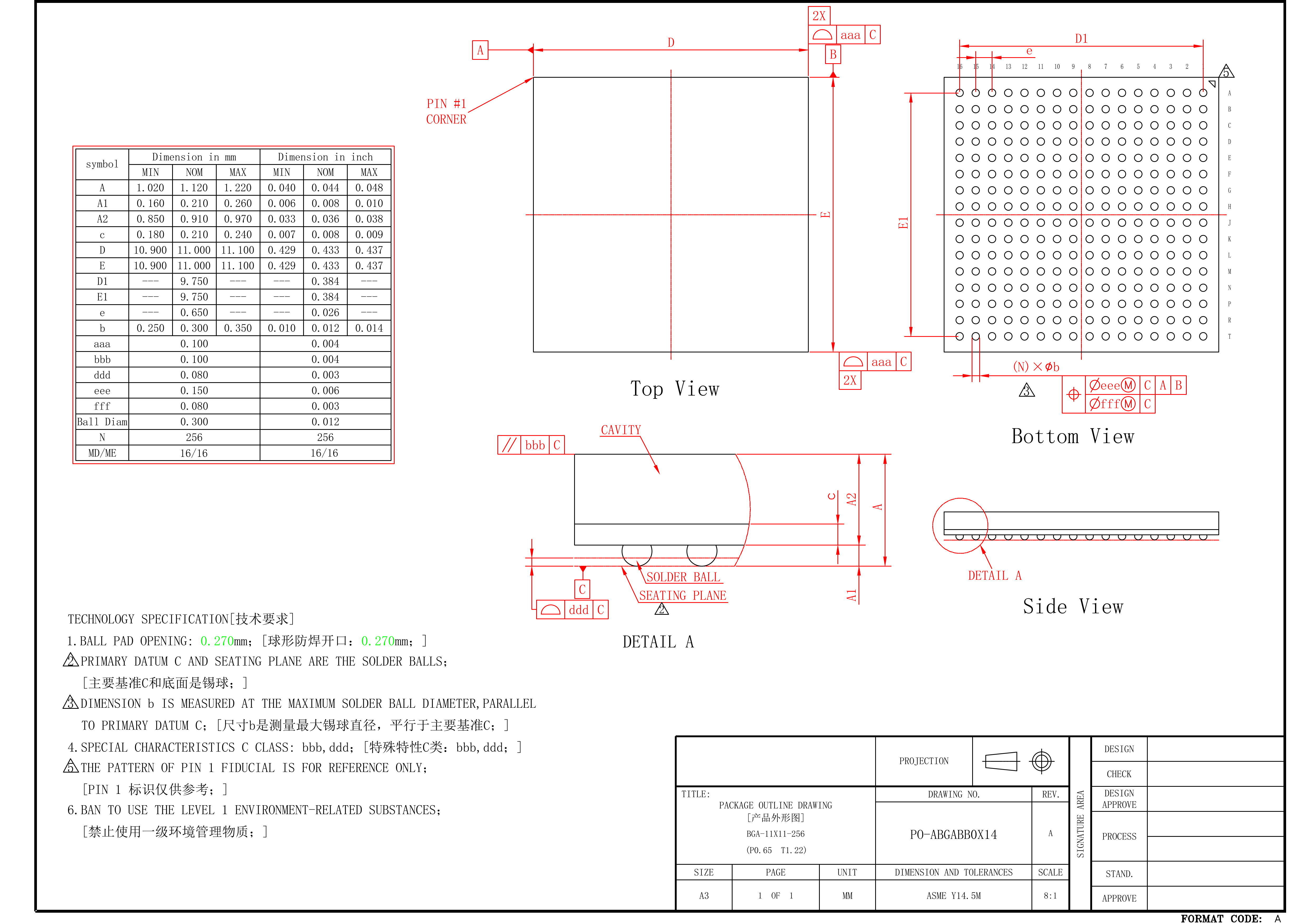

2.1 K230#
Figure 2-1-1 K230 Package
K230_package

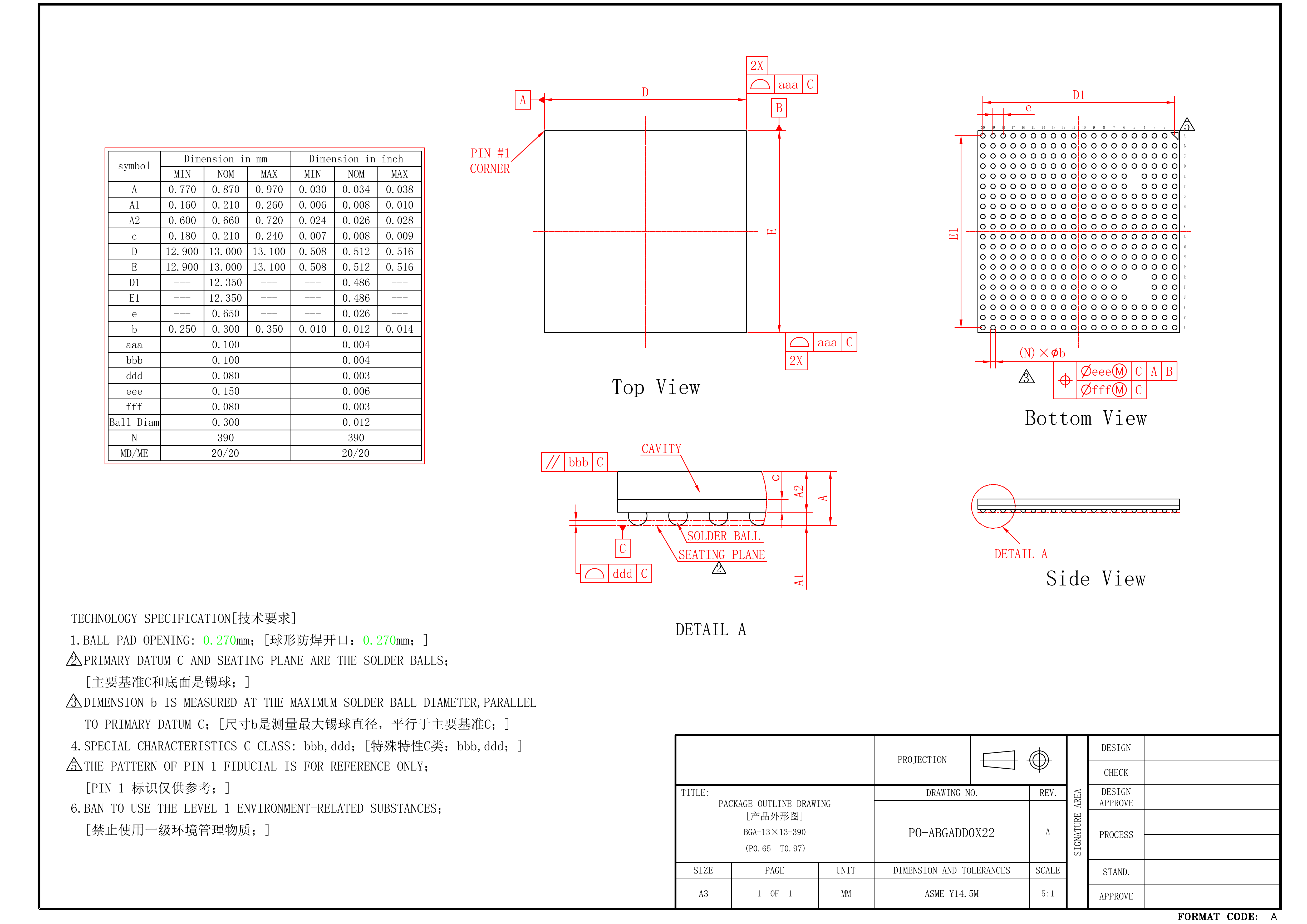

2.2 K230D#
Figure 2-2-1 K230D Package
K230_package

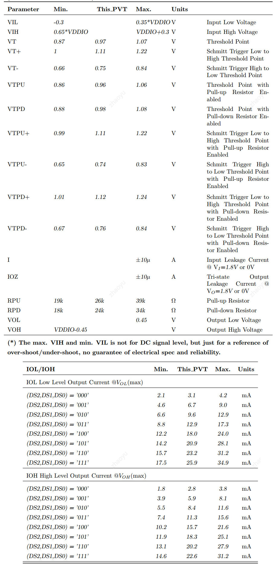

3.3.1 Electrical Characteristics for General IO#
GPIO_ecectric
