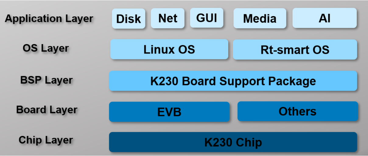

The software architecture of K230 SDK is shown in the diagram below:
K230 SDK Software Architecture
