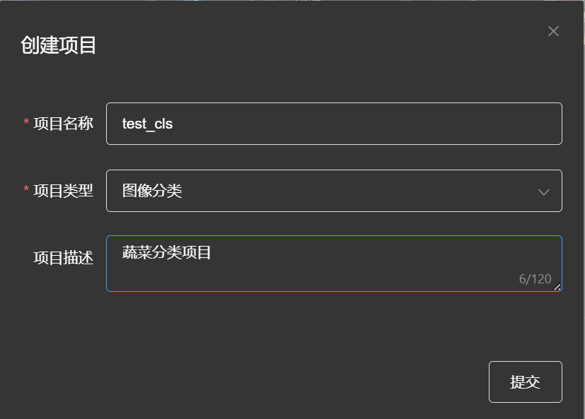

Create a Project#
Click the “Create Project” button to create a vegetable classification project.
Create Project

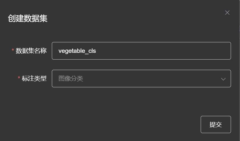

Select the “Dataset” tab and click the “Create Dataset” button.
Create Dataset
Click the “Bind” button to bind the newly created dataset to the currently selected project. Then upload images and complete the annotation. Follow the steps shown below.

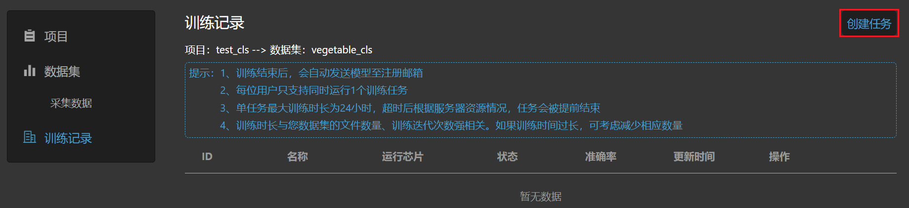

Create a Training Task#
Go to the “Training Records” tab and click the “Create Task” button.
Create Task

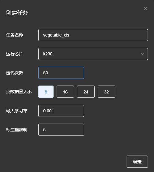

Configure the training parameters and create a new task.
New Task
Note: The annotation box limit is a training parameter for object detection tasks and can be set to default when creating image classification parameters.
After creating the new task, wait for the training to complete. Click the “Details” button to view the task’s execution status.

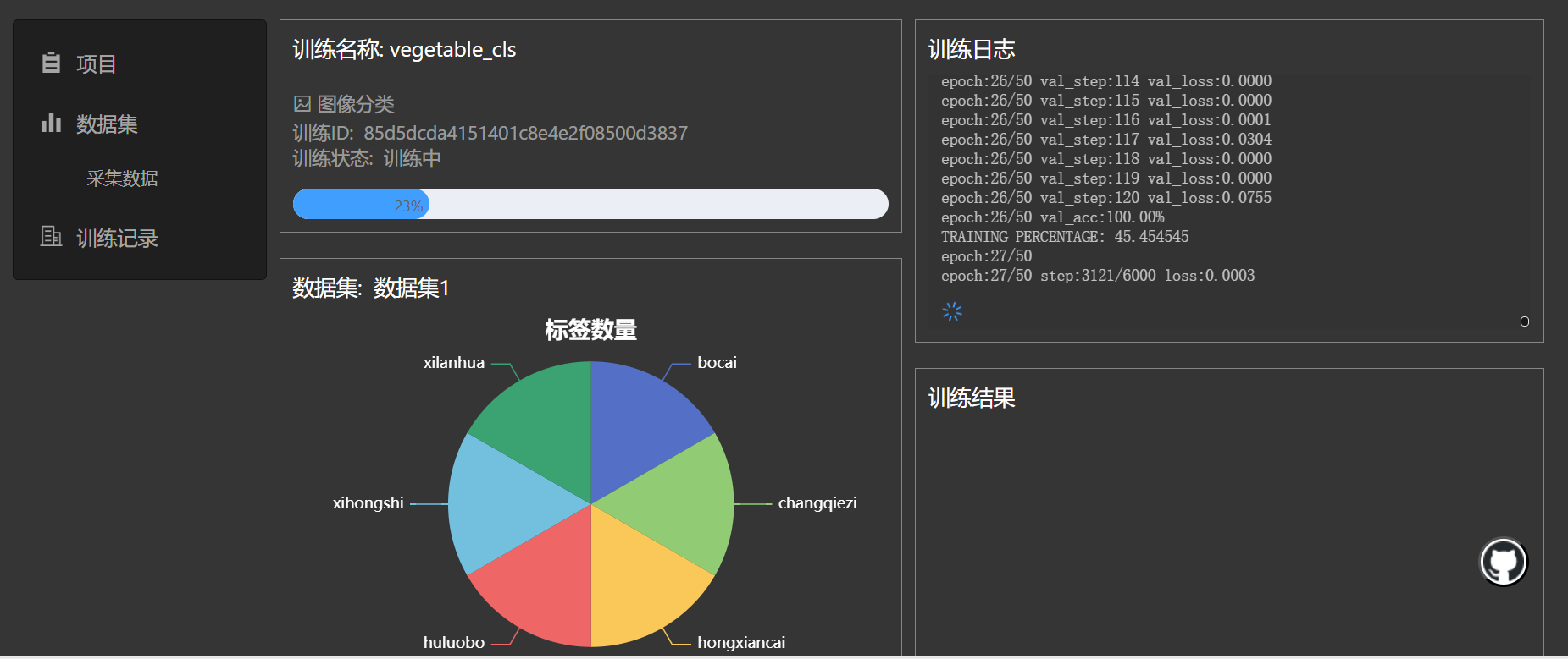

When cloud server training resources are available, the task will enter the training phase. Click the “Details” button to view the training status, as shown below.
Training Details

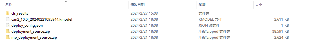

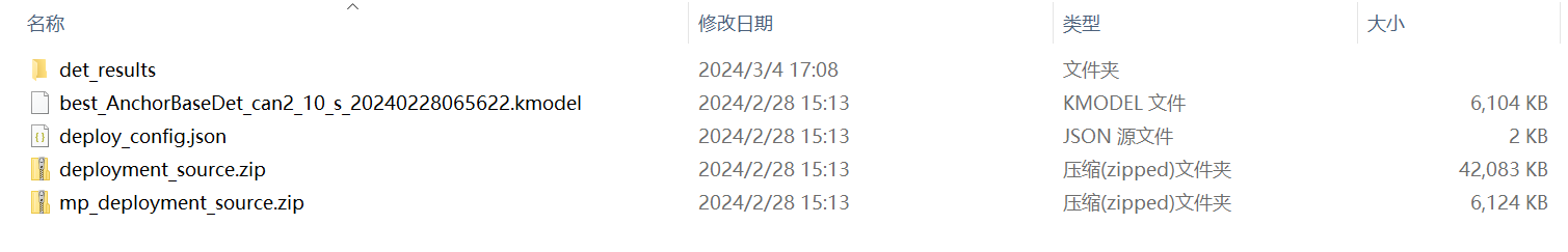

After training is complete, you can download the deployment package, which will also be sent to your registered email.
After extracting the deployment package, the directory structure is as follows:
Classification Task Deployment Package
Directory description:
|-cls_result # This directory contains example images of correct classifications
|-*.kmodel # kmodel used for deployment on the development board
|-deploy_config.json # Deployment configuration file
|-deployment_source.zip # C++ deployment resources
|-mp_deployment_source.zip # MicroPython deployment resources

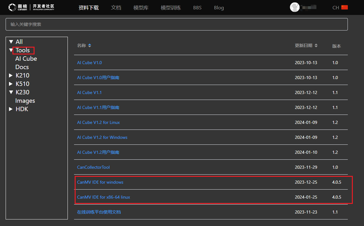

First, go to the Canaan Developer Community (canaan-creative.com) resource download page, select K230->Images, and choose K230_canmv_sdcard_v##_nncase_v###.img.gz. Select the corresponding version of the image based on the “nncase_version” field in the deploy_config.json obtained in the previous section.

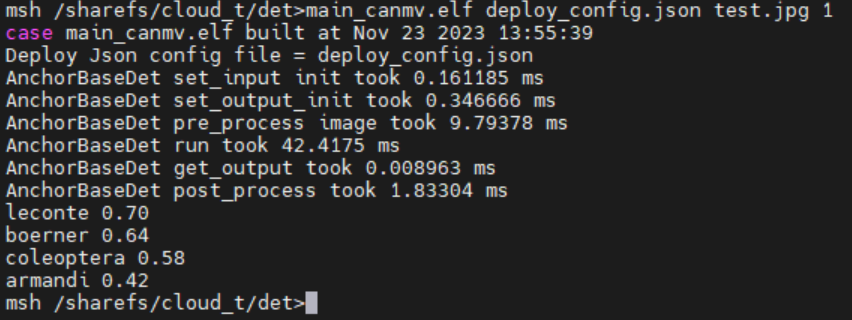

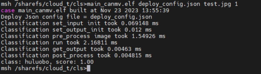

  • Static Image Inference
Connect to the large core serial port and execute the following commands:
# Linux+RT-Smart
cd /sharefs/test_cls
# Only RT-Smart
cd /sdcard/test_cls
# deploy_config.json: Deployment configuration file;
# input_path: Path to the inference image. For video stream inference, set to None;
# debug_mode: Debug mode, 0 for no debug, 1 for simple debug, 2 for detailed debug;
Static image inference result:
Static Image Inference Result

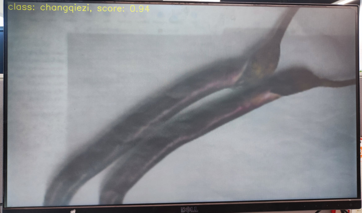

  • Video Stream Inference
# Linux+RT-Smart
# Only RT-Smart
cd /sdcard/test_cls
# input_path: Path to the inference image, set to None for video stream inference;
Video stream inference result:
Video Stream Inference Result

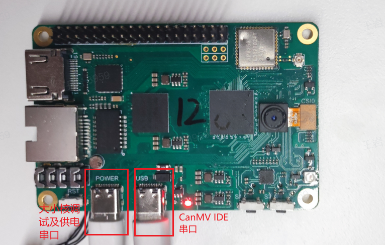

Connect the development board as shown below and power it on:
MicroPython Development Connection

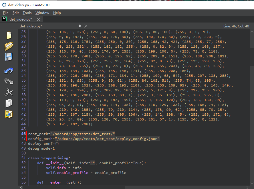

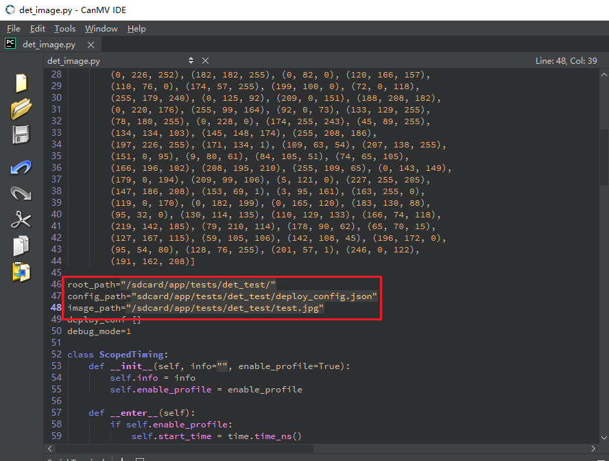

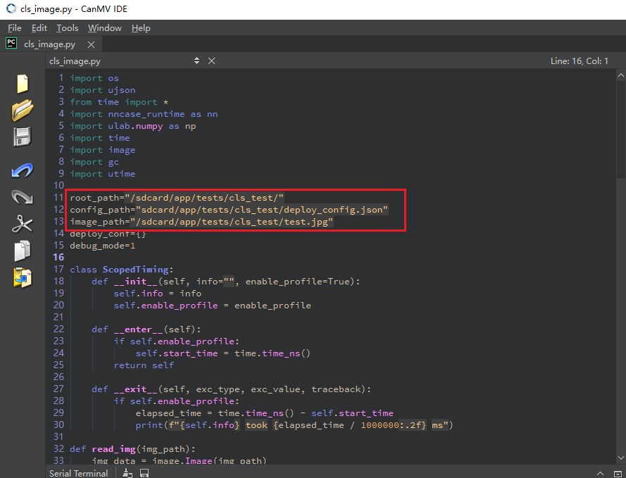

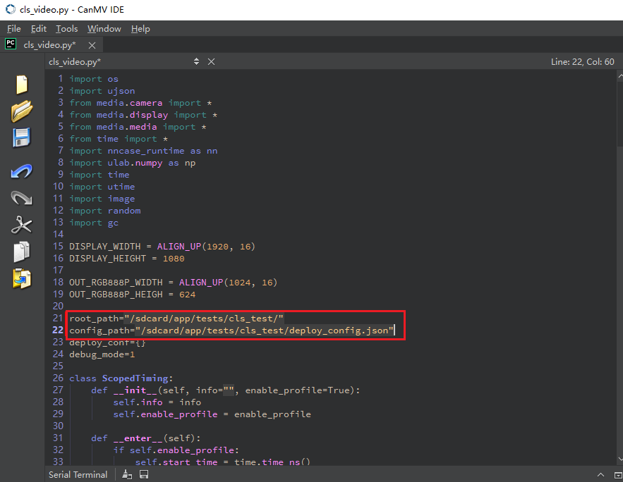

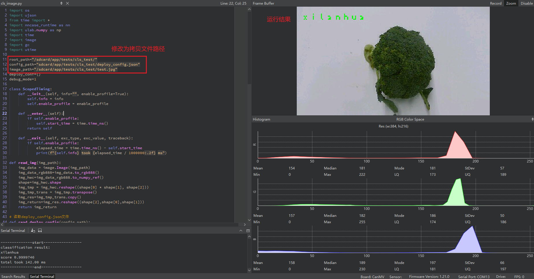

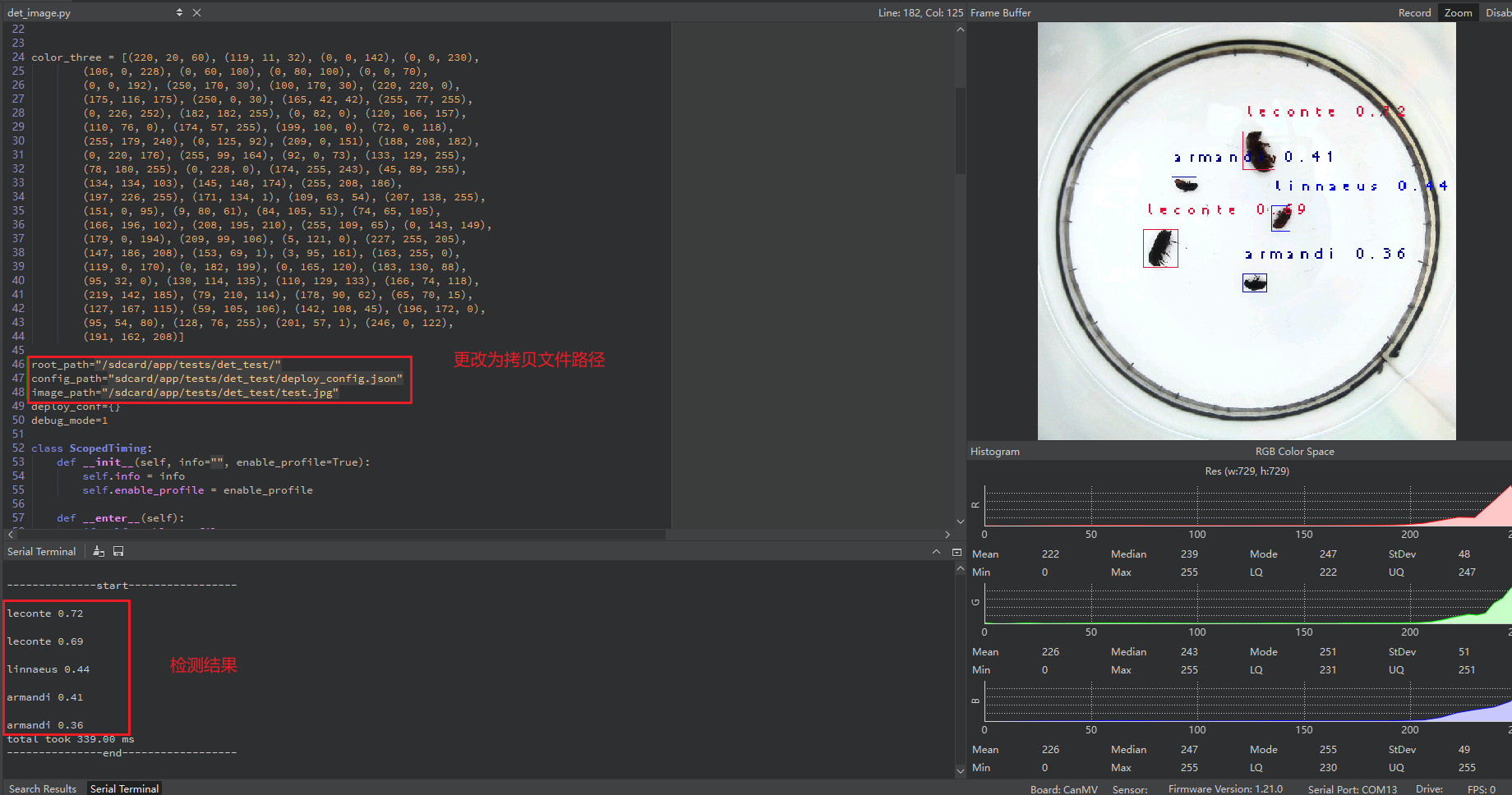

Start CanMV IDE, open the file, select the cls_image.py file from the extracted mp_deployment_source.zip, and modify the file path in the red box below to your copied file path for single image inference:
Classification Single Image
Or open the cls_video.py file, modify the file path to your copied directory for video inference. The video inference result is shown below:
Video Inference

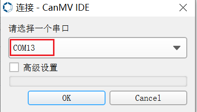

When the connection status at the bottom left changes to the state shown below: canmv_ide_connect
Click the button to connect to the serial port. Select the third serial port besides the large and small core serial ports:
canmv_ide_port After connecting, click the green triangle button to run.
The single image inference result is shown below:
Single Image Inference Result
Video Inference Result

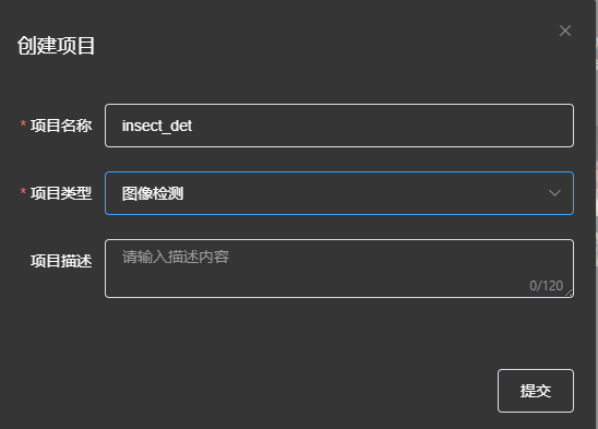

Create a Project#
Click the “Create Project” button to create an insect detection project.
Create Project
Then select this project as the current project.

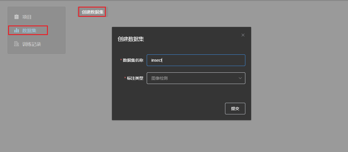

Create Dataset

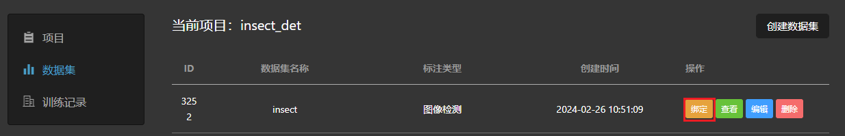

Upload Images Create Dataset
Bind Dataset

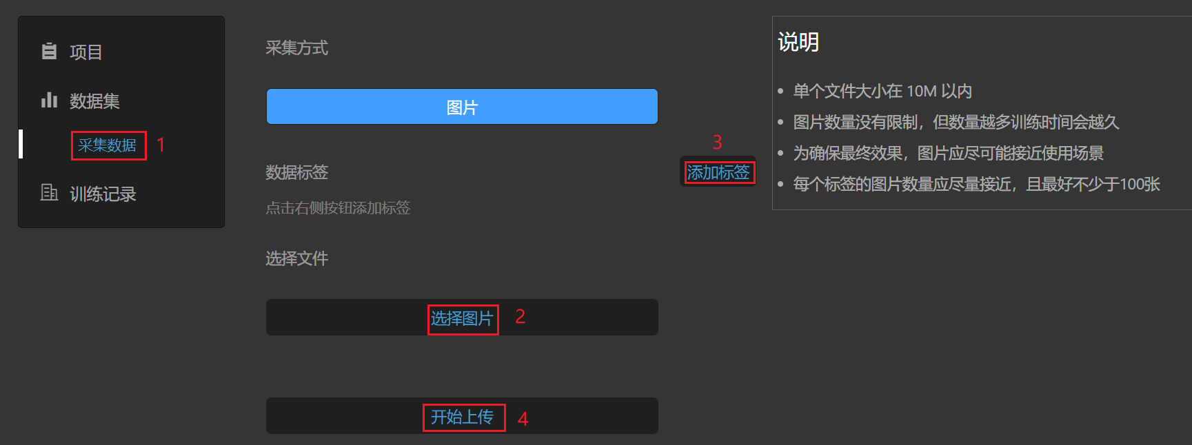

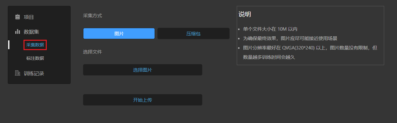

Collect Data

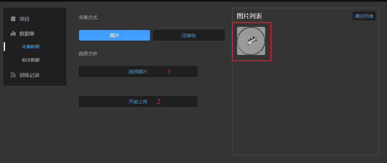

If you choose to upload images, select the images and click “Start Upload”:
Upload Detection Images

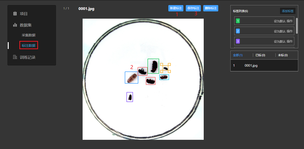

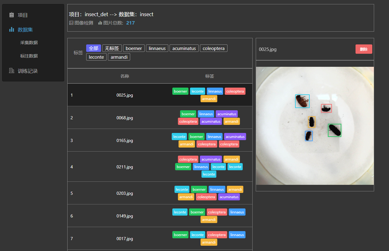

Then click “Annotate Data” to complete the annotation of the uploaded dataset:
Annotate Detection Dataset
If you choose to upload in compressed package format, organize your data as required:
Detection Compressed Dataset
After the dataset is uploaded, you can click the “Dataset” tab to preview it.
Preview Dataset

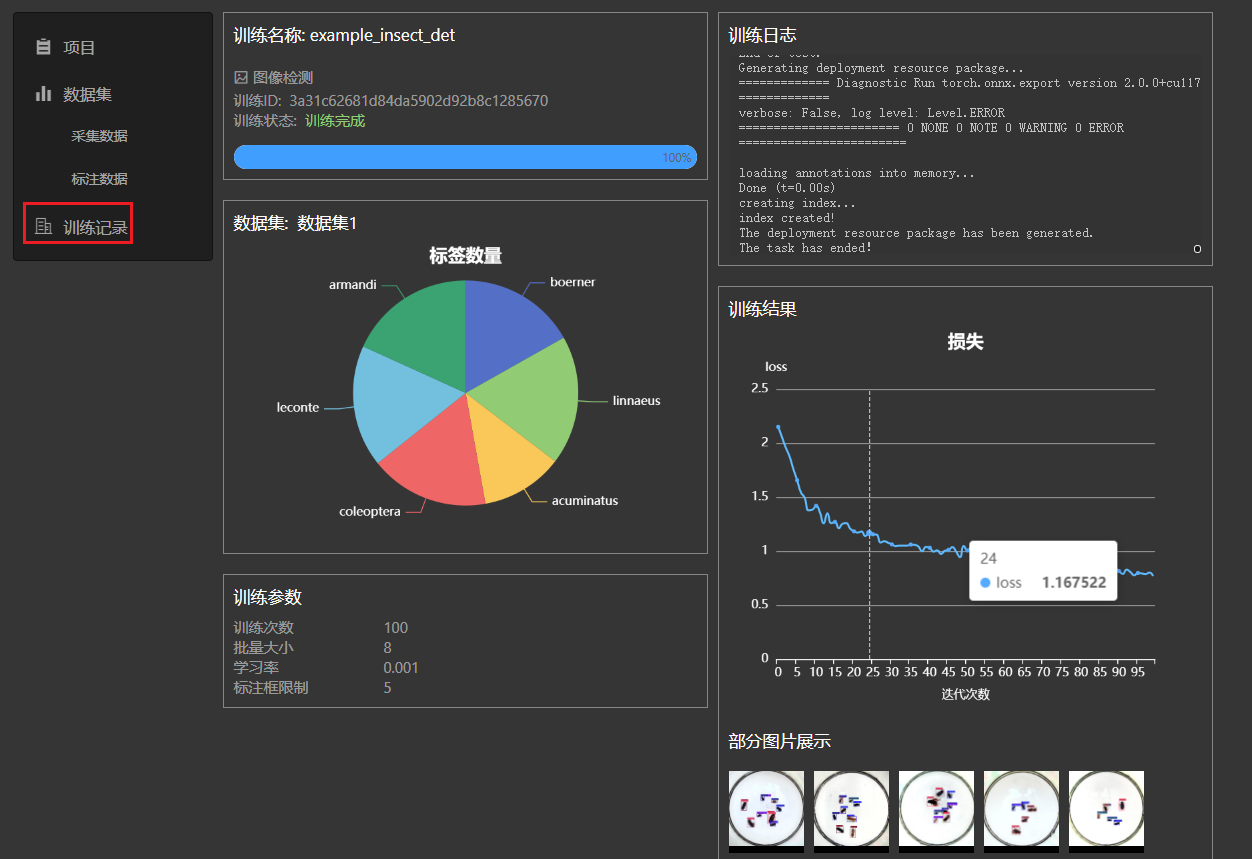

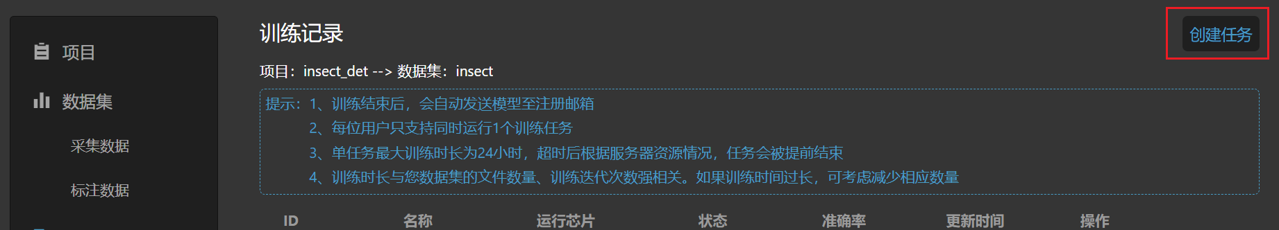

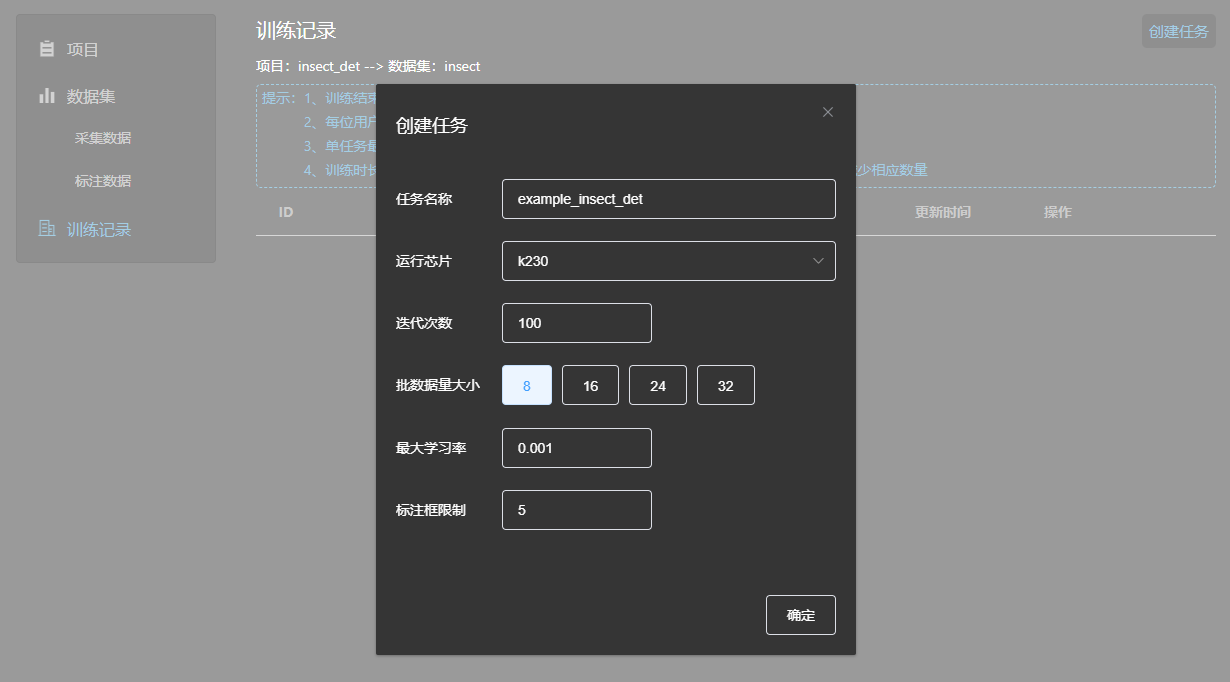

Create Task
New Task
Note: The bounding box limit is a training parameter for object detection tasks, indicating that each bounding box should be at least 5*5 pixels.
Detection Task Training Details
Detection Task Deployment Package
|-det_result # This directory contains some test sample detection results
Note:
For the relationship between k230_sdk and nncase versions, please refer to the link:
CanMV-K230_SDK_nncase Version Compatibility — K230 CanMV Documentation (canaan-creative.com)
# Linux+RT-Smart
cd /sharefs/test_det
# Only RT-Smart
cd /sdcard/test_det

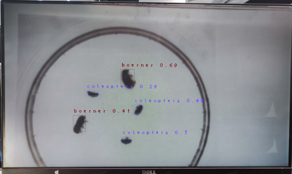

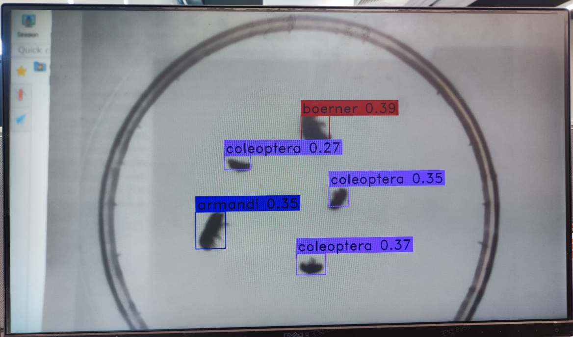

# Linux+RT-Smart
# Only RT-Smart
cd /sdcard/test_det

Burn the MicroPython image. Go to the Canaan Developer Community (canaan-creative.com) resource download page, click on the left side K230/Images, and select CanMV-K230_micropython_v##_sdk_v##__nncase_v###.img.gz to download. Select the version based on the “nncase_version” field in the deploy_config.json file. Use the method described in section 8.2.5.1 to burn the image.
Note:
For the relationship between k230_canmv and k230_sdk, nncase versions, please refer to the link:

Install CanMV IDE. Go to the Canaan Developer Community (canaan-creative.com) resource download page, click on the left side Tools, and download the appropriate version of CanMV IDE for your system.
CanMV IDE
Or open the cls_video.py file, modify the file path to your copied directory for video inference:
Video Inference
