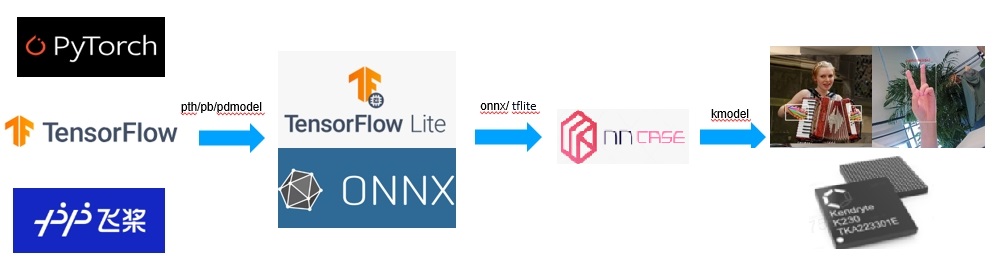

AI models are typically trained using deep learning frameworks such as PyTorch, TensorFlow, and PaddlePaddle. However, there are two issues with directly using these trained models for inference: relying on these training frameworks for inference is complex; different hardware may have different underlying optimizations for operators, resulting in inefficient performance when the same model runs on different hardware, especially in online scenarios with strict latency requirements. After years of exploration by the industry and academia, a mainstream pipeline for AI development has emerged.
image-20240228110135631
This pipeline addresses two major issues in model deployment: using an intermediate representation that interfaces with deep learning frameworks and inference engines, developers no longer need to worry about running various complex frameworks in new environments; through network structure optimization in the intermediate representation and underlying optimization of operations by the inference engine, the computational efficiency of the model is greatly improved.

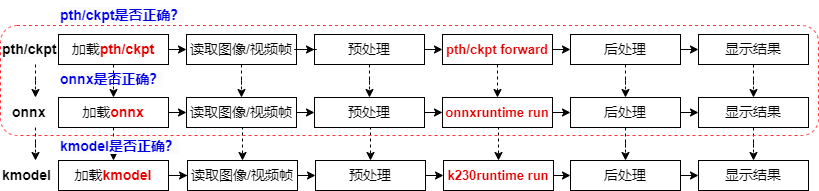

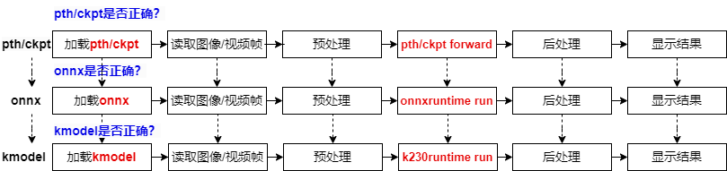

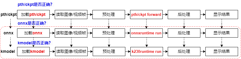

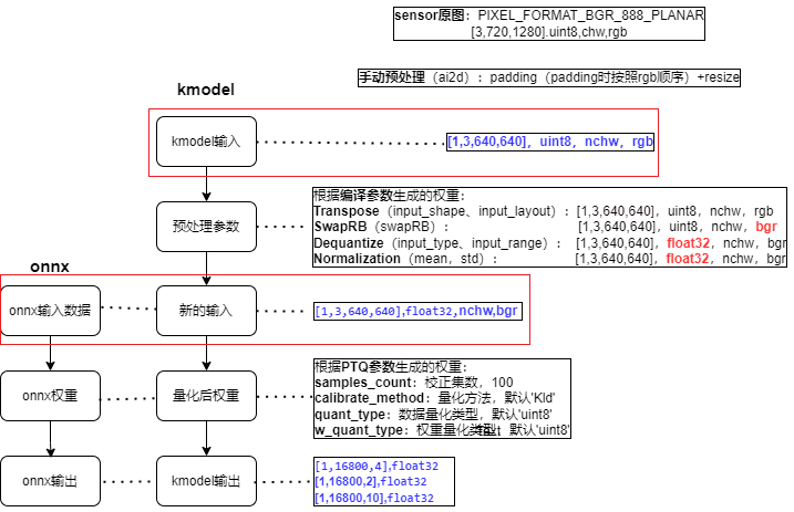

pytorch2onnx2kmodel
For a PyTorch model, from training to deployment on K230, it goes through three file formats: pth/ckpt -> onnx -> kmodel. After converting to a new file format, we need to verify the correctness of the converted model to ensure successful deployment.
  1. We will use a pth inference script to verify the correctness of the pre-trained PyTorch model.
  2. After verifying pth/ckpt, we convert it to onnx.
  3. After converting to onnx, we verify the correctness of the onnx model using ONNXRuntime. The verification process is similar to PyTorch inference, including loading the onnx model, reading images/video streams, preprocessing images/video frames, running onnx, post-processing, and displaying results.
  4. After verifying the onnx model, we convert it to kmodel.
  5. At this point, we use K230Runtime to verify the correctness of the kmodel. The verification process is similar to ONNXRuntime inference, including loading the kmodel, reading images/video streams, preprocessing images/video frames, running kmodel, post-processing, and displaying results.
  6. Once the kmodel inference process is correct, our AI model can be successfully deployed.
The PyTorch model goes through three stages from training to deployment on K230: pth/ckpt verification (usually already verified), onnx verification (using ONNXRuntime), and finally kmodel verification (using K230Runtime). Each stage requires ensuring the correctness of the model to guarantee successful deployment. The verification process includes loading the model, processing input data, running inference, processing output results, and ultimately ensuring the successful deployment of the AI model on K230.

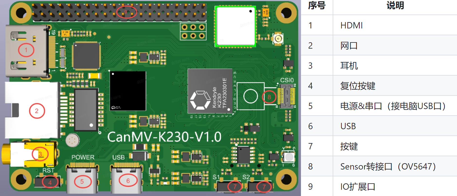

CanMV-K230 Interface Description#
Note: The CanMV-K230 mainboard shares a Type-C port for both power and serial communication (with the computer), as shown in position ⑤ in the image below:
canmv_board

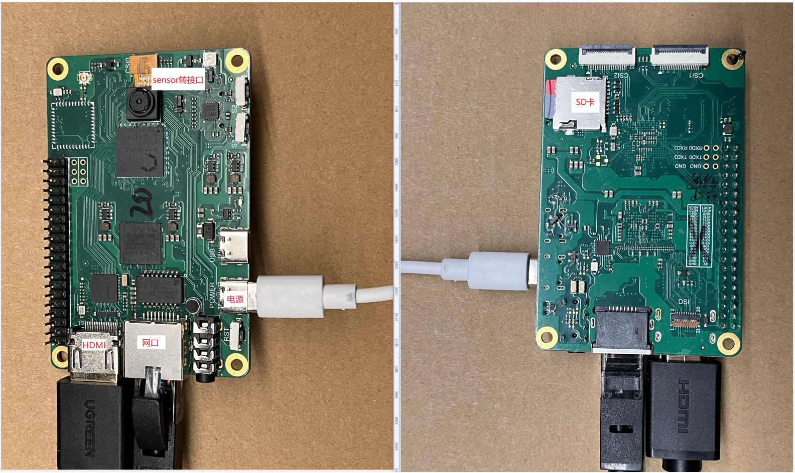

CanMV-K230 Connection Example#
Prepare the following hardware and connect them as shown in the image:
  • CanMV-K230
  • At least one Type-C USB cable
  • An Ethernet cable (optional)
  • An HDMI cable
  • An SD card (if the PC does not have an SD card slot, an SD card reader is needed)
  • A monitor that supports HDMI
After connecting as shown above, you need to flash an image onto the SD card. The next section will explain how to flash the image.

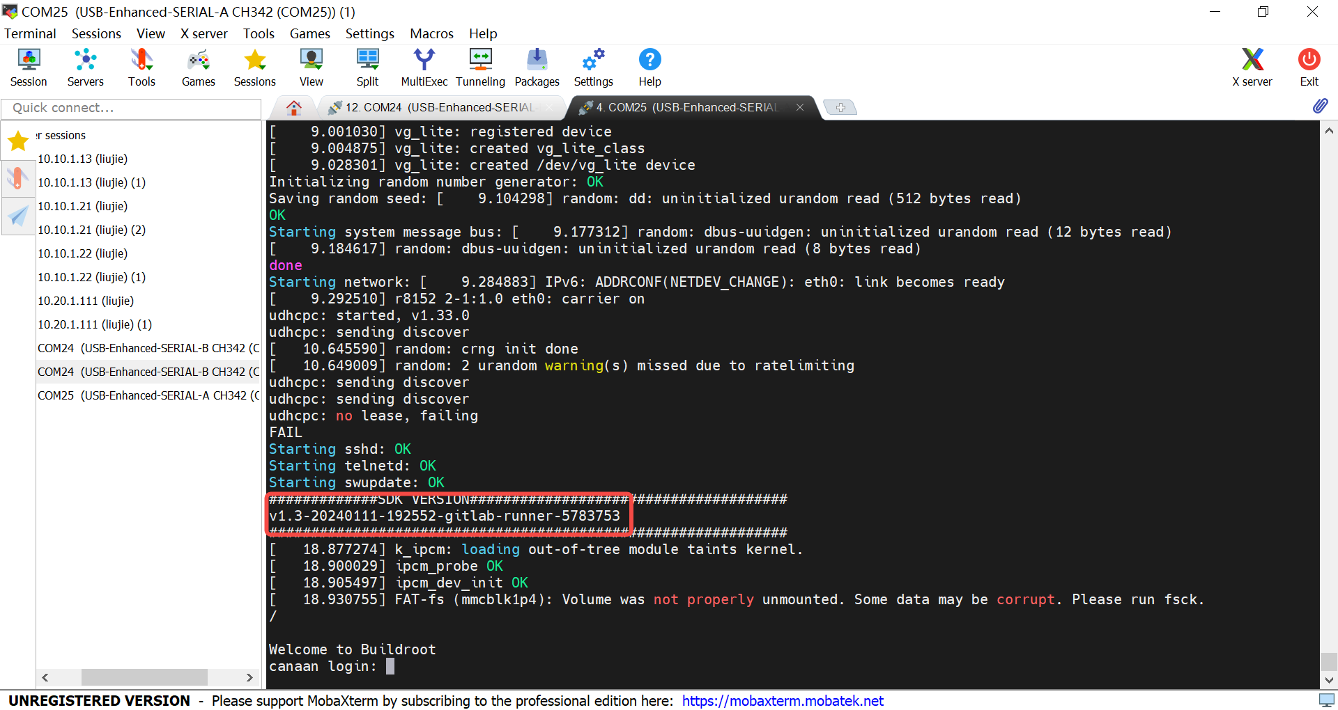

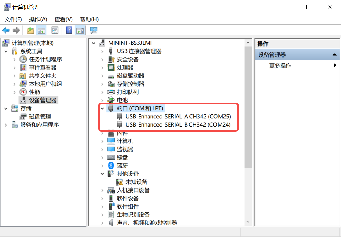

Serial Port Driver Installation and Power-On Verification#
The K230 mainboard provides two debug serial ports via USB. To use the debug serial ports on Windows, you need to install the USB-to-serial driver. Download the driver.
After installing the driver, how do you verify if the driver is installed successfully? First, connect the CanMV-K230 development board as shown in section 6.2.1.2, then connect the Type-C power cable to the PC’s USB port. You should see two USB serial devices, as shown below:

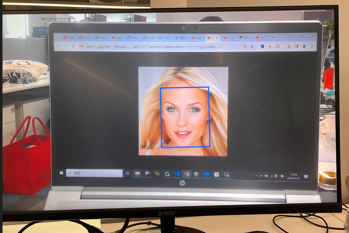

image-20240131110201060
At the same time, the monitor connected via HDMI will display the face detection results.
image-20240131112814667

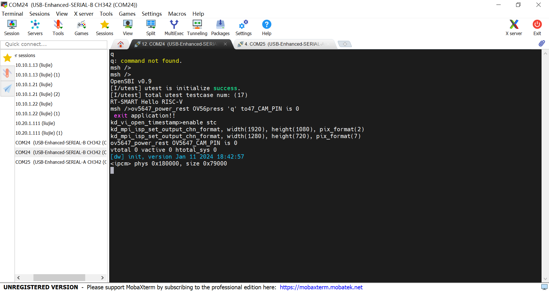

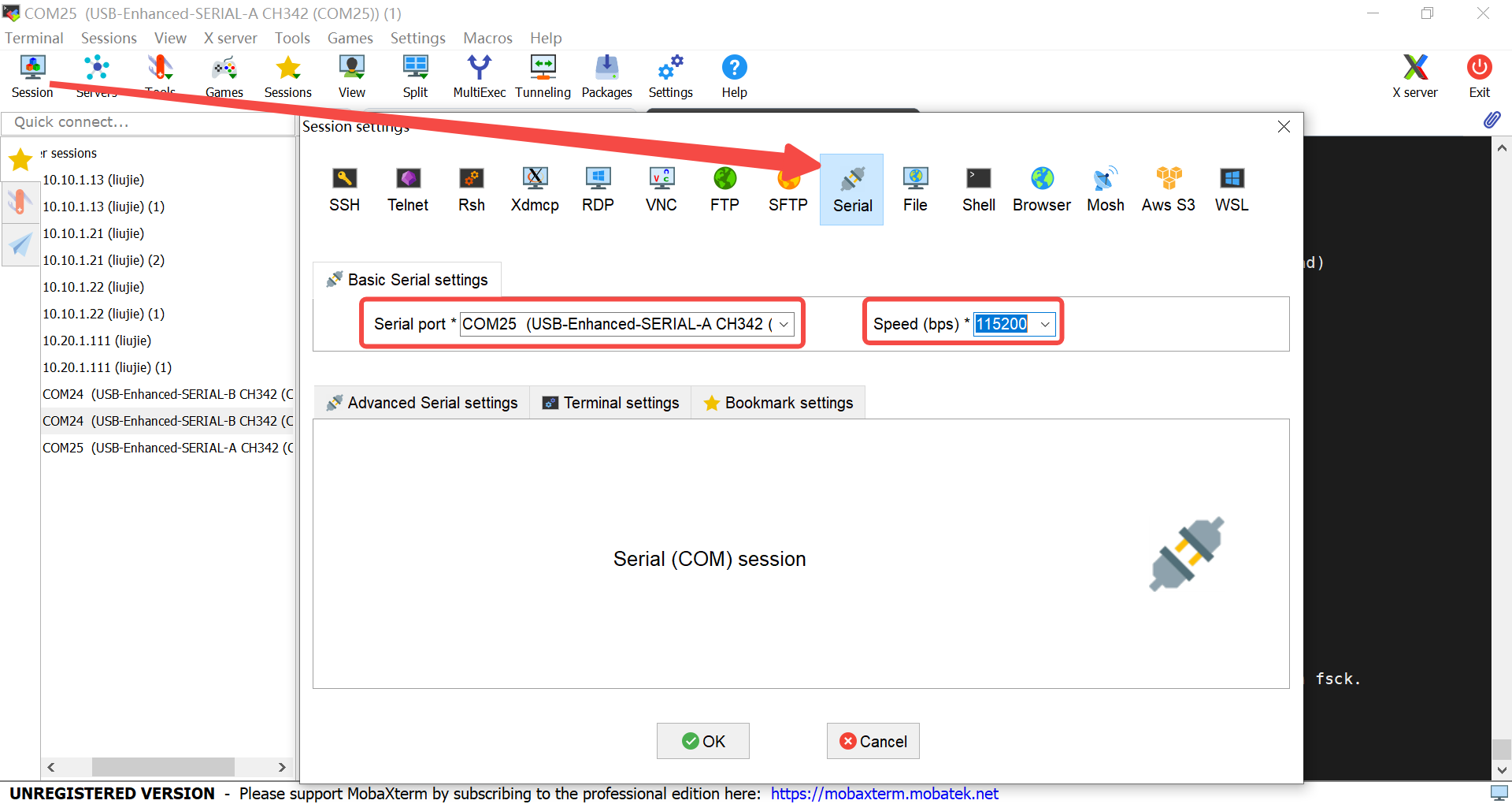

After installing the driver, download a serial port debugging tool. Install it and create a serial port session.
Connecting to the Small Core: For the AI Demo, the small core mainly handles network-related tasks.
image-20240201141045153
image-20240201141234952
Log in as root to enter the small core.
Connecting to the Big Core: The big core mainly handles AI-related tasks.
image-20240201141139709
image-20240201140752999
Press ‘q’ and Enter to exit the current face detection demo.

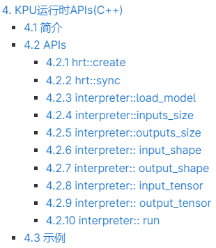

  • KPU Runtime APIs (C++): Used to load kmodel on AI devices, perform inference using KPU Runtime, obtain output data, etc., i.e., On-board inference verification.
  • AI2D Runtime APIs (C++): Used to configure AI2D parameters on AI devices, generate related register configurations, and perform AI2D calculations. Common AI2D calculations include Affine, Crop, Resize, Padding, etc., which can accelerate image preprocessing operations, i.e., On-board preprocessing.

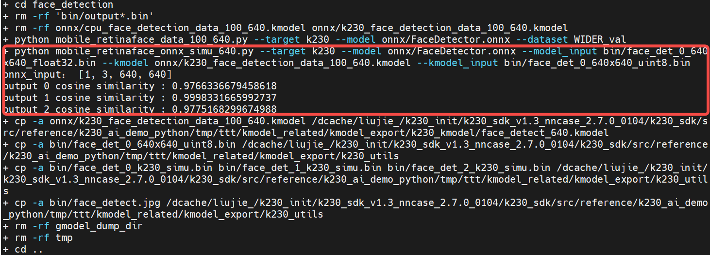

  4. Converting ONNX to kmodel:
    • Use the conversion tool supported by K230 to convert the ONNX model to the kmodel format usable by K230. This step optimizes the model to adapt to K230, generating a model that can run efficiently on K230.

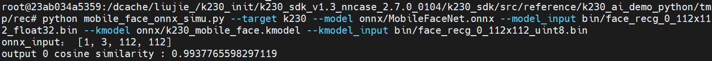

  5. Inference using K230Runtime:
    • Load the kmodel on K230 and perform inference using K230Runtime. This ensures the model’s performance on K230. The main process of K230Runtime inference includes preprocessing, running, and post-processing.

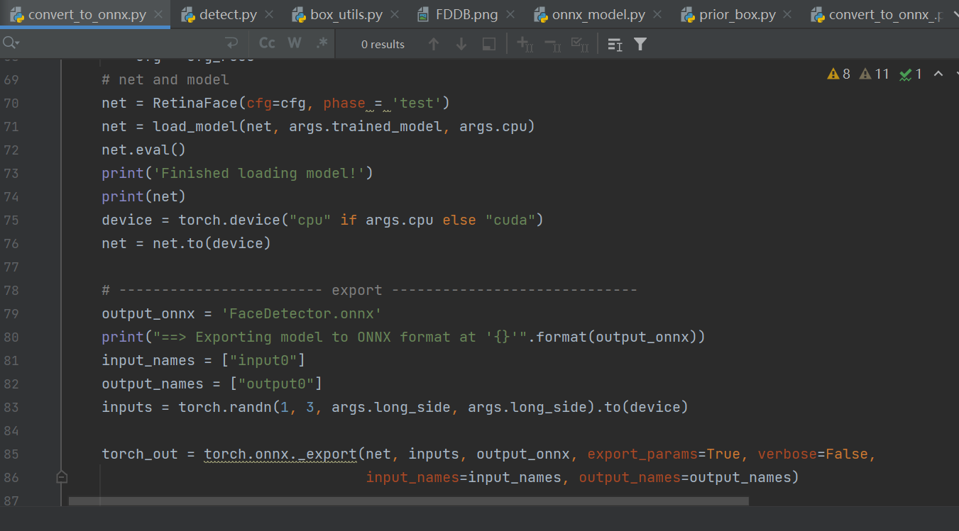

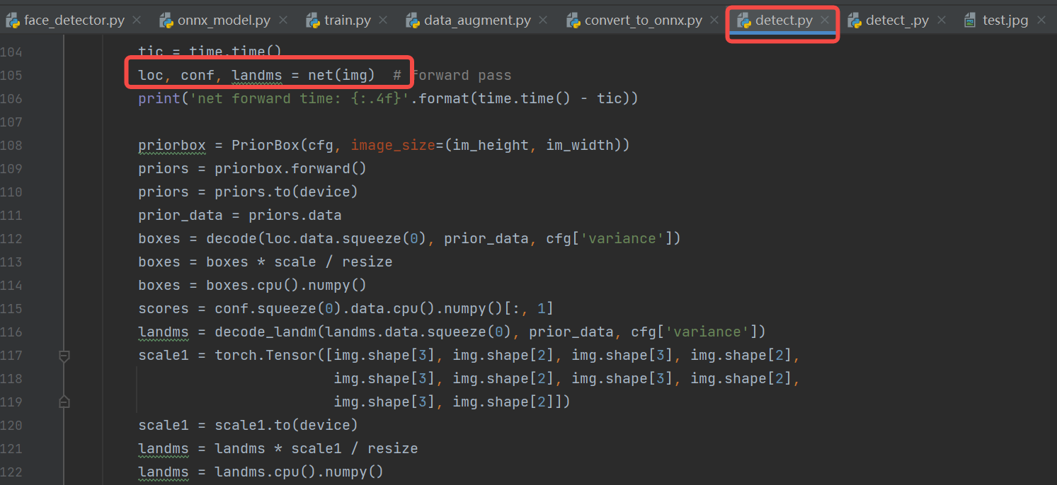

PyTorch to ONNX Conversion#

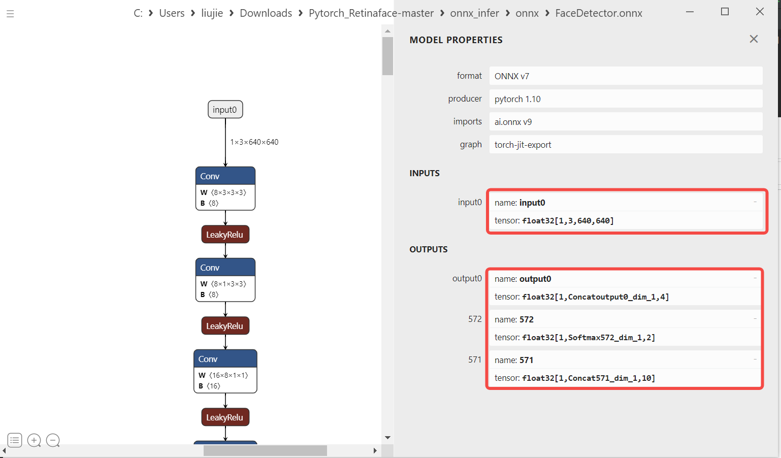

When choosing a face detection model, it is generally advisable to choose a lightweight model, with a backbone smaller than resnet50 in terms of parameters. Therefore, we choose RetinaFace based on MobileNetV1 as the face detection model.
  • Load the pth or ckpt model to the CPU
  • Construct random model input
  • Export the ONNX model
Note: Both pth and onnx support dynamic input, but K230 models currently do not support dynamic input. Therefore, when exporting ONNX, the ONNX input shape is fixed.
image-20240116180710999
Steps to execute:
Clone the code to your PC, install the dependencies, and run the script to convert to ONNX.
git clone https://github.com/JayL323/K230_AI_Demo_Development_Process_Analysis/
cd K230_AI_Demo_Development_Process_Analysis
cd onnx_related/onnx_export
git clone https://github.com/biubug6/Pytorch_Retinaface
cp face_detection_convert_to_onnx.py Pytorch_Retinaface/
cd Pytorch_Retinaface
# Download the pre-trained model according to the Pytorch_Retinaface documentation
python face_detection_convert_to_onnx.py

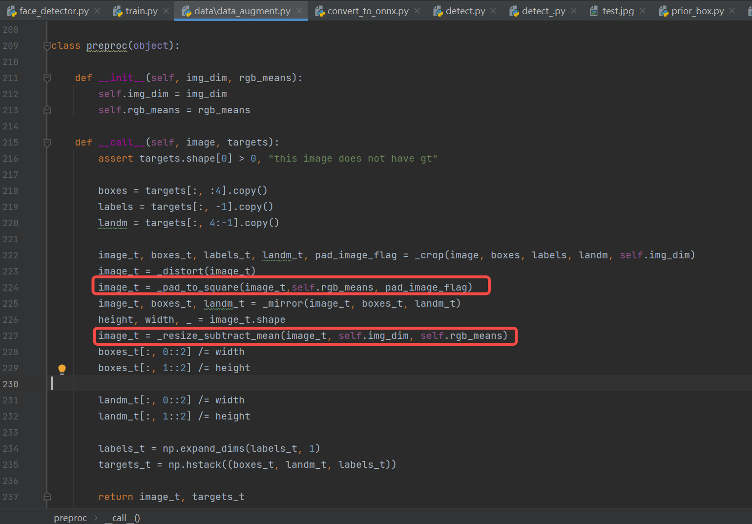

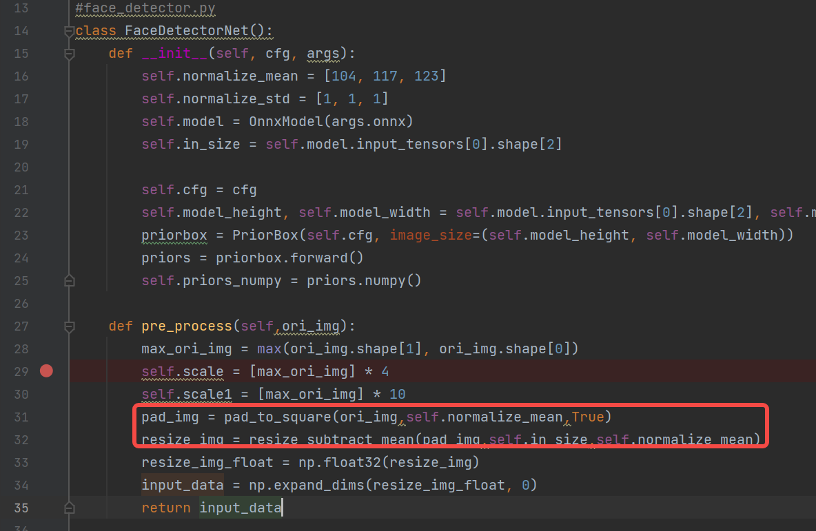

Image Preprocessing#

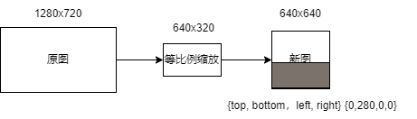

Construct preprocessing (common methods: padding_resize, crop_resize, resize, affine, normalization): refer to train.py, test.py, predict.py, and existing ONNX inference scripts.
Constructing face detection preprocessing code:
image-20240116181759199
# face_detector.py
def pre_process(self, ori_img):
    max_ori_img = max(ori_img.shape[1], ori_img.shape[0])
    self.scale = [max_ori_img] * 4
    self.scale1 = [max_ori_img] * 10
    # (1) padding: Pad the original image to a square, pad_img (1024, 1024, 3)
    pad_img = pad_to_square(ori_img, self.normalize_mean, True)
    # (2) resize + transpose + normalization: Resize the padded image to 640, convert hwc to chw, and normalize, resize_img (3, 640, 640)
    resize_img = resize_subtract_mean(pad_img, self.in_size, self.normalize_mean)
    # (3) dequantize: Convert the resized image to float32, resize_img_float (3, 640, 640)
    resize_img_float = np.float32(resize_img)
    # (4) Expand 3 dimensions to 4 dimensions: input_data (1, 3, 640, 640)
    input_data = np.expand_dims(resize_img_float, 0)
    return input_data
Reference (consistent with pth preprocessing process): The face detection preprocessing code refers to train.py (since the input shape of the K230 model currently only supports fixed input, and training is done with fixed batch input, we can refer to this). Remove unsuitable preprocessing steps for inference such as crop, distort, mirror (data augmentation), and only keep necessary preprocessing steps for ONNX inference like pad_to_square and resize_subtract_mean to ensure consistency between ONNX and pth preprocessing.
image-20240116184823495

# face_detector.py
loc, conf, landms = self.model.forward(input_data)

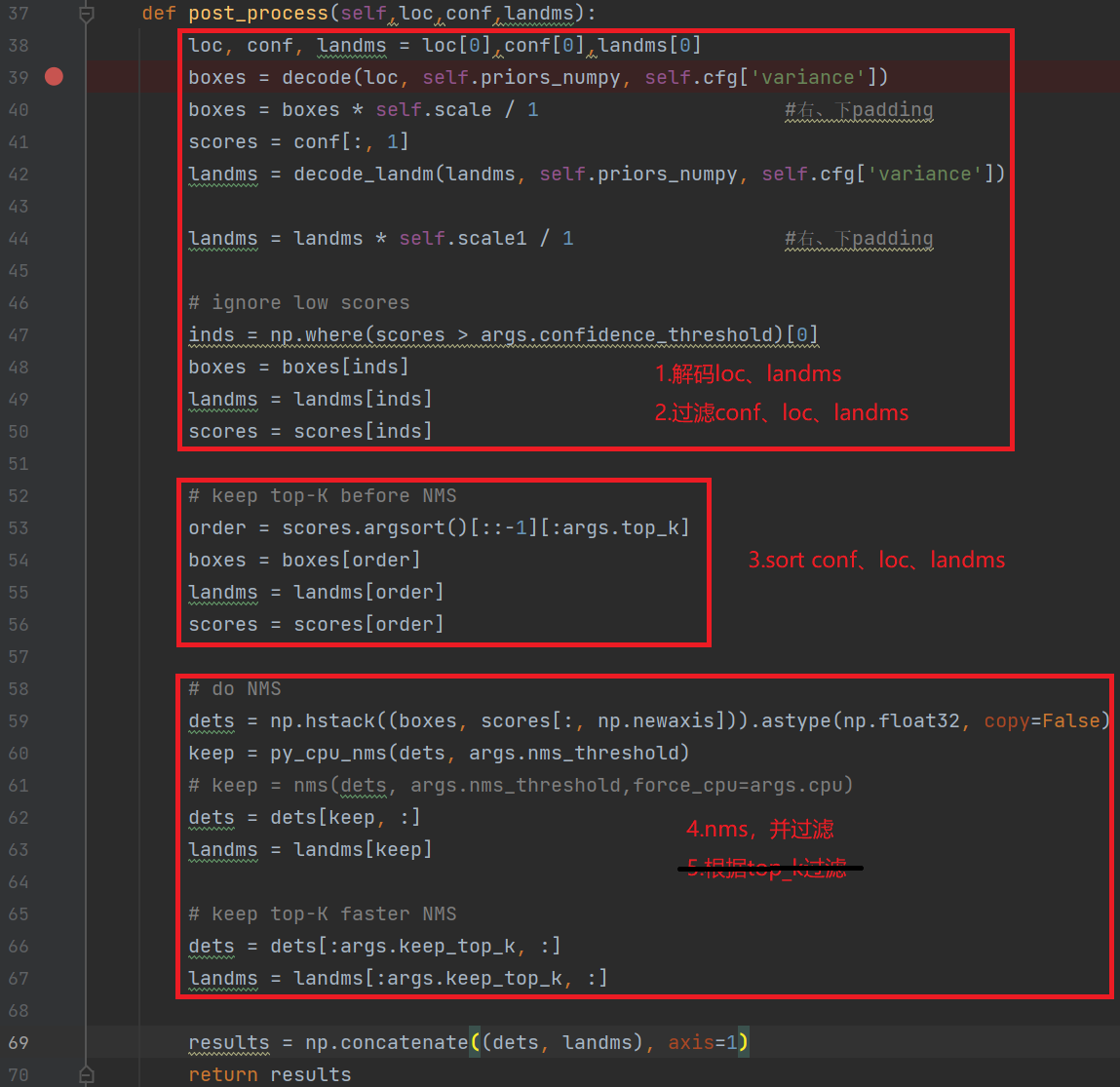

Post-processing#
Construct post-processing (common methods: softmax, loc decoding, nms, etc.): refer to test.py or predict.py and existing ONNX inference scripts.
Constructing face detection post-processing code: Includes decoding, nms, etc. Due to the extensive post-processing, we will only show a part of the code. For the complete implementation, refer to the source code.
# face_detector.py
def post_process(self, loc, conf, landms):
    loc, conf, landms = loc[0], conf[0], landms[0]
    boxes = decode(loc, self.priors_numpy, self.cfg['variance'])
    boxes = boxes * self.scale / 1  # Right, bottom padding
Reference: The detect.py script in the face detection repository processes the model outputs: loc (detection boxes), conf (scores), and landms (landmarks) to obtain the face detection boxes, scores, and key points. image-20240116190012087

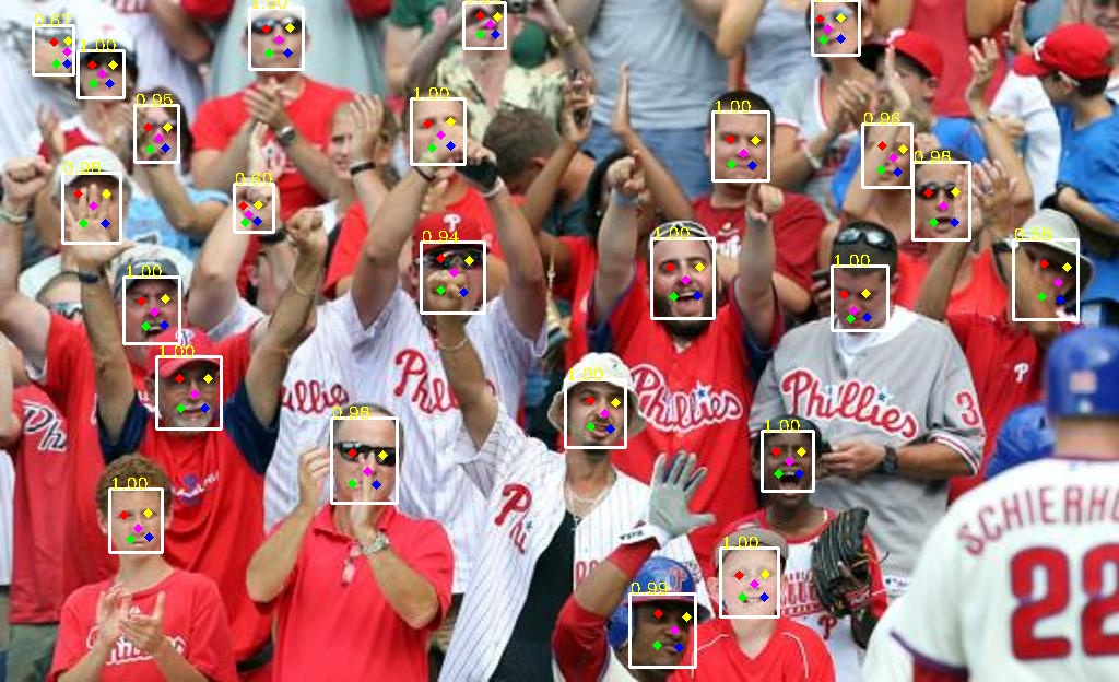

Displaying Results#
Display the results: Draw the post-processed results on the original image. For the complete implementation, refer to the source code.

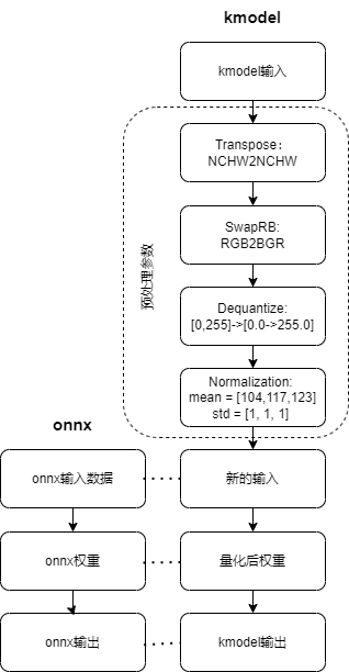

Preprocessing Parameters: Since preprocessing parameters are complex, we will focus on common preprocessing parameters.
# Enable preprocessing, default is False
(1) Preprocessing Parameters (when preprocess = False, no preprocessing is performed, kmodel ≈ onnx)
(2) Preprocessing Parameters (when preprocess = True, kmodel ≈ preprocessing + onnx, at this time kmodel includes the set preprocessing steps, which will be calculated by KPU. KPU calculations are faster, so it is better to put as much preprocessing as possible into the kmodel)
Preprocessing Operation Type
Related Parameters
Transpose
input_shape, input_layout
SwapRB
swapRB
Dequantize
input_type, input_range
Normalization
mean, std
The format of the [ONNX input data] determines the format of the [new input];
The format of the [actual input of kmodel] determines the format of the [kmodel input]; image-20240220135401913
Transpose Parameters:
# Specify the shape of the input data, the layout of input_shape needs to be consistent with input_layout
compile_options.input_shape = [1, 3, 640, 640]
# When configuring `input_layout` as a string (`"NHWC"`, `"NCHW"`), it indicates the layout of the new input data
compile_options.input_layout = "NCHW"
  • Related parameters:
    • input_shape: The shape of the input data. The layout of input_shape needs to be consistent with input_layout; must be specified when preprocess is True.
    • input_layout: Supports strings ("NHWC", "NCHW") and indices. When configured as a string ("NHWC", "NCHW"), it indicates the layout of the new input data. When configured as indices, it indicates that the input data will be transposed according to the current input_layout, i.e., input_layout is the perm parameter of the Transpose; must be specified when preprocess is True.
  • Analysis (taking string configuration format as an example):
    • The new input layout is consistent with input_layout; the new input layout is consistent with the ONNX input layout; therefore, input_layout should be consistent with the ONNX input layout.
    • When input_layout is consistent with the kmodel input layout, the kmodel input, after transposing, will remain consistent with the kmodel input layout.
    • When input_layout is inconsistent with the kmodel input layout, the kmodel input, after transposing, will become consistent with input_layout.
    • image-20240220135401914
      During actual inference, the face detection ONNX input layout is NCHW, with a shape of [1, 3, 640, 640], so input_layout = "NCHW", input_shape = [1, 3, 640, 640].
SwapRB Parameters:
compile_options.swapRB = True
    • swapRB: Whether to reverse the data in the channel dimension, default is False.
  • Analysis:
    • During actual inference, the kmodel input for face detection is rgb, while the ONNX input (new input) is bgr. Since the order is different, we need to reverse the channel dimension, hence swapRB = True.

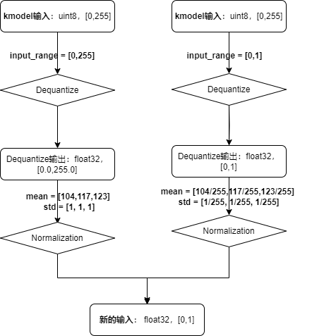

Dequantize Parameters:
# Must be specified as "uint8" or "float32" when preprocess is True
# Effective when input_type is 'uint8', specifies the range of dequantized data
    • input_type: Consistent with the actual input data type of the kmodel; must be specified as “uint8” or “float32” when preprocess is True.
    • input_range: Specifies the floating-point range of the dequantized input data; must be specified when preprocess is True and input_type is uint8.
  • Analysis:
    • If the kmodel input_type is float32, no dequantization is performed.
    • If the kmodel input_type is uint8, with a range of [0, 255], when input_range is [0, 255], dequantization only converts the data type from uint8 to float32.
    • If the kmodel input_type is uint8, with a range of [0, 255], when input_range is [0, 1], dequantization converts the fixed-point data to floating-point data in the range [0.0, 1.0].
    • During actual inference, the kmodel input for face detection is obtained from the sensor, with a data type of uint8, so input_type = 'uint8', input_range = [0, 255] or [0, 1] can be used.
Normalization Parameters:
    • mean: Mean value for normalization, default is [0, 0, 0].
    • std: Standard deviation for normalization, default is [1, 1, 1].
  • image-20240220135401915
  • During actual inference, the ONNX mean for face detection is mean = [104, 117, 123], std = [1, 1, 1]. Clearly, the left-hand settings in the image are more concise. The kmodel for face detection has input_range = [0, 255], mean = [104, 117, 123], std = [1, 1, 1].

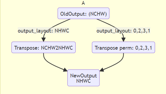

Post-processing Parameters:
# Post-processing
compile_options.output_layout = "NCHW"
    • output_layout: Specifies the layout of the output data, such as ‘NCHW’, ‘NHWC’. Default is “”, meaning no transpose is performed.
Similar to the input_layout preprocessing parameter, if the model’s own output layout (oldKmodelOutput) is the same as output_layout, then after transposing, the newKmodelOutput layout will still be consistent with the oldKmodelOutput layout. If the model’s own output layout (oldKmodelOutput) is different from output_layout, then after transposing, the newKmodelOutput layout will become consistent with output_layout.
image-20240304191018189

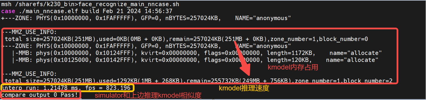

Inference Using K230Runtime#

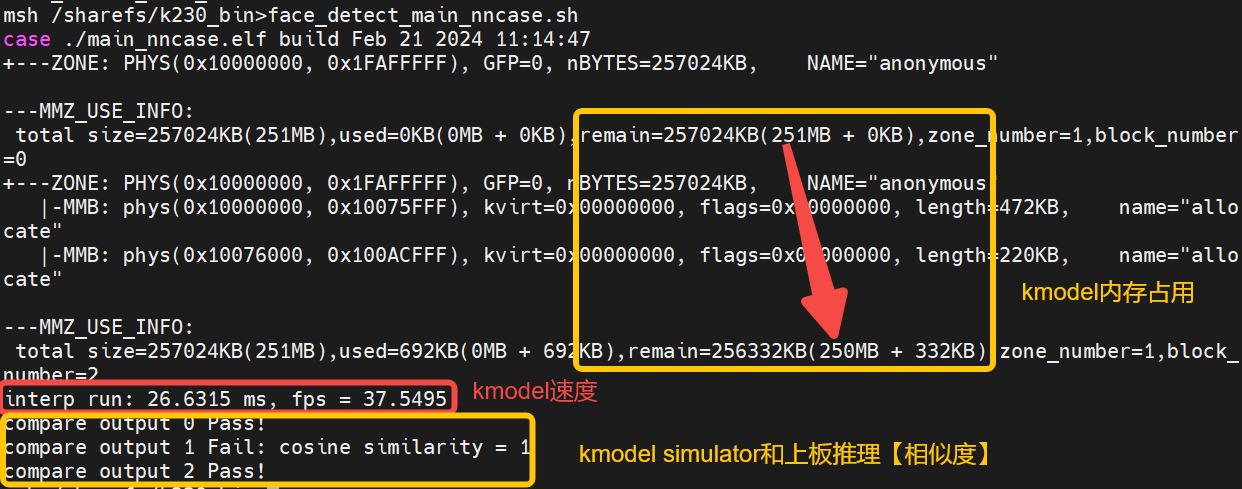

To verify the correctness of the kmodel, we need to perform inference using K230Runtime, ensuring that the processes of reading images, preprocessing, running, post-processing, and displaying results are consistent with the corresponding processes for ONNX. onnx2kmodel.png
Due to the complexity of debugging the K230 development board, we provide some auxiliary tools and share relevant experiences to help users verify the correctness of K230-side inference. Since the main parts of the inference process are run, preprocessing, and post-processing, we will explain the common debugging methods for these three parts separately.
Run:
  • Simulator: Simulates the kmodel inference process on K230 on a PC to compare whether the kmodel and ONNX outputs are consistent.
  • main_nncase: Performs kmodel inference on K230 to compare whether the simulated kmodel inference results are consistent with the actual kmodel inference results.
  • If both are correct, it indicates that the generated kmodel is correct.

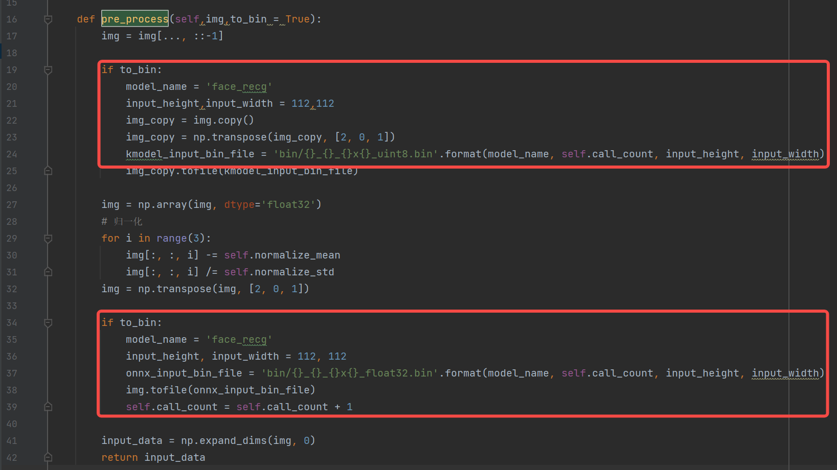

Note: Since the generated kmodel includes partial preprocessing, the preprocessing required to generate kmodel_input.bin ≈ the preprocessing required to generate onnx_input.bin - the preprocessing included in the kmodel (the preprocessing in the face detection kmodel includes transpose, dequantize, normalization, swapRB).
(1) Dimension expansion can be omitted (the bin file can be reshaped during reading, and dimension expansion can be omitted during generation).
(2) Why is dequantize and normalization not required for kmodel_input.bin? Because dequantize and normalization are already included in the kmodel.
(3) Why is bgr -> rgb required for kmodel_input.bin? When generating the face detection kmodel, the swapRB switch was turned on for preprocessing to convert rgb to bgr. Correspondingly, when generating kmodel_input.bin, the data needs to be converted to rgb order first.
(4) Transpose is also included in the kmodel, so why is transpose still needed for kmodel_input.bin? Because when generating the kmodel, if the preprocessing switch is turned on, the transpose-related parameters must be set. The actual input of our face detection kmodel is NCHW, and input_layout is set to NCHW, both are consistent. Therefore, transpose is NCHW2NCHW, and there is no actual conversion.

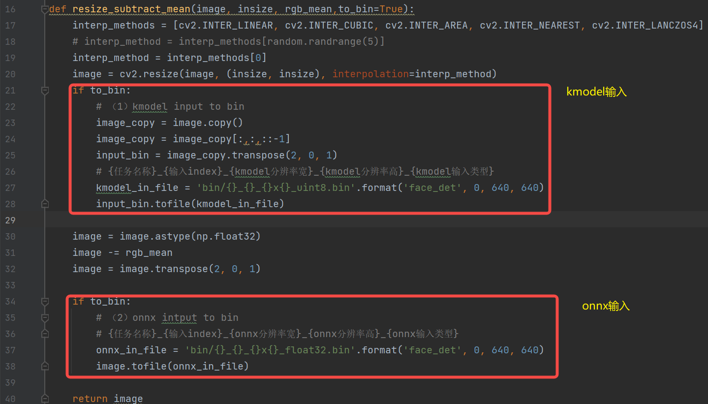

Process of generating input.bin: (placed in the preprocessing method of ONNX inference)

  • Calculate the cosine similarity between cpu_results and nncase_results to determine whether the generated kmodel is correct based on the similarity.

        # print("nncase_result:", nncase_result)
        input_bin_file = 'bin/face_det_{}_{}_simu.bin'.format(i, args.target)
        nncase_result.tofile(input_bin_file)
    # Calculate the similarity between ONNX and Simulator
if __name__ == '__main__':
    main()
The above script can meet the verification needs for most ONNX and their kmodels without much modification. Just modify the input_shape according to the actual input size of the model.
python mobile_retinaface_onnx_simu_640.py \
        --target k230 --model onnx/FaceDetector.onnx \
        --model_input bin/face_det_0_640x640_float32.bin \
        --kmodel onnx/k230_face_detection_data_100_640.kmodel \
        --kmodel_input bin/face_det_0_640x640_uint8.bin
# If you have already downloaded the code, ignore the clone step
cd kmodel_related/kmodel_export
./build_model.sh
The higher the cosine similarity between ONNX and Simulator, the better. Generally, a similarity above 0.99 is acceptable. If it is below 0.99 but above 0.95, further on-board verification can be used to determine whether the generated kmodel meets the actual requirements.

Note: When running the simulator, you must first add the following environment variables (included in the build_model.sh file):
export NNCASE_PLUGIN_PATH=$NNCASE_PLUGIN_PATH:/usr/local/lib/python3.8/dist-packages/
export PATH=$PATH:/usr/local/lib/python3.8/dist-packages/
source /etc/profile
Using main_nncase to Verify kmodel#
Generally, the kmodel inference results from the Simulator and actual on-board inference are consistent, but there may be some differences in certain cases. To verify whether they are consistent, the main_nncase tool is used to assist in verifying whether the kmodel inference results from the Simulator and actual on-board inference are consistent. This tool requires calling the nncase KPU Runtime APIs (C++).
The KPU Runtime APIs provide various interfaces for kmodel on-board inference, as shown below. If you cannot see the K230_nncase_Development_Guide.md document structure on GitHub, you can download it locally and open it with the Typora tool.

./main_nncase.elf face_detect_640.kmodel face_det_0_640x640_uint8.bin face_det_0_k230_simu.bin face_det_1_k230_simu.bin face_det_2_k230_simu.bin
image-20240221112222263
From the execution results, we can observe:
  • Memory usage of the face detection kmodel: approximately 1MB
  • Inference speed of the face detection kmodel: 26.6ms
  • Similarity between Simulator and on-board inference for face detection: Outputs 0 and 2 pass with byte-level exact match; output 1 fails but has a cosine similarity of 1 at the float level. Generally, a similarity above 0.99 is acceptable.
The face detection simulator results roughly meet the requirements, and the main_nncase results also meet the requirements, so the generated face detection kmodel is likely correct.

image-20240222134841039
Face Detection Preprocessing:
Background Knowledge: The ai2d_builder_ can be called repeatedly if the parameters remain unchanged; if the parameters change, a new ai2d_builder_ needs to be created.
For image preprocessing: Since the sizes of different images are different, for the padding_resize method, the AI2D parameters will change each time, and a new ai2d_builder_ needs to be created using Utils::padding_resize_one_side for preprocessing.
For video stream preprocessing: Since the sizes of different frames are the same, the padding values do not change. Therefore, for the padding_resize method, the AI2D parameters remain unchanged, and after copying the new frame image to ai2d_in_tensor_, only ai2d_builder_->invoke needs to be called (the ai2d_builder_ is already constructed in the face detection constructor).

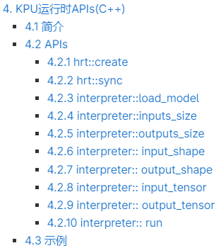

(1) Introduction to AIBase: AIBase mainly encapsulates KPU-related operations, including loading kmodel on AI devices (such as K230), setting kmodel input data, executing KPU/CPU calculations, and obtaining kmodel output data. The encapsulation of AIBase simplifies the KPU calling process.
(2) kmodel Inference Example (main_nncase modified to be based on the AIBase class): test_aibase demo.
KPU Runtime APIs interface is shown below. For details, please refer to K230_nncase_Development Guide.md. If you cannot see the K230_nncase_Development Guide.md document structure on GitHub, you can download it locally and open it with the Typora tool.

Post-processing#
ONNX Post-processing: image-20240223153101754.png
C++ Post-processing (details in the code):
// face_detection.cc
void FaceDetection::post_process(FrameSize frame_size, vector<FaceDetectionInfo> &results)
    if (debug_mode_ > 3)
        // Verify if the post-processing flow is correct: Exclude preprocessing and model inference, directly use Simulator kmodel data to check the correctness of the post-processing code.
    else
        filter_confs(p_outputs_[1]);
        filter_locs(p_outputs_[0]);
        filter_landms(p_outputs_[2]);
    std::sort(confs_.begin(), confs_.end(), nms_comparator);
    nms(results);
    transform_result_to_src_size(frame_size, results);
ONNX Post-processing Flow
kmodel Post-processing Flow
1. Decode loc, landms
1. Filter conf, loc, landms (magnitude: 16800 -> hundreds)
2. Filter conf, loc, landms
2. Sort conf, loc, landms based on conf (reduce sorting time)
3. Sort conf, loc, landms based on conf
3. nms + Decode loc, landms
4. nms
4. Transform face detection results to original image size
5. top_k
The adjusted kmodel inference flow is more suitable for C++ code.

  • (1) Verify if preprocessing is correct
Set debug_mode to 2 to save the preprocessed image.
# The large and small cores share /sharefs/
# On the small core
cd /sharefs/
# Example: Replace the source directory with your own directory during actual execution
scp liujie@10.10.1.22:/xxx/k230_bin /sharefs/
# On the large core (if just started, press q+Enter to exit the auto-start program)
cd /sharefs/k230_bin/face_detect
./face_detection.elf face_detect_640.kmodel 0.5 0.2 face_detect.jpg 2
# On the small core
scp FaceDetection_input_padding.png username@ip:dir
The FaceDetection_input_padding.png will be generated. Copy it to the PC to check if the preprocessing code is correct. If there is an issue, check if the original sensor image is correct and if the preprocessing parameters are set correctly.
  • (2) Verify if post-processing is correct
Set debug_mode to 3 to verify if post-processing is correct.
# On the small core
cd /sharefs/
# On the large core (press q+Enter to exit the auto-start program)
./face_detection.elf face_detect_640.kmodel 0.5 0.2 face_detect.jpg 3
# On the small core
scp face_detection_result.jpg username@ip:dir
The face_detection_result.jpg will be generated. Copy it to the PC to check if the post-processing code is correct. If it is incorrect, carefully check the post-processing part of the code and print debug information.
  • (3) Execution On the large core, execute face_detect_isp.sh to run the inference process based on the video stream.
# On the large core
./face_detect_isp.sh

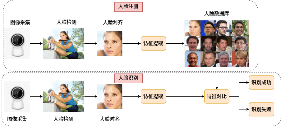

Face Recognition Demo#
Face recognition is a widely used facial task that compares the current face with a known face identity database to determine if the current face is recognized. Face recognition generally includes 2 steps: face registration and face recognition. Face registration is used to build a face database, and face recognition is used to recognize faces present in the database. Face Registration: Image collection -> Face localization -> Face alignment -> Feature extraction -> Database saving Face Recognition: Image collection -> Face localization -> Face alignment -> Feature extraction -> Feature comparison -> Provide recognition results Face Alignment: For an image, the face detection model outputs the face bounding box coordinates and 5 facial key points. Before face recognition, the detected face box needs to be aligned; that is, the face is rectified in the 2D plane to reduce the differences caused by face rotation, facilitating more accurate subsequent face recognition.

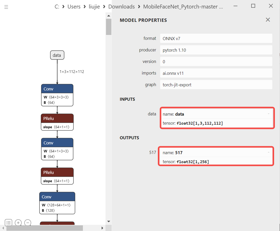

When choosing a face recognition model, it is generally advisable to choose a lightweight model, with a backbone smaller than resnet50 in terms of parameters. Therefore, we choose MobileFaceNet, which is based on MobileNet and has high accuracy, as our face recognition model. Reference link: Xiaoccer/MobileFaceNet_Pytorch
# convert_to_onnx.py
import numpy as np
import torch
from core import model               # Varies by model
def convert_onnx(net, path_module, output, opset=11):
    assert isinstance(net, torch.nn.Module)
    img = np.random.randint(0, 255, size=(112, 112, 3), dtype=np.int32)
    img = img.astype(np.float)
    img = (img / 255. - 0.5) / 0.5  # torch style norm
    img = img.transpose((2, 0, 1))
    img = torch.from_numpy(img).unsqueeze(0).float()
    ckpt = torch.load(path_module, map_location='cpu')
    net.load_state_dict(ckpt['net_state_dict'], strict=True)
    net.eval()
    torch.onnx.export(net, img, output, input_names=["data"], keep_initializers_as_inputs=False, verbose=False,
                      opset_version=opset)
    net = model.MobileFacenet()
    input_file = 'model/best/068.ckpt'
    output_file = 'model/best/MobileFaceNet.onnx'
    convert_onnx(net, input_file, output_file)

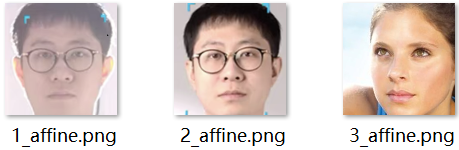

Face Alignment#
Common face recognition training sets include MS1MV2, MS1MV3, Glint360K. Creating these datasets generally requires preprocessing the full-face original images, i.e., performing face detection first, then aligning each face, and finally saving the aligned face images.
Face Alignment: For an image, the face detection model outputs the face bounding box coordinates and 5 facial key points. Before face recognition, the detected face needs to be aligned; that is, the face is rectified in the 2D plane to reduce the differences caused by face rotation, facilitating more accurate subsequent face recognition.
x.png: Original image, x_affine.png: Aligned face
image-20240226154210101

# mobile_face_net.py: MobileFaceNet
def pre_process(self, img, to_bin=True):
    # bgr->rgb, uint8, (112,112,3)
    img = img[..., ::-1]
    # Dequantize, float32, (112,112,3)
    img = np.array(img, dtype='float32')
    # Normalization, float32, (112,112,3)
    for i in range(3):
        img[:, :, i] -= self.normalize_mean
        img[:, :, i] /= self.normalize_std
    # transpose, hcw->chw, float32, (3,112,112)
    img = np.transpose(img, [2, 0, 1])
    # Expand 3 dimensions to 4 dimensions, input_data, float32, (1,3,112,112)
    input_data = np.expand_dims(img, 0)
    return input_data

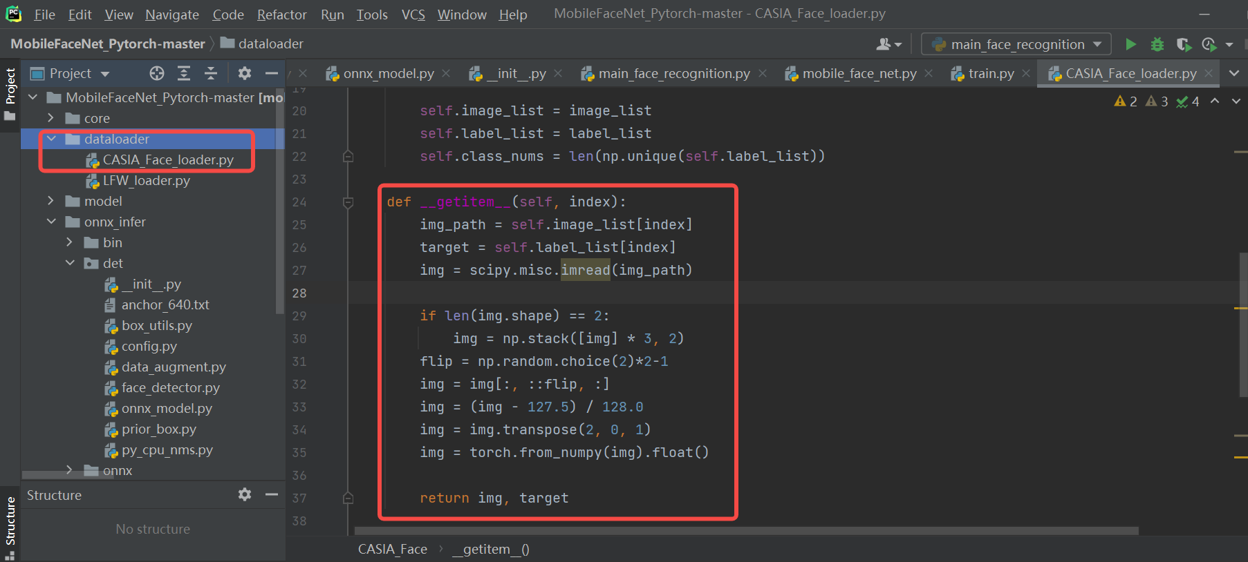

Reference: The face recognition preprocessing code refers to the dataloader called in train.py, removing the flip (data augmentation) that is not suitable for inference, and only keeping the necessary preprocessing steps for ONNX inference: bgr->rgb (scipy.misc.imread reads images in RGB format), Normalization (subtract mean and divide by std), hwc->chw (transpose).

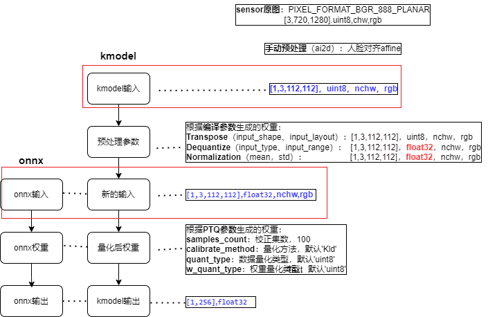

Generate input.bin#
Before using the simulator to verify the kmodel, you need to prepare the input file. Since the kmodel includes partial preprocessing, for the same image, you need to use different preprocessing to generate different onnx_input.bin and kmodel_input.bin.
Name
onnx_input.bin Construction Process
kmodel_input.bin Construction Process
Source -> Target
(uint8, hwc, bgr -> float32, nchw, bgr)
(uint8, hwc, bgr -> uint8, nchw, rgb)
Original Image
(112, 112, 3), uint8, hwc, bgr
bgr -> rgb
(112, 112, 3), uint8, hwc, rgb
Dequantize
(112, 112, 3), float32, hwc, rgb
Normalization
Transpose
(3, 112, 112), float32, chw, rgb
(3, 112, 112), uint8, chw, rgb
Dimension Expansion (optional)
(1, 3, 112, 112), float32, chw, rgb
(1, 3, 112, 112), uint8, chw, rgb
Note: The generated kmodel includes partial preprocessing, so the preprocessing required to generate kmodel_input.bin ≈ the preprocessing required to generate onnx_input.bin - the preprocessing included in the kmodel (the preprocessing in the face recognition kmodel includes transpose, dequantize, normalization)
(2) Why is transpose still needed for generating kmodel_input.bin even though it is included in the kmodel? When generating the kmodel, if the preprocessing switch is turned on, the transpose-related parameters must be set. The actual input of our face recognition kmodel is NCHW, and the input_layout is set to NCHW, both are consistent. Therefore, transpose is NCHW2NCHW, and there is no actual conversion.

Generally, the higher the cosine similarity between ONNX and Simulator, the better. A similarity above 0.99 is usually acceptable. If it is below 0.99 but above 0.96, you can further verify the generated kmodel through on-board inference verification to see if it meets the actual performance requirements.
image-20240226175528723
image image-20240221141307953
main_nncase Verification Process:
  • Load the kmodel
  • Set kmodel input: read the kmodel_input.bin file
  • Set kmodel output
  • Run the kmodel
  • Get kmodel output
  • Compare the similarity between Simulator inferred kmodel and on-board inferred kmodel results

./main_nncase.elf face_recognize.kmodel face_recg_0_112x112_uint8.bin face_recg_0_k230_simu.bin
image-20240226185940457
  • Memory usage of the face recognition kmodel: approximately 2MB
  • Inference speed of the face recognition kmodel: 1.21ms
  • Similarity between Simulator and on-board inference for face recognition: Outputs are completely consistent (byte-level consistency)

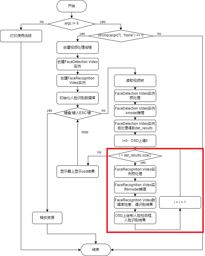

Overall Process:
Recognition Process: image-20240226185940458.png
face_recognition code. This code only supports the development boards CanMV-K230-V1.0 and CanMV-K230-V2.0. For other models of CanMV-K230 development boards, you can use the latest vi_vo.h to replace the current repo vi_vo.h.
├── ai_base.cc                  # AI base class, encapsulates KPU runtime APIs, simplifies kmodel-related operations
├── ai_base.h
├── anchors_640.cc              # Anchors for face detection with 640 resolution input
├── CMakeLists.txt
├── face_detection.cc           # Face detection, preprocessing, kmodel inference, post-processing
├── face_detection.h
├── face_recognition.cc         # Face recognition, preprocessing, kmodel inference, database comparison
├── face_recognition.h
├── main.cc                     # Main process of face recognition demo
├── README.md
├── scoped_timing.hpp           # Timing class
├── utils.cc                    # Utility class, encapsulates common functions and AI2D runtime APIs, simplifies preprocessing operations
├── utils.h
└── vi_vo.h                     # Encapsulates sensor and display operations

Background Knowledge: If the parameters remain unchanged, ai2d_builder_ can be called repeatedly; if the parameters change, a new ai2d_builder_ needs to be created.
Face Recognition Image Preprocessing: Since the positions of facial key points in the input face are different, the calculated affine transformation will also be different. When performing face alignment (affine), the generated affine transformation needs to be used as a parameter to set AI2D. AI2D parameters will change each time, and a new ai2d_builder_ needs to be created using Utils::affine for preprocessing.
Face Recognition Video Stream Preprocessing: Similarly, since the positions of facial key points in different frames are different, a new ai2d_builder_ needs to be created using Utils::affine for preprocessing.

The method to obtain sparse_points (facial key points): Perform face detection first, and the face detection result contains sparse_points.

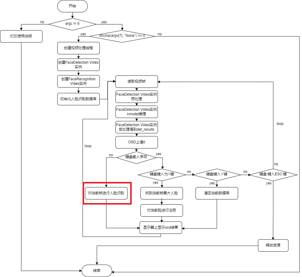

// main.cc
// Face detection and face recognition instances share the same memory address vaddr
FaceDetection face_det(argv[1], atof(argv[2]), atof(argv[3]), {SENSOR_CHANNEL, SENSOR_HEIGHT, SENSOR_WIDTH}, reinterpret_cast<uintptr_t>(vaddr), reinterpret_cast<uintptr_t>(paddr), atoi(argv[8]));
FaceRecognition face_recg(argv[4], atoi(argv[5]), recg_thres, {SENSOR_CHANNEL, SENSOR_HEIGHT, SENSOR_WIDTH}, reinterpret_cast<uintptr_t>(vaddr), reinterpret_cast<uintptr_t>(paddr), atoi(argv[8]));
// Each time a frame is read from the sensor, the data is copied to vaddr
while (!isp_stop)
        ScopedTiming st("read capture", atoi(argv[8]));
        if (ret)
            continue;
        // Copy data read from the sensor to vaddr
        ScopedTiming st("isp copy", atoi(argv[8]));
        memcpy(vaddr, (void *)vbvaddr, SENSOR_HEIGHT * SENSOR_WIDTH * 3);  // This can be removed later, no need to copy
    det_results.clear();
    // Copy vaddr data to face detection ai2d input, preprocess it, and the preprocessing result will be stored in the ai2d output; ai2d output actually points to the face detection kmodel input
    face_det.pre_process();
    face_det.inference();
    face_det.post_process({SENSOR_WIDTH, SENSOR_HEIGHT}, det_results);
    for (int i = 0; i < det_results.size(); ++i)
        // ***for face recg***
        // Copy vaddr data to face recognition ai2d input, preprocess it, and the preprocessing result will be stored in the ai2d output; ai2d output actually points to the face recognition kmodel input
        face_recg.pre_process(det_results[i].sparse_kps.points);
        face_recg.inference();
        FaceRecognitionInfo recg_result;
        face_recg.database_search(recg_result);
        face_recg.draw_result(osd_frame, det_results[i].bbox, recg_result, false);
        ScopedTiming st("osd copy", atoi(argv[8]));
        // Insert frame into display channel
        kd_mpi_vo_chn_insert_frame(osd_id + 3, &vf_info); // K_VO_OSD0
        if (ret)
kmodel Run#

// main.cc, verify if kmodel inference is correct: we have already verified using simulator and main_nncase
# On the small core
cd /sharefs/
cd /sharefs/k230_bin/face_recognize
./face_recognition.elf face_detect_640.kmodel 0.6 0.2 face_recognize.kmodel 100 75 None 2 db
# On the small core
scp FaceRecognition_input_affine.png username@ip:dir
The FaceRecognition_input_affine.png will be generated. Copy it to the PC to check if the preprocessing code is correct. If there is an issue, check if the original sensor image is correct and if the preprocessing parameters are set correctly. FaceRecognition_input_affine.png

  • (3) Execution
On the large core, execute face_recognize_isp.sh to run the inference process based on the video stream.
# On the large core
./face_recognize_isp.sh
# Press 'i' to start registering the largest face in the current frame, and enter the name of the registered face, e.g., aaa
# From the next frame, registered faces can be recognized
# Press 'Esc' to stop the current inference program

Technique 1: target = ‘cpu’#
If target = 'k230', generate the kmodel, and find that the kmodel inference result is incorrect, what should you do?
compile_options.target = 'k230'
ptq_options.samples_count = 100
compiler.use_ptq(ptq_options)
Modify the target setting to target = 'cpu', regenerate cpu_xxx.kmodel. The generated kmodel will not be quantized. If the cpu_xxx.kmodel inference is correct but the k230_xxx.kmodel inference is incorrect, it indicates that the kmodel parsing is correct and the issue is related to quantization. You can check the number of calibration sets (too few?), the content of the calibration set (whether the format of generate_data matches the actual kmodel input), and modify the quantization method and type to correct it.

Technique 3: Generating input.bin#
When generating the kmodel, if the preprocessing parameter is set to True, you can simply think of it as:
kmodel ≈ configured kmodel preprocessing + onnx;
For the same image, the preprocessing required for kmodel input ≈ the preprocessing required for onnx input - configured kmodel preprocessing; that is, kmodel_input.bin ≈ onnx_input.bin - configured kmodel preprocessing.
