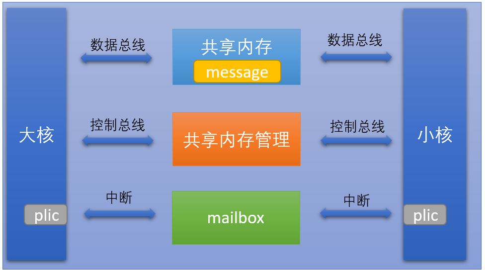

Inter-Core Communication Implementation Principle#
Shared memory is used for the specific content of communication messages sent by large and small cores.
Shared memory management is used to identify the attributes of communication messages such as address, size, port number, etc.
Mailbox realizes the notification mechanism after large and small cores send messages through interrupts.
