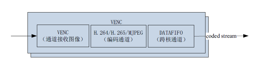

Encoding Channel#
The encoding channel serves as the basic container, storing various user settings and managing various internal resources of the encoding channel. The encoding channel completes the functions of image overlay and encoding. The 2D module performs image overlay computation, and the encoder module performs image encoding. Both can be used separately or in conjunction.
Figure 1-2 Encoding Channel

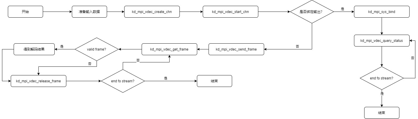

VDEC supports streaming mode:
Streaming Mode (K_VDEC_SEND_MODE_STREAM): Users can send any length of code stream to the decoder each time, and the decoder will internally complete the identification process of one frame of the code stream. Note that for H.264/H.265, the end of the current frame code stream can only be identified after receiving the next frame code stream, so in this sending mode, if you input one frame of H.264/H.265 code stream, you cannot expect the image decoding to start immediately.
Typical Decoding Application Example#
Figure 1-3 Typical Encoding Application Scenario Flow Diagram

Video Encoding#
MAPI is called on the small core to obtain VENC stream data.
Encoding Data Flow Diagram#
Figure 4-1
A typical encoding process includes receiving input images, encoding the images, cross-core data stream transmission, and stream output.
The encoding module (VENC) in the above figure consists of the VENC receiving channel, encoding channel, 2D receiving channel, and 2D operation module. For details, see [1.2.1 Video Encoding](#Video Encoding).
