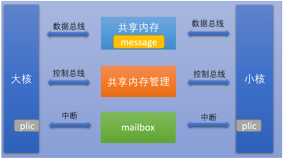

1.1.1 Inter-Core Communication Implementation Principle#
Schedule Low Confidence Description Automatically Generated
  • Shared memory is used for the specific content of communication messages sent by large and small cores.
  • Shared memory management is used to identify the attributes of communication messages such as address, size, port number, etc.
  • Mailbox realizes the notification mechanism after large and small cores send messages through interrupts.
