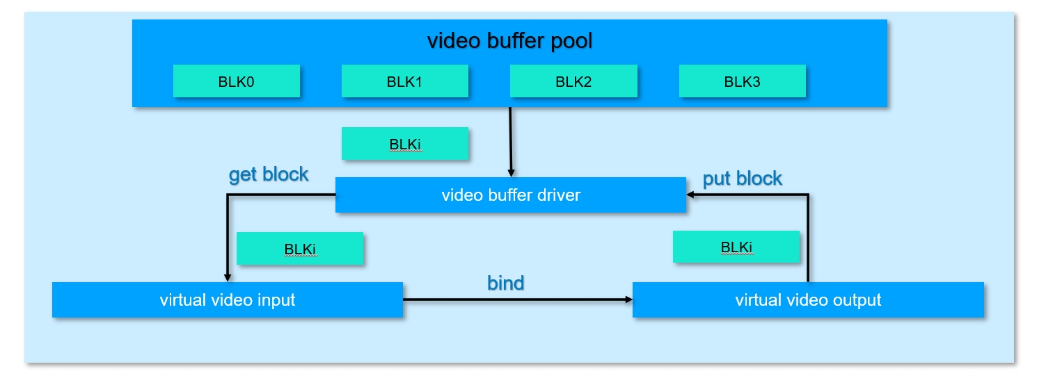

1.2.1 Video Buffer Pool#
The video buffer pool is a group of buffers (not just one), mainly provided for use by multimedia hardware devices and circulated between these devices. The buffer pool is divided into public and private buffer pools. The public buffer pool is mainly for VI, and the size of the buffer blocks must be determined according to the image parameters of VI before using it, and then a certain number of buffer blocks are applied for to form a buffer pool. Generally, for the original image input by VI, the size of one frame corresponds to the size of one buffer block, and multiple buffer blocks provide a multi-frame buffering mechanism for VI. These public buffer blocks can also be used by VO or VENC. Private buffer pools often represent data stored in memory that is closely related to the multimedia device itself. For example, the encoded bitstream data is quite different from the actual image pixel composition of the video stream. These bitstreams are only available to the codec, and VB provides dedicated buffer pools for these devices. The following diagram shows the process of virtual VI and virtual VO using VB to circulate buffer blocks.
Diagram
