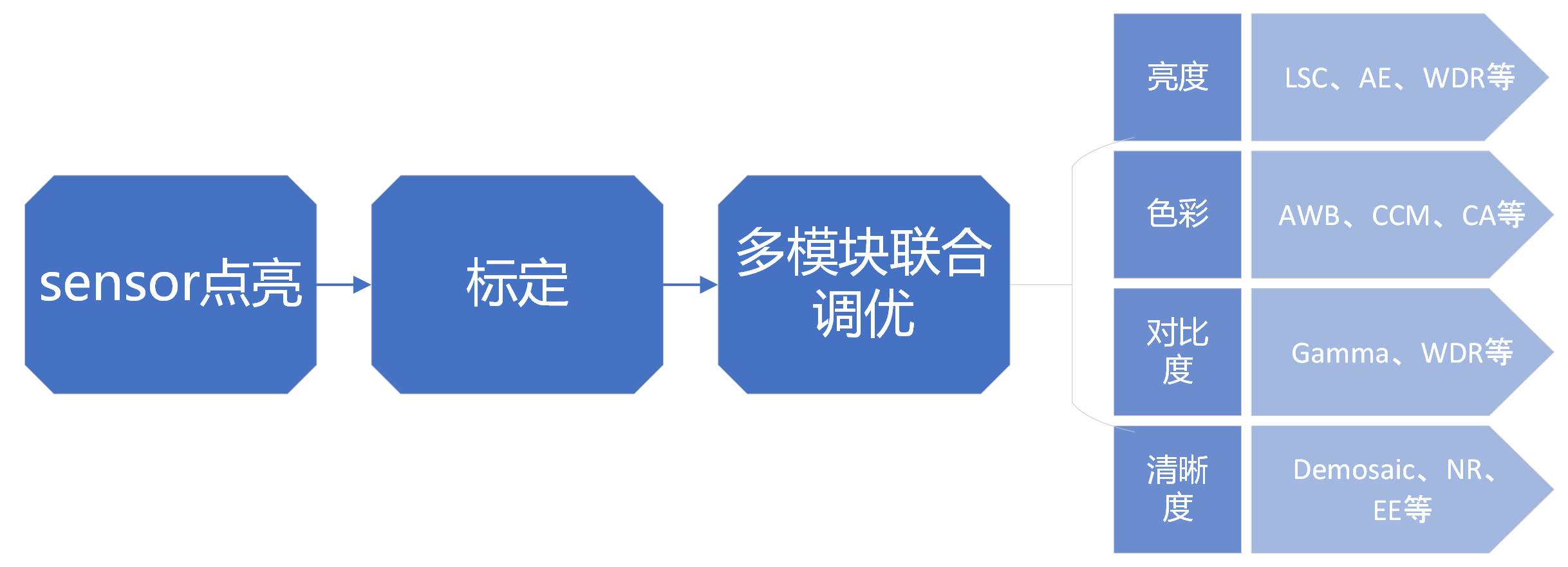

When tuning images, brightness, color, contrast, and clarity are our main focus areas. Through calibration of the sensor and lens and joint tuning of ISP sub-modules, we aim to achieve reasonable overall brightness, accurate color reproduction, good image clarity without obvious noise, high image contrast, and an overall transparent look.
The overall image tuning process is shown in the following figure:

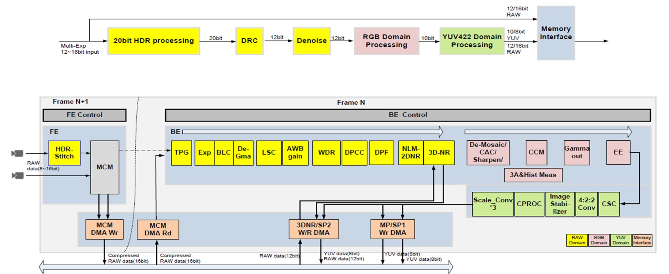

The K230 ISP pipeline is shown in the following figure:
Please note:
In K230 HDR mode, the K230 CSI (Camera Serial Interface) module does not support sensor data modes where Hsync precedes Vsync, and there should be no overlap when each frame (L/S/VS) Vsync is high (valid data output).
When enabling TNR in 3DNR, the ISP requires the sensor Hblank to be no less than 180 pixel clocks (it is recommended to set it to no less than 256 pixel clocks). Recommendation: Frame length – Active lines >= 92 lines.
K230 ISP pipeline as following figure:

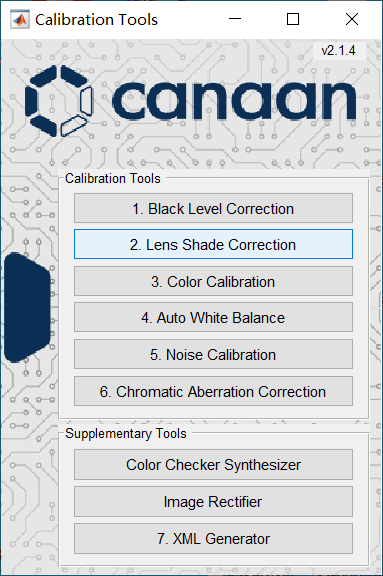

The main interface of the calibration tool is shown below.
Click the corresponding module button to directly jump to the calibration interface of each module and start calibration.

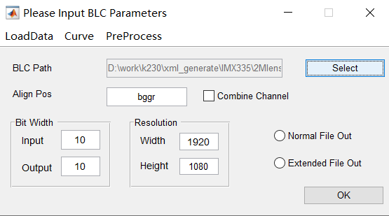

Starting Calibration Using the Calibration Tool#
When the “Black level correction” button is clicked on the main interface, the tool will pop up a dialog box as shown below.
Steps:
Click the “Select” button to choose the folder where the RAW images are saved.
Fill in the RAW image’s Bayer pattern in the “Align Pos” text box.
Set the input and output Bit Width.
Set the resolution: the width and height of the image.
Click the “OK” button to start calibration.
Among them:
Combine Channel text box: If checked, it means the BLC obtained by the user is the combined measurement value of the R, Gr, Gb, and B channels.
Normal File Out / Extended File Out: If Normal File Out is checked, it means the output is blc_para.txt; if Extended File Out is checked, the BLC of the R, Gr, Gb, and B channels will be output separately according to different exposure times and Gains.

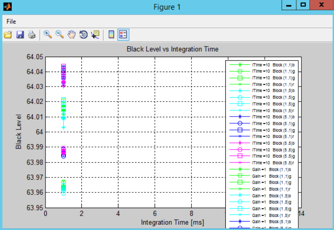

After calibration, the Black Level vs Integration Time chart is shown below.

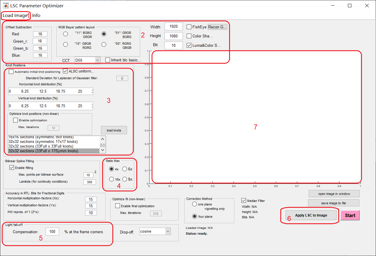

When the “Lens Shade correction” button is clicked on the main interface, the tool will pop up a dialog box as shown below.
Specific steps:
In area 2, select the Bayer pattern sorting of the RAW image, fill in the image width and height, bit width, select the type of LSC correction needed (Color Shading or Luma & Color Shading), select the corresponding color temperature light source in the CCT drop-down menu, and fill in the Black Level Offset values of each channel in the offset Subtraction field.
Click the “load image” button in area 1 to import the RAW image to be calibrated.
Area 3 is for setting the LSC grid nodes. First, determine the number of grids. The K230 ISP LSC hardware statistics are 32x16 grids, so you can choose “33Full x 17Symm knots” for calibration. If you plan to use the ISP ALSC function, check “ALSC uniform…”. If “Automatic initial knot positioning” is checked, ALSC function cannot be enabled in auto.json.
In area 4, you can select the maximum calibration ratio of the center/corner.
In area 5, you can set the compensation ratio of the corners (e.g., if set to 80%, it means the brightness of the corners after calibration needs to be 80% of the center brightness).
Other settings can be kept as default.
Click “Start” to start calibration and save the LSC data.
In area 6, you can choose to apply the calibrated LSC data to the image, preview the calibration effect, and click “save image to file” to save the Png images under each light source.

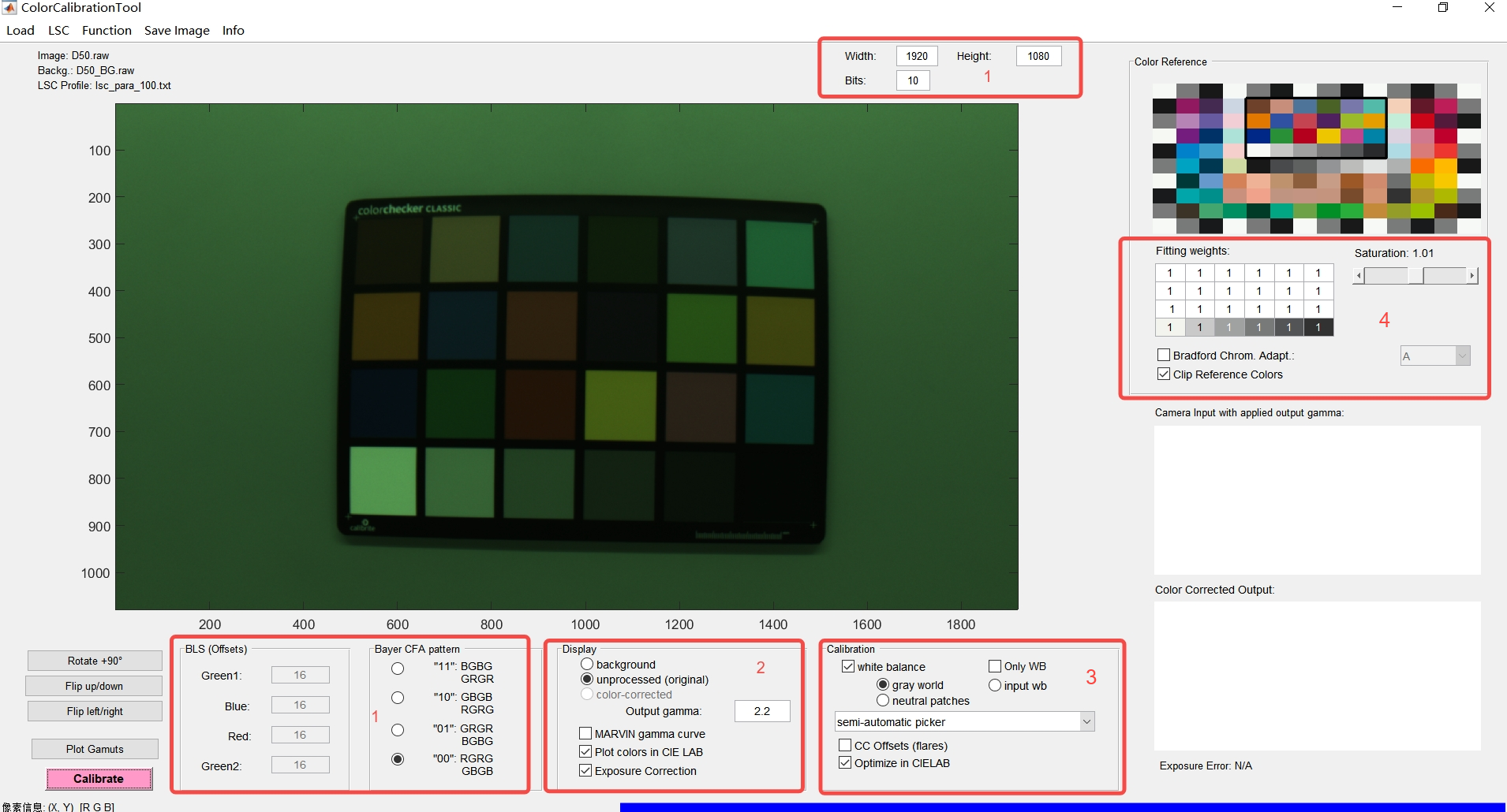

When the “Color Correction” button is clicked on the main interface, the tool will pop up a dialog box as shown below.
Specific steps are as follows:

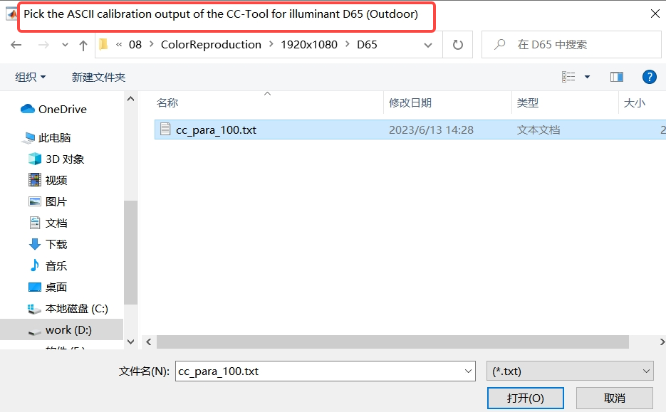

In area 1, set the width, height, bit width, Black Level Offset, and Bayer pattern of the RAW image.
Click the “Load” menu to sequentially import the color reference file CC_Standard.cxf (Load sRGB References, this file is located in the Canaan.Calibration.Samples\Data\ directory of the calibration tool), 24-color card RAW image (Load Color Checker Image), and gray wall background RAW image (Load Background Image).
To import the reference color card, besides importing CC_Standard.cxf through “Load sRGB References,” you can also get the customer’s custom reference color card Lab values through “Load Lab-Customer References” under the “Load” menu; or load the reference color card image through “Load References Image” under the “Load” menu, then select “Select Reference Color Check” under the “Function” menu, and control the crosshair by moving the mouse to position it at the center of the four color blocks at the upper left, upper right, lower left, and lower right corners of the given color card image, and click the mouse sequentially to complete the specification of the reference color card area.Click the “LSC” button to import the calibrated LSC parameter file.
Configure calibration parameters:
Set gamma
Check CIELAB reference
Configure the weights of the 24 color blocks
Set the preferred light source
Set the output saturation, default is 1
In the drop-down menu in area 3, select the method to pick the 24 color blocks (there are three modes: automatic, semi-automatic, and manual).
In semi-automatic mode, the crosshair can be controlled by moving the mouse to position it at the center of the four color blocks at the upper left, upper right, lower left, and lower right corners of the color card image, and click the mouse sequentially to complete the specification of the reference color card area.Click “Calibrate” to start calibration.

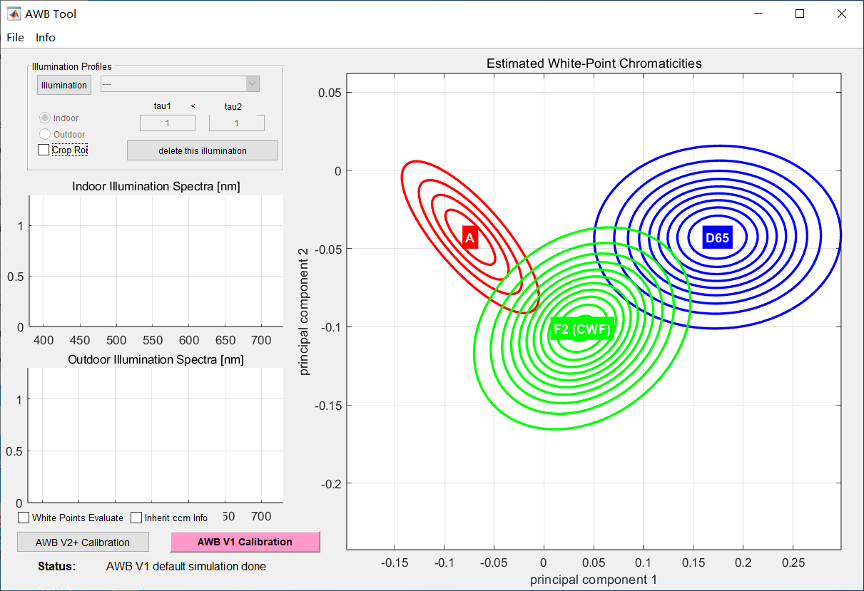

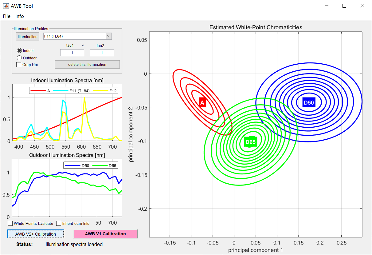

When the “Auto White Balance” button is clicked on the main interface, the tool will pop up a dialog box as shown below.
The specific steps are as follows:

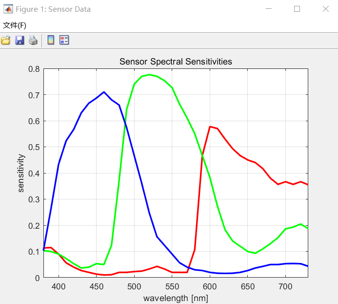

Click the “file” button to import the sensor spectral sensitivity file, as shown below:
Note: If the user does not have their own sensor spectral sensitivity file, they can use the default OV2775_sensitivity.txt included in the toolkit (this file is located in the Canaan.Calibration.Samples\Data\ directory of the calibration tool). Although AWB calibration no longer relies on the sensor spectral sensitivity file, any sensor spectral sensitivity file can be imported to proceed with the following steps without issues.
Click the “illumination” button to import the light source file CIE_Illuminants.cxf (this file is located in the Canaan.Calibration.Samples\Data\ directory of the calibration tool) and select the light sources to be calibrated (at least three), as shown below. Click the “OK” button to display the spectral distribution of each light source on the left side as shown below and classify each light source as indoor or outdoor using the dropdown menu.
Click the “AWB V2+ Calibration” button (in older versions of the calibration tool, click the “Start Calibration” button), and select the parameter files of each light source generated from CC calibration as shown in the red box below:
Check the “White Points Evaluate” box and select an image for white point estimation.

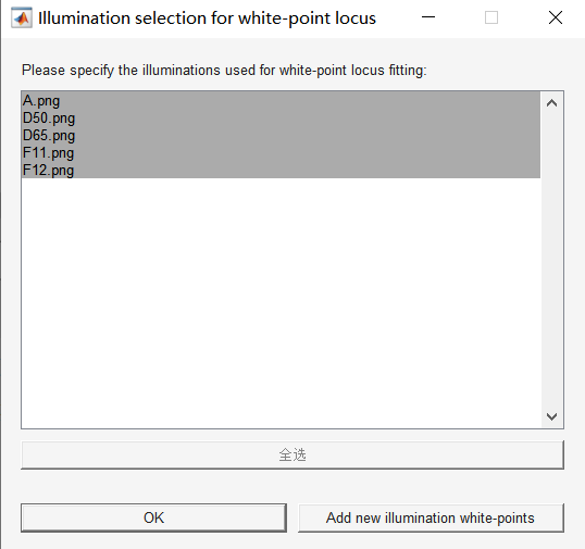

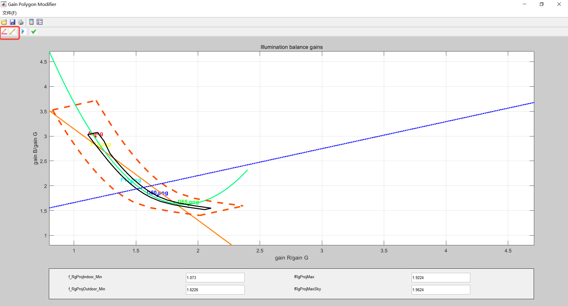

Click the “Gain Region Modifier” button, select the PNG images of each light source saved during LSC calibration, as shown below, and click “OK” to proceed to the next step:
Define the starting range size of the gain polygon, as shown below, and click the “OK” button to proceed to the next step:
Manually adjust the range of the orange box (near white area) and the black box (all points within the black box are recognized as white points) using the buttons in the red box area, adjust the black box range to include the white points of all selected light sources, as shown below. Save the data, and if the test fails, readjust the polygon range.

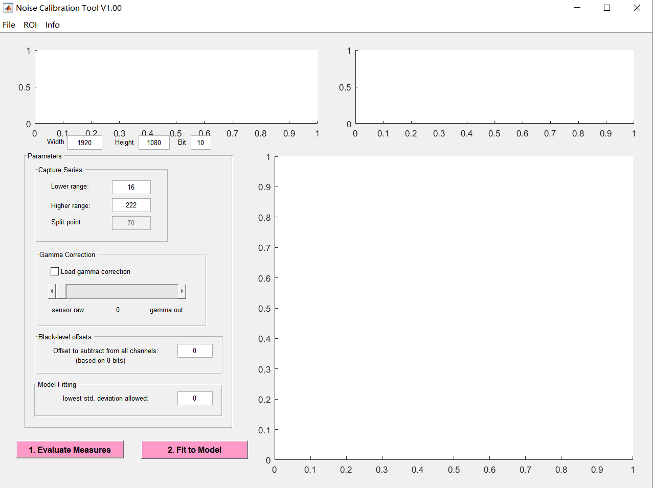

When the “Noise Calibration” button is clicked on the main interface, the tool will pop up a dialog box as shown below.
Set the width, height, bit width, and Black Level Offset of the RAW image.
Click the “file” button to import the bright and dark series of RAW images.
Click the “ROI” button to set the ROI of the image.
Adjust the parameters. For the Lowlight histogram, select the histogram area from the Lower range to the Split point; for the Highlight histogram, select the histogram area from the Split point to the Higher range. The combined area should cover all values from 0 to 255 (8-bit width). The selection of Split point and high range values should ensure that the retained areas of highlight and lowlight follow a Poisson distribution. If a black level offset is set, then Lower range >= black level.
Gamma correction and Model Fitting do not need to be set.
Click “Evaluate Measures”.
Click “Fit to Model” to complete the Noise calibration and save the results.

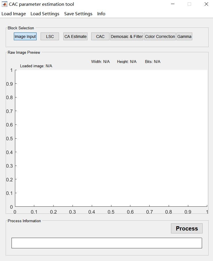

When the “Chromatic Aberration Correction” button is clicked on the main interface, the tool will pop up a dialog box as shown below.
Click the “Demosaic&Filter” button and set the Bayer pattern format.
Click the “load image” button to load the RAW image, and the image will be displayed in the preview window.
Set the parameters under the “Demosaic&Filter” interface.
Since the CAC module operates after demosaicing, the tool implements a simple demosaicing function here.
ISP_demosaic_threshold: The default threshold value is set to 4. The higher the value, the fewer edges detected by the edge detection algorithm; lower values will result in more detected edges. A value of 255 means edge detection is completely disabled.
Simulate 2 additional Line Buffers: Allows users to extend the vertical offset. This enables setting the vertical vector clipping to +-3. In this case, chroma reduction filtering is not performed. Default is unchecked.
Filter stage1 select:
Sharpen Level:
Denoise Level:
Lum_weight Off: Allows disabling a special feature of the filter algorithm. This feature helps suppress stronger noise in dark areas compared to bright areas. Due to nonlinear gamma correction in the processing chain, contrast and noise are emphasized in dark areas and attenuated in bright areas. To compensate for this, the texture parameter is weighted by a function derived from the average brightness of a 5x5 kernel before comparing it with the threshold. Default is unchecked, resulting in less noise in the image preview.
Click the “Color Correction” button and set the parameters under this interface.
Check “ISP_bls_enable” and set the correct BLC.
Check “Auto White-Balance”.
Set the CCM.
The global gain is set to 1.0 by default.
Click the “Gamma” button and set the gamma curve, with the default set to gamma 2.2.
Click the “LSC” button, then click “Load parameters” to load the LSC calibration parameters under the corresponding D50 light source, and check “Enable”.
Click the “CA Estimate” button, check the “CA_Estimate” box, and click “Process” to run.
Click the “CAC” button to view the calibration results from this interface.

LSC#
Function Description#
In K230, the LSC algorithm uses a 32x16 grid to calibrate the image. During RAW image data processing, the LSC algorithm divides the image into 32x16 sub-blocks and processes the four channels of the RAW image.
Main Parameters#
Parameter |
Type and Range |
Description |
enable |
bool |
LSC enable switch |
matrix |
matrix[4] [1089] |
Lens shading calibration parameters for R, Gr, Gb, and B channels, obtained from the calibration file |
x_size |
xSize[32] |
Distance between every two grid nodes on the x-axis, obtained from the calibration file |
y_size |
ySize[16] |
Distance between every two grid nodes on the y-axis, obtained from the calibration file |

AWB#
Under different light source environments, the color of objects will vary. Human eyes have the characteristic of constancy, being able to recognize the true color of objects under different color temperatures, but sensors react differently under various light sources compared to human eyes, leading to color cast. AWB (Auto White Balance) can reduce the impact of external light sources on the true color of objects, making color-cast objects appear as if they are under ideal daylight without color cast.
Main Parameters#
Parameter |
Type and Range |
Description |
enable |
bool |
true: Enable AWB |
awbTempWeight |
float 0.0~1.0 |
AWB color temperature light source weight |
mode |
int 0,1 |
0: AWB |
roiNumber |
int |
Current ROI window index |
roiWeight |
float |
AWB calculation weight of the current ROI window |
roiWindow |
float (fx,fy,fw,fh) |
Starting point coordinates (x,y) and width and height of the current ROI window |
useCcMatrix |
bool |
true: Enable CCM adaptive |
useCcOffset |
bool |
true: Enable CCM offset adaptive |
useDamping |
bool |
true: Enable AWB damping change |
kFactor |
float |
Sensitivity coefficient used to identify outdoor and transition areas |
Explanation of kFactor Calibration#
In the AWB algorithm, the determination of an outdoor environment is: Exp * kFactor <= 0.12 (where Exp is the exposure).
For example, if 2000 lux is taken as the illumination threshold between outdoor and transition environments, obtain the exposure value (ET gain) corresponding to this illumination, and calculate: kFactor = 0.12 / (ET gain).
The larger the kFactor, the stronger the sensor’s sensitivity; the smaller the kFactor, the weaker the sensor’s sensitivity.
This kFactor parameter is located in the AWB parameters of the XML file and needs to be calculated using the above method and filled in.

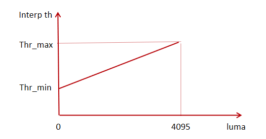

Demosaic#
The Demosaic module primarily converts input Bayer format data into RGB format data using interpolation algorithms. It also supports noise reduction, sharpening, moiré removal, and purple fringe removal.
Main Parameters#
Parameter |
Type and Range |
Description |
demosaic_enable |
bool |
Enable switch for demosaic |
demosaic_thr |
int 0~255 |
Interpolation threshold for the R and B channels; below this value, non-directional interpolation is performed |
dmsc_dir_thr_min |
int 0~4095 |
Interpolation for the G channel in dark areas |
dmsc_dir_thr_max |
int 0~4095 |
Interpolation for the G channel in bright areas |

Interpolation
For 12-bit raw, the interpolation threshold corresponding to the value 0 is dir_thr_min, and the interpolation threshold corresponding to the value 4095 is dir_thr_max. Values in between correspond to points on the line segment determined by dir_thr_min and dir_thr_max.
Setting demosaic_thr: Gradient difference > threshold, directional interpolation; gradient difference < threshold, average interpolation. Smaller values mean more false colors in high-frequency areas.
This module is used for chromatic aberration correction.
Main Parameters#
Parameter |
Type and Range |
Description |
a_blue |
float -16~15.9375 |
Radial blue shift calculation parameter, calculated according to the formula (a_blue r + b_blue r^2 + c_blue * r^3) |
a_red |
float -16~15.9375 |
Radial red shift calculation parameter, calculated according to the formula (a_red r + b_red r^2 + c_red * r^3) |
b_blue |
float -16~15.9375 |
b_red |
float -16~15.9375 |
c_blue |
float -16~15.9375 |
c_red |
float -16~15.9375 |
cac_enable |
bool |
CAC enable switch |
center_h_offs |
int |
Horizontal distance between the image center and the optical center |
center_v_offs |
int |
Vertical distance between the image center and the optical center |
a_blue, b_blue, c_blue can be obtained from the blue_parameters field in the xml file’s CAC section, a_red, b_red, c_red can be obtained from the red_parameters field in the xml file’s CAC section, center_h_offs can be obtained from the x_offset field in the xml file’s CAC section, and center_v_offs can be obtained from the y_offset field in the xml file’s CAC section.
