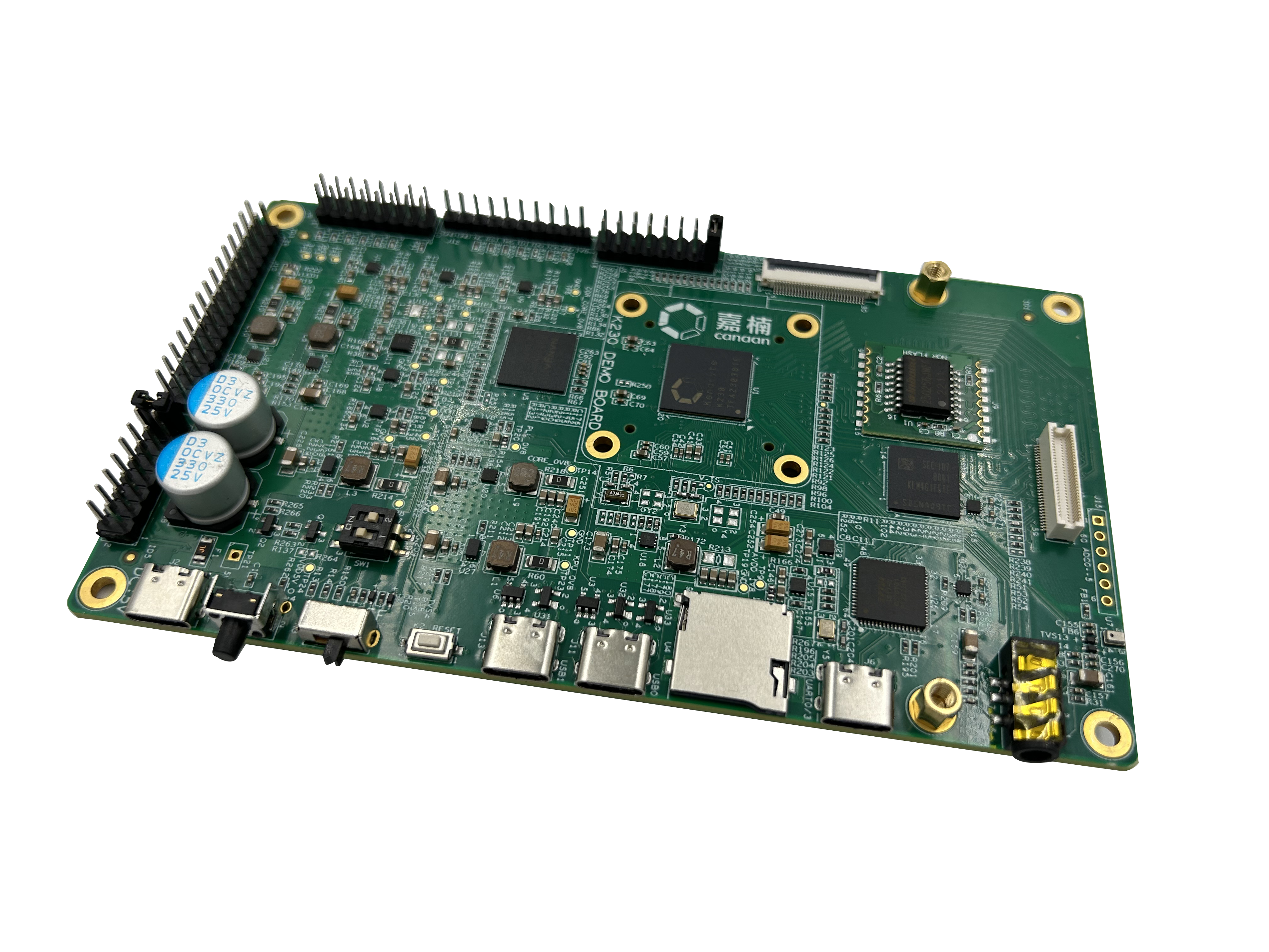

The K230 DEMO BOARD is a fully equipped development and testing board with an attached camera sub-board and screen, ready for plug-and-play. Once powered on, you can immediately begin subsequent development work for the K230. The K230 DEMO BOARD is delivered in a mainboard-assembled-with-multiple-sub-boards form. This document will briefly summarize the various component sub-boards and usage processes of the K230 DEMO BOARD through the interfaces on the mainboard.
K230 DEMO BOARD Mainboard Diagram#
K230 DEMO BOARD Sample (Figure 1.2.1: K230 DEMO BOARD Sample, Sub-boards Unassembled)

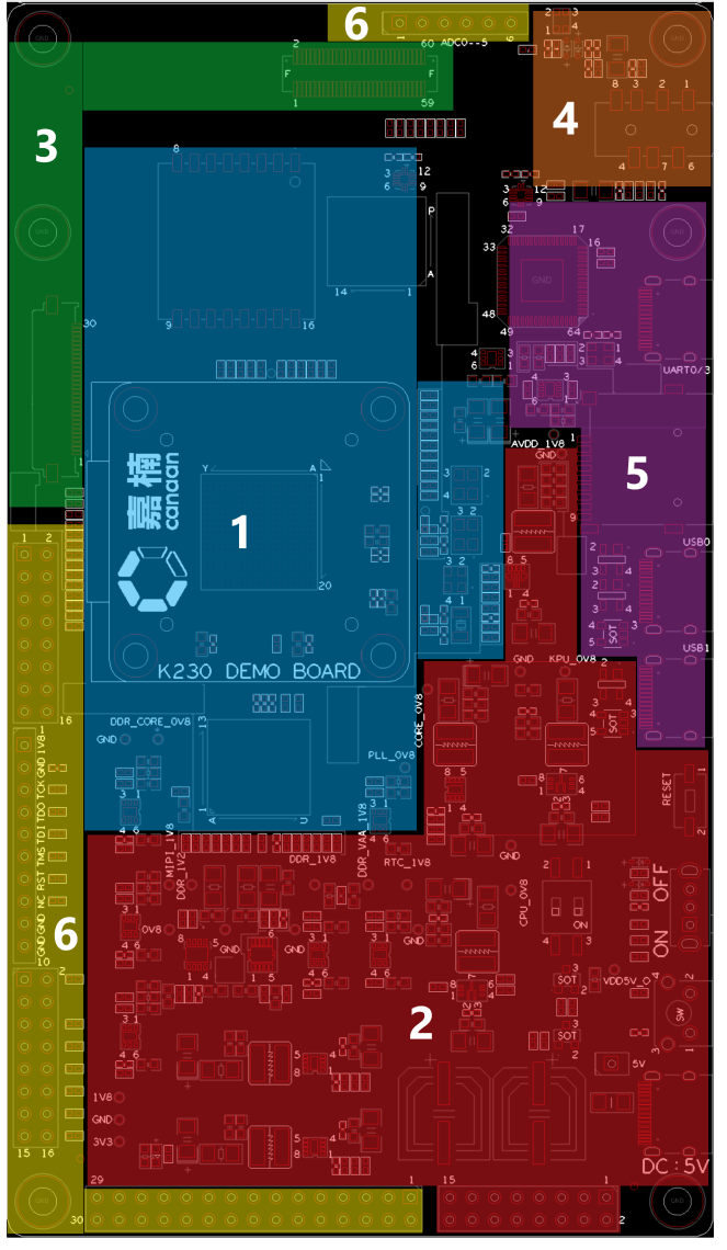

The K230 DEMO BOARD can be roughly divided into 6 areas as shown in the left image of Figure 2.1.1, in the order of the marked numbers:
  1. (Blue) Core Area - This is where the main chip K230 and its storage DDR, flash, eMMC, and system main clock are located.
  2. (Red) Power Area - This is where all power supplies and power control components on the DEMO BOARD mainboard are located.
  3. (Green) Video Input and Output - This is where the camera and screen connect to the mainboard.
  4. (Orange) Audio Input and Output - This is where the microphone and headphones are located.
  5. (Purple) General Interface - This area contains the interfaces for data exchange with other devices.
  6. (Yellow) Pin Header Interface - This area contains pin headers corresponding to key signals on the DEMO BOARD, which can be used as test points or connection points for external signals and expansion sub-cards.
Each area in the left image contains several components/interfaces listed in the right image. In the following sections of this chapter, each component/interface covered in each area will be listed in the above sequence. Additional information or usage instructions will be provided as needed when listing the corresponding components/interfaces.
In cases where schematics appear in this chapter, unless otherwise specified, it is assumed that the pin configurations of the components on the DEMO BOARD are completely consistent with the pin configurations in the schematics (referring to single or dual rows, pin-out order). Additionally, all pin numbers and component numbers mentioned are marked with white silkscreen on the K230 DEMO BOARD. Please confirm with the actual DEMO BOARD.

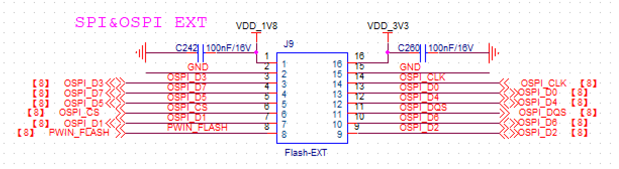

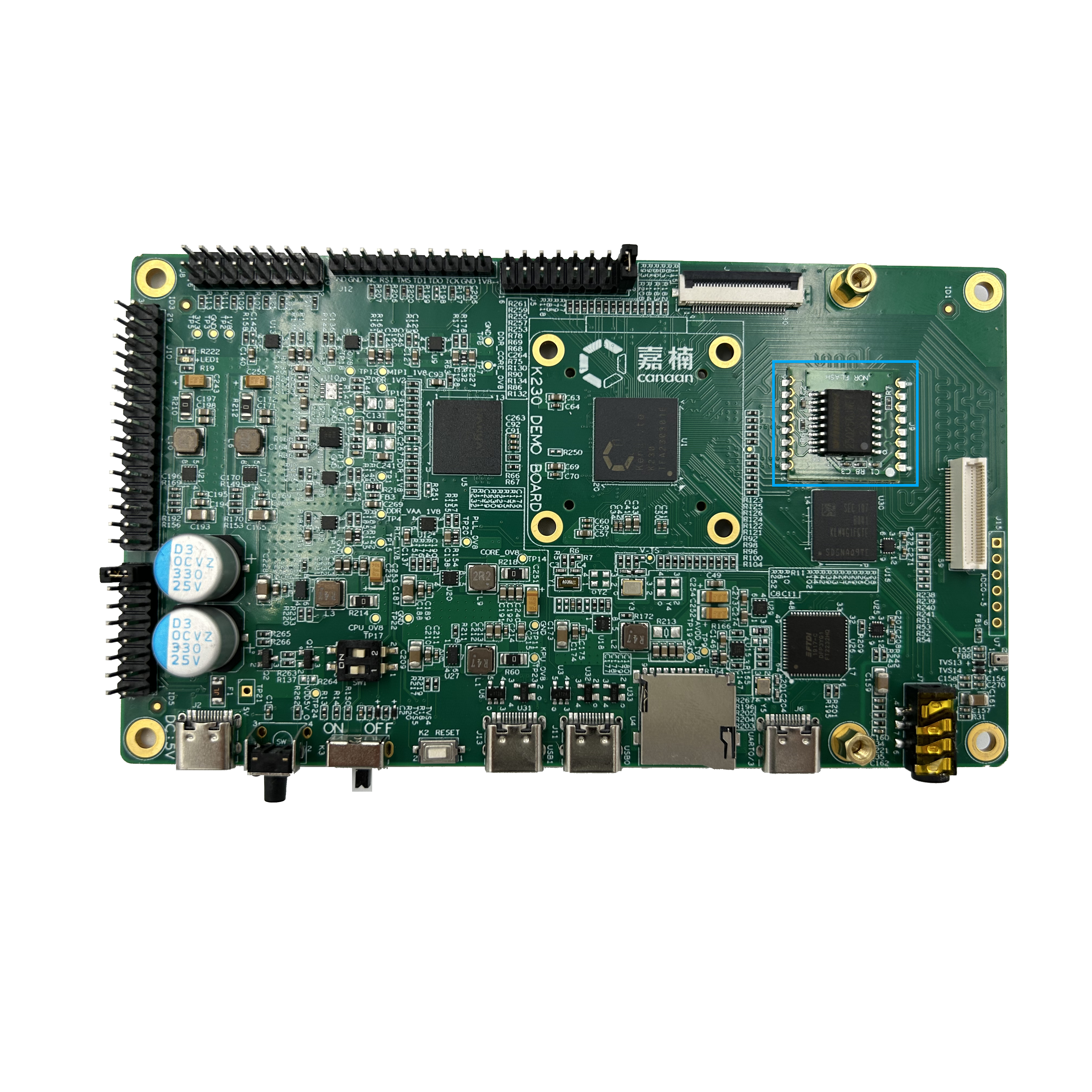

  4. Flash Expansion (Component Number on DEMO BOARD: J9)
Flash Module Sub-Card Example Flash Expansion-J9 Schematic (Figure 2.2.1: The top image is an example of the flash module sub-card, with the white dot at the top left indicating pin 1. The bottom image is the Flash Expansion-J9 schematic)
The FLASH expansion on the DEMO board has already been soldered with a verified flash module, requiring no further modification. The selected model is NOR flash, OSPI interface (GD25LX256E, Manufacturer: Giga Device, 256Mbits).

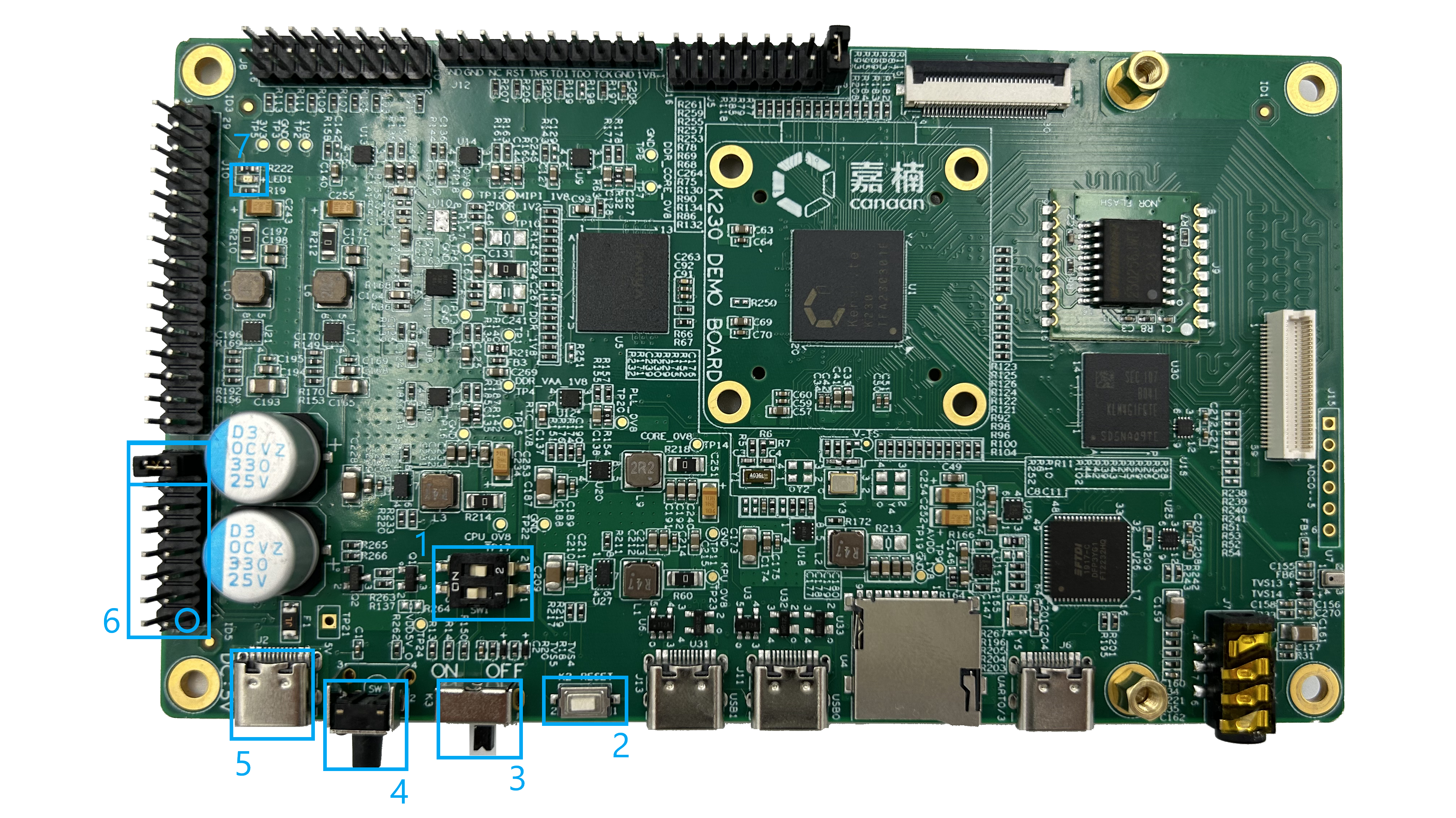

Main Component Locations (Figure 2.3.1: Main Component Locations in the Power Area, showing the power-on mode via switch)
This area generates all the power required on the DEMO BOARD. All components related to DEMO BOARD power control are located in this area, and there are 2 power-on modes to choose from (the selection method will be explained later). The numbered components/interfaces in Figure 2.3.1 correspond to the following 6 main components/interfaces (names are consistent with the list in the right image of Figure 2.1.1):
  1. Boot Mode Selection Switch (Component Number on DEMO BOARD: SW1) The K230 supports loading boot files from four different locations, selected via four high and low logic states on the DIP switch. The four states correspond to the boot locations and the SW1 schematic as shown in Figure 2.3.2 below. SW1 Schematic (Figure 2.3.2: SW1 Schematic) Switches 1 and 2 correspond to BOOT0 and BOOT1, respectively. Flip the switch to pins 1 and 2 for high logic levels (H side marked on the DEMO BOARD) and to pins 3 and 4 for low logic levels (L side marked on the DEMO BOARD). All numbers are marked on the DEMO BOARD surface with silkscreen.
  2. System Reset Button (Component Number on DEMO BOARD: K2) Low-active reset button. When pressed, it pulls the reset low; when released, the default state is high. You can determine the current reset status by checking the voltage at pin 2.
  3. Power Switch (Component Number on DEMO BOARD: K3)
  4. Interrupt Signal Button (Component Number on DEMO BOARD: K1) A test button used to manually generate an interrupt signal.
  5. Power Input DC 5V: 2A (Component Number on DEMO BOARD: J2)
  6. PMU Expansion (Component Number on DEMO BOARD: J1) Pin header expansion used for power testing, not needed during normal use of the DEMO board. PMU Expansion J1 Schematic (Figure 2.3.3: PMU Expansion J1 Schematic)
  7. Red LED Power Indicator (Component Number on DEMO BOARD: LED1)
Normal Power-On Procedure:
  • Set SW1 to the desired BOOT position.
  • Connect the 5V power supply to the power input-J2 via the Type-C power cable.
  • Flip K3 to the ON position to power on. If the power is successfully connected, the red LED indicator in Figure 2.3.1 will light up.
  • Under normal power conditions, you can check if the reset status is high to ensure the K230 has successfully started.
  • If the power indicator does not light up during power-on, check if the jumper cap at pins 15 and 16 of the PMU expansion (J6) (specifically marked in the box labeled 6 in Figure 2.3.1) is correctly inserted.

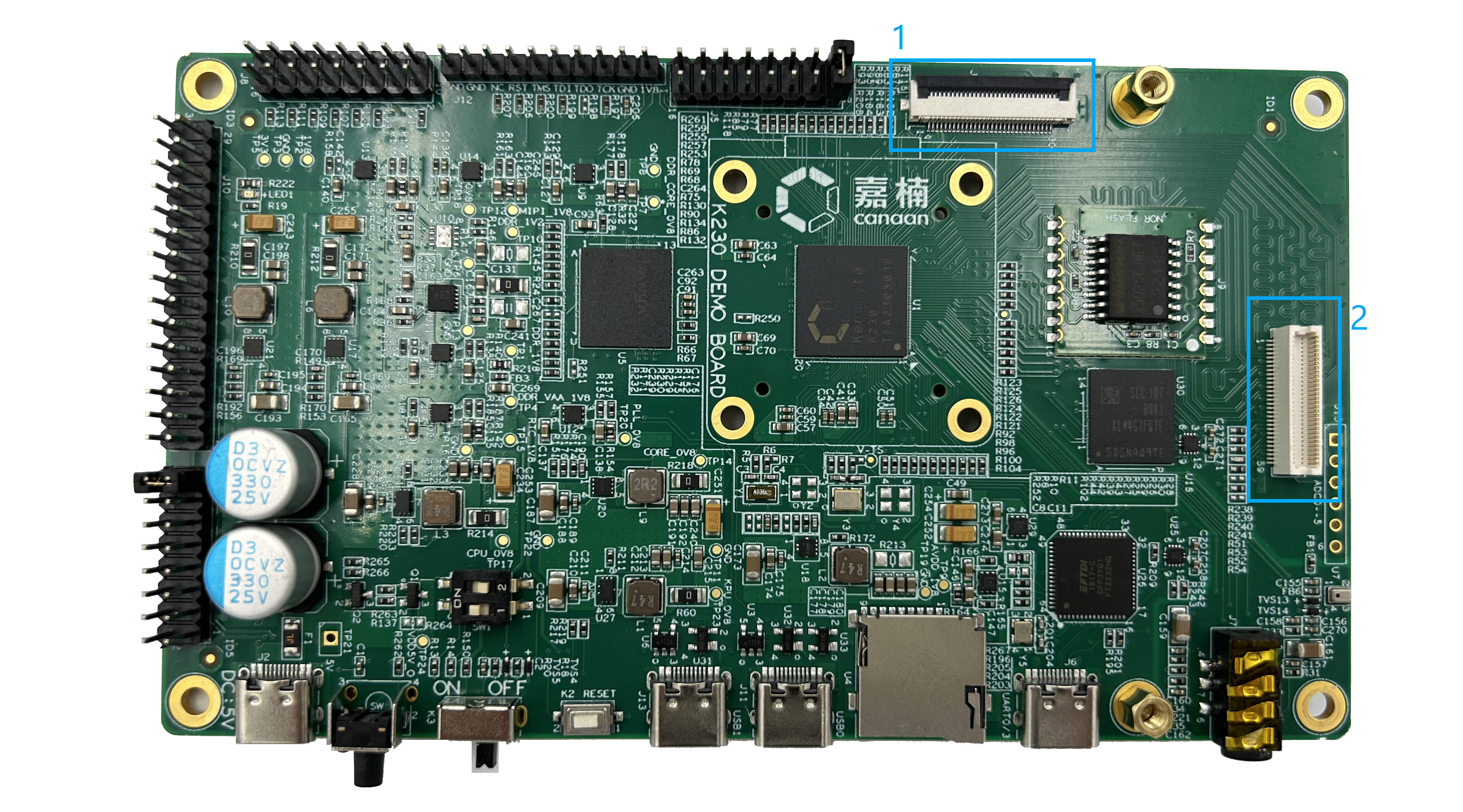

Video Area Main Component Locations (Figure 2.4.1: Main Component Locations in the Video Area)
This is where the camera and screen sub-cards delivered with the DEMO BOARD are connected. The numbered components/interfaces in Figure 2.4.1 correspond to the following 2 main components/interfaces (names are consistent with the list in the right image of Figure 2.1.1).

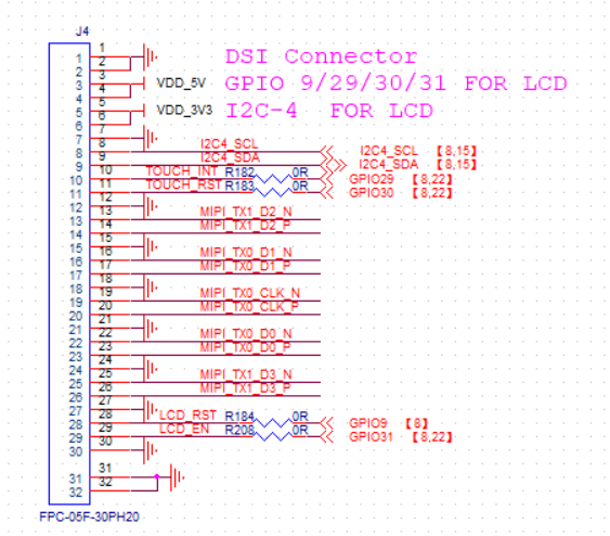

  1. Display Expansion (Component Number on DEMO BOARD: J4) MIPI DSI interface, transmitting video signals from MIPI to the display through an FPC cable, also known as the MIPI TX interface. This is where the DSI Touch Screen Adapter Board mentioned in Section 1.3 connects, directly connecting J4 and the adapter board via a 30-pin wide FPC cable. The pin definition schematic for J4 is shown in Figure 2.4.2. Display Expansion Pin Definition Schematic (Figure 2.4.2: Display Expansion Pin Definition Schematic. Pins 31 and 32 are fixed pins, not signal pins, and can be ignored.)
  2. Sensor Expansion (Component Number on DEMO BOARD: J3) MIPI CSI interface, transmitting video signals received from the camera through a board-to-board connector, also known as the MIPI RX interface. This is where the IMX335 Module Sensor Board mentioned in Section 1.3 connects. The pin definition schematic for J3 is shown in Figure 2.4.3. Sensor Expansion Pin Definition Schematic (Figure 2.4.3: Sensor Expansion Pin Definition Schematic)

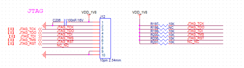

  3. JTAG Expansion (Component Number on DEMO BOARD: J12) Port for connecting a JTAG debugger. Use jumper wires to connect the pins on the JTAG expansion to the corresponding JTAG debugger ports. The pin definitions are shown in Figure 2.7.4. JTAG Expansion (Figure 2.7.3: JTAG Expansion Pin Definition Schematic, with data lines pulled up to 1.8V via 10K resistors)

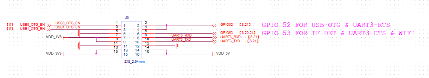

  4. IOMUX/Power Expansion (Component Number on DEMO BOARD: J5) Control pin headers for USB and serial ports. By shorting certain pins on J5, you can change the modes of the two USB interfaces mentioned in Section 2.6. The pin definitions of J5 are shown in Figure 2.7.5. If USB0 is to be used as a HOST or for Ethernet port conversion, short pins 1 and 2 of J5; for DEVICE mode, leave pins 1 and 2 open (default delivery is shorted). Similarly, if USB1 is to be used as a HOST or for Ethernet port conversion, add a jumper cap on pins 3 and 4 of J5 (default delivery is not shorted). Additionally, pins 8 and 10 can be used as an extra serial debug port with UART_RX and UART_TX, respectively. IOMUX/Power Expansion (Figure 2.7.4: IOMUX/Power Expansion-J5 Schematic)
