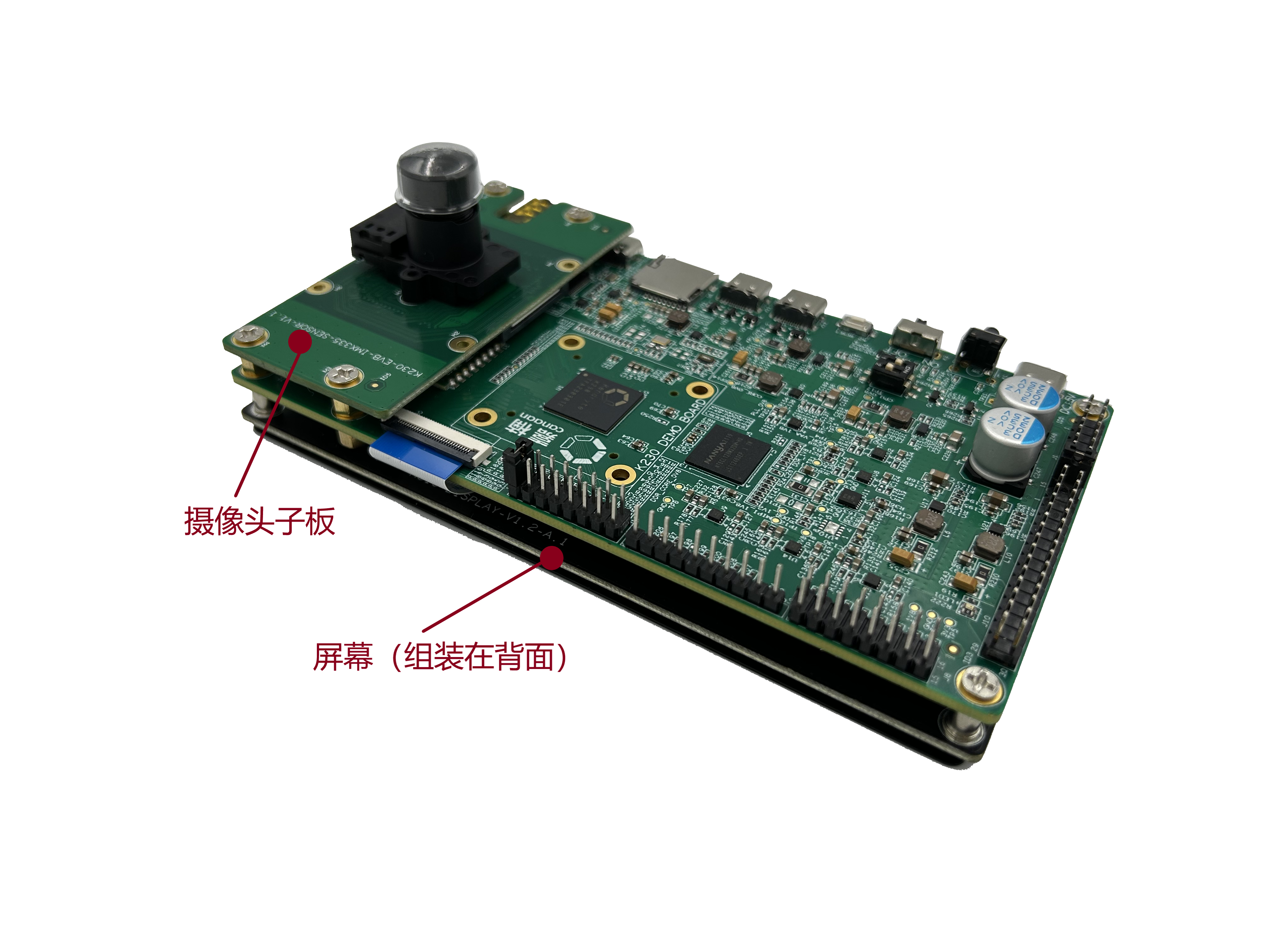

For a fully assembled DEMO board, refer to Figure 1.3.1.
(Figure 1.3.1: K230 DEMO BOARD Sample, Fully Assembled)

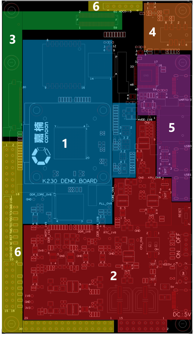

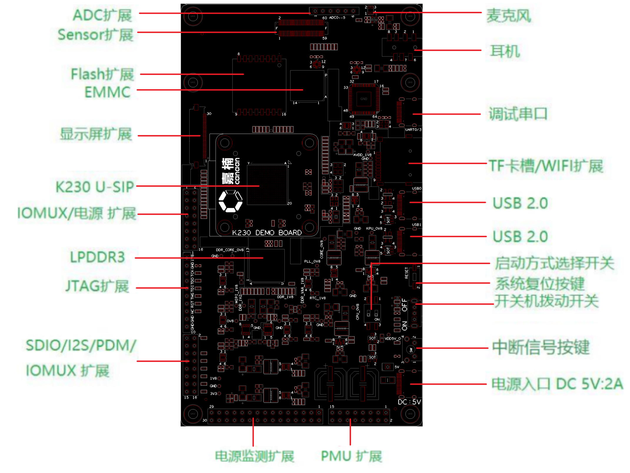

(Figure 2.1.1: The top image shows the K230 DEMO BOARD functional area division, and the bottom image shows all supported interfaces and their corresponding positions on the DEMO BOARD)
The K230 DEMO BOARD can be roughly divided into 6 areas as shown in the left image of Figure 2.1.1, in the order of the marked numbers:
(Blue) Core Area - This is where the main chip K230 and its storage DDR, flash, eMMC, and system main clock are located.
(Red) Power Area - This is where all power supplies and power control components on the DEMO BOARD mainboard are located.
(Green) Video Input and Output - This is where the camera and screen connect to the mainboard.
(Orange) Audio Input and Output - This is where the microphone and headphones are located.
(Purple) General Interface - This area contains the interfaces for data exchange with other devices.
(Yellow) Pin Header Interface - This area contains pin headers corresponding to key signals on the DEMO BOARD, which can be used as test points or connection points for external signals and expansion sub-cards.
Each area in the left image contains several components/interfaces listed in the right image. In the following sections of this chapter, each component/interface covered in each area will be listed in the above sequence. Additional information or usage instructions will be provided as needed when listing the corresponding components/interfaces.

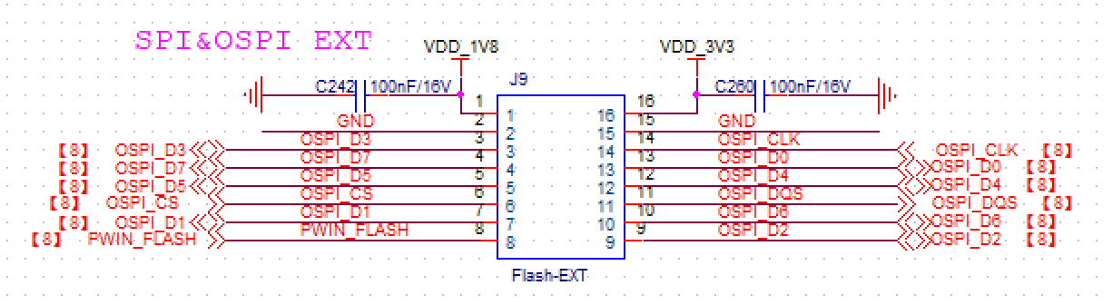

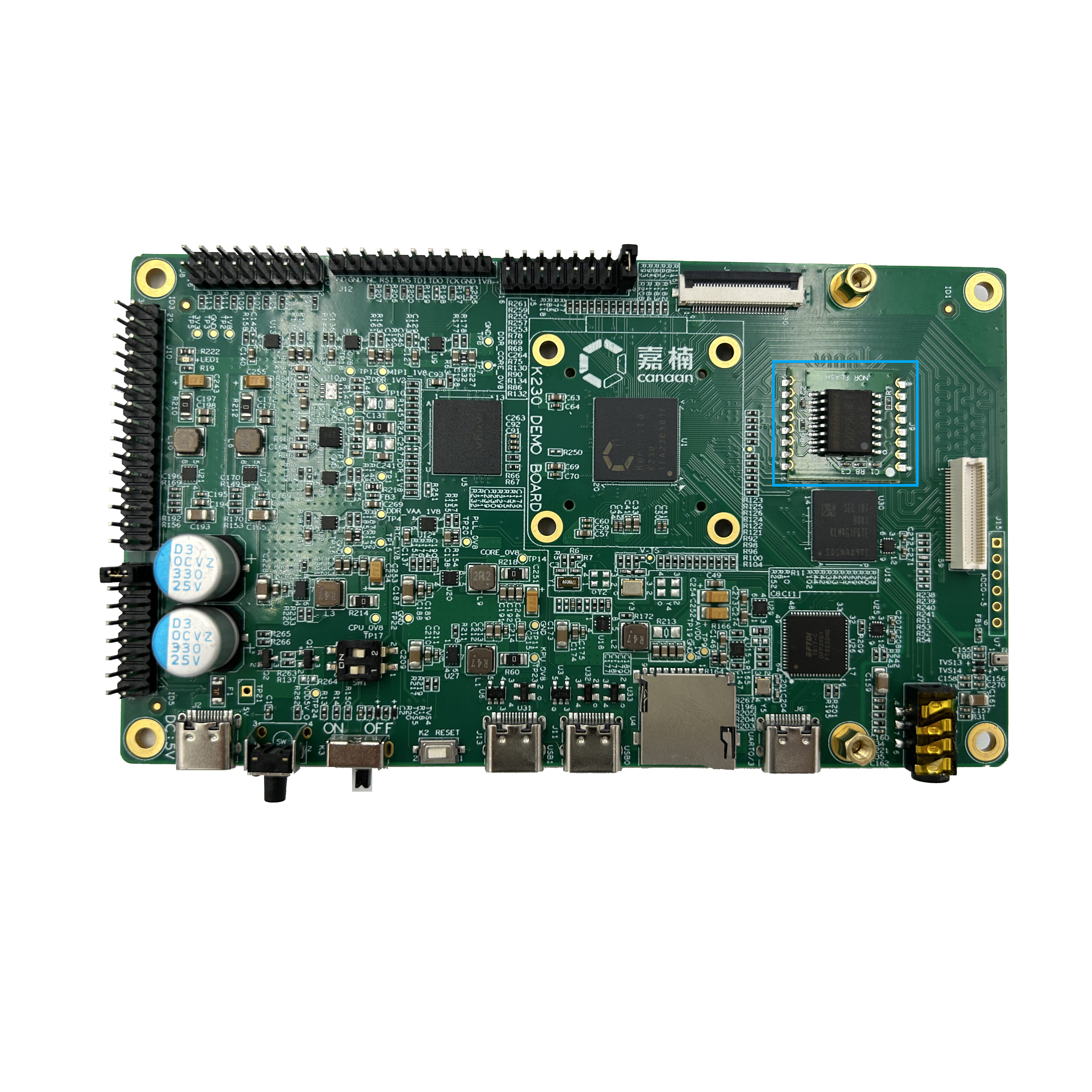

Flash Expansion (Component Number on DEMO BOARD: J9)
(Figure 2.2.1: The top image is an example of the flash module sub-card, with the white dot at the top left indicating pin 1. The bottom image is the Flash Expansion-J9 schematic)
The FLASH expansion on the DEMO board has already been soldered with a verified flash module, requiring no further modification. The selected model is NOR flash, OSPI interface (GD25LX256E, Manufacturer: Giga Device, 256Mbits).

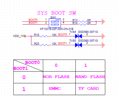

Boot Mode Selection Switch (Component Number on DEMO BOARD: SW1) The K230 supports loading boot files from four different locations, selected via four high and low logic states on the DIP switch. The four states correspond to the boot locations and the SW1 schematic as shown in Figure 2.3.2 below.
(Figure 2.3.2: SW1 Schematic)
Switches 1 and 2 correspond to BOOT0 and BOOT1, respectively. Flip the switch to pins 1 and 2 for high logic levels (H side marked on the DEMO BOARD) and to pins 3 and 4 for low logic levels (L side marked on the DEMO BOARD). All numbers are marked on the DEMO BOARD surface with silkscreen.System Reset Button (Component Number on DEMO BOARD: K2) Low-active reset button. When pressed, it pulls the reset low; when released, the default state is high. You can determine the current reset status by checking the voltage at pin 2.

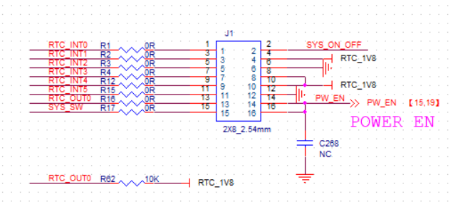

PMU Expansion (Component Number on DEMO BOARD: J1) Pin header expansion used for power testing, not needed during normal use of the DEMO board.
(Figure 2.3.3: PMU Expansion J1 Schematic)Red LED Power Indicator (Component Number on DEMO BOARD: LED1)

Flip K3 to the ON position to power on. If the power is successfully connected, the red LED indicator in Figure 2.3.1 will light up.
Under normal power conditions, you can check if the reset status is high to ensure the K230 has successfully started.
If the power indicator does not light up during power-on, check if the jumper cap at pins 15 and 16 of the PMU expansion (J6) (specifically marked in the box labeled 6 in Figure 2.3.1) is correctly inserted.

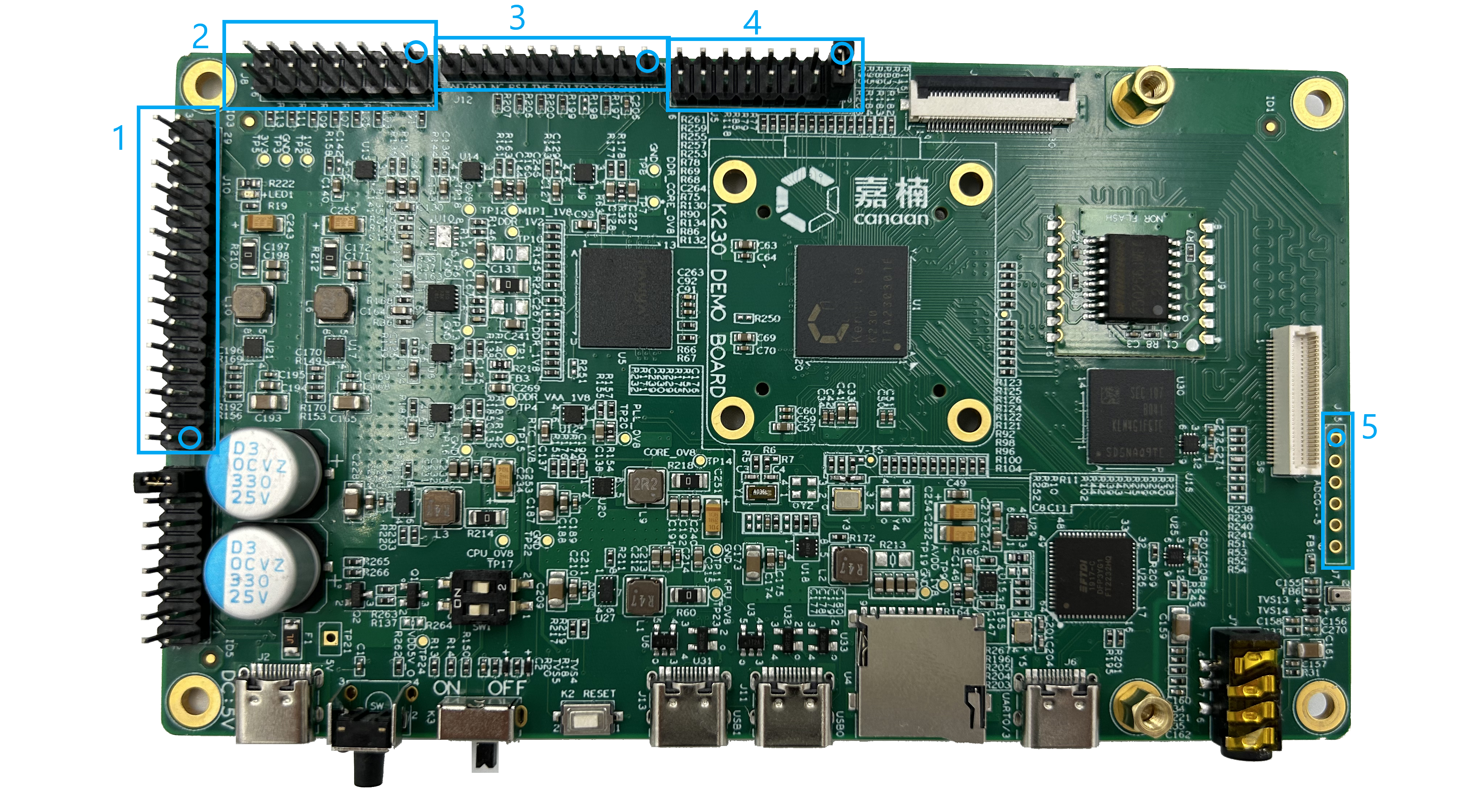

(Figure 2.7.1: Location of Pin Headers on the DEMO BOARD, with pin 1 of each pin header circled)
This area outputs power and some signals from the K230 GPIO through pin headers. The numbered components/interfaces in Figure 2.7.1 correspond to the following three main interfaces/devices (names are consistent with the list in the right image of Figure 2.1.1):

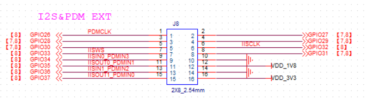

SDIO/I2S/PDM/IOMUX Expansion (Component Number on DEMO BOARD: J8) Pin headers connected to GPIO26-37 of the K230, with a corresponding IO voltage level of 1.8V. As mentioned in Section 2.5, the I2S/PDM interface digital audio adapter board listed in Section 1.3 should be placed here to convert the digital audio generated by the K230 externally. Align the female header of the sub-board with pin 1 of the pin header here to use it. The pin definitions can be found in the schematic.
(Figure 2.7.2: SDIO/I2S/PDM/IOMUX Expansion-J8 Schematic)JTAG Expansion (Component Number on DEMO BOARD: J12) Port for connecting a JTAG debugger. Use jumper wires to connect the pins on the JTAG expansion to the corresponding JTAG debugger ports. The pin definitions are shown in Figure 2.7.4.
