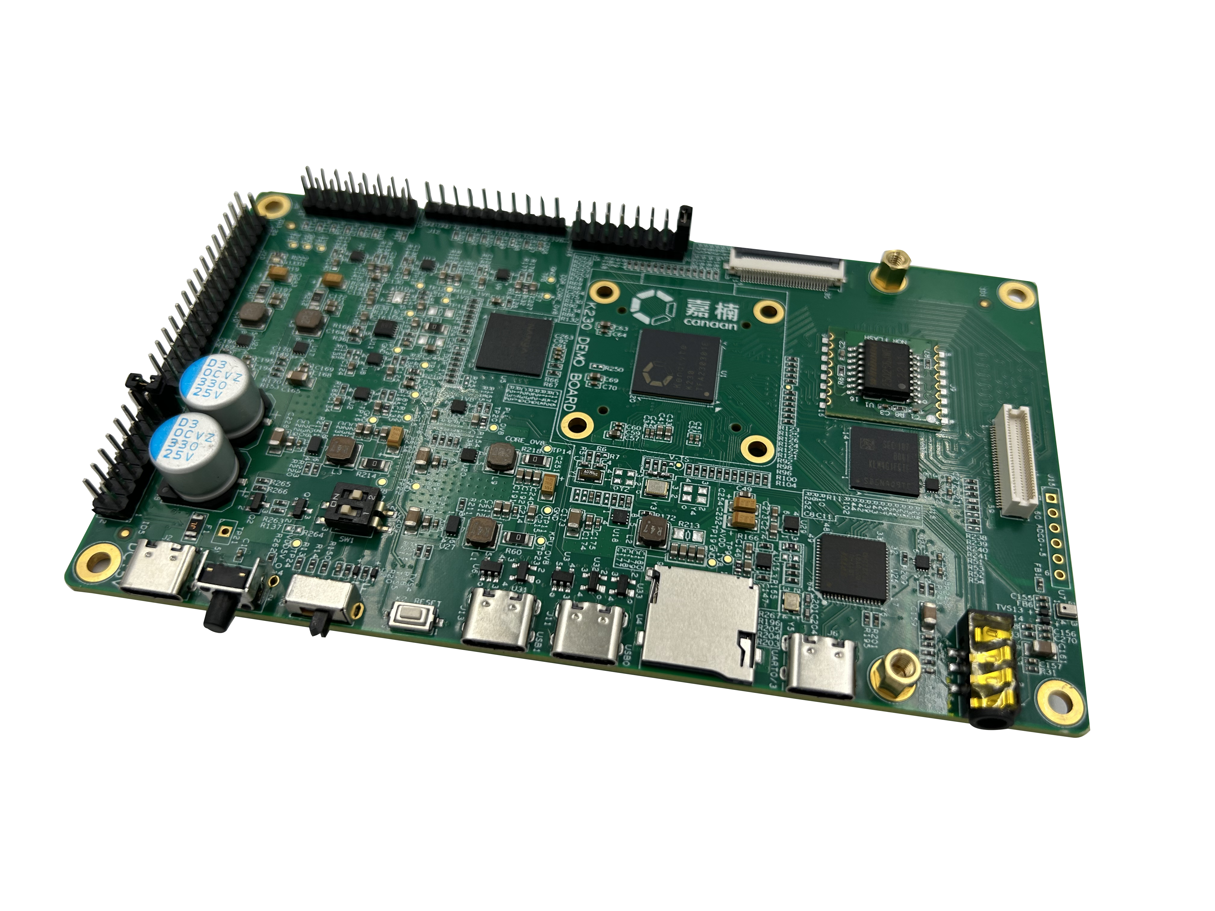

The K230 DEMO BOARD is a complete development test board with a camera daughter board and screen, which is already in the plug-and-play state, and the follow-up development work for the K230 can be started after powering on. The K230 DEMO BOARD will be delivered as a motherboard assembly with multiple daughter boards. THIS DOCUMENT WILL BRIEFLY SUMMARIZE THE COMPONENT DAUGHTER BOARDS AND USAGE PROCESS OF THE K230 DEMO BOARD through various interfaces on the motherboard.
Schematic diagram of the K230 DEMO BOARD motherboard#
SAMPLE K230 DEMO BOARD (Figure 1.2.1: Example of a K230 DEMO BOARD sample, daughter plate not assembled).

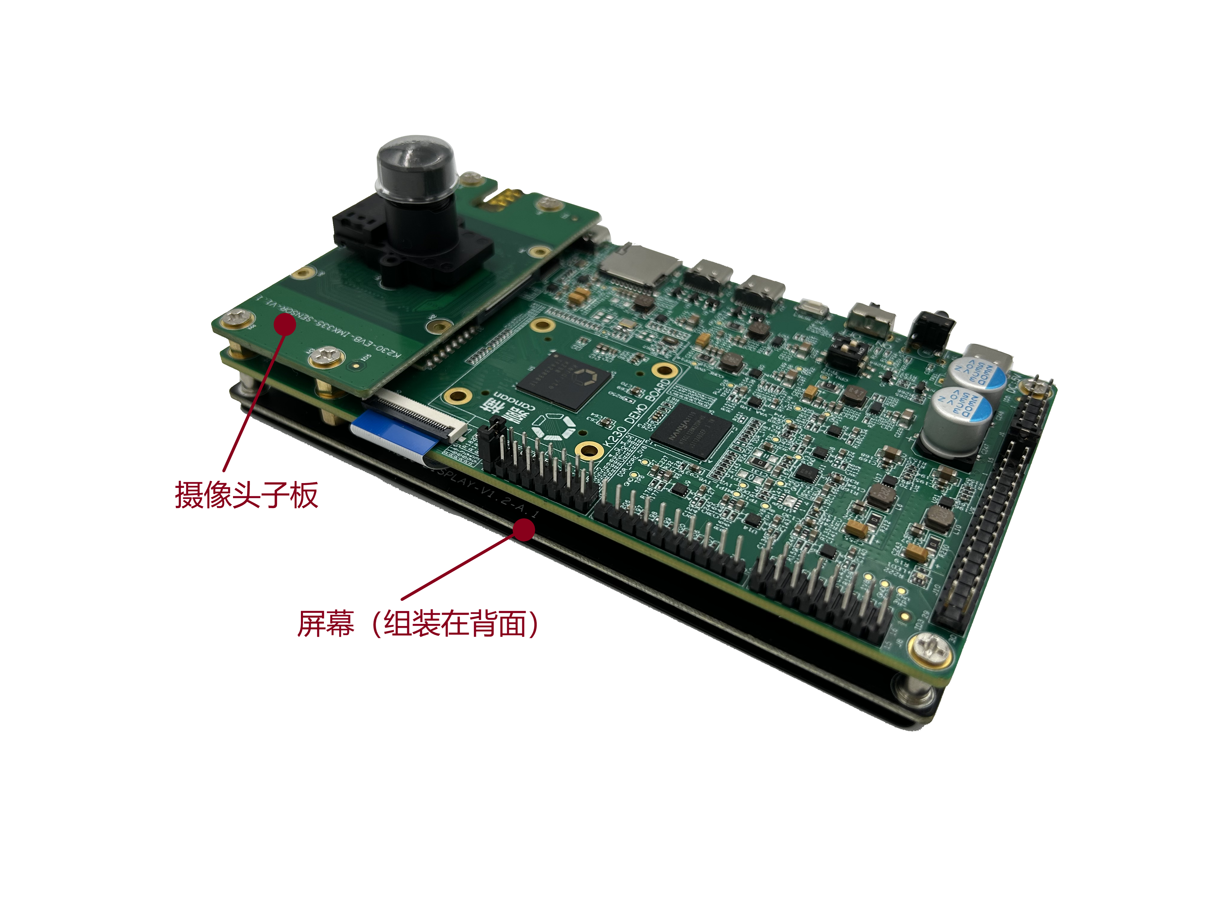

To assemble the complete DEMO board, please refer to Figure 1.3.1
K230 DEMO BOARD sample example, fully assembled (Figure 1.3.1: Example of K230 DEMO BOARD sample, fully assembled).

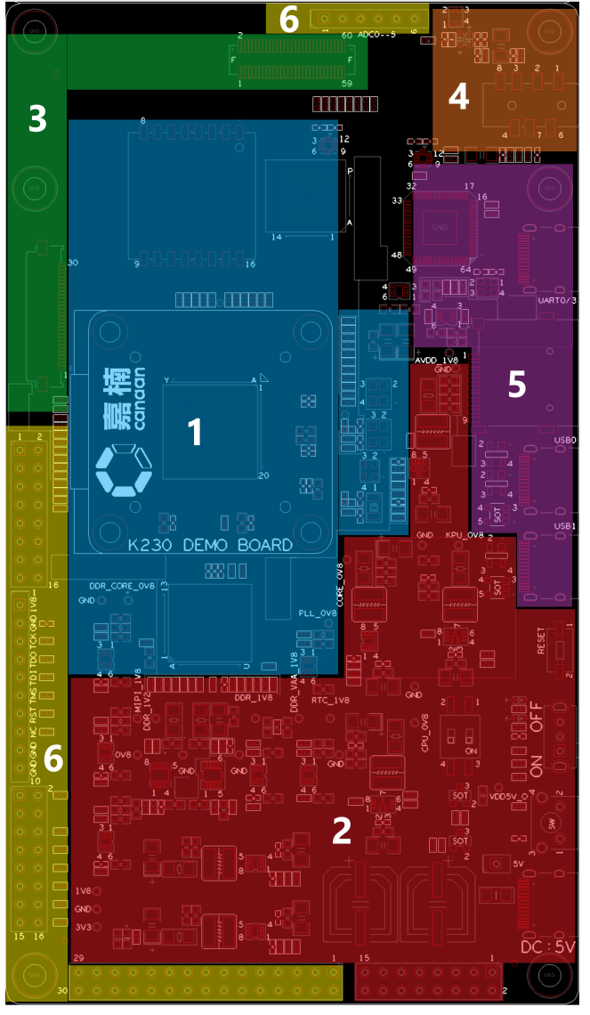

K230 DEMO BOARD functional area division ALL SUPPORTED INTERFACES CORRESPOND TO THEIR LOCATIONS ON THE DEMO BOARD (FIGURE 2.1.1: THE UPPER FIGURE IS THE FUNCTIONAL AREA DIVISION OF THE K230 DEMO BOARD, AND THE FOLLOWING FIGURE SHOWS ALL THE SUPPORTED INTERFACES AND THEIR CORRESPONDING POSITIONS ON THE DEMO BOARD).
The K230 DEMO BOARD can be roughly divided into 6 regions as shown in the left figure in Figure 2.1.1, in the order of the serial number:
  1. (Blue) Core Area - This is where the main chip K230 and its storage DDR, flash, eMMC, and system master clock are located.
  2. (Red) Power Zone - That is, the location of all power supplies on the DEMO BOARD motherboard and power control devices.
  3. (Green) Video Zone - This is where the camera is connected to the screen and motherboard.
  4. (Orange) Audio Zone - This is where the microphone and headphones are located.
  5. (purple) Generally Interface – Interface area for data exchange with other devices.
  6. (Yellow) Pin header – This area contains pins corresponding to critical signals on the DEMO BOARD, which can be used as test points or connection points to external signals, expansion daughter cards, etc.
Each region in the figure on the left contains several devices/interfaces listed in the figure on the right. The devices/interfaces covered in each area are displayed in the following order in the following sections of this section. If necessary, additional information or instructions on how to use the corresponding device/interface will be displayed.
In the case of schematic diagrams in this section, unless otherwise specified, the pins of the device package on the DEMO BOARD are exactly the same as the package pins on the schematic (referring to single and double rows, pin out order). In addition, all pin numbers mentioned and device numbers are indicated on the K230 DEMO BOARD through white silkscreen, please confirm in conjunction with the DEMO BOARD.

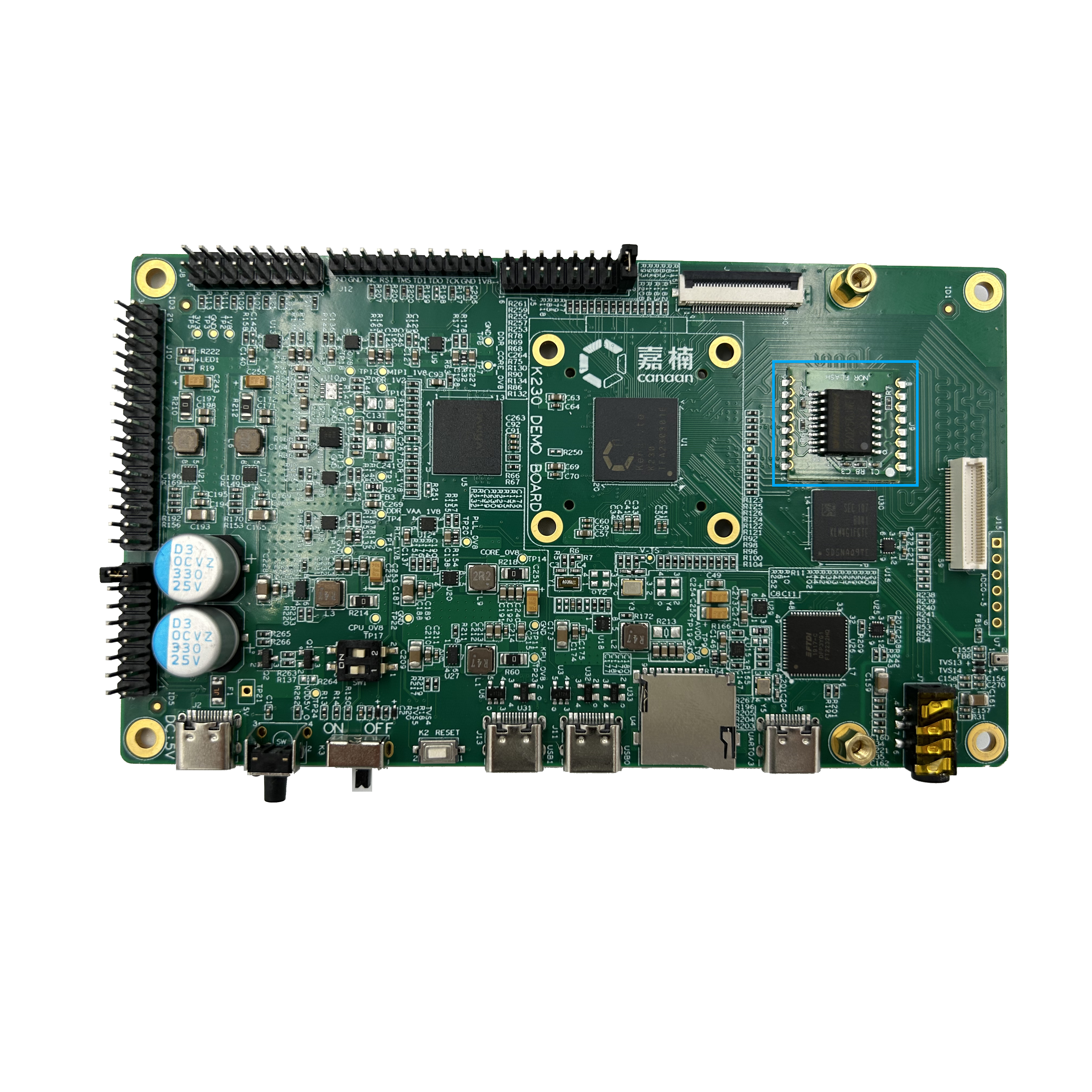

  4. Flash Extension (Part No. J9 on DEMO BOARD)
Example diagramof the flash module daughter cardFlash extension - schematic of J9 (Figure 2.2.1: The above figure is an example diagram of the flash module daughter card, pin 1 is at the upper left white point, and the following figure is the schematic of Flash Extension-J9).
THE EXTENSION OF THE FLASH OF THE DEMO BOARD HAS BEEN WELDED WITH THE VERIFIED FLASH MODULE, AND NO FURTHER CHANGES ARE REQUIRED. The selection is NOR flash OSPI interface(GD25LX256E, manufacturer: Giga Device, 256Mbits)

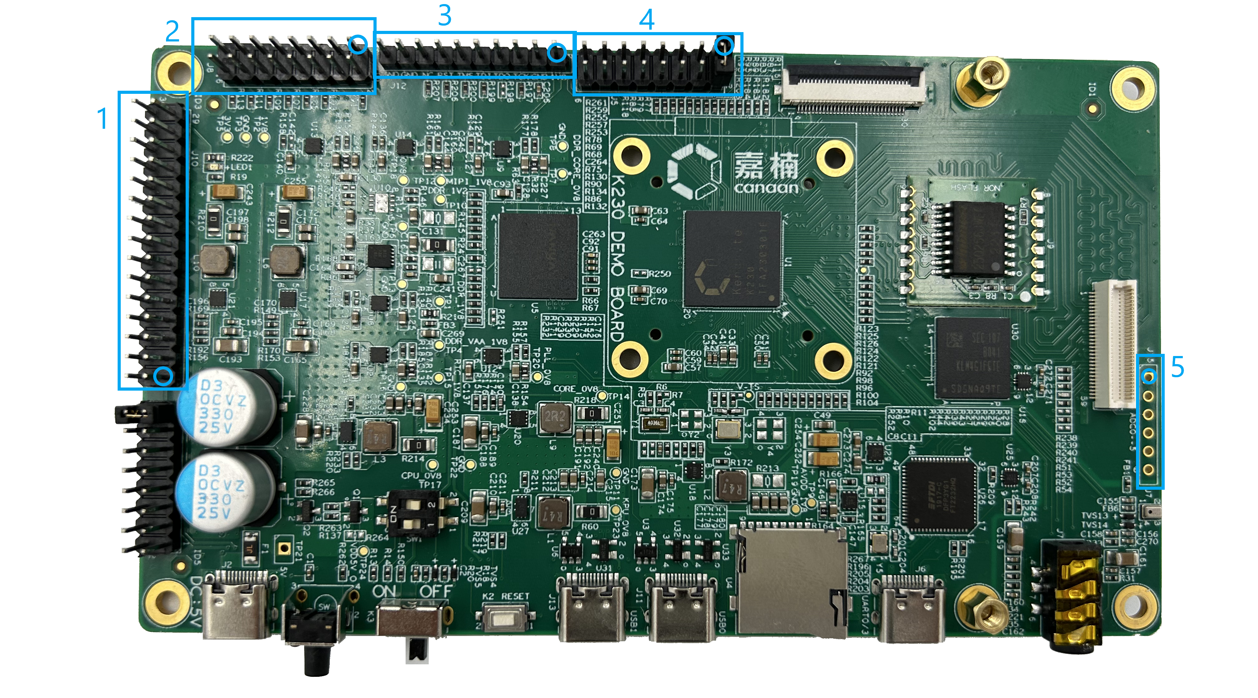

Pin header#
Pin header (FIG. 2.7.1: POSITION OF PIN HEADERS ON THE DEMO BOARD, PIN 1 OF EACH PIN HEADER IS CIRCLED).
The power supply on the board and some of the signal from the K230 GPIO are connected through the pin headers here. The numbers in Figure 2.7.1 correspond to the following three main interfaces/devices (names are consistent with the list in the right figure in Figure 2.1.1):
  1. POWER MONITORING EXTENSION (PART NUMBER J10 ON DEMO BOARD). It is an internal test interface during R&D, and does not need to be used when using K230 for product development.

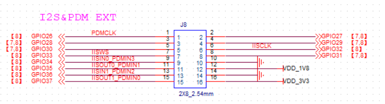

  2. SDIO/I2S/PDM/IOMUX EXTENSION (PART NUMBER J8 ON DEMO BOARD). The pin header connected to the GPIO26-37 on the K230 corresponds to an IO level voltage of 1.8V. As mentioned in Section 2.5 above, the I2S/PDM interface digital audio adapter board in the daughter card list described in Section 1.3 should be placed here for external digital-to-analog conversion of the digital audio generated by the K230. Align the daughter board’s female header with pin header pin 1 here and use it on the buckle. The pin definitions are detailed in their schematics. SDIO/I2S/PDM/IOMUX extensions (Figure 2.7.2: Schematic of SDIO/I2S/PDM/IOMUX Extension-J8).

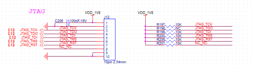

  3. JTAG EXTENSION (PART NUMBER J12 ON DEMO BOARD). Connect the port to the JTAG debugger. When in use, use a DuPont cable to connect the pins on the JTAG extension to the corresponding JTAG debugger port. Its pins are defined in Figure 2.7.4 JTAG extension (Figure 2.7.3: Pin-defined schematic for JTAG extension with data lines pulled up to 1.8V through 10K resistors).

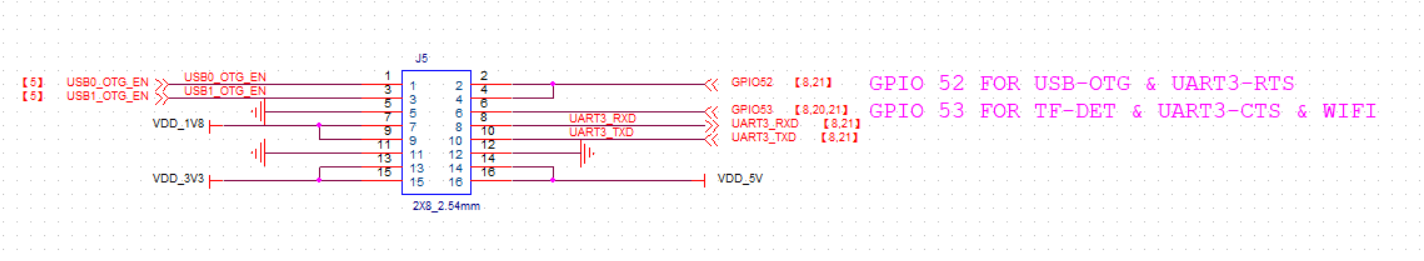

  4. IOMUX/Power Extension (J5 on DEMO BOARD). The control pin of the USB and serial ports can change the mode of the two USB interfaces mentioned in Section 2.6 by shorting the J5 part pins. The pin definition for J5 is shown in Figure 2.7.5 If USB0 is required as HOST, or when used to transfer to Ethernet, pin 1,2 of J5 needs to be shortened with a jumper cap, and pin 1,2 is kept open when used as DEVICE. (Shorted by default at the time of delivery) Correspondingly, USB1 is used as HOST, or when used to convert to Ethernet, add jumping caps on pins 3 and 4 of J5. (Not shorted by default when delivered) In addition, pins 8 and 10 can be used as additional debug serial ports with UART_RX and UART_TX, respectively. IOMUX/Power Extension (Figure 2.7.4: Schematic of IOMUX/Power Extension-J5).
  5. ADC extension (J15 on demo board). The K230 has a total of 6 ADC inputs leading out to J15, which can collect sensor data or feedback signals according to the needs of the application. The input location of the ADC is located next to the MIPI CSI interface. Please note that ADC5 (the second hole in the lower right of Figure 2.7.1) is multiplexed with the headphones, and the ADC input will always be grounded and cannot be used properly when the headphones are not connected. If ADC5 does not read, plug the headphones into the headphone jack.
