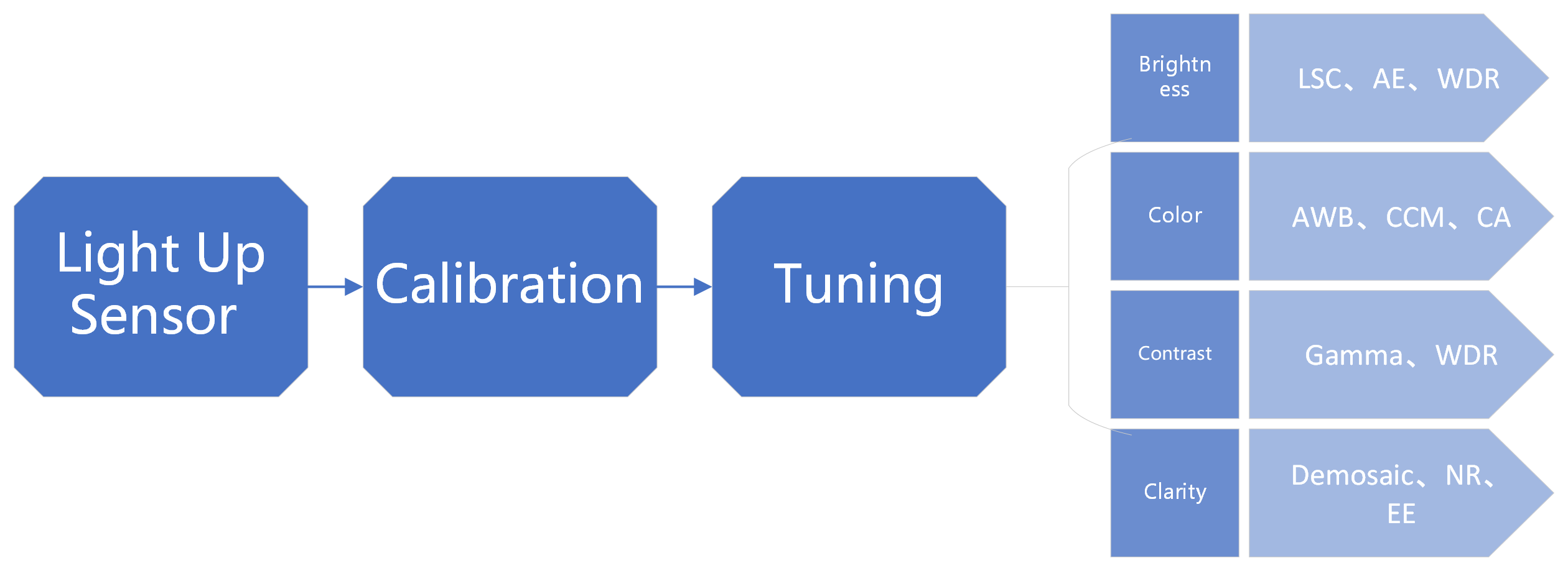

When it comes to image tuning, brightness, color, contrast, and clarity are our main concerns. Through the calibration of the sensor and lens and the joint tuning of the ISP submodule, the overall brightness of the image is reasonable, the color reproduction in the image is accurate, the clarity of the image is good, there is no obvious noise, the contrast of the image is high, and the overall appearance is relatively transparent.
The overall image tuning process is as follows:
flow

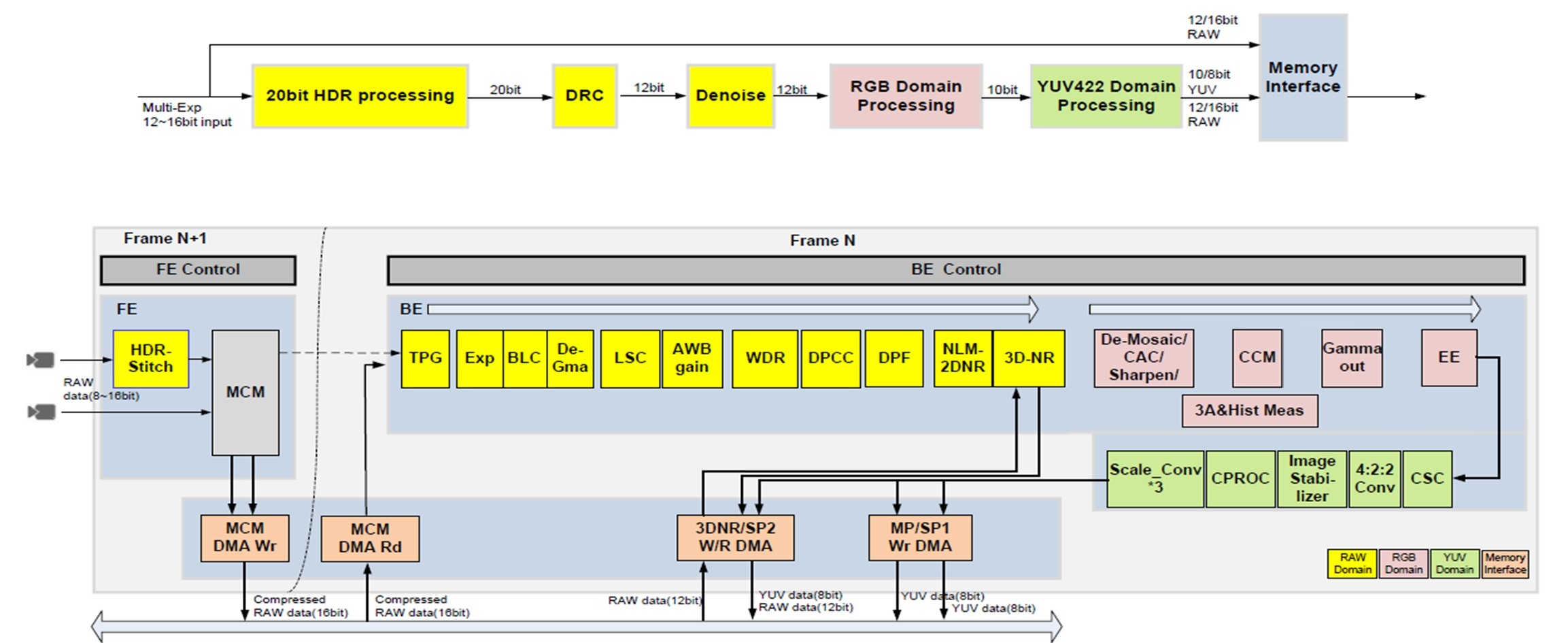

K230 ISP pipeline as following figure: flow

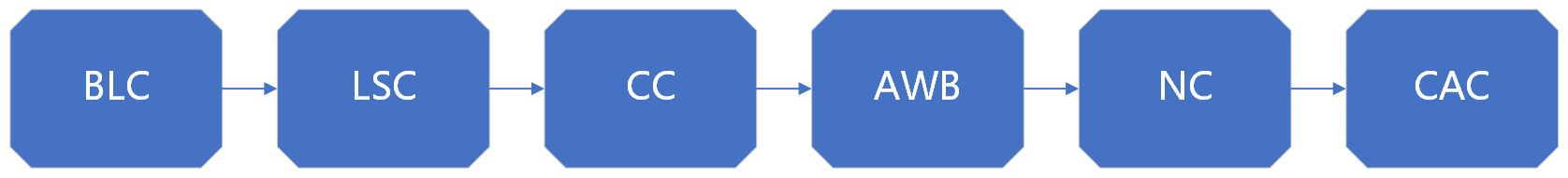

The calibration sequence of the modules is as follows:
flow

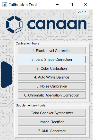

The main interface of the calibration tool is shown in the figure below.
image-20230821114715137
Click the corresponding module button to jump directly to the calibration interface of each module to start calibration.

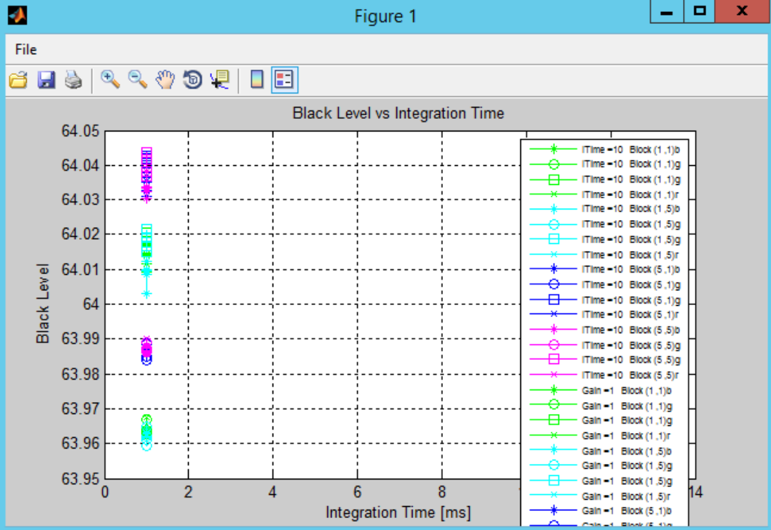

After calibration, the chart of Black Level vs Integration Time is shown in the figure below.

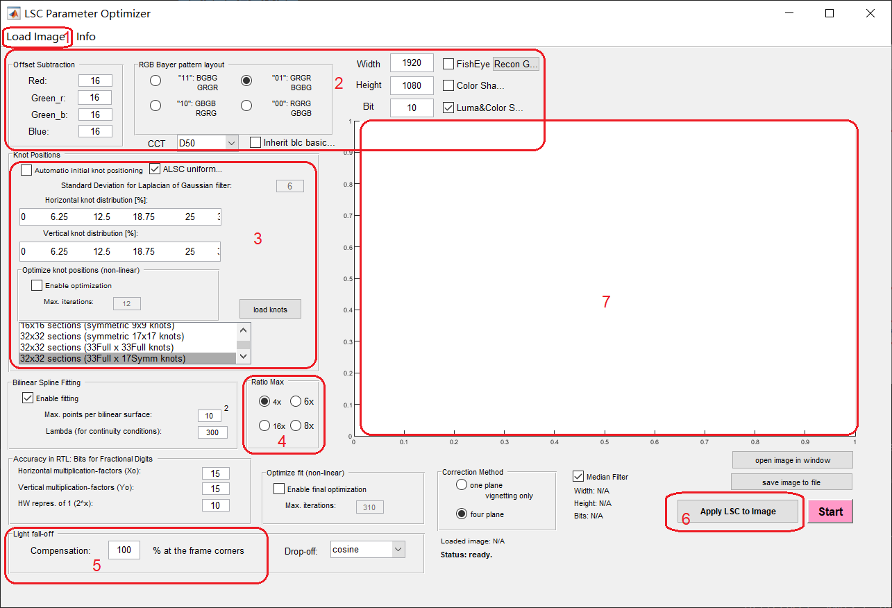

Start calibration using the calibration tool#
When you click “Lens Shade correction” on the main interface, the tool will pop up the dialog box as shown in the figure.
image-20230821163641202
Specific operation steps:
  1. In Region 2, check the bayer pattern type of the RAW image, fill in the image width, height, and bit width, check the type of LSC correction required (Color Shading or Lumi&Color Shading), check the color temperature light source in the CCT drop-down menu, and fill in the Black Level Offset value for each channel in the offset Subtraction column;
  2. Click the “load image” button in Region 1 to import the RAW image to be calibrated;
  3. Region 3 is set for LSC knot positions. First, determine the number of grids. The hardware statistics of K230 ISP LSC are 32x16 grids, so “33Full x 17Symm knots” can be selected for calibration; If you plan to use the ISP ALSC function, check “ALSC uniform…”; If “Automatic initial knot positioning” is checked, the ALSC function cannot be enabled in auto.json.
  4. Region 4 selects the maximum calibration ratio of the center/corner;
  5. Region 5 can set the compensation ratio of the corner (if it is set to 80%, it means that the brightness of the corner to be calibrated is 80% of the center brightness.);
  6. Keep the other settings as default;
  7. Click “Start” to start calibration and save LSC data;
  8. Region 6 selects the calibrated LSC data to apply to the image, preview the calibration effect, and click “save image to file” to save the Png image under each light source.
Note: When setting the compensation ratio in step 5, it should be determined according to the severity of the shading of the lens. When the lens shading is very serious, the gain of the four corners of the picture compensation is very large, which is easy to cause the noise of the four corners to become larger. At this time, it is necessary to reduce the compensation ratio to achieve the purpose of optimizing the four-corner noise.

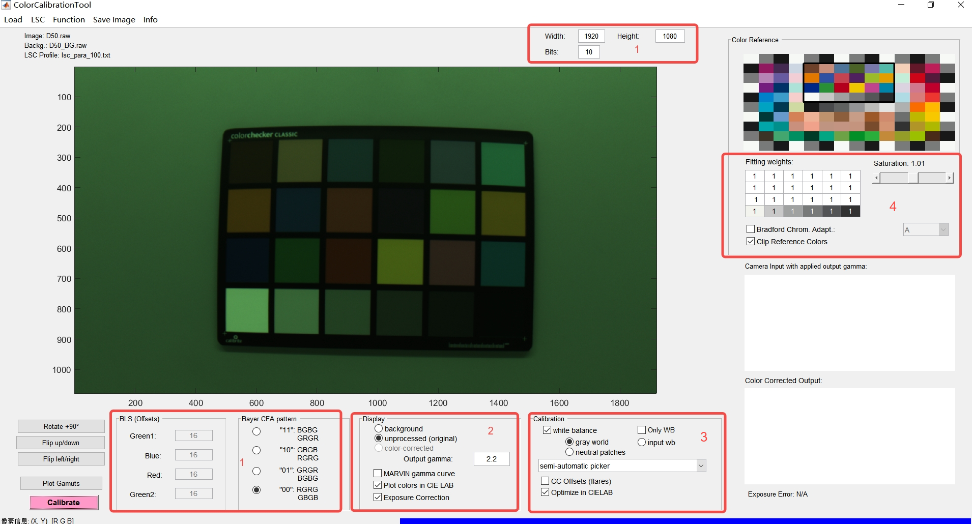

When you click “Color Correction” on the main interface, the tool will pop up the dialog box as shown in the figure.
image-20230822111931692
The specific operation steps are as follows:
  1. Set the width, height, bit width, Black level Offset, and bayer pattern of the RAW image in area 1;
  2. Click the “Load” option to import color checker reference file CC_Standard.cxf(click “Load sRGB References”,this cxf file is located in the director of calibration tool Canaan.Calibration.Samples\Data), 24-color card RAW image(click “Load Color Checker Image”), gray wall background RAW image(click “Load Background Image”);
    Import reference color checker, and you can also obtain the Lab values of customer reference through the “Load Lab Customer References” option under the “Load” option; Alternatively, you can use the “Load References Image” option under the “Load” option to access the reference color checker image file, and then select “Select Reference Color Checker” under the “Function” option. Move the mouse to control the crosshairs so that they are located at the center of the four corners color blocks. Click the mouse one by one to complete the area selection of the reference color checker.
  3. Click the “LSC” button to import the calibrated LSC parameter file;
  4. Configure calibration parameters;
    • Set up gamma
    • Check CIELAB Reference
    • Configure the 24-patch weight
    • Set the preferred light source
    • Set the output saturation, which defaults to 1
  5. Select the way to select 24 color blocks in the drop-down key of area 3 (there are three modes: automatic, semi-automatic and manual);
    At semi-automatic mode, move the mouse to control the crosshairs so that they are located at the center of the four corners color blocks. Click the mouse one by one to complete the area selection of the reference color checker.
  6. Click “Caibrate” to start calibration.

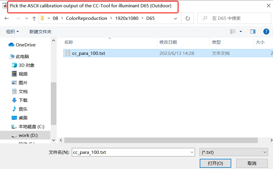

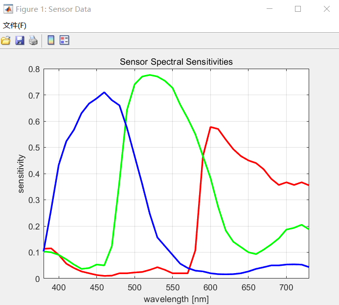

  1. Click the “file” button to import the sensor spectral sensitivity file, as shown in the following figure;
    image-20230822152530065
    Note: If the user does not have the sensor spectral sensitivity file they are using, use the default OV2775_sensitivity.txt (this txt file is located in the director of calibration tool Canaan.Calibration.Samples\Data) in the toolkit. Because AWB calibration now does not depend on the sensor spectral sensitivity file, but in order not to affect the subsequent operation, so import any sensor spectral sensitivity file.

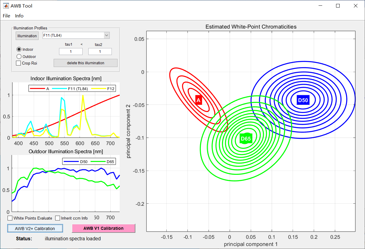

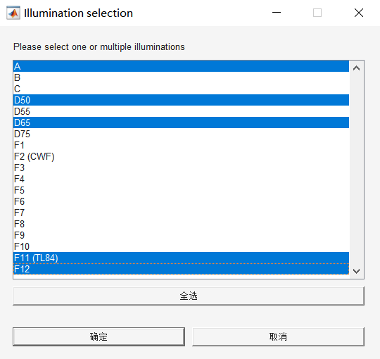

  2. Click the “illuination” button, import the light file CIE_Illuminants.cxf (this cxf file is located in the director of calibration tool Canaan.Calibration.Samples\Data), and select the light sources to be calibrated (at least 3), as shown in the figure. Click the “OK” button, the spectral release of each light source will be displayed on the left as shown in the figure, and each light source will be divided into indoor light source and outdoor light source by drop-down key.
    image-20230822152740591
    image-20230822154937933

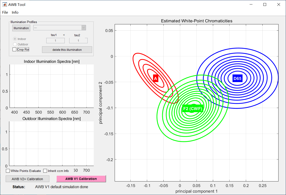

  3. Click the “AWB V2+ Calibration” button(please click the “Start Calibration” button in old version calibration tool) and select the parameter file of each light source generated by CC calibration as shown in the red box of the figure;

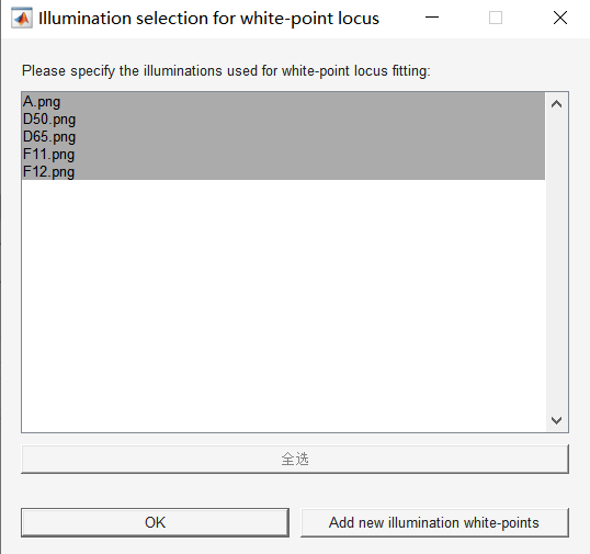

  5. Click the “Gain Region Modifier” button, select the png picture of each light source saved in the LSC calibration, as shown in the figure, click “OK” to enter the next step;
    image-20230822162343131

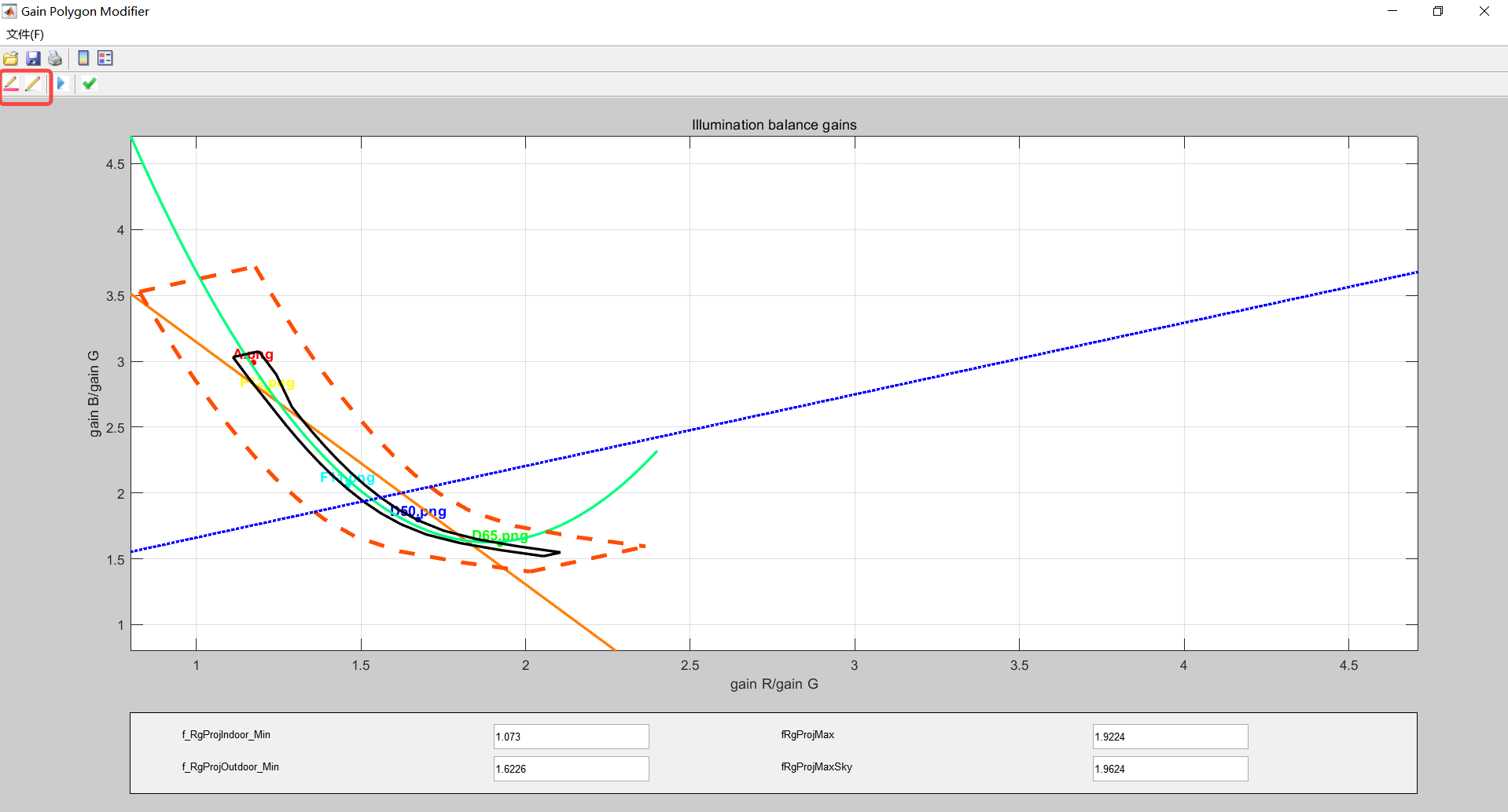

  6. Define the starting point range size of the gain polygon, as shown in the figure, click the “OK” button to enter the next step;
    image-20230822162723170
  7. Manually adjust the range of the orange box (near the white area) and the black box (all identified as white points in the black box) through the button in the red frame area, and adjust the range of the black box to include all the selected white points of the light source, as shown in the figure. Save the data and, if the test fails, resize the polygon.
    image-20230822164058879

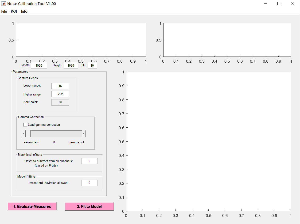

Noise Calibration#
The principle and significance of Noise Profile calibration#
Noise Profile calibration involves the quantitative measurement and characterization of the noise characteristics generated by the sensor under different conditions. This is because, when sensors operate at different light, temperature, or ISO settings, they generate different types and magnitude of noise. Understanding the characteristics of these noises is key to effective noise reduction or correction.
Noise Profile calibrated to acquire RAW images#
When performing CC calibration, the steps to acquire RAW images are as follows:
  1. Place the black and white gradient test card on the inner wall of the standard light box, open the light box and select the D50 color temperature light source;
  2. Turn off AE, change to manual exposure mode, and collect two sets of RAW images, each group of 30 pictures;
    • Light group: adjust the brightness of the light box, maintain the exposure time, keep gain 1x unchanged, so that the black area of the gradient card is in the middle gray value;
    • Dark group: Adjust the brightness of the light box, maintain the exposure time, keep the gain 1x unchanged, so that the gradient card white area is in the middle gray value.
When you click “Noise Calibration” on the main interface, the tool will pop up the dialog box as shown in the figure.
image-20230822170824745
  1. Set the width and height, bit width, and black level offset of the RAW image;
  2. Click the “flie” button to import two sets of light and dark RAW image series;
  3. Click the “ROI” button to set the ROI of the image;
  4. Adjust the parameters. For the Lowlight histogram, take the histogram area from Lower range to Split point; for the Highlight histogram, take the histogram from Split point to Higher ranger, and the superposition area of the two should basically cover all value intervals (8bit width) of 0~255. For the selection of Split point and high range value points, the reserved areas of hightlight and lowlight should be made to conform to the Poisson distribution. If black level offset is set, Lower range >= black level;
  5. Gamma correction and Model Fitting require no setup;
  6. 点击“Evaluate Measures”;
  7. Click “Fit to Model” again to complete the Noise calibration and save the result.

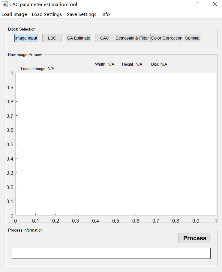

When you click “Chromatic Aberration Correction” on the main interface, the tool will pop up the dialog box as shown in the figure.
image-20230822192525126
  1. Click the “Demosaic & Filter” button and set the bayer pattern format;
  2. Click the “load image” button to load the RAW image, and the image can be displayed in the preview window;
  3. Set the parameters under the “Demosaic & Filter” interface;
    Because the CAC module comes after demosaic, the tool implements a simple demosaic function here.
    • ISP_demosaic_threshold: The default value for the threshold is set to 4. A higher value is set, the edge detection algorithm detects fewer edges, a lower value results in more edges being detected, and a value of 255 indicates that edge detection is completely disabled.
    • Simulate 2 additional Line Buffers: Allows the user to extend the vertical offset. This allows vertical vector clipping to be set to +-3. In this case, filtering that reduces chromaticity is not performed, and it is not checked by default.
    • Filter stage1 select:
    • Sharpen Level:
    • Denoise Level:
    • Lum_weight Off: A special feature that allows the filter algorithm to be deactivated. This feature helps suppress noise that is stronger in dark areas than in light areas. Due to nonlinear gamma correction, in the processing chain, contrast and noise are emphasized in dark areas and attenuated in bright areas. To compensate for this, the texture parameters are weighted using a function derived from the average brightness of the 5x5 core before comparing them to the threshold. By default, it is not checked, and the image preview effect has little noise.
  4. Click the “Color Correction” button to set the parameters under this interface;
    • Check “ISP_bls_enable” to set the correct BLC;
    • Check “Auto White-Balance”;
    • Set up CCM;
    • Global gain is set to 1.0 by default.
  5. Click the “Gamma” button to set the gamma curve, the default setting is gamma 2.2;
  6. Click the “LSC” button, and then click “Load parameters” to load the LSC calibration parameters under the corresponding light source D50 and check “Enable”;
  7. Click the “CA Estimate” button, check the “CA_Estimate” box, and click “Process” to run;

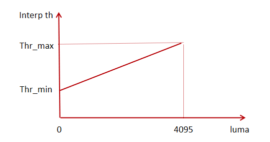

dmsc_dir_thr_min
int 0~4095
Dark area G channel interpolation
dmsc_dir_thr_max
int 0~4095
Bright area G channel interpolation

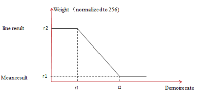

dmsc_demoire_area_thr
int 0~32
The threshold of demolar area is greater than the threshold before the demoliré treatment is performed
dmsc_demoire_enable
bool
demoire enable switch
dmsc_demoire_r1
int 0~255
moire elimination intensity curve parameters
dmsc_demoire_r2
int 0~255
dmsc_demoire_t1
int 0~255
dmsc_demoire_t2_shift
int 0~8
demoire_edge_r1
int 0~255
moire conversion curve parameters
demoire_edge_r2
int 0~255
demoire_edge_t1
int 0~511
demoire_edge_t2_shift
int 0~9
dmsc_demoire_sat_shrink
int 0~32
The higher the value, the stronger the saturation reduction in the moire area

  1. interpolation
    For 12-bit raw, the interpolated Threshold corresponding to the value 0 is dir_thr_min, the interpolated Threshold of the value 4095 is dir_thr_max, and the value in the middle corresponds to the Threshold on the dir_thr_min and the line segment determined by the dir_thr_max.
    image-20230828143338539
    demosaic_thr settings: gradient difference> threshold, direction interpolation; gradient difference< threshold, mean interpolation. Smaller values mean more false colors in high-frequency regions.

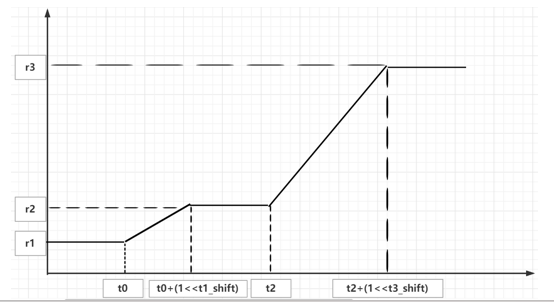

  2. Sharpening and noise reduction
    denoise_strength indicates the intensity of low-frequency noise filtering, and when set to 0, it is equivalent to turning off the noise reduction function. In general, the noise reduction function is turned off in the demosaic module, and only when the noise of the image is particularly large, the noise reduction is used here.
    Setting of sharpening curve parameters: The steeper the curve, the greater the sharpening intensity.
    image-20230828145740677
    sharpen_line settings: When the noise of the image is relatively large, if you want to make the edges smooth and continuous, you can open the sharpen_line. The basic effect of sharpen_line is to smooth lines or textures vertically or horizontally. The larger the vertical axis sharpen_line_r1, the larger the sharpen_line_r2, the closer the sharpening result is to directional (horizontal or vertical) enhancement. In addition, more points are incorrectly connected, which can lead to errors in high-frequency details.
    sharpen_factor&Clip setting: The higher the factor value, the stronger the sharpening effect; the larger the clip value, the weaker the truncation effect and the more detail is preserved. Factor>clip settings should be avoided as much as possible, so that black and white detail is kept low, and sharpening intensity is high, resulting in no sense of layering.
  3. Demoire
    moire transition curve:
    image-20230904094148683
