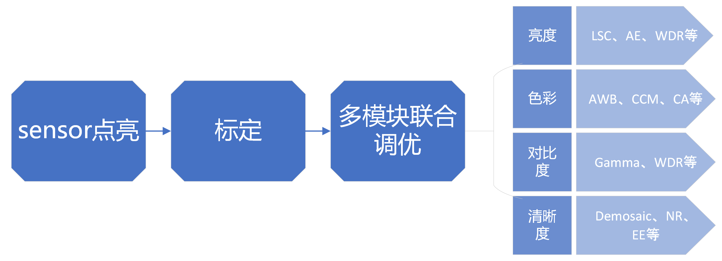

When tuning images, brightness, color, contrast, and clarity are our main focus areas. Through calibration of the sensor and lens and joint tuning of ISP sub-modules, we aim to achieve reasonable overall brightness, accurate color reproduction, good image clarity without obvious noise, high image contrast, and an overall transparent look.

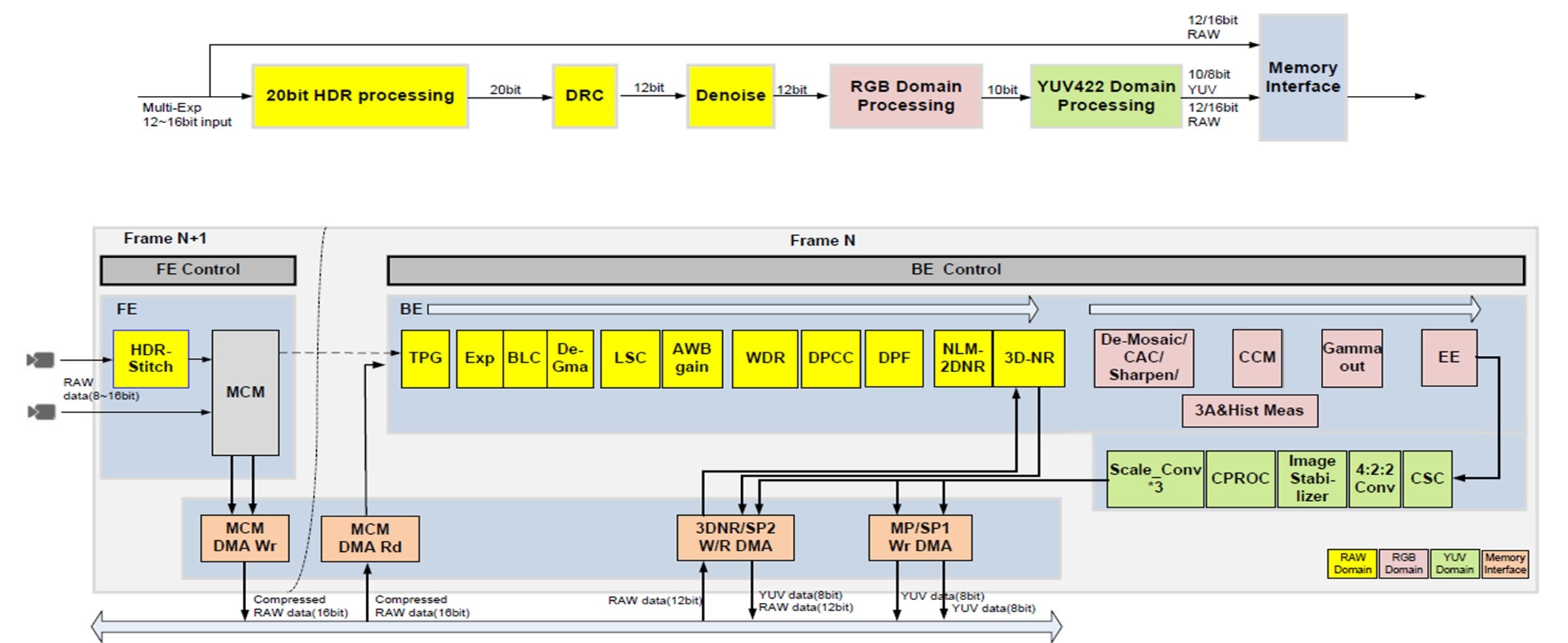

The overall image tuning process is shown in the following figure:
flow
The K230 ISP pipeline is shown in the following figure: flow
Please note:
  • In K230 HDR mode, the K230 CSI (Camera Serial Interface) module does not support sensor data modes where Hsync precedes Vsync, and there should be no overlap when each frame (L/S/VS) Vsync is high (valid data output).
  • When enabling TNR in 3DNR, the ISP requires the sensor Hblank to be no less than 180 pixel clocks (it is recommended to set it to no less than 256 pixel clocks). Recommendation: Frame length – Active lines >= 92 lines.
K230 ISP pipeline as following figure: flow

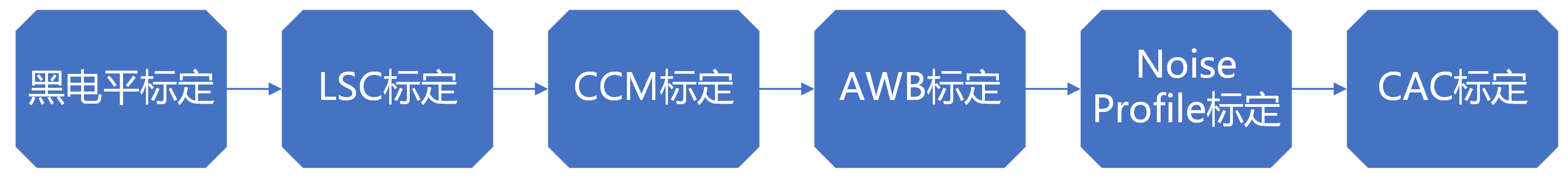

The calibration sequence of the modules is as follows:
flow

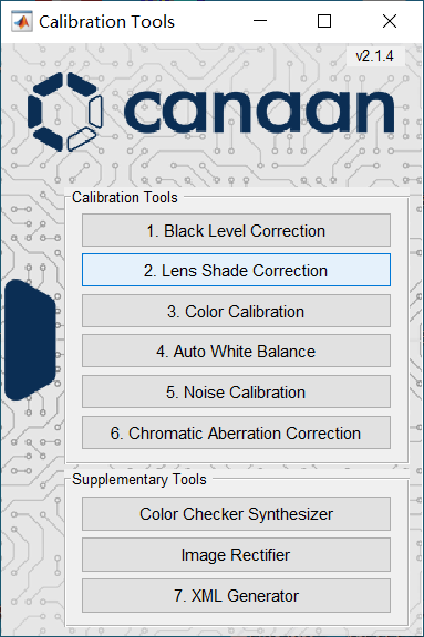

Before using the calibration tool (K230ISPCalibrationTool.exe), users need to pre-install MATLAB Runtime (R2023a). Download link: https://ssd.mathworks.com/supportfiles/downloads/R2023a/Release/0/deployment_files/installer/complete/win64/MATLAB_Runtime_R2023a_win64.zip
The main interface of the calibration tool is shown below.
image-20230821114715137
Click the corresponding module button to directly jump to the calibration interface of each module and start calibration.

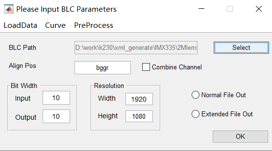

Starting Calibration Using the Calibration Tool#
When the “Black level correction” button is clicked on the main interface, the tool will pop up a dialog box as shown below.
image-20230821145452924
Steps:
  1. Click the “Select” button to choose the folder where the RAW images are saved.
  2. Fill in the RAW image’s Bayer pattern in the “Align Pos” text box.
  3. Set the input and output Bit Width.
  4. Set the resolution: the width and height of the image.
  5. Click the “OK” button to start calibration.
Among them:
  1. Combine Channel text box: If checked, it means the BLC obtained by the user is the combined measurement value of the R, Gr, Gb, and B channels.
  2. Normal File Out / Extended File Out: If Normal File Out is checked, it means the output is blc_para.txt; if Extended File Out is checked, the BLC of the R, Gr, Gb, and B channels will be output separately according to different exposure times and Gains.
After calibration, the Black Level vs Integration Time chart is shown below.

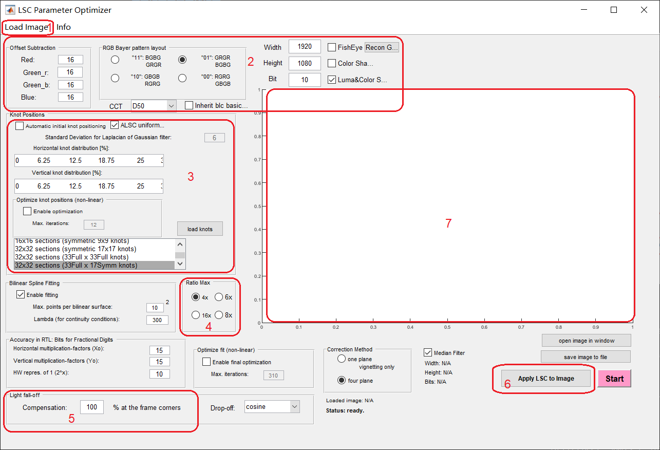

When the “Lens Shade correction” button is clicked on the main interface, the tool will pop up a dialog box as shown below.
image-20230821163641202
Specific steps:
  1. In area 2, select the Bayer pattern sorting of the RAW image, fill in the image width and height, bit width, select the type of LSC correction needed (Color Shading or Luma & Color Shading), select the corresponding color temperature light source in the CCT drop-down menu, and fill in the Black Level Offset values of each channel in the offset Subtraction field.
  2. Click the “load image” button in area 1 to import the RAW image to be calibrated.
  3. Area 3 is for setting the LSC grid nodes. First, determine the number of grids. The K230 ISP LSC hardware statistics are 32x16 grids, so you can choose “33Full x 17Symm knots” for calibration. If you plan to use the ISP ALSC function, check “ALSC uniform…”. If “Automatic initial knot positioning” is checked, ALSC function cannot be enabled in auto.json.
  4. In area 4, you can select the maximum calibration ratio of the center/corner.
  5. In area 5, you can set the compensation ratio of the corners (e.g., if set to 80%, it means the brightness of the corners after calibration needs to be 80% of the center brightness).
  6. Other settings can be kept as default.
  7. Click “Start” to start calibration and save the LSC data.
  8. In area 6, you can choose to apply the calibrated LSC data to the image, preview the calibration effect, and click “save image to file” to save the Png images under each light source.
Note: When setting the compensation ratio in step 5, it should be determined based on the severity of the lens shading. When the lens shading is severe, the gain of the four corners after compensation is large, which can easily cause noise in the four corners. In this case, reduce the compensation ratio to optimize the noise in the four corners.

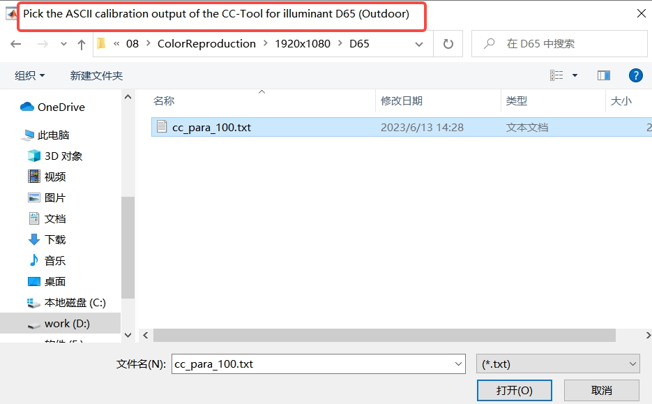

  2. Click the “Load” menu to sequentially import the color reference file CC_Standard.cxf (Load sRGB References, this file is located in the Canaan.Calibration.Samples\Data\ directory of the calibration tool), 24-color card RAW image (Load Color Checker Image), and gray wall background RAW image (Load Background Image).
    To import the reference color card, besides importing CC_Standard.cxf through “Load sRGB References,” you can also get the customer’s custom reference color card Lab values through “Load Lab-Customer References” under the “Load” menu; or load the reference color card image through “Load References Image” under the “Load” menu, then select “Select Reference Color Check” under the “Function” menu, and control the crosshair by moving the mouse to position it at the center of the four color blocks at the upper left, upper right, lower left, and lower right corners of the given color card image, and click the mouse sequentially to complete the specification of the reference color card area.

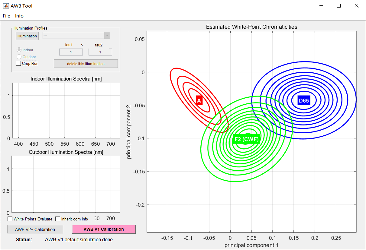

Auto White Balance#
Basic Principle and Significance of AWB Calibration#
AWB calibration involves calculating the best Planckian fit curve and color temperature fit curve based on the white point characteristics (R/G, B/G) of the sensor under several standard light sources. The purpose of AWB calibration is to enable the camera to automatically recognize and adapt to various color temperature light source conditions, ensuring accurate reproduction of white and other colors in the image.
When the “Auto White Balance” button is clicked on the main interface, the tool will pop up a dialog box as shown below.
image-20230822142135073
The specific steps are as follows:

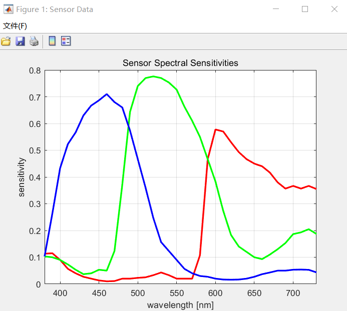

  1. Click the “file” button to import the sensor spectral sensitivity file, as shown below:
    image-20230822152530065
    Note: If the user does not have their own sensor spectral sensitivity file, they can use the default OV2775_sensitivity.txt included in the toolkit (this file is located in the Canaan.Calibration.Samples\Data\ directory of the calibration tool). Although AWB calibration no longer relies on the sensor spectral sensitivity file, any sensor spectral sensitivity file can be imported to proceed with the following steps without issues.

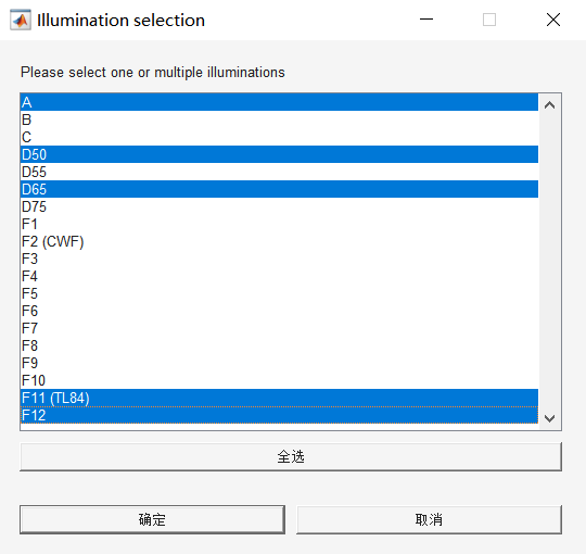

  2. Click the “illumination” button to import the light source file CIE_Illuminants.cxf (this file is located in the Canaan.Calibration.Samples\Data\ directory of the calibration tool) and select the light sources to be calibrated (at least three), as shown below. Click the “OK” button to display the spectral distribution of each light source on the left side as shown below and classify each light source as indoor or outdoor using the dropdown menu.
    image-20230822152740591
    image-20230822154937933

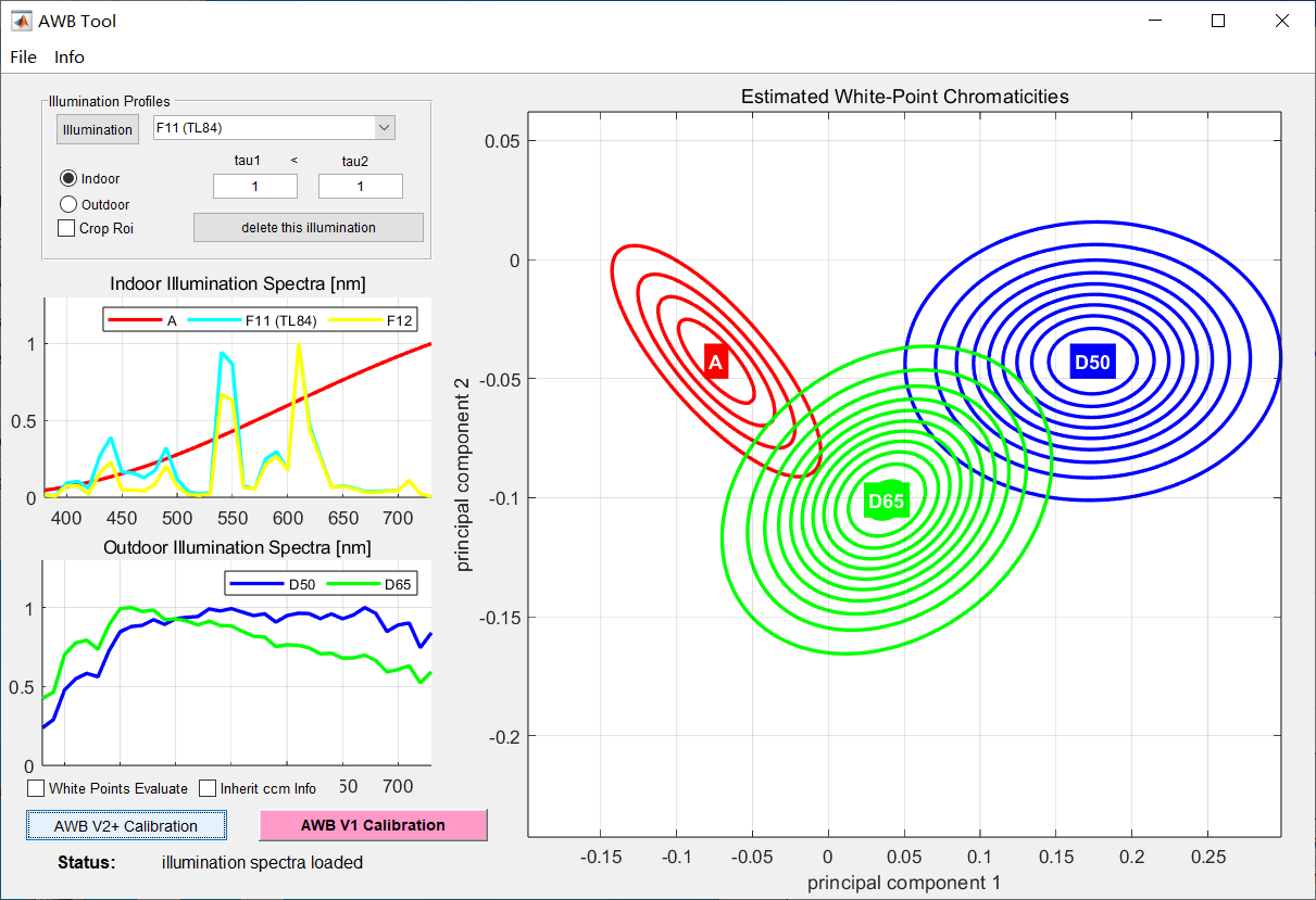

  3. Click the “AWB V2+ Calibration” button (in older versions of the calibration tool, click the “Start Calibration” button), and select the parameter files of each light source generated from CC calibration as shown in the red box below:
    image-20230822155713505
  4. Check the “White Points Evaluate” box and select an image for white point estimation.

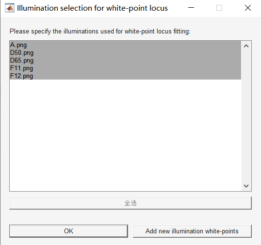

  5. Click the “Gain Region Modifier” button, select the PNG images of each light source saved during LSC calibration, as shown below, and click “OK” to proceed to the next step:
    image-20230822162343131
  6. Define the starting range size of the gain polygon, as shown below, and click the “OK” button to proceed to the next step:
    image-20230822162723170

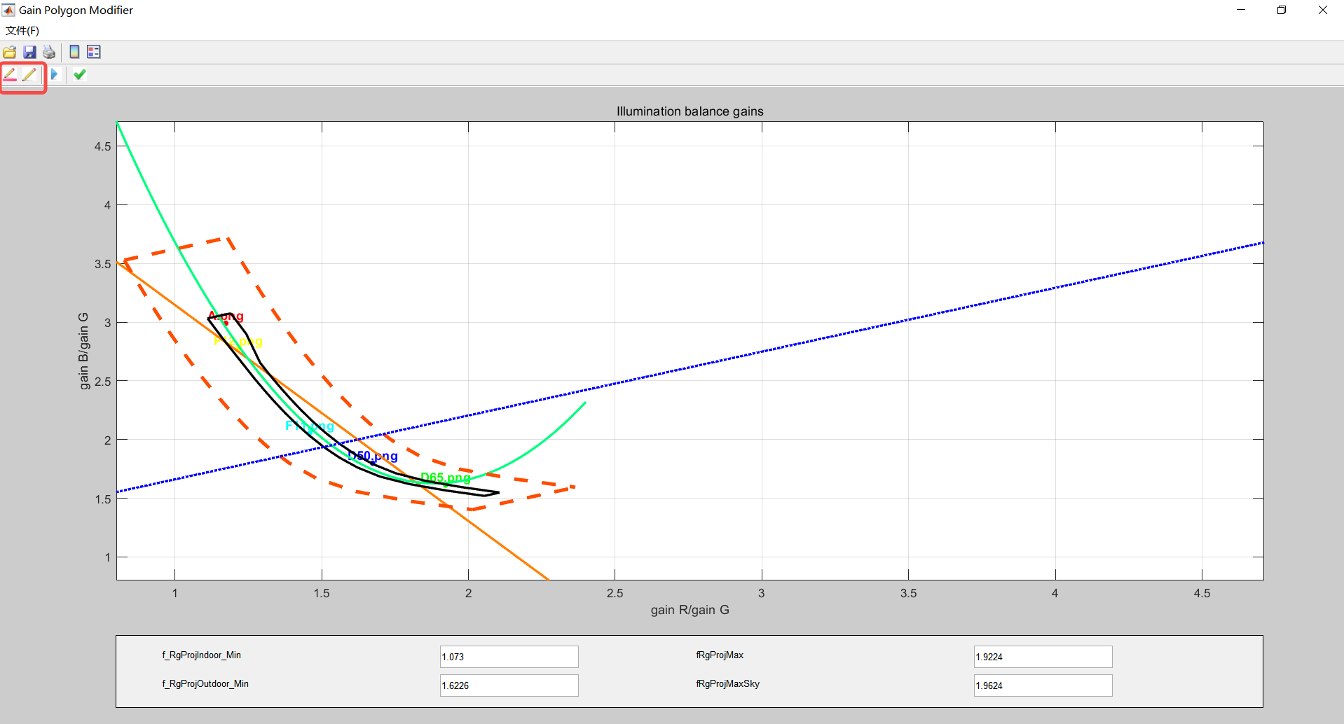

  7. Manually adjust the range of the orange box (near white area) and the black box (all points within the black box are recognized as white points) using the buttons in the red box area, adjust the black box range to include the white points of all selected light sources, as shown below. Save the data, and if the test fails, readjust the polygon range.
    image-20230822164058879

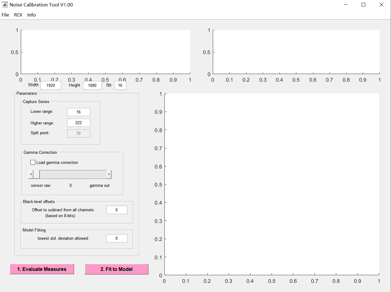

When the “Noise Calibration” button is clicked on the main interface, the tool will pop up a dialog box as shown below.
image-20230822170824745
  1. Set the width, height, bit width, and Black Level Offset of the RAW image.
  2. Click the “file” button to import the bright and dark series of RAW images.
  3. Click the “ROI” button to set the ROI of the image.
  4. Adjust the parameters. For the Lowlight histogram, select the histogram area from the Lower range to the Split point; for the Highlight histogram, select the histogram area from the Split point to the Higher range. The combined area should cover all values from 0 to 255 (8-bit width). The selection of Split point and high range values should ensure that the retained areas of highlight and lowlight follow a Poisson distribution. If a black level offset is set, then Lower range >= black level.
  5. Gamma correction and Model Fitting do not need to be set.
  6. Click “Evaluate Measures”.
  7. Click “Fit to Model” to complete the Noise calibration and save the results.

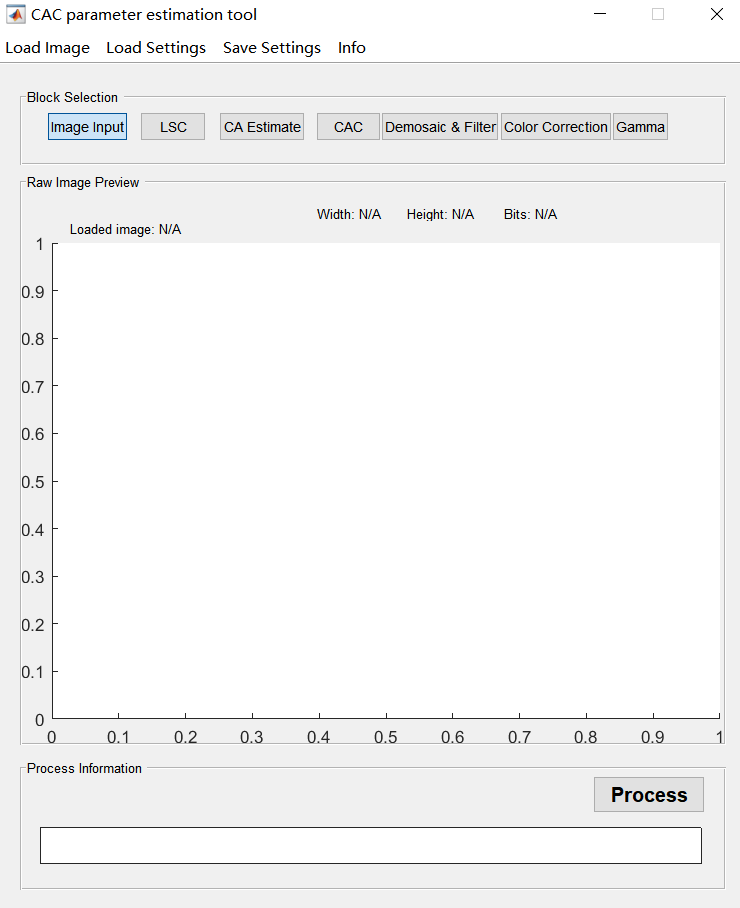

When the “Chromatic Aberration Correction” button is clicked on the main interface, the tool will pop up a dialog box as shown below.
image-20230822192525126
  1. Click the “Demosaic&Filter” button and set the Bayer pattern format.
  2. Click the “load image” button to load the RAW image, and the image will be displayed in the preview window.
  3. Set the parameters under the “Demosaic&Filter” interface.
    Since the CAC module operates after demosaicing, the tool implements a simple demosaicing function here.
    • ISP_demosaic_threshold: The default threshold value is set to 4. The higher the value, the fewer edges detected by the edge detection algorithm; lower values will result in more detected edges. A value of 255 means edge detection is completely disabled.
    • Simulate 2 additional Line Buffers: Allows users to extend the vertical offset. This enables setting the vertical vector clipping to +-3. In this case, chroma reduction filtering is not performed. Default is unchecked.
    • Filter stage1 select:
    • Sharpen Level:
    • Denoise Level:
    • Lum_weight Off: Allows disabling a special feature of the filter algorithm. This feature helps suppress stronger noise in dark areas compared to bright areas. Due to nonlinear gamma correction in the processing chain, contrast and noise are emphasized in dark areas and attenuated in bright areas. To compensate for this, the texture parameter is weighted by a function derived from the average brightness of a 5x5 kernel before comparing it with the threshold. Default is unchecked, resulting in less noise in the image preview.
  4. Click the “Color Correction” button and set the parameters under this interface.
    • Check “ISP_bls_enable” and set the correct BLC.
    • Check “Auto White-Balance”.
    • Set the CCM.
    • The global gain is set to 1.0 by default.
  5. Click the “Gamma” button and set the gamma curve, with the default set to gamma 2.2.
  6. Click the “LSC” button, then click “Load parameters” to load the LSC calibration parameters under the corresponding D50 light source, and check “Enable”.
  7. Click the “CA Estimate” button, check the “CA_Estimate” box, and click “Process” to run.
  8. Click the “CAC” button to view the calibration results from this interface.

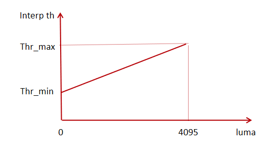

dmsc_dir_thr_min
int 0~4095
Interpolation for the G channel in dark areas
dmsc_dir_thr_max
int 0~4095
Interpolation for the G channel in bright areas

  1. Interpolation
    For 12-bit raw, the interpolation threshold corresponding to the value 0 is dir_thr_min, and the interpolation threshold corresponding to the value 4095 is dir_thr_max. Values in between correspond to points on the line segment determined by dir_thr_min and dir_thr_max.
    image-20230828143338539
    Setting demosaic_thr: Gradient difference > threshold, directional interpolation; gradient difference < threshold, average interpolation. Smaller values mean more false colors in high-frequency areas.

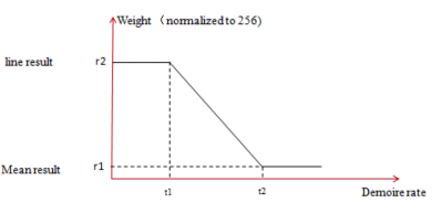

  3. Moire Removal
    Moire conversion curve:
    image-20230904094148683
    Moire calibration curve:
    image-20230904094333522
