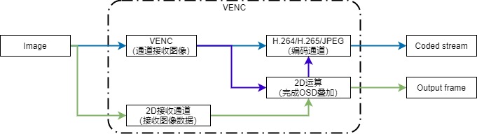

Video Encoding#
encode flow
Figure 1-1 Encoding Data Flow Diagram
The typical encoding process includes receiving the input image, masking and overlaying the image content, encoding the image, and outputting the code stream.
The encoding module consists of the VENC receiving channel, encoding channel, 2D receiving channel, and 2D computation module. The encoding and 2D computation capabilities are shown in the table below.
The green arrows in the encoding data flow diagram indicate the process of 2D computation alone. The blue arrows indicate the process of encoding alone. The purple arrows indicate the process of 2D computation followed by encoding.

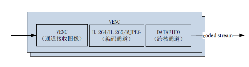

Encoding Channel#
The encoding channel serves as the basic container, storing various user settings and managing various internal resources of the encoding channel. The encoding channel completes the functions of image overlay and encoding. The 2D module performs image overlay computation, and the encoder module performs image encoding. Both can be used separately or in conjunction.
encode channel
Figure 1-2 Encoding Channel

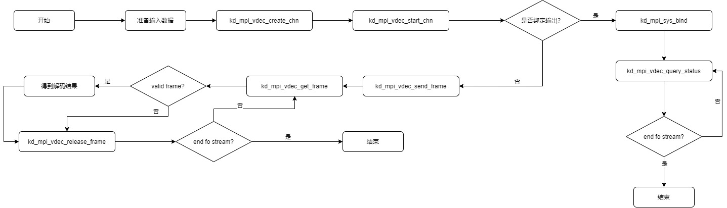

VDEC supports streaming mode:
  • Streaming Mode (K_VDEC_SEND_MODE_STREAM): Users can send any length of code stream to the decoder each time, and the decoder will internally complete the identification process of one frame of the code stream. Note that for H.264/H.265, the end of the current frame code stream can only be identified after receiving the next frame code stream, so in this sending mode, if you input one frame of H.264/H.265 code stream, you cannot expect the image decoding to start immediately.
Typical Decoding Application Example#
vdec sample flow
Figure 1-3 Typical Encoding Application Scenario Flow Diagram

Video Encoding#
MAPI is called on the small core to obtain VENC stream data.
Encoding Data Flow Diagram#
Figure 4-1
mapi encode channel
A typical encoding process includes receiving input images, encoding the images, cross-core data stream transmission, and stream output.
The encoding module (VENC) in the above figure consists of the VENC receiving channel, encoding channel, 2D receiving channel, and 2D operation module. For details, see [1.2.1 Video Encoding](#Video Encoding).
