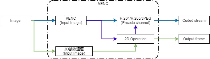

Video Coding#
Figure 1-1 Encoding data flow diagram
A typical encoding process includes the reception of the input image, the overlay of the image content, the encoding of the image, and the output of the code stream.
The coding module is composed of VENC receiving channel, coding channel, 2D receiving channel and 2D operation module. The coding power and 2D computing power are shown in the table below.
The path shown by the green arrow in the encoded data flow diagram is a separate 2D operation. The path shown by the blue arrow is the flow of separate encoding operations. The path shown by the purple arrow is the process of doing 2D operations before coding.

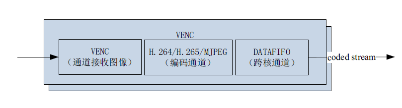

Encoded channels#
The encoding channel is the basic container that holds multi user settings for the encoding channel and manages multi internal resources of the encoding channel. The encoding channel completes the function of image overlay and encoding. The 2D module realizes image overlay operations and the encoder module realizes image encoding, and they separately or in cooperation.
Figure 1-2 Encoding channel

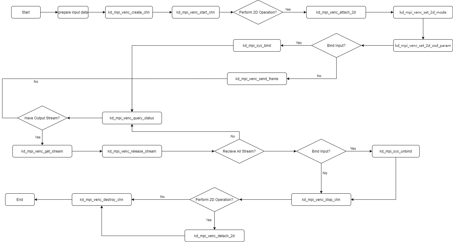

Examples of coding application#
Figure 1-3 Flowchart of typical coding application

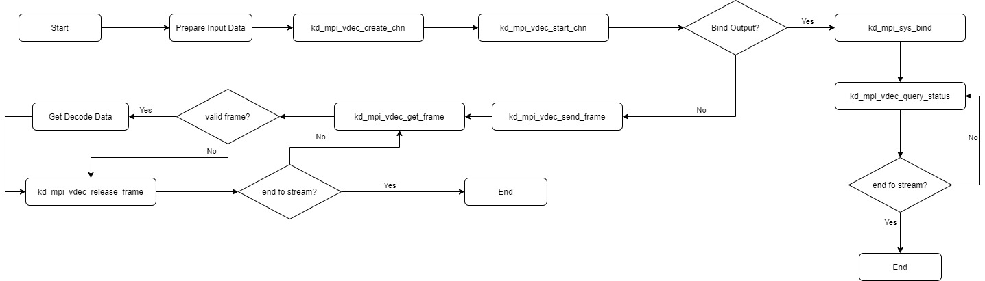

Examples of decoding applications#
Figure 1-3 Flowchart of typical coding application scenarios

MAPI is called on a little core to obtain the stream data of the VENC.
Encoded data flow diagram#
Figure 4-1
Typical encoding processes include the reception of input images, the encoding of images, the cross-core transmission of data streams, and the output of code streams.
The coding module (VENC) above is composed of a VENC receiving channel, a coding channel, a 2D receiving channel, and a 2D computing module, see[1.2.1 Video Coding](#Video Coding).
