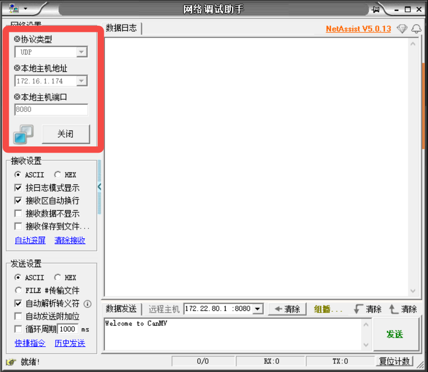

  1. Use NetAssist Network Debugging Assistant to establish a UDP connection:
../../_images/image-20240722171950467.png
