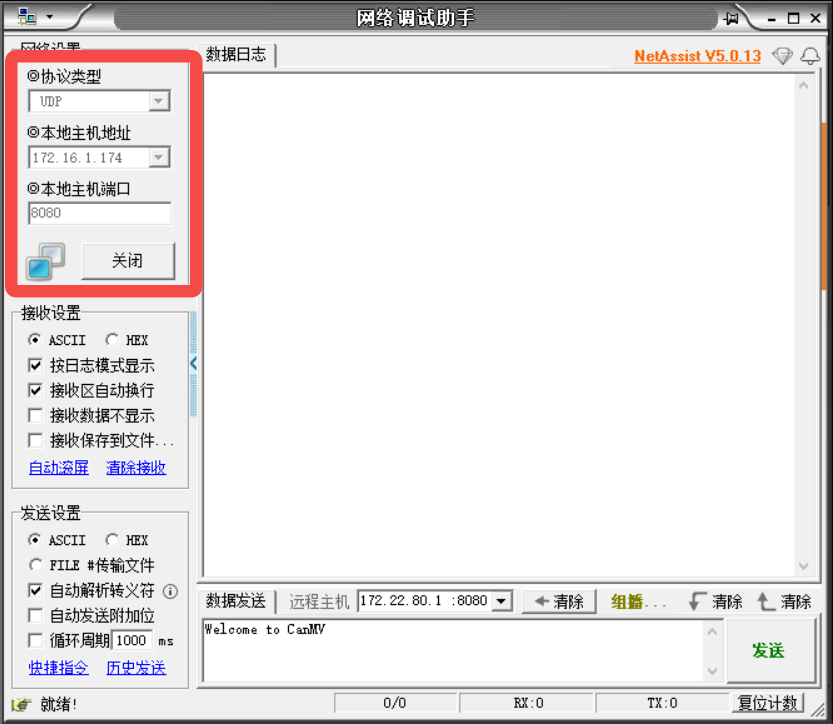

  1. Use NetAssist Network Debugging Assistant to establish a UDP connection:
../../_images/image-20240722171950467.png
  1. Modify the server IP address in the code:

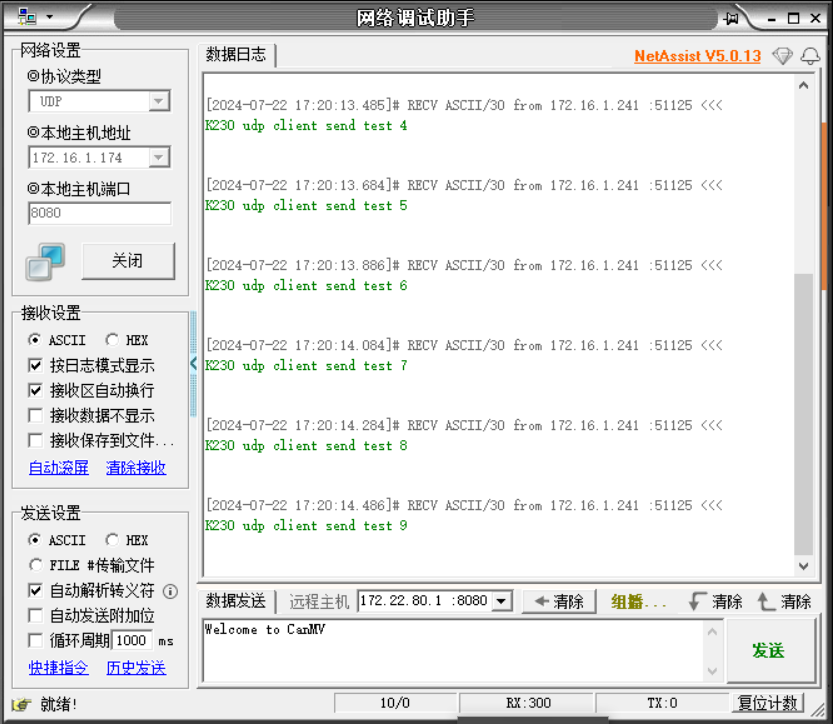

  1. After running the example, NetAssist will display the received UDP packets:
../../_images/image-20240722172037608.png
