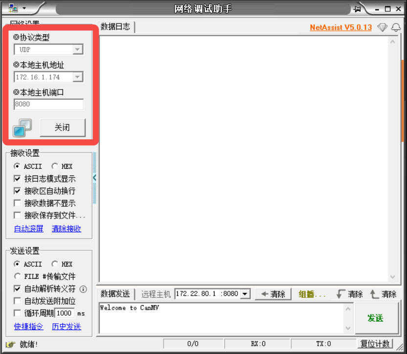

First, start a UDP debugging tool on the computer and listen on a port, then modify the network parameters and target address in the script:
NETWORK_TYPE = "wifi_sta"
WLAN_DEVICE = "auto"
WIFI_SSID = "TEST"
WIFI_PASSWORD = "12345678"
NETWORK_TIMEOUT = 20
Change 192.168.1.110 to the IP that allows communication between the computer and the development board, change 8080 to the UDP listening port on the computer side, and allow that UDP port through the firewall.

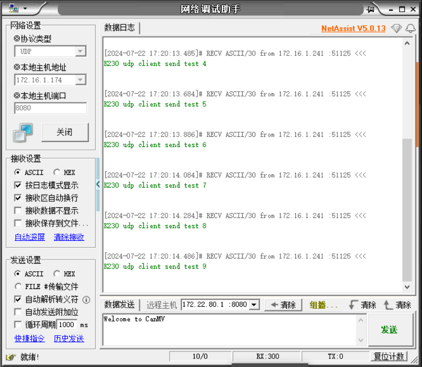

Running and Verification#
  1. First, start the UDP receiving tool on the computer.
  2. Run /sdcard/examples/14-Socket/udp_clinet.py.
  3. The computer should receive 10 datagrams with sequence numbers 0 to 9.
  4. If the serial port shows the message was sent successfully but the computer didn’t receive it, focus on checking the target IP, UDP port, firewall, and the client isolation settings of the Wi-Fi hotspot.
