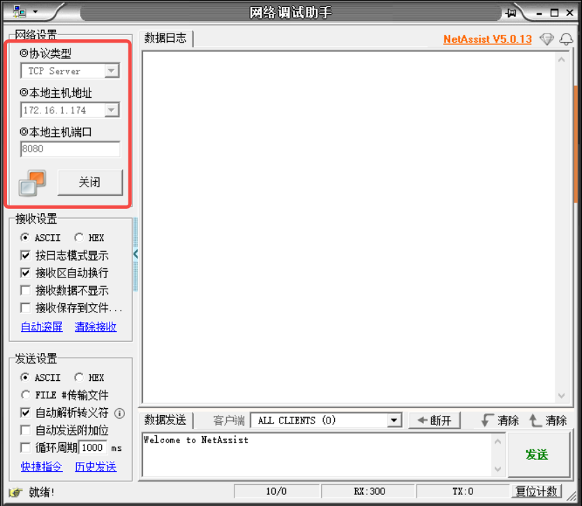

  1. Open the NetAssist Network Debugging Assistant, configure it as a TCP server, and wait for the connection:
../../_images/image-20240722152102440.png

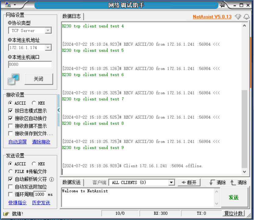

  1. Run the client code, and NetAssist will display the messages sent by the client:
../../_images/image-20240722151843380.png
