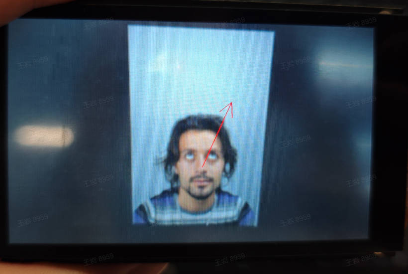

eye_gaze |
Watching estimate |
Multi-model task |

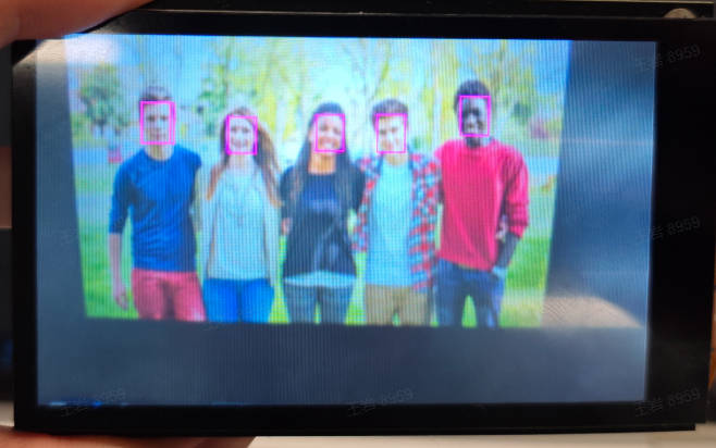

face_detection |
Face detection |
Single model task |

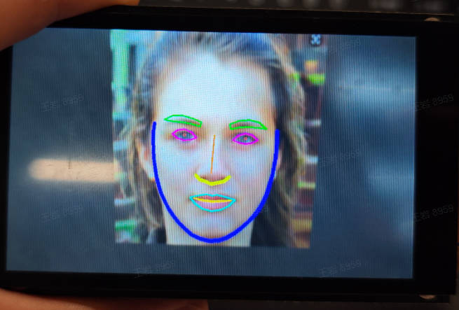

face_landmark |
Key parts of the face |
Multi-model task |

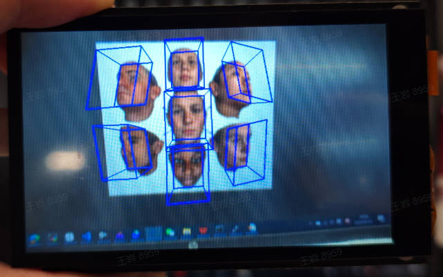

face_pose |
Face posture |
Multi-model task |

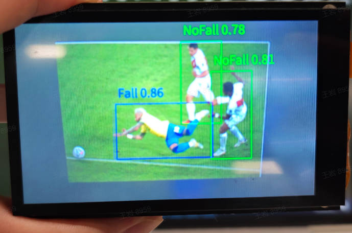

Falldown_detection |
Fall detection |
Single model task |

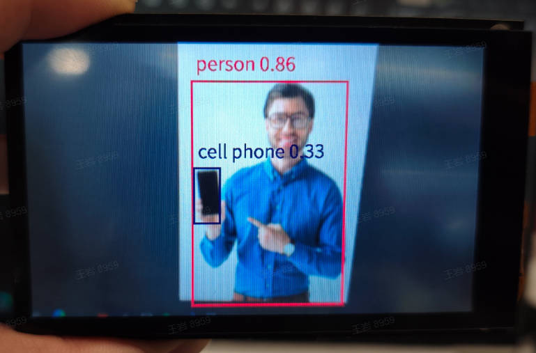

object_detect_yolov8n |
yolov8n target detection |
Single model task |

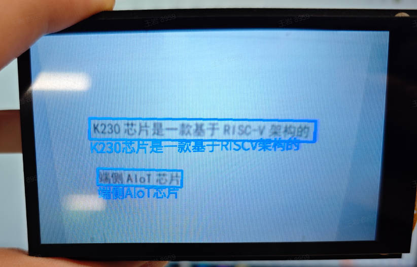

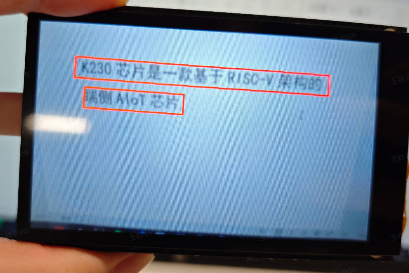

ocr_det |
OCR detection |
Single model task |
ocr_rec |
OCR recognition |
Multi-model task |

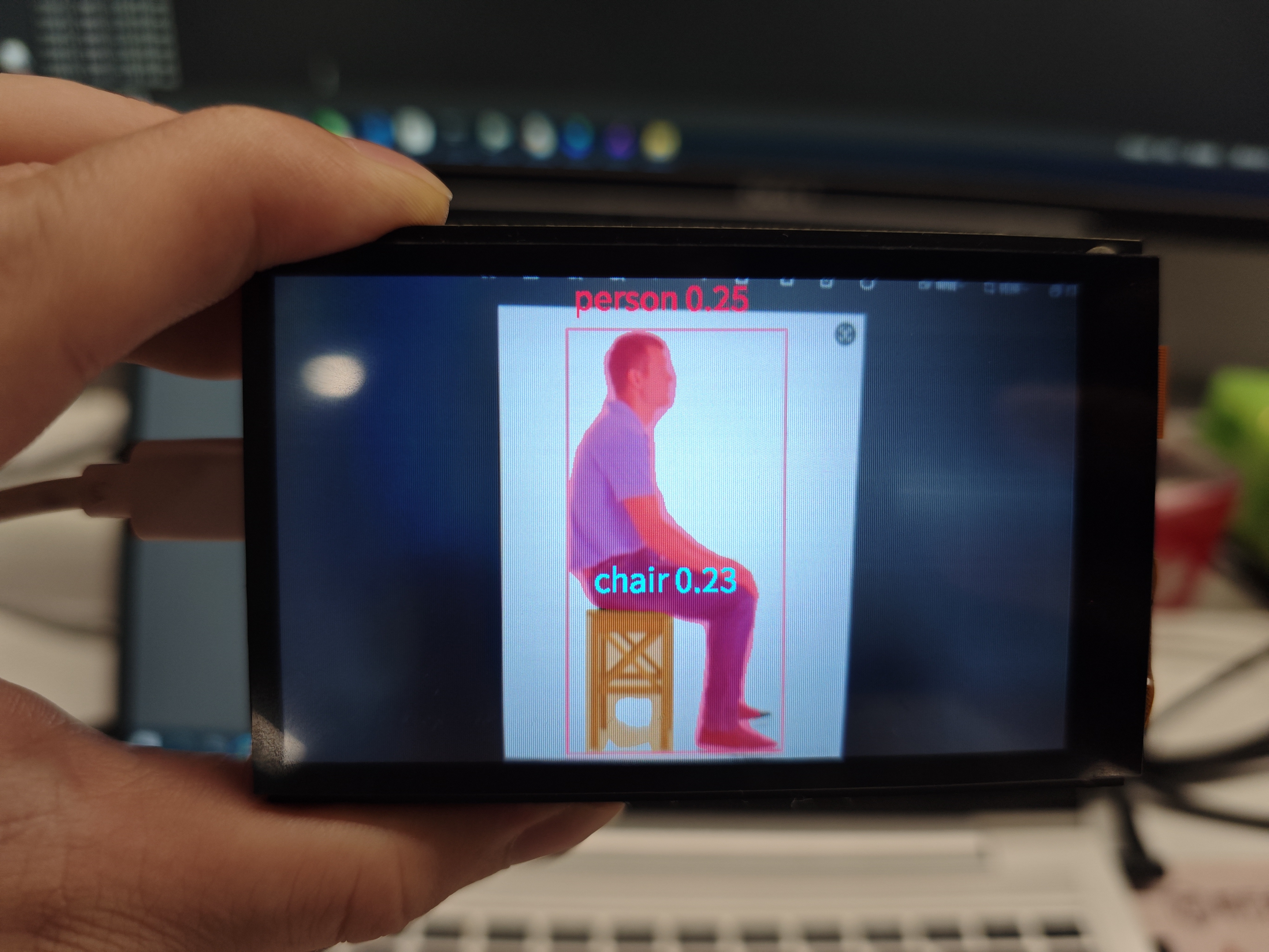

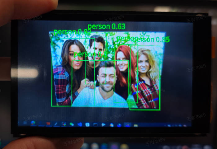

person_detection |
Human body test |
Single model task |

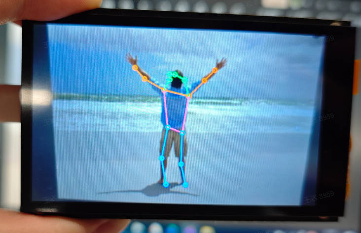

person_kp_detect |
Human key points detection |
Multi-model task |

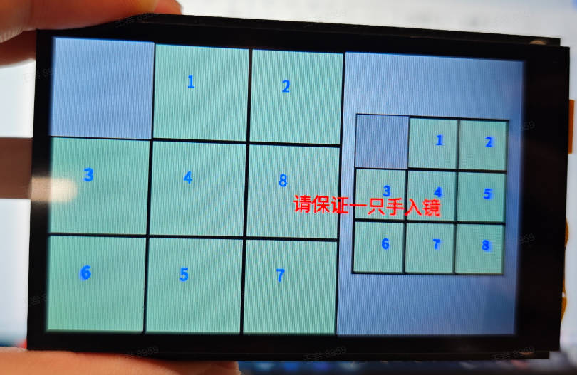

puzzle_game |
Jigsaw puzzle game |
Multi-model task |
segment_yolov8n |
yolov8 segmentation |
Single model task |

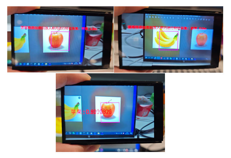

self_learning |
Self-study |
Single model task |

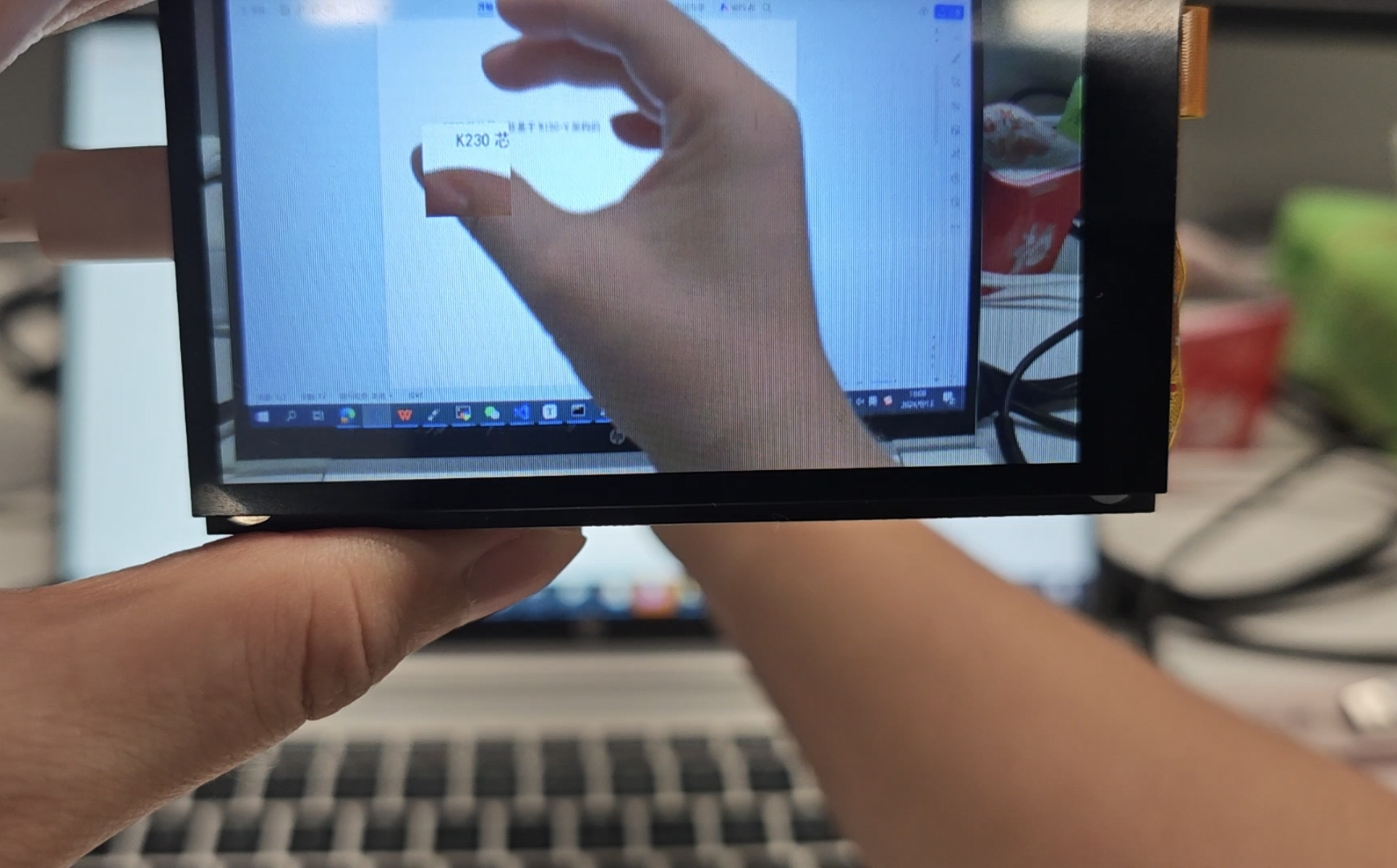

space_resize |
Local amplifier |
Multi-model task |

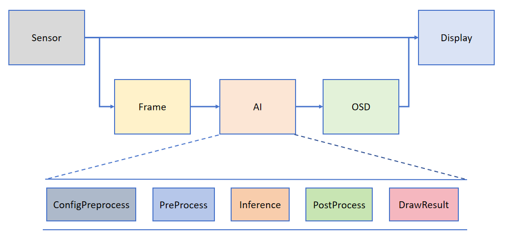

The Camera outputs two streams of images by default: one in YUV420SP format (Sensor.YUV420SP) is directly provided to the Display for display; the other in RGBP888 format (Sensor.RGBP888) is used for AI processing. The AI is mainly responsible for the pre-processing, inference, and post-processing workflow of tasks. After processing, the results are drawn on the OSD image instance and sent to the Display for overlay display.
The PipeLine process encapsulation mainly simplifies the development process of visual tasks. You can use ‘get_frame’ to get a frame for machine vision processing; if you want to customize the AI process, refer to face_detection. For audio-related AI, refer to the keyword_spotting and tts_zh examples in the demo.

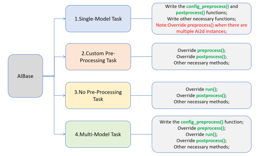

Users can write custom task classes inheriting from AIBase according to specific AI scenarios. Tasks can be divided into four categories: single-model tasks, multi-model tasks, custom pre-processing tasks, and no pre-processing tasks. Different tasks require different code implementations, as shown in the diagram below:
Introduction to different tasks:
Task Type |
Task Description |
Code Description |
Single-Model Task |
This task has only one model, focusing on the model’s pre-processing, inference, and post-processing. Pre-processing uses Ai2d, possibly with one or multiple Ai2d instances. Post-processing is customized based on the scenario. |
Write a custom task class, focusing on config_preprocess, postprocess, and other methods like draw_result. If multiple Ai2d instances are used, override preprocess to set the computation process of pre-processing stages. |
Custom Pre-Processing Task |
This task has one model, focusing on pre-processing, inference, and post-processing. Pre-processing does not use Ai2d; it can be customized with ulab.numpy. Post-processing is customized based on the scenario. |
Write a custom task class, focusing on preprocess, postprocess, and other methods like draw_result. |
No Pre-Processing Task |
This task has one model and requires no pre-processing. Focus on inference and post-processing. Usually part of a multi-model task, using the output of the previous model as input. Post-processing is customized based on needs. |
Write a custom task class, focusing on run (the entire inference process, including preprocess, inference, postprocess), postprocess, and other methods like draw_results. |
Multi-Model Task |
This task includes multiple models, possibly in series or other combinations. Each model is essentially one of the first three types, unified in a complete task class. |
Write multiple sub-model task classes. Different sub-model tasks refer to the first three task definitions. Different tasks focus on different methods. Write a multi-model task class to unify sub-model task classes for the entire scenario. |

Below is an example code for face detection:
from libs.AI2D import Ai2d
from libs.Utils import *
import ujson
from media.media import *
from time import *
import nncase_runtime as nn
import ulab.numpy as np
import utime
import image
import random
import gc
import sys
import aidemo
#Custom Face Detection Class, inheriting from the AIBase class
super().__init__(kmodel_path, model_input_size, rgb888p_size, debug_mode) # Call the constructor of the base class
self.kmodel_path = kmodel_path # Model file path
self.model_input_size = model_input_size # Model input resolution
self.confidence_threshold = confidence_threshold # Confidence threshold
self.nms_threshold = nms_threshold # NMS (Non-Maximum Suppression) threshold
self.anchors = anchors # Anchor data, used for object detection
self.rgb888p_size = [ALIGN_UP(rgb888p_size[0], 16), rgb888p_size[1]] # Image resolution from sensor to AI, aligned to 16 in width
self.display_size = [ALIGN_UP(display_size[0], 16), display_size[1]] # Display resolution, aligned to 16 in width
self.debug_mode = debug_mode # Whether to enable debug mode
self.ai2d = Ai2d(debug_mode) # Instantiate Ai2d for model pre-processing
self.ai2d.set_ai2d_dtype(nn.ai2d_format.NCHW_FMT, nn.ai2d_format.NCHW_FMT, np.uint8, np.uint8) # Set input and output format and type for Ai2d
# Configure pre-processing operations, using pad and resize here. Ai2d supports crop/shift/pad/resize/affine. See the code in /sdcard/app/libs/AI2D.py.
with ScopedTiming("set preprocess config", self.debug_mode > 0): # Timer, enabled if debug_mode is greater than 0
ai2d_input_size = input_image_size if input_image_size else self.rgb888p_size # Initialize ai2d pre-processing configuration, default to sensor size to AI, can modify input size by setting input_image_size
top, bottom, left, right = self.get_padding_param() # Get padding parameters
self.ai2d.pad([0, 0, 0, 0, top, bottom, left, right], 0, [104, 117, 123]) # Pad the edges
self.ai2d.resize(nn.interp_method.tf_bilinear, nn.interp_mode.half_pixel) # Resize the image
self.ai2d.build([1,3,ai2d_input_size[1],ai2d_input_size[0]],[1,3,self.model_input_size[1],self.model_input_size[0]]) # Build the pre-processing workflow
# Customize post-processing for the current task, results is a list of model output arrays, using the face_det_post_process interface from the aidemo library here
if len(post_ret) == 0:
return post_ret
return post_ret[0]
# Draw detection results on the screen
if dets:
pl.osd_img.clear() # Clear the OSD image
for det in dets:
# Convert the coordinates of the detection box to coordinates under the display resolution
pl.osd_img.draw_rectangle(x, y, w, h, color=(255, 255, 0, 255), thickness=2) # Draw a rectangle
pl.osd_img.clear()
def get_padding_param(self):
dst_w = self.model_input_size[0] # Model input width
dst_h = self.model_input_size[1] # Model input height
ratio_w = dst_w / self.rgb888p_size[0] # Width scaling ratio
ratio_h = dst_h / self.rgb888p_size[1] # Height scaling ratio
ratio = min(ratio_w, ratio_h) # Take the smaller scaling ratio
new_w = int(ratio * self.rgb888p_size[0]) # New width
new_h = int(ratio * self.rgb888p_size[1]) # New height
dw = (dst_w - new_w) / 2 # Width difference
dh = (dst_h - new_h) / 2 # Height difference
top = int(round(0))
left = int(round(0))
if __name__ == "__main__":
# Display mode, default is "hdmi", you can choose "hdmi" or "lcd"
display_mode="hdmi"
# k230 remains unchanged, k230d can be adjusted to [640,360]
rgb888p_size = [1920, 1080]
if display_mode=="hdmi":
display_size=[1920,1080]
display_size=[800,480]
# Set model path and other parameters
# Other parameters
confidence_threshold = 0.5
nms_threshold = 0.2
anchor_len = 4200
det_dim = 4
# Initialize PipeLine for image processing workflow
pl.create() # Create PipeLine instance
# Initialize custom face detection instance
face_det.config_preprocess() # Configure pre-processing
os.exitpoint() # Check for exit signal
with ScopedTiming("total",1):
img = pl.get_frame() # Get current frame data
res = face_det.run(img) # Infer current frame
face_det.draw_result(pl, res) # Draw result
pl.show_image() # Show result
gc.collect() # Garbage collection
face_det.deinit() # Deinitialize
pl.destroy() # Destroy PipeLine instance

# Omitted
# Display mode, default "hdmi", can choose "hdmi" and "lcd"
display_mode = "hdmi"
if display_mode == "hdmi":
display_size = [1920, 1080]
display_size = [800, 480]
# Set model path, replace with the current task model
kmodel1_input_size = [320, 320]
kmodel2_input_size = [48, 48]
###### Other parameters ########
# Omitted
# Initialize custom AI task instance
my_ai = MyApp(kmodel1_path, kmodel2_path, kmodel1_input_size, kmodel2_input_size, rgb888p_size=rgb888p_size, display_size=display_size, debug_mode=0)
my_ai.config_preprocess() # Configure preprocessing
outputs_1, outputs_2 = my_ai.run(img) # Infer current frame
my_ai.draw_result(pl, outputs_1, outputs_2) # Draw result
my_ai.app_1.deinit() # Deinitialize
my_ai.app_2.deinit()
For example code, please refer to the license plate detection and recognition: burn the firmware, open the IDE, select File -> Open File, and choose the corresponding script according to the following path: This PC -> CanMV -> sdcard -> examples -> 05-AI-Demo -> licence_det_rec.py.

Gaze Estimation#
Demo Description#
Gaze estimation predicts the eye gaze direction based on facial features. This application uses a dual-model approach, first performing face detection, then predicting the gaze direction of the detected face, and marking it with an arrow on the screen.
Code#
Open the IDE, select File -> Open File, and choose the corresponding script according to the following path: This PC -> CanMV -> sdcard -> examples -> 05-AI-Demo -> eye_gaze.py. You can refer to the source code displayed in the IDE. Click the run button at the bottom left of the IDE to demonstrate the demo.
Demonstration Effect#
The original image is as follows:
Here, the demonstration effect is given using the 01studio LCD screen (800*480) as an example. Please change the display_mode in the __main__ function to lcd and run it. The HDMI effect is similar.
Face Detection#
Demo Description#
The face detection application detects every face in the video and marks it with a detection box, while also marking the five key points of each face: left eyeball, right eyeball, nose tip, left mouth corner, and right mouth corner.
Code#
Open the IDE, select File -> Open File, and choose the corresponding script according to the following path: This PC -> CanMV -> sdcard -> examples -> 05-AI-Demo -> face_detection.py. You can refer to the source code displayed in the IDE. Click the run button at the bottom left of the IDE to demonstrate the demo.

Face 3D Mesh#
Demo Description#
The face 3D mesh is a multi-model application. First, it performs face detection on each frame of the video, then uses a face alignment model (3DDFA, 3D Dense Face Alignment) for face alignment, and finally uses a face mesh model for face 3D mesh reconstruction to obtain the mesh of each face in the image.
Code#
Open the IDE, select File -> Open File, and choose the corresponding script according to the following path: This PC -> CanMV -> sdcard -> examples -> 05-AI-Demo -> face_mesh.py. You can refer to the source code displayed in the IDE. Click the run button at the bottom left of the IDE to demonstrate the demo.

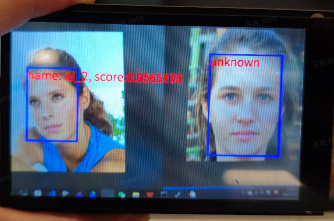

Face Recognition#
Demo Description#
The face recognition application performs face identity recognition on each frame of the video based on the information from face registration. If the recognized face is in the registration database, it labels the recognized face’s identity information; otherwise, it displays “unknown.”
Code#
Open the IDE, select File -> Open File, and choose the corresponding script according to the following path: This PC -> CanMV -> sdcard -> examples -> 05-AI-Demo -> face_recognition.py. You can refer to the source code displayed in the IDE. Click the run button at the bottom left of the IDE to demonstrate the demo.
The registered face original image is as follows:
Fall Detection#
Demo Description#
The fall detection application detects whether there is a human in each frame of the video and checks for the fall status of the human. If not fallen, it marks “NoFall”; if fallen, it marks “Fall.”
Code#
Open the IDE, select File -> Open File, and choose the corresponding script according to the following path: This PC -> CanMV -> sdcard -> examples -> 05-AI-Demo -> falldown_detect.py. You can refer to the source code displayed in the IDE. Click the run button at the bottom left of the IDE to demonstrate the demo.

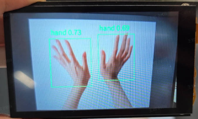

Palm Detection#
Demo Description#
The palm detection application detects the presence of palms in each frame of the video and marks the palm detection box on the screen.
Code#
Open the IDE, select File -> Open File, and choose the corresponding script according to the following path: This PC -> CanMV -> sdcard -> examples -> 05-AI-Demo -> hand_detection.py. You can refer to the source code displayed in the IDE. Click the run button at the bottom left of the IDE to demonstrate the demo.

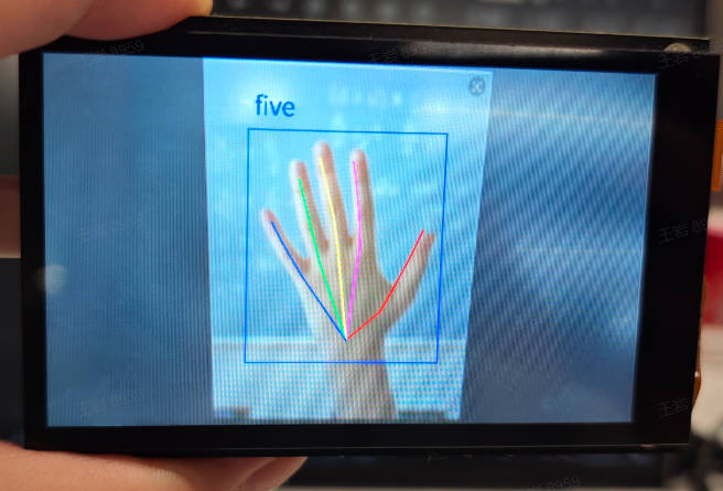

Palm Key Point Classification#
Demo Description#
The palm key point classification application is a dual-model task. First, it detects the palms present in the video, then performs key point regression on the detected palms. After obtaining the key point information, it distinguishes different gestures by calculating the angle information between fingers. It currently supports 9 gestures as shown below.
Code#
Open the IDE, select File -> Open File, and choose the corresponding script according to the following path: This PC -> CanMV -> sdcard -> examples -> 05-AI-Demo -> hand_keypoint_class.py. You can refer to the source code displayed in the IDE. Click the run button at the bottom left of the IDE to demonstrate the demo.

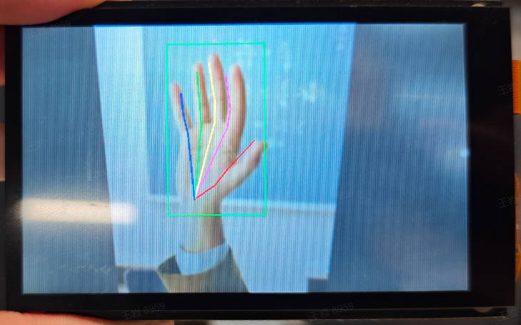

Palm Key Point Detection#
Demo Description#
Palm key point detection is a dual-model task. First, it detects the palm in each frame of the video, then performs key point regression on each detected palm to obtain the positions of 21 palm skeletal key points. These key points and their connections are displayed on the screen.
Code#
Open the IDE, select File -> Open File, and choose the corresponding script according to the following path: This PC -> CanMV -> sdcard -> examples -> 05-AI-Demo -> hand_keypoint_detection.py. You can refer to the source code displayed in the IDE. Click the run button at the bottom left of the IDE to demonstrate the demo.

YOLOv8n Object Detection#
Demo Description#
The YOLOv8n object detection application uses the YOLOv8n model to detect 80 categories from the COCO dataset, and the detection results are marked on the screen with detection boxes.
Code#
Open the IDE, select File -> Open File, and choose the corresponding script according to the following path: This PC -> CanMV -> sdcard -> examples -> 05-AI-Demo -> object_detect_yolov8n.py. You can refer to the source code displayed in the IDE. Click the run button at the bottom left of the IDE to demonstrate the demo.
OCR Detection#
Demo Description#
The OCR detection application detects text appearing in the video, and the detection results are marked on the screen with detection boxes.
Code#
Open the IDE, select File -> Open File, and choose the corresponding script according to the following path: This PC -> CanMV -> sdcard -> examples -> 05-AI-Demo -> ocr_det.py. You can refer to the source code displayed in the IDE. Click the run button at the bottom left of the IDE to demonstrate the demo.

Human Detection#
Demo Description#
The human detection application detects people in the video and marks them on the screen with detection boxes.
Code#
Open the IDE, select File -> Open File, and choose the corresponding script according to the following path: This PC -> CanMV -> sdcard -> examples -> 05-AI-Demo -> person_detection.py. You can refer to the source code displayed in the IDE. Click the run button at the bottom left of the IDE to demonstrate the demo.
