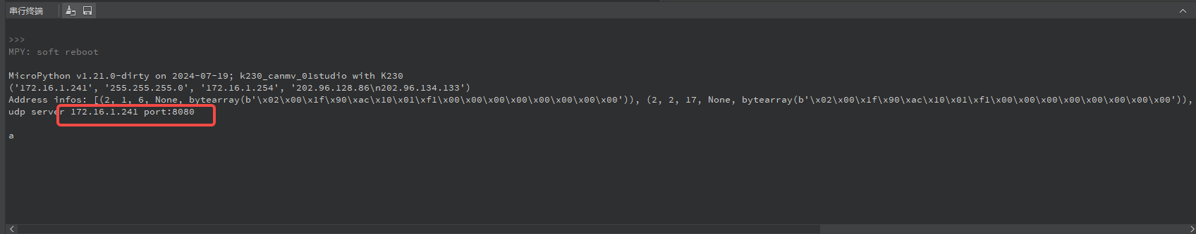

After running the code, the serial terminal will output the server’s IP address and port number information:

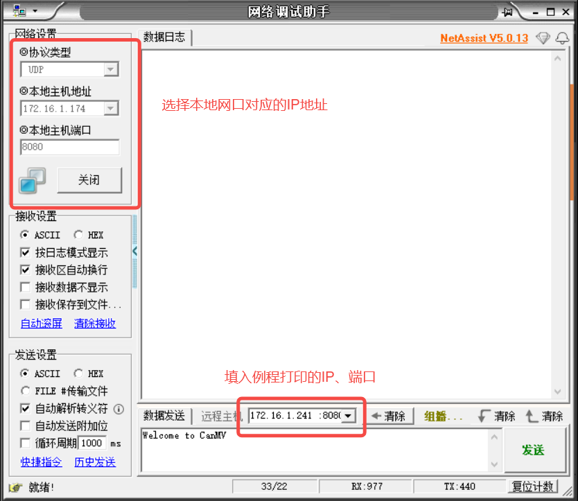

In the network debugging assistant, select UDP and configure the connection parameters:
Send data and observe the server’s response:
