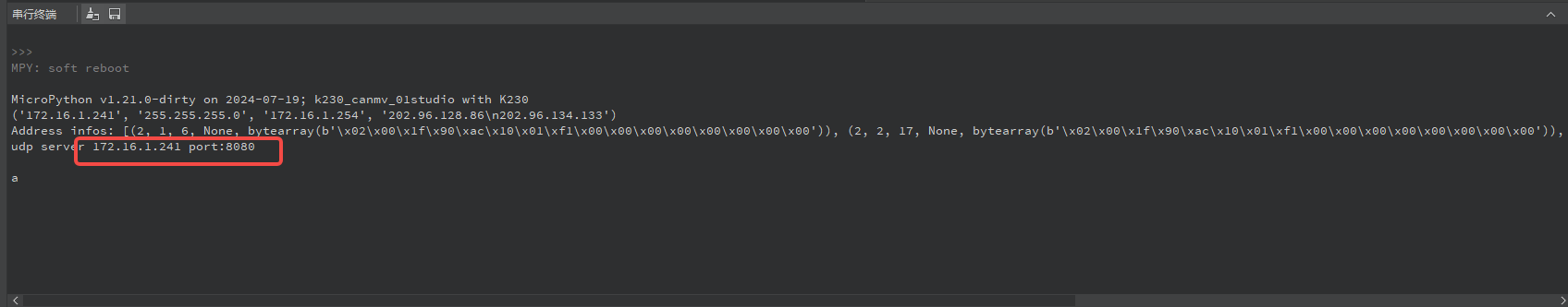

After running the code, the serial terminal will output the server’s IP address and port number information:
image-20240722165929097

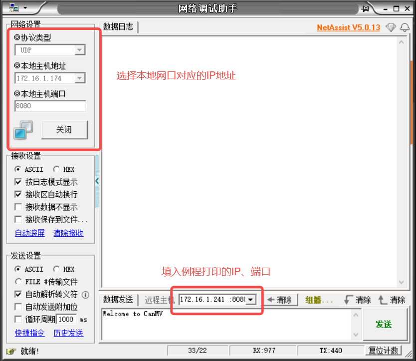

In the network debugging assistant, select UDP and configure the connection parameters:
../../_images/image-20240722170233348.png

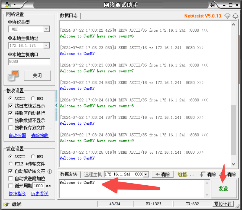

Send data and observe the server’s response:
../../_images/image-20240722170412175.png
