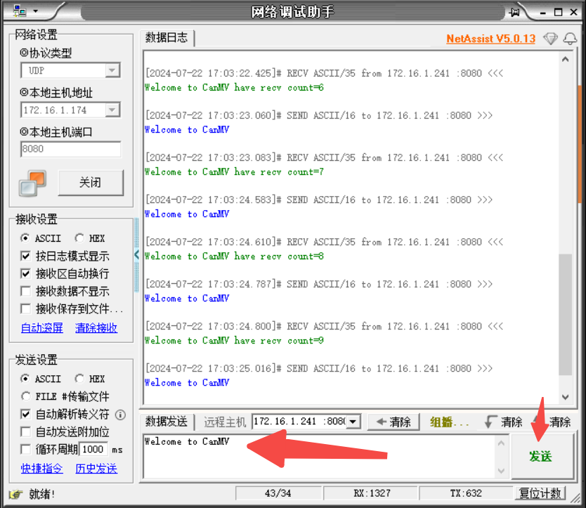

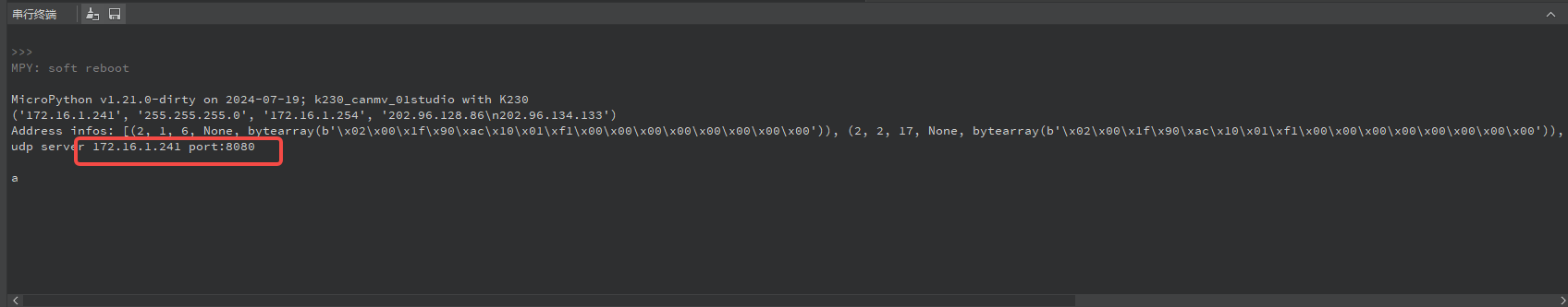

  1. Run the script and check the development board IP and port 8080 from the serial output.

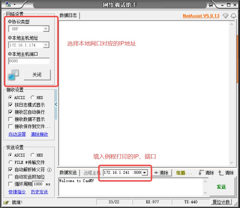

  2. Set the development board address as the target in the computer’s UDP tool and send text.
  3. The serial port should print the count, data, and computer address, and the computer should receive the reply from the development board.
