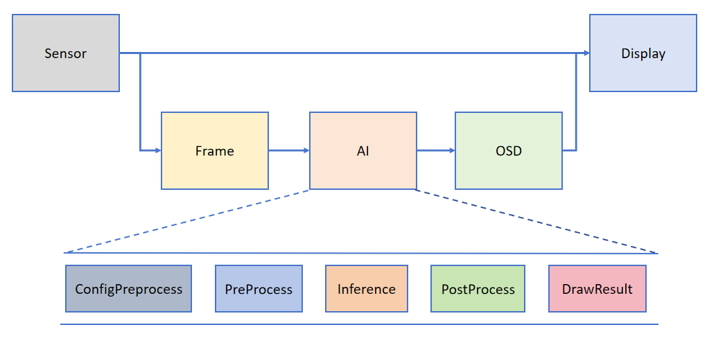

AI Demo Development Framework Introduction#
AI Demo Development Framework#
To help users simplify the development of AI components, we have built a supporting AI development framework based on the API interface provided by K230_CanMV. The framework structure is shown in the diagram below:
The Camera outputs two streams of images by default: one in YUV420SP format (Sensor.YUV420SP) is directly provided to the Display for display; the other in RGBP888 format (Sensor.RGBP888) is used for AI processing. The AI is mainly responsible for the pre-processing, inference, and post-processing workflow of tasks. After processing, the results are drawn on the OSD image instance and sent to the Display for overlay display.
The PipeLine process encapsulation mainly simplifies the development process of visual tasks. You can use ‘get_frame’ to get a frame for machine vision processing; if you want to customize the AI process, refer to face_detection. For audio-related AI, refer to the keyword_spotting and tts_zh examples in the demo.

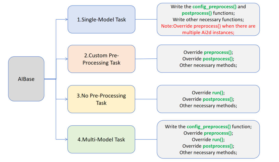

Application Methods and Examples#
Users can write custom task classes inheriting from AIBase according to specific AI scenarios. Tasks can be divided into four categories: single-model tasks, multi-model tasks, custom pre-processing tasks, and no pre-processing tasks. Different tasks require different code implementations, as shown in the diagram below:
Different Task Types
Introduction to different tasks:
Task Type
Task Description
Code Description
Single-Model Task
This task has only one model, focusing on the model’s pre-processing, inference, and post-processing. Pre-processing uses Ai2d, possibly with one or multiple Ai2d instances. Post-processing is customized based on the scenario.
Write a custom task class, focusing on config_preprocess, postprocess, and other methods like draw_result. If multiple Ai2d instances are used, override preprocess to set the computation process of pre-processing stages.
Custom Pre-Processing Task
This task has one model, focusing on pre-processing, inference, and post-processing. Pre-processing does not use Ai2d; it can be customized with ulab.numpy. Post-processing is customized based on the scenario.
Write a custom task class, focusing on preprocess, postprocess, and other methods like draw_result.
No Pre-Processing Task
This task has one model and requires no pre-processing. Focus on inference and post-processing. Usually part of a multi-model task, using the output of the previous model as input. Post-processing is customized based on needs.
Write a custom task class, focusing on run (the entire inference process, including preprocess, inference, postprocess), postprocess, and other methods like draw_results.
Multi-Model Task
This task includes multiple models, possibly in series or other combinations. Each model is essentially one of the first three types, unified in a complete task class.
Write multiple sub-model task classes. Different sub-model tasks refer to the first three task definitions. Different tasks focus on different methods. Write a multi-model task class to unify sub-model task classes for the entire scenario.

        # Instantiate Ai2d for model pre-processing
        # Set input and output format and type for Ai2d
    # Configure pre-processing operations, using resize and crop here. Ai2d supports crop/shift/pad/resize/affine. See the code in /sdcard/libs/AI2D.py.
            # Initialize ai2d pre-processing configuration, default to sensor size to AI, can modify input size by setting input_image_size
            # Configure resize pre-processing method
            # Build pre-processing workflow
            # Configure crop pre-processing method
    # Assume this task requires crop and resize pre-processing, the order is resize first then crop, this order does not match ai2d's processing order, so two Ai2d instances are needed to handle them separately
        return [crop_tensor]

Custom Pre-processing Task#
For AI tasks that require rewriting the pre-processing (not using the provided ai2d class, writing pre-processing manually), the pseudocode is as follows:
from libs.AI2D import Ai2d
from media.media import *
import nncase_runtime as nn
import ulab.numpy as np
import image
import gc
import sys
# Custom AI Task Class, Inheriting from AIBase Base Class
class MyAIApp(AIBase):
        # Call the constructor of the base class
        # Model file path
        # Model input resolution
        # Image resolution from sensor to AI, aligned to 16 in width
        # Display resolution, aligned to 16 in width
        # Whether to enable debug mode
        self.debug_mode = debug_mode
        self.ai2d = Ai2d(debug_mode)
    # For AI tasks that do not use ai2d for pre-processing, use the encapsulated interface or ulab.numpy to implement pre-processing, need to override this function in the subclass
        # Note custom pre-processing
        return [tensor]

No Pre-processing Task#
For AI tasks that do not require pre-processing (direct input inference), the pseudocode is as follows:
import image
import gc
import sys
        # Model file path
    # Custom post-processing for the current task, results is a list of model output arrays, needs to be rewritten based on the actual task
           pass
    # For AI tasks without preprocessing, this function needs to be overridden in the subclass
    def run(self, inputs_np):
        # First convert ulab.numpy.ndarray list to tensor list
        tensors = []
        for input_np in inputs_np:
        # Call the inference function in AIBase for model inference
        results = self.inference(tensors)
        # Call the postprocess method of the current subclass for custom post-processing
        outputs = self.postprocess(results)
        return outputs
    # Draw results on the screen, needs to be written according to the task
            pass

Multi-Model Task#
Here is an example of dual-model cascade inference, with the pseudocode as follows:
import image
import gc
import sys
# Custom AI task class, inheriting from AIBase base class
class MyAIApp_1(AIBase):
        # Model file path
        # Instantiate Ai2d for model preprocessing
    # Configure preprocessing operations, using resize here. Ai2d supports crop/shift/pad/resize/affine. Check /sdcard/libs/AI2D.py for specific code.
            # Initialize ai2d preprocessing configuration, default is the size from sensor to AI, can modify input size by setting input_image_size
            # Configure resize preprocessing method
            # Build preprocessing workflow
            self.ai2d.build([1,3,ai2d_input_size[1],ai2d_input_size[0]], [1,3,self.model_input_size[1],self.model_input_size[0]])
           pass
class MyAIApp_2(AIBase):
        # Model file path
           pass
class MyApp:
    def __init__(self, kmodel1_path, kmodel2_path, kmodel1_input_size, kmodel2_input_size, rgb888p_size, display_size, debug_mode):
        # Create instances for two model inferences
        self.app_1 = MyAIApp_1(kmodel1_path, kmodel1_input_size, rgb888p_size, display_size, debug_mode)
        self.app_2 = MyAIApp_2(kmodel2_path, kmodel2_input_size, rgb888p_size, display_size, debug_mode)
    # Write the run function, specific code should be written according to AI task requirements, here is just an example
    def run(self, input_np):
        outputs_1 = self.app_1.run(input_np)
        outputs_2 = []
        for out in outputs_1:
            out_2 = self.app_2.run(input_np)
            outputs_2.append(out_2)
        return outputs_1, outputs_2
    # Draw
    def draw_result(self, pl, outputs_1, outputs_2):
        pass
    ###### Other functions ########
    # Omitted
if __name__ == "__main__":
    # Display mode, default "hdmi", can choose "hdmi" and "lcd"
    display_mode = "hdmi"
    if display_mode == "hdmi":
        display_size = [1920, 1080]
        display_size = [800, 480]
    rgb888p_size = [1920, 1080]
    # Set model path, replace with the current task model
    kmodel1_input_size = [320, 320]
    kmodel2_input_size = [48, 48]
    ###### Other parameters ########
    # Omitted
    # Initialize PipeLine for image processing workflow
    pl.create()  # Create PipeLine instance
    # Initialize custom AI task instance
    my_ai = MyApp(kmodel1_path, kmodel2_path, kmodel1_input_size, kmodel2_input_size, rgb888p_size=rgb888p_size, display_size=display_size, debug_mode=0)
    my_ai.config_preprocess()  # Configure preprocessing
            os.exitpoint()                      # Check for exit signal
                img = pl.get_frame()            # Get current frame data
                outputs_1, outputs_2 = my_ai.run(img)  # Infer current frame
                my_ai.draw_result(pl, outputs_1, outputs_2)  # Draw result
                pl.show_image()                 # Show result
                gc.collect()                    # Garbage collection
        sys.print_exception(e)                  # Print exception information
    finally:
        my_ai.app_1.deinit()                    # Deinitialize
        my_ai.app_2.deinit()
        pl.destroy()                            # Destroy PipeLine instance
For example code, please refer to the license plate detection and recognition: burn the firmware, open the IDE, select File -> Open File, and choose the corresponding script according to the following path: This PC -> CanMV -> sdcard -> examples -> 05-AI-Demo -> licence_det_rec.py.

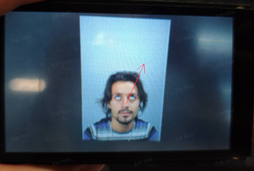

Gaze Estimation#
Demo Description#
Gaze estimation predicts the eye gaze direction based on facial features. This application uses a dual-model approach, first performing face detection, then predicting the gaze direction of the detected face, and marking it with an arrow on the screen.
Code#
Open the IDE, select File -> Open File, and choose the corresponding script according to the following path: This PC -> CanMV -> sdcard -> examples -> 05-AI-Demo -> eye_gaze.py. You can refer to the source code displayed in the IDE. Click the run button at the bottom left of the IDE to demonstrate the demo.
Demonstration Effect#
The original image is as follows:
eye_gaze
Here, the demonstration effect is given using the 01studio LCD screen (800*480) as an example. Please change the display_mode in the __main__ function to lcd and run it. The HDMI effect is similar.
eye_gaze_res

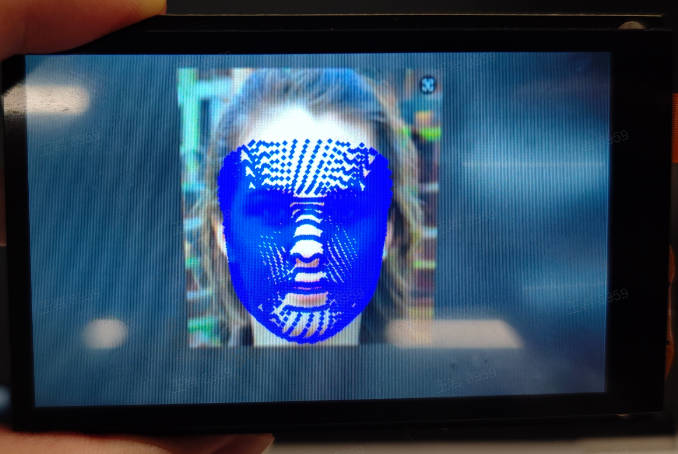

Face 3D Mesh#
Demo Description#
The face 3D mesh is a multi-model application. First, it performs face detection on each frame of the video, then uses a face alignment model (3DDFA, 3D Dense Face Alignment) for face alignment, and finally uses a face mesh model for face 3D mesh reconstruction to obtain the mesh of each face in the image.
Code#
Open the IDE, select File -> Open File, and choose the corresponding script according to the following path: This PC -> CanMV -> sdcard -> examples -> 05-AI-Demo -> face_mesh.py. You can refer to the source code displayed in the IDE. Click the run button at the bottom left of the IDE to demonstrate the demo.
face_mesh
face_mesh_res

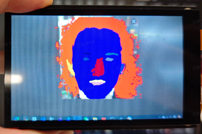

Face Parsing#
Demo Description#
Face parsing (also known as face segmentation) is a dual-model application. First, it performs face detection, then implements segmentation of different parts of the face. Face segmentation includes pixel-level classification of parts such as eyes, nose, and mouth, with different regions marked in different colors on the screen.
Code#
Open the IDE, select File -> Open File, and choose the corresponding script according to the following path: This PC -> CanMV -> sdcard -> examples -> 05-AI-Demo -> face_parse.py. You can refer to the source code displayed in the IDE. Click the run button at the bottom left of the IDE to demonstrate the demo.
face_parse
face_parse_res

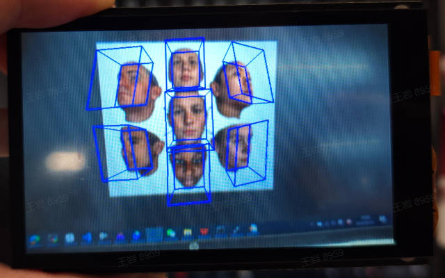

Face Pose#
Demo Description#
Face pose is a dual-model application. First, it performs face detection on each frame of the video, then predicts the face orientation for each detected face. Face orientation is represented using Euler angles (roll/yaw/pitch), where roll indicates the degree of head shaking left or right, yaw indicates the degree of head rotation left or right, and pitch indicates the degree of head nodding up or down. This application visualizes face orientation on the screen by constructing a projection matrix.
Code#
Open the IDE, select File -> Open File, and choose the corresponding script according to the following path: This PC -> CanMV -> sdcard -> examples -> 05-AI-Demo -> face_pose.py. You can refer to the source code displayed in the IDE. Click the run button at the bottom left of the IDE to demonstrate the demo.
face_pose
face_pose_res

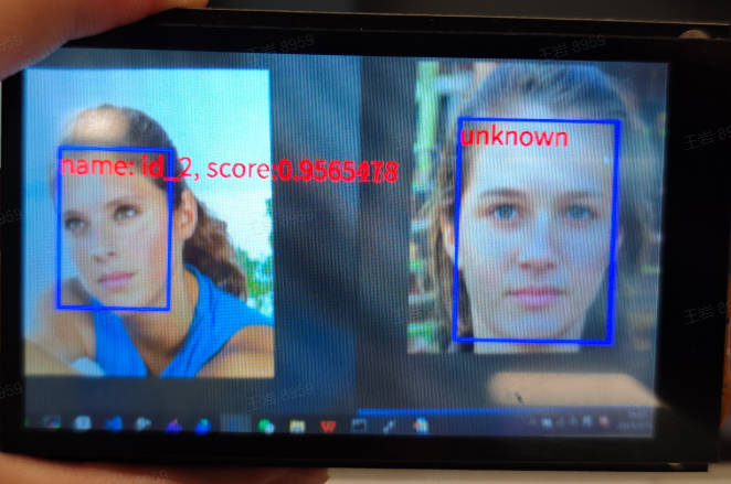

Face Recognition#
Demo Description#
The face recognition application performs face identity recognition on each frame of the video based on the information from face registration. If the recognized face is in the registration database, it labels the recognized face’s identity information; otherwise, it displays “unknown.”
Code#
Open the IDE, select File -> Open File, and choose the corresponding script according to the following path: This PC -> CanMV -> sdcard -> examples -> 05-AI-Demo -> face_recognition.py. You can refer to the source code displayed in the IDE. Click the run button at the bottom left of the IDE to demonstrate the demo.
The registered face original image is as follows:
face_recognition
face_recognition_res

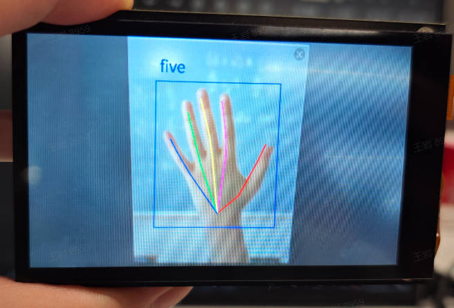

Palm Key Point Classification#
Demo Description#
The palm key point classification application is a dual-model task. First, it detects the palms present in the video, then performs key point regression on the detected palms. After obtaining the key point information, it distinguishes different gestures by calculating the angle information between fingers. It currently supports 9 gestures as shown below.
Supported Gesture Illustration
Code#
Open the IDE, select File -> Open File, and choose the corresponding script according to the following path: This PC -> CanMV -> sdcard -> examples -> 05-AI-Demo -> hand_keypoint_class.py. You can refer to the source code displayed in the IDE. Click the run button at the bottom left of the IDE to demonstrate the demo.
hand_kp_cls
hand_kp_cls_res

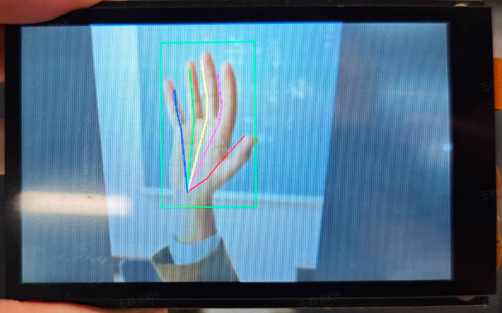

Palm Key Point Detection#
Demo Description#
Palm key point detection is a dual-model task. First, it detects the palm in each frame of the video, then performs key point regression on each detected palm to obtain the positions of 21 palm skeletal key points. These key points and their connections are displayed on the screen.
Code#
Open the IDE, select File -> Open File, and choose the corresponding script according to the following path: This PC -> CanMV -> sdcard -> examples -> 05-AI-Demo -> hand_keypoint_detection.py. You can refer to the source code displayed in the IDE. Click the run button at the bottom left of the IDE to demonstrate the demo.
hand_kp_det
hand_kp_det_res

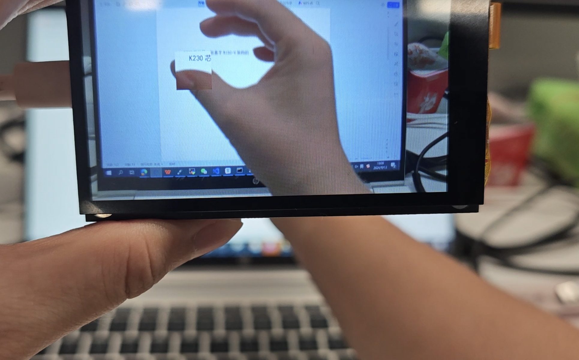

Single Object Tracking#
Demo Description#
The single object tracking application tracks and recognizes the registered object within the target box. After starting the application, wait for a while. During this time, place the object to be tracked (preferably with a different color from the background) in the target box. Once registration is complete, it will automatically enter tracking mode, and the moving target box will follow the object.
Code#
Open the IDE, select File -> Open File, and choose the corresponding script according to the following path: This PC -> CanMV -> sdcard -> examples -> 05-AI-Demo -> nanotracker.py. You can refer to the source code displayed in the IDE. Click the run button at the bottom left of the IDE to demonstrate the demo.
nanotracker
nanotracker_res

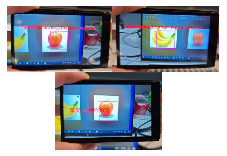

The images of the apple and banana to be learned are as follows:
apple
banana
Here, the demonstration effect is given using the 01studio LCD screen (800*480) as an example. Please change the display_mode in the __main__ function to lcd and run it. The HDMI effect is similar. Follow the screen prompts to place the apple and banana in the box for learning, then automatically enter recognition mode. The object in the box will be recognized as an apple or banana, and a similarity score will be given.
self_learning_res

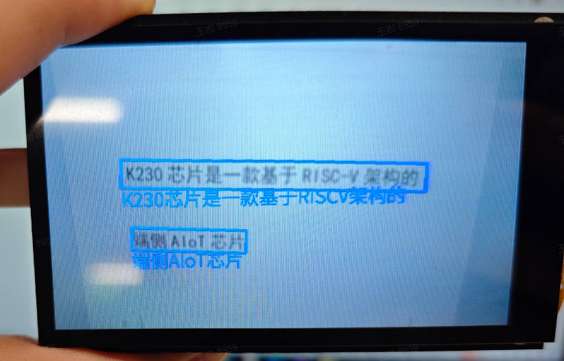

Text-to-Speech (Chinese)#
Demo Description#
Text-to-Speech (TTS, Chinese) is a typical audio application. You can modify the text in the main function, and after the audio is generated, you can listen to it through headphones. This application takes a relatively long time, and the complete audio playback time is also quite long, depending on the length of the generated text.
Code#
Open the IDE, select File -> Open File, and choose the corresponding script according to the following path: This PC -> CanMV -> sdcard -> examples -> 05-AI-Demo -> tts_zh.py. You can refer to the source code displayed in the IDE. Click the run button at the bottom left of the IDE to demonstrate the demo.
Please insert headphones or speakers, run the program, and the generated audio will play after completion. Please experience it yourself!
