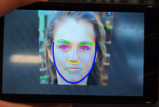

face_landmark
Key parts of the face
Multi-model task

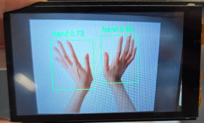

hand_detection
Palm detection
Single model task

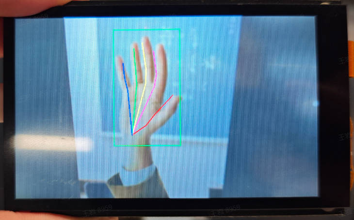

hand_keypoint_detection
Palm key point detection
Multi-model task

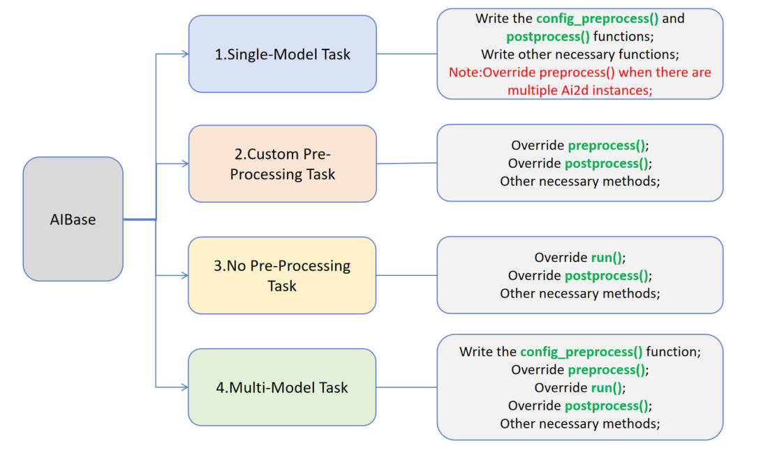

To help users simplify the development of AI components, we have built a supporting AI development framework based on the API interface provided by K230_CanMV. The framework structure is shown in the diagram below:
Development Framework

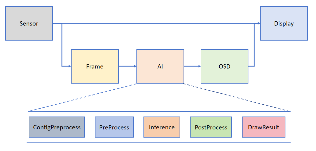

The Camera outputs two streams of images by default: one in YUV420SP format (Sensor.YUV420SP) is directly provided to the Display for display; the other in RGBP888 format (Sensor.RGBP888) is used for AI processing. The AI is mainly responsible for the pre-processing, inference, and post-processing workflow of tasks. After processing, the results are drawn on the OSD image instance and sent to the Display for overlay display.
The PipeLine process encapsulation mainly simplifies the development process of visual tasks. You can use ‘get_frame’ to get a frame for machine vision processing; if you want to customize the AI process, refer to face_detection. For audio-related AI, refer to the keyword_spotting and tts_zh examples in the demo.
Interface Encapsulation#
For user convenience, we have encapsulated common functions for obtaining images from the Camera, AI2D pre-processing, and kmodel model inference based on the framework above. For encapsulated interfaces, please refer to: AI Demo API
Application Methods and Examples#
Users can write custom task classes inheriting from AIBase according to specific AI scenarios. Tasks can be divided into four categories: single-model tasks, multi-model tasks, custom pre-processing tasks, and no pre-processing tasks. Different tasks require different code implementations, as shown in the diagram below:
Different Task Types
Introduction to different tasks:
Task Type
Task Description
Code Description
Single-Model Task
This task has only one model, focusing on the model’s pre-processing, inference, and post-processing. Pre-processing uses Ai2d, possibly with one or multiple Ai2d instances. Post-processing is customized based on the scenario.
Write a custom task class, focusing on config_preprocess, postprocess, and other methods like draw_result. If multiple Ai2d instances are used, override preprocess to set the computation process of pre-processing stages.
Custom Pre-Processing Task
This task has one model, focusing on pre-processing, inference, and post-processing. Pre-processing does not use Ai2d; it can be customized with ulab.numpy. Post-processing is customized based on the scenario.
Write a custom task class, focusing on preprocess, postprocess, and other methods like draw_result.
No Pre-Processing Task
This task has one model and requires no pre-processing. Focus on inference and post-processing. Usually part of a multi-model task, using the output of the previous model as input. Post-processing is customized based on needs.
Write a custom task class, focusing on run (the entire inference process, including preprocess, inference, postprocess), postprocess, and other methods like draw_results.
Multi-Model Task
This task includes multiple models, possibly in series or other combinations. Each model is essentially one of the first three types, unified in a complete task class.
Write multiple sub-model task classes. Different sub-model tasks refer to the first three task definitions. Different tasks focus on different methods. Write a multi-model task class to unify sub-model task classes for the entire scenario.

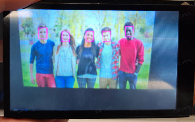

Below is an example code for face detection:
from libs.AI2D import Ai2d
from libs.Utils import *
import ujson
from media.media import *
from time import *
import nncase_runtime as nn
import ulab.numpy as np
import utime
import image
import random
import gc
import sys
import aidemo
#Custom Face Detection Class, inheriting from the AIBase class
        super().__init__(kmodel_path, model_input_size, rgb888p_size, debug_mode)  # Call the constructor of the base class
        self.kmodel_path = kmodel_path  # Model file path
        self.model_input_size = model_input_size  # Model input resolution
        self.confidence_threshold = confidence_threshold  # Confidence threshold
        self.nms_threshold = nms_threshold  # NMS (Non-Maximum Suppression) threshold
        self.anchors = anchors  # Anchor data, used for object detection
        self.rgb888p_size = [ALIGN_UP(rgb888p_size[0], 16), rgb888p_size[1]]  # Image resolution from sensor to AI, aligned to 16 in width
        self.display_size = [ALIGN_UP(display_size[0], 16), display_size[1]]  # Display resolution, aligned to 16 in width
        self.debug_mode = debug_mode  # Whether to enable debug mode
        self.ai2d = Ai2d(debug_mode)  # Instantiate Ai2d for model pre-processing
        self.ai2d.set_ai2d_dtype(nn.ai2d_format.NCHW_FMT, nn.ai2d_format.NCHW_FMT, np.uint8, np.uint8)  # Set input and output format and type for Ai2d
    # Configure pre-processing operations, using pad and resize here. Ai2d supports crop/shift/pad/resize/affine. See the code in /sdcard/app/libs/AI2D.py.
        with ScopedTiming("set preprocess config", self.debug_mode > 0):  # Timer, enabled if debug_mode is greater than 0
            ai2d_input_size = input_image_size if input_image_size else self.rgb888p_size  # Initialize ai2d pre-processing configuration, default to sensor size to AI, can modify input size by setting input_image_size
            top, bottom, left, right = self.get_padding_param()  # Get padding parameters
            self.ai2d.pad([0, 0, 0, 0, top, bottom, left, right], 0, [104, 117, 123])  # Pad the edges
            self.ai2d.resize(nn.interp_method.tf_bilinear, nn.interp_mode.half_pixel)  # Resize the image
            self.ai2d.build([1,3,ai2d_input_size[1],ai2d_input_size[0]],[1,3,self.model_input_size[1],self.model_input_size[0]])  # Build the pre-processing workflow
    # Customize post-processing for the current task, results is a list of model output arrays, using the face_det_post_process interface from the aidemo library here
            if len(post_ret) == 0:
                return post_ret
                return post_ret[0]
    # Draw detection results on the screen
            if dets:
                pl.osd_img.clear()  # Clear the OSD image
                for det in dets:
                    # Convert the coordinates of the detection box to coordinates under the display resolution
                    pl.osd_img.draw_rectangle(x, y, w, h, color=(255, 255, 0, 255), thickness=2)  # Draw a rectangle
                pl.osd_img.clear()
    def get_padding_param(self):
        dst_w = self.model_input_size[0]  # Model input width
        dst_h = self.model_input_size[1]  # Model input height
        ratio_w = dst_w / self.rgb888p_size[0]  # Width scaling ratio
        ratio_h = dst_h / self.rgb888p_size[1]  # Height scaling ratio
        ratio = min(ratio_w, ratio_h)  # Take the smaller scaling ratio
        new_w = int(ratio * self.rgb888p_size[0])  # New width
        new_h = int(ratio * self.rgb888p_size[1])  # New height
        dw = (dst_w - new_w) / 2  # Width difference
        dh = (dst_h - new_h) / 2  # Height difference
        top = int(round(0))
        left = int(round(0))
if __name__ == "__main__":
    # Display mode, default is "hdmi", you can choose "hdmi" or "lcd"
    display_mode="hdmi"
    # k230 remains unchanged, k230d can be adjusted to [640,360]
    rgb888p_size = [1920, 1080]
    if display_mode=="hdmi":
        display_size=[1920,1080]
        display_size=[800,480]
    # Set model path and other parameters
    # Other parameters
    confidence_threshold = 0.5
    nms_threshold = 0.2
    anchor_len = 4200
    det_dim = 4
    # Initialize PipeLine for image processing workflow
    pl.create()  # Create PipeLine instance
    # Initialize custom face detection instance
    face_det.config_preprocess()  # Configure pre-processing
        os.exitpoint()                      # Check for exit signal
        with ScopedTiming("total",1):
            img = pl.get_frame()            # Get current frame data
            res = face_det.run(img)         # Infer current frame
            face_det.draw_result(pl, res)   # Draw result
            pl.show_image()                 # Show result
            gc.collect()                    # Garbage collection
    face_det.deinit()                       # Deinitialize
    pl.destroy()                            # Destroy PipeLine instance

Custom Pre-processing Task#
For AI tasks that require rewriting the pre-processing (not using the provided ai2d class, writing pre-processing manually), the pseudocode is as follows:

For AI tasks that do not require pre-processing (direct input inference), the pseudocode is as follows:

Multi-Model Task#
Here is an example of dual-model cascade inference, with the pseudocode as follows:

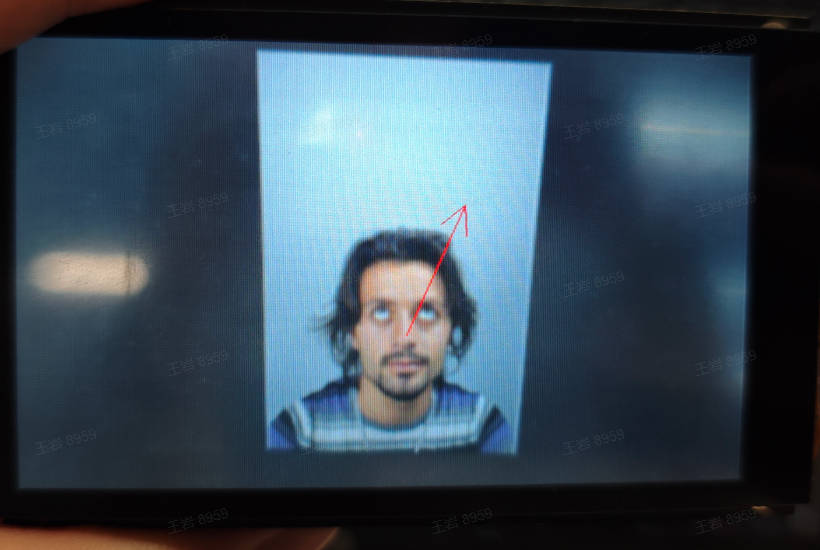

Gaze Estimation#
Demo Description#
Gaze estimation predicts the eye gaze direction based on facial features. This application uses a dual-model approach, first performing face detection, then predicting the gaze direction of the detected face, and marking it with an arrow on the screen.
Code#
Open the IDE, select File -> Open File, and choose the corresponding script according to the following path: This PC -> CanMV -> sdcard -> examples -> 05-AI-Demo -> eye_gaze.py. You can refer to the source code displayed in the IDE. Click the run button at the bottom left of the IDE to demonstrate the demo.
Demonstration Effect#
The original image is as follows:
eye_gaze
Here, the demonstration effect is given using the 01studio LCD screen (800*480) as an example. Please change the display_mode in the __main__ function to lcd and run it. The HDMI effect is similar.
eye_gaze_res

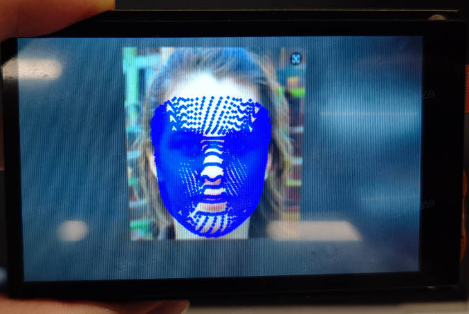

Face 3D Mesh#
Demo Description#
The face 3D mesh is a multi-model application. First, it performs face detection on each frame of the video, then uses a face alignment model (3DDFA, 3D Dense Face Alignment) for face alignment, and finally uses a face mesh model for face 3D mesh reconstruction to obtain the mesh of each face in the image.
Code#
Open the IDE, select File -> Open File, and choose the corresponding script according to the following path: This PC -> CanMV -> sdcard -> examples -> 05-AI-Demo -> face_mesh.py. You can refer to the source code displayed in the IDE. Click the run button at the bottom left of the IDE to demonstrate the demo.
face_mesh
face_mesh_res

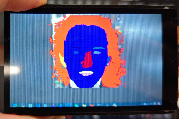

Face Parsing#
Demo Description#
Face parsing (also known as face segmentation) is a dual-model application. First, it performs face detection, then implements segmentation of different parts of the face. Face segmentation includes pixel-level classification of parts such as eyes, nose, and mouth, with different regions marked in different colors on the screen.
Code#
Open the IDE, select File -> Open File, and choose the corresponding script according to the following path: This PC -> CanMV -> sdcard -> examples -> 05-AI-Demo -> face_parse.py. You can refer to the source code displayed in the IDE. Click the run button at the bottom left of the IDE to demonstrate the demo.
face_parse
face_parse_res

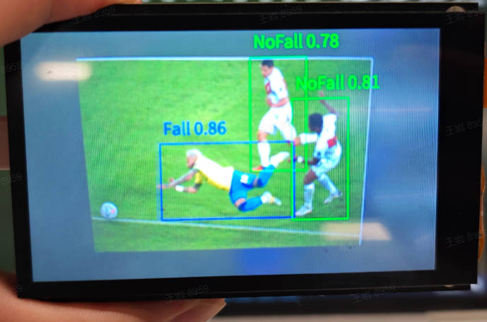

Fall Detection#
Demo Description#
The fall detection application detects whether there is a human in each frame of the video and checks for the fall status of the human. If not fallen, it marks “NoFall”; if fallen, it marks “Fall.”
Code#
Open the IDE, select File -> Open File, and choose the corresponding script according to the following path: This PC -> CanMV -> sdcard -> examples -> 05-AI-Demo -> falldown_detect.py. You can refer to the source code displayed in the IDE. Click the run button at the bottom left of the IDE to demonstrate the demo.
falldown_det
falldown_det_res

Palm Detection#
Demo Description#
The palm detection application detects the presence of palms in each frame of the video and marks the palm detection box on the screen.
Code#
Open the IDE, select File -> Open File, and choose the corresponding script according to the following path: This PC -> CanMV -> sdcard -> examples -> 05-AI-Demo -> hand_detection.py. You can refer to the source code displayed in the IDE. Click the run button at the bottom left of the IDE to demonstrate the demo.
hand_det
hand_det_res

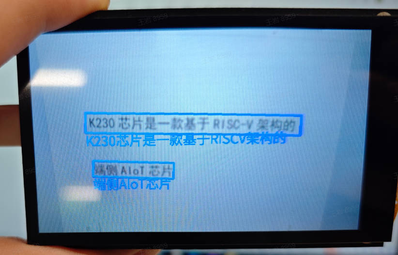

OCR Detection#
Demo Description#
The OCR detection application detects text appearing in the video, and the detection results are marked on the screen with detection boxes.
Code#
Open the IDE, select File -> Open File, and choose the corresponding script according to the following path: This PC -> CanMV -> sdcard -> examples -> 05-AI-Demo -> ocr_det.py. You can refer to the source code displayed in the IDE. Click the run button at the bottom left of the IDE to demonstrate the demo.
ocr_det
ocr_det_res
