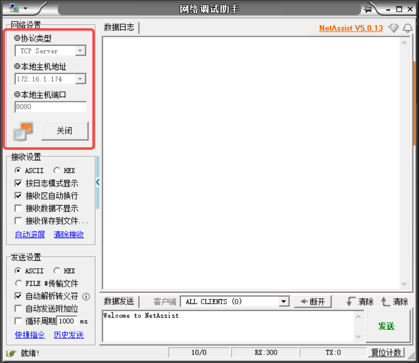

First, start a TCP debugging tool on the computer and listen on a port. Then modify the two types of configurations in the script:

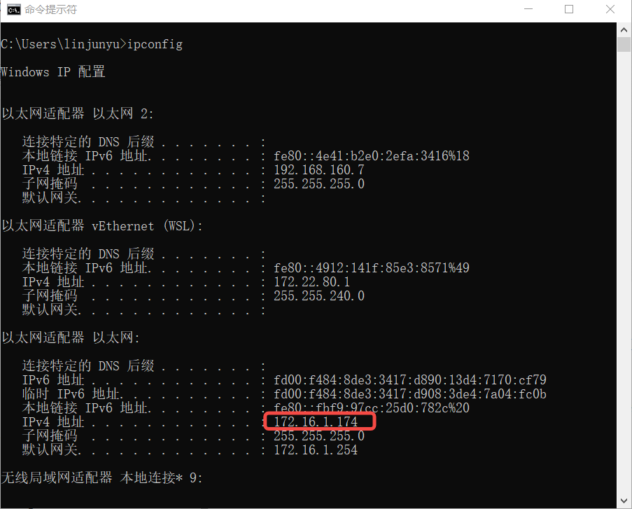

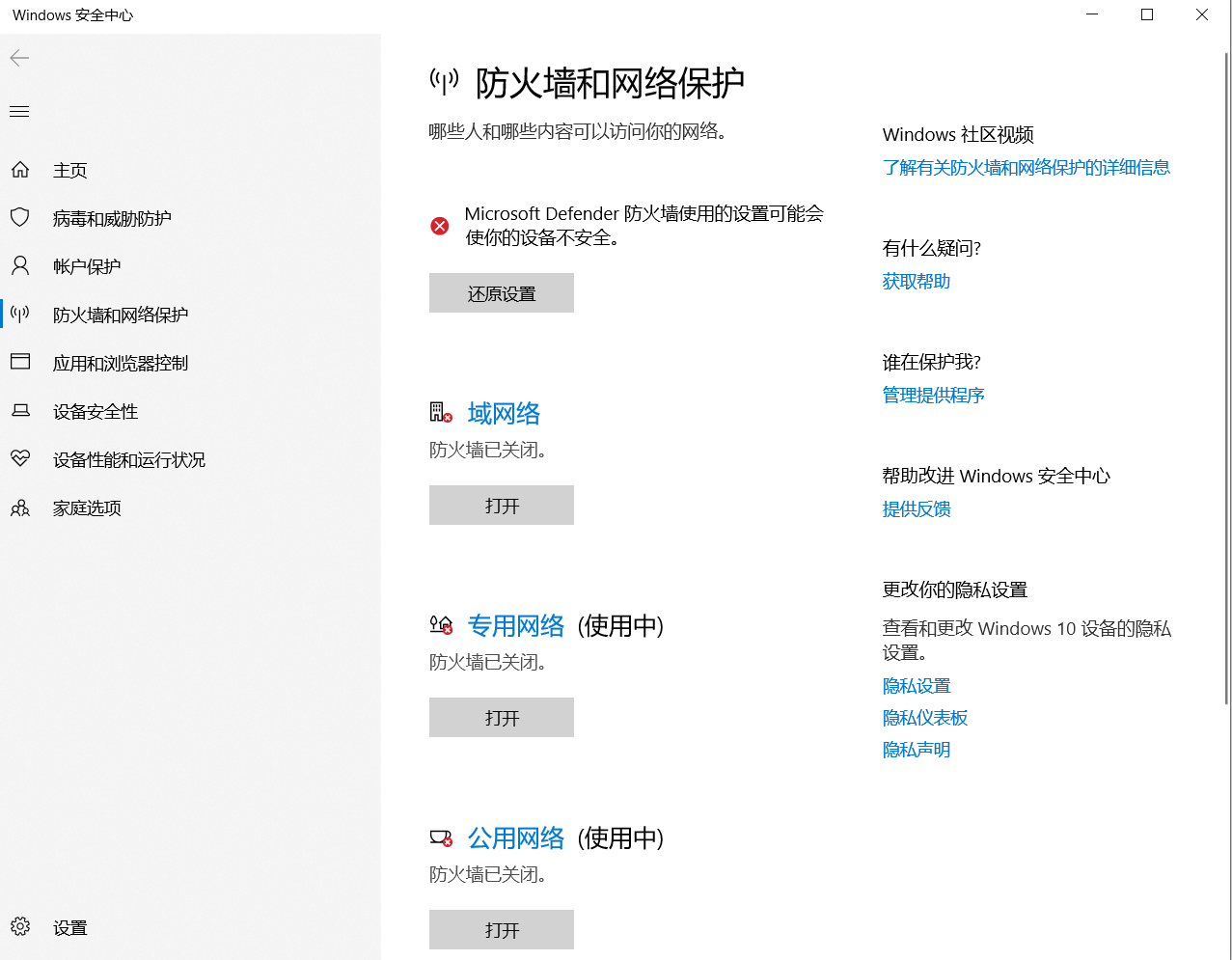

Change 192.168.1.110 to the computer’s IP address, and change 8080 to the TCP port that the debugging tool is listening on. The computer and the development board must be on the same network, and the computer’s firewall must also allow inbound traffic on that port.

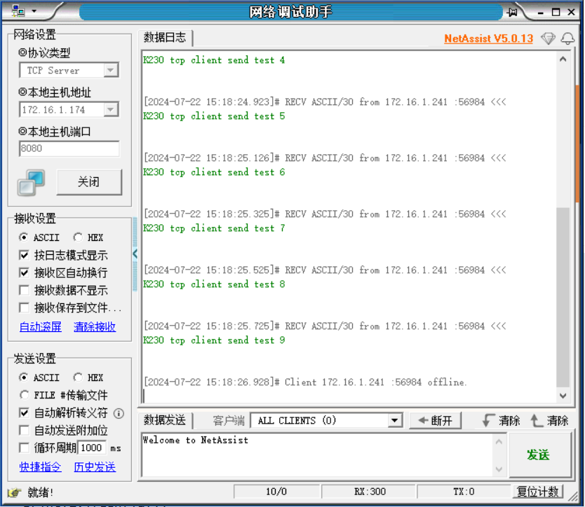

Running and Verification#
  1. First, start the computer-side TCP service and confirm the listening address and port.
  2. Run the script under the development board firmware path in CanMV IDE.
  3. The computer side should receive 10 messages with sequence numbers 0 to 9.
  4. If the computer has multiple network cards, the target IP should be the one that communicates with the development board, not the loopback address.
