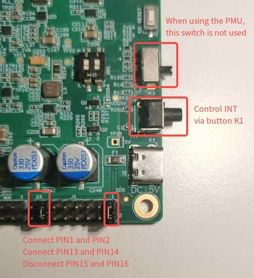

Hardware connection#
When using a PMU, you need to set up the EVB board as follows

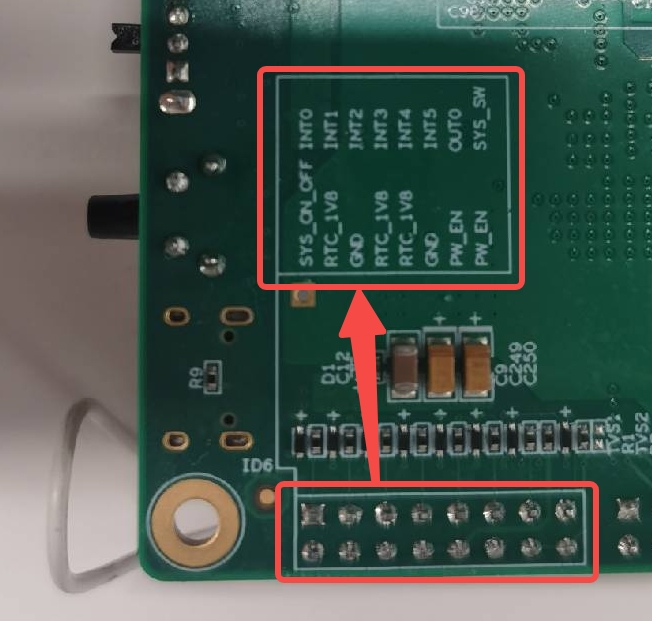

Use the jumper cap to connect PIN13(OUT0) and PIN14(PW_EN) of the J1 interface, taking care to disconnect PIN15(SYS_SW) and PIN16(PW_EN)
Depending on the different wake-up source, PIN2 (SYS_ON_OFF) is connected to the corresponding PIN using a jumper, and the button K1 can control the state of INT, press the button to go high, and release it to low
Wake source
PIN
label
INT0
INT0
INT1
3
INT1
INT2
5
INT2
INT3
7
INT3
INT4
9
INT4
INT5
11
INT5
