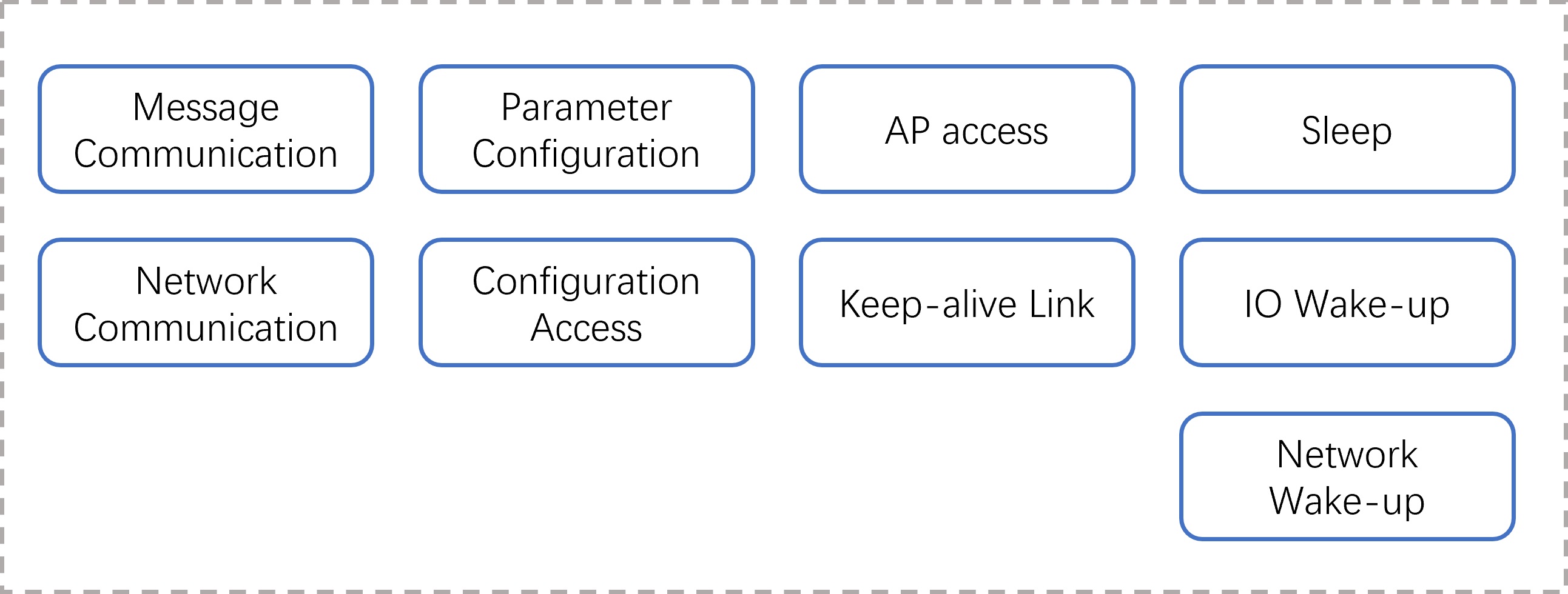

The main functions of WiFi are shown in Figure 1-1:
Figure 1-1 WiFi function block diagram
Brief introduction of the main functions of WiFi:
Message communication: WiFi receives and parses message instructions and command parameters sent by the host to trigger the execution of corresponding events
Network communication: network data transparent transmission
Parameter configuration: Establishes a SoftAP, receives configuration parameters, and triggers configuration events
Configuration access: Manage configuration files formed by configuration data, stored on flash
AP access: Access the specified AP, monitor the access status, and handle it accordingly
keepalive link: Establishes a keepalive link between maintenance and the remote server
Sleep: Set the software and hardware environment, power down the host (according to the platform characteristics, the K230 is self-powered), and the WiFi enters sleep mode
IO wake-up: Processes button or PIR wake-up signals, restores the software and hardware environment, and powers up the host
Wake-on-LAN: Processes wake-up packets from keepalive links, restores the software and hardware environment, and powers up the host

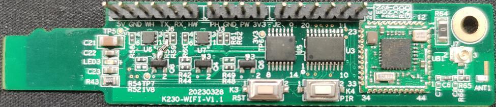

The K230 EVB development board is connected to the AiW4211LV10 development board pinout, and the connection relationship is shown in Table 2-2:
Table 2-2 Flying line relationship
Link1 |
Link2 |
Link3 |
Link4 |
Link5 |
Link6 |
Link7 |
K230 pin header |
TP21 (5V) |
D8. PIN9 (GPIO34) |
J1. PIN9 (RTC_INT4) |
J1. PIN14 (PW_EN) |
WiFi header |
J6. PIN1 (5V) |
J2. PIN3 (SDIO_INT_OUT) |
D6. PIN3 (WH) |
Day 2. PIN2 (GPIO2) |
Day 2. PIN4 (TX) |
Day 2. PIN5 (RX) |
J2. PIN6 (GND) |
TTL-USB |
RX |
TX |
GND |
Description |
5V power supply line |
WiFi data disconnect line |
WiFi wake-up K230 interrupt line |
WiFi monitors K230 levels |
com port sending and receiving |
com port GND |
Connection Instructions:
The TP21 is a 5V voltage test point that requires a soldering pin and a connection to J5 PIN16 if the K230 EVB version is V1.0
If you use a K230 EVB that does not involve waking up WiFi, you do not need to set up Link3
If WiFi is configured to sleep by monitoring the power state of the K230 core, Link4 is established, otherwise it is not needed.
The connection between TTL-USB and WiFi is mainly to observe the firmware output of WiFi, and it can be left without connection
The description of the pin headers of the AiW4211LV10 development board is shown in Table 2-3

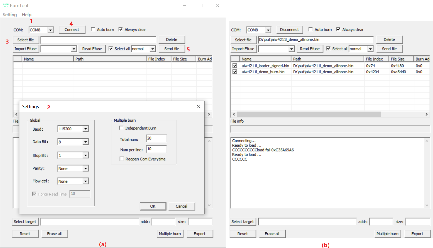

Use the BurnTool .exe of the programming tool in the WiFi SDK support directory to flash the firmware aiw4211l_demo_allinone.bin to the AiW4211LV10 development board through the serial port.
For programming methods, please refer to the document “AiW4211V10/AiW4211LV10 BurnTool Tool Tool User Guide.pdf”, which is stored in the support directory of the WiFi SDK.
Users can also contact Chengdu Aiqi Technology Co., Ltdhttp://www.aichtech.com/. for relevant information.
Figure 5-1 shows a schematic diagram of fast programming of veneers:
Figure 5-1 Rapid programming of veneer
Step 1: Choose to program the COM port Step 2: Configure COM port parameters through the “Setting” menu item Step 3: Select WiFi firmware step 4: Click the “Connect” control to initiate a connection to the WiFi development board, the WiFi development board is powered on, and the tool log window can see ready to load … , indicating that the connection has been established and can start flashing Step 5: Click the “Send file” control to start flashing

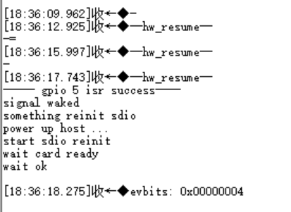

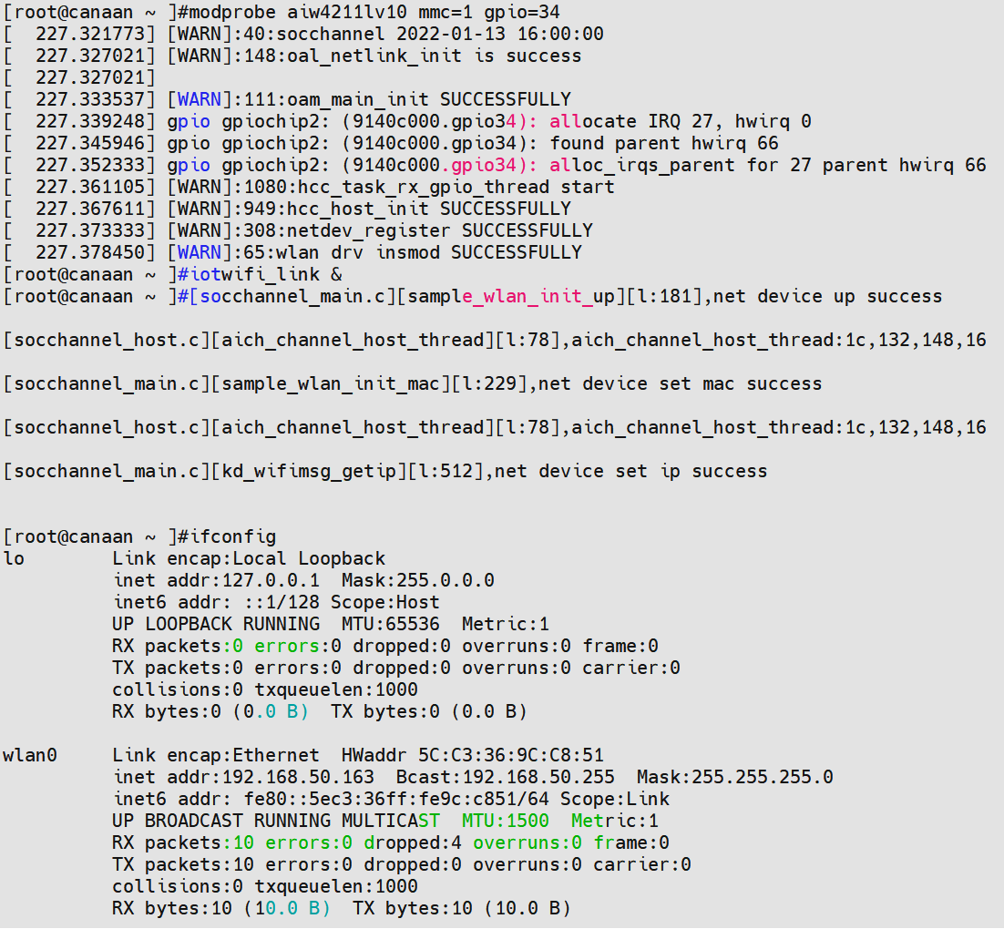

Refer to Section 2.2 to configure the hardware environment, press and hold the K1 button on the K230 EVB board to power on and start, and load the driver:
modprobe AIW4211LV10 or modprobe AIW4211LV10 MMC=1 GPIO=34
Start the configuration tool server side and run it in the background: iotwifi_link &
The current driver supports passing in the MMC master number and GPIO number for interrupt detection, which can achieve more flexible hardware configuration, and if no parameters are passed, the default values of 1 and 34 specified in the code are used respectively. iotwifi_link functions similar to wpa_supplicant, first up, and then synchronize the MAC address and IP address from the WiFi device side to the Host side.
Figure 5-2 Driver loading and iotwifi_link startup

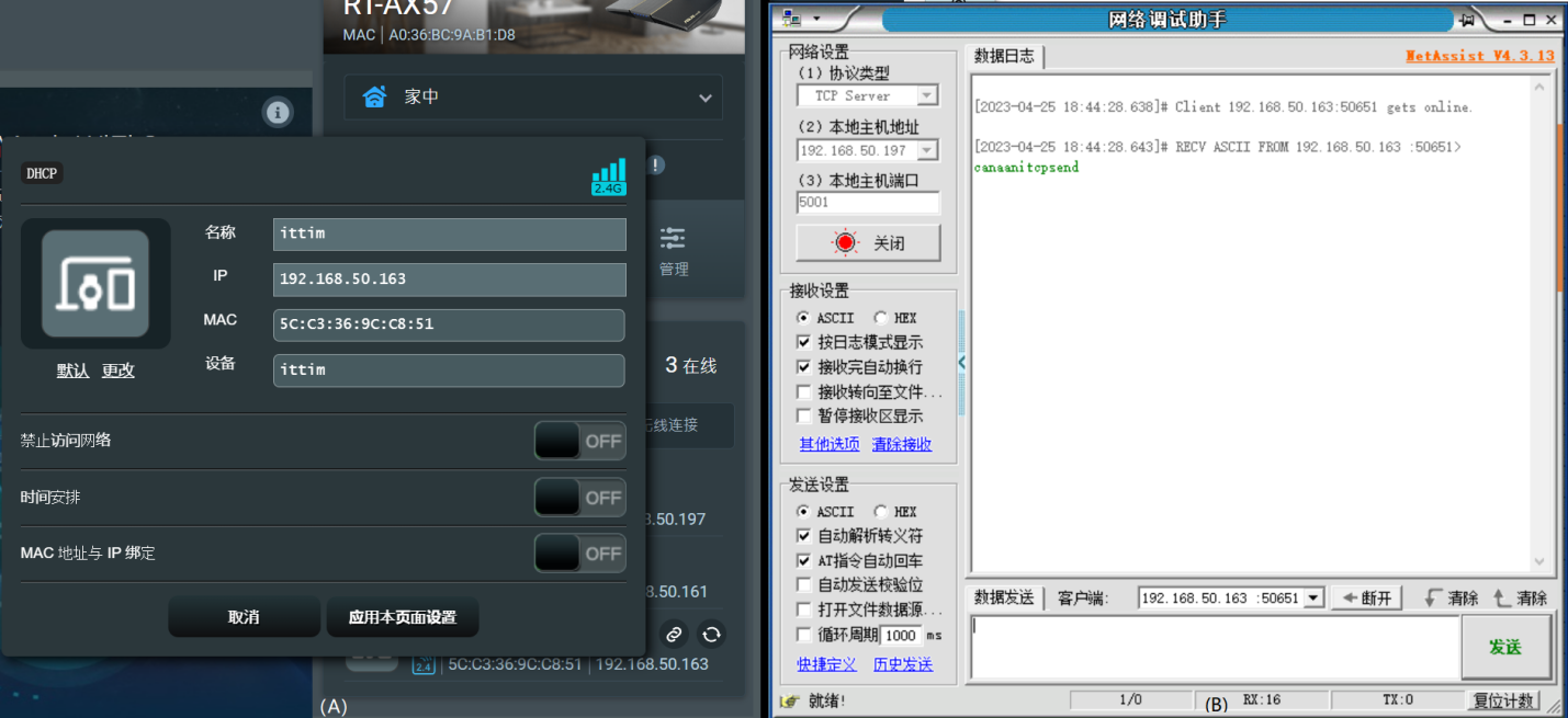

Configure AP Access Through the Network#
The AiW4211LV10 development board supports configuring the name, password, and encryption method of the target AP through the network. The steps to configure AP access are as follows:
Step 1: Prepare a router and record its hotspot name, password, and encryption method information Step 2: The AiW4211LV10 development board will start and run for the first time after the firmware is flashed, or long press the K4 button on the board for 3s after the configuration has been completed, WiFi will start the SoftAP mode to generate a hotspot and establish a socket server based on the TCP protocol Step 3: Connect your PC to the hotspot and start NetAssist Step 4: Configure NetAssist to connect to WiFi as a tcp socket client Step 5: After the server parses the configuration data, connect to the specified AP and exit the SoftAP mode
If the user has the ability, he can develop a mobile APP for network configuration, and here only the PC+NetAssist solution is used for simplicity. The SoftAP parameters and configuration data format are shown in Table 5-1, and the NetAssist configuration operation is shown in Figure 5-1:
Table 5-1 SoftAP parameters and configuration data format
Project |
Parameters |
AP name |
K230 |
AP password |
12345678 |
server ip |
192.168.43.1 |
server port |
35556 |
config data |
cfg=<targer ap name>,<targer ap auth>,<targer ap password> for example:cfg=xuyuxuan,2,Xuyuxuan123 |
Figure 5-3 NetAssist configuration runs

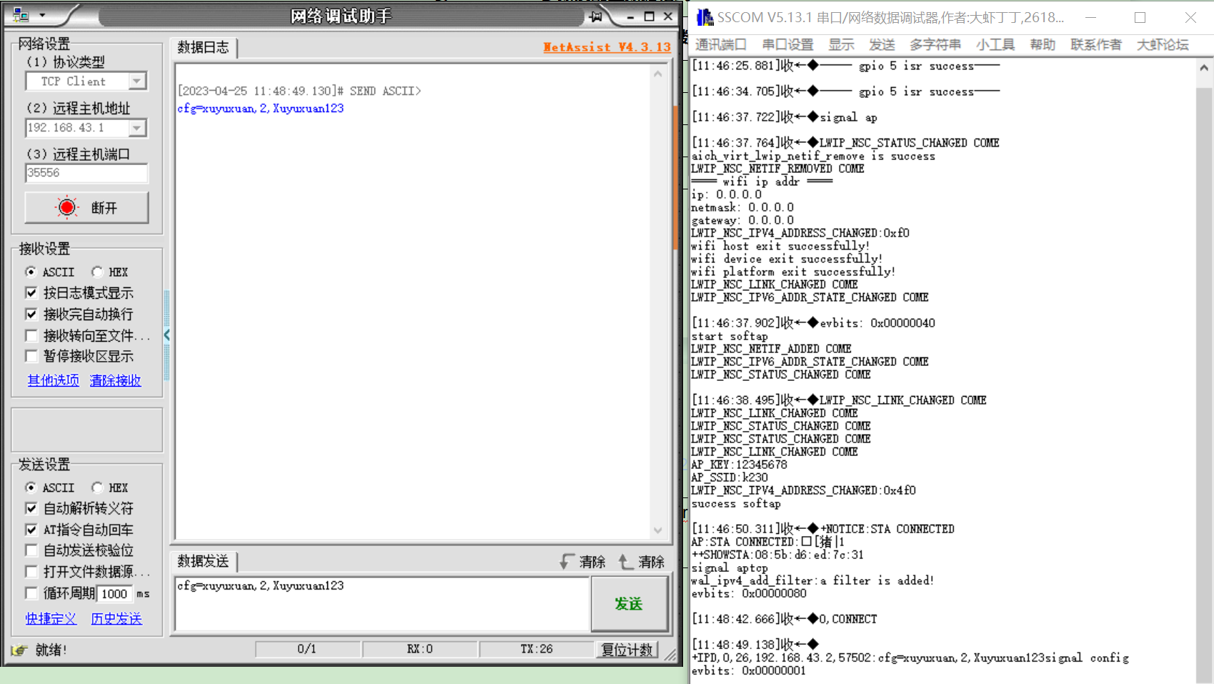

Configuration via the Configuration Tool#
The configuration steps are as follows:
Step 1: Prepare a router and start the hotspot Step 2: Connect the PC to the hotspot, then start NetAssist, here for simplicity use PC+NetAssist as the remote keepalive server Step 3: Configure NetAssist as a tcp socket server to wait for WiFi keepalive link access Step 4: The K230 side edits the configuration file/etc/wifi.conf based on the hotspot information and the server information started by NetAssist Step 5: Run the configuration tool client, parse the configuration file, and send the configuration message: iotwifi_cli –config /etc/wifi.conf Step 6: After receiving the configuration parameters, AiW4211LV10 first stores the sleep parameters, then accesses the specified AP, and finally establishes a tcp socket client to connect to the tcp socket server established by NetAssist
/etc/wifi.conf is a WiFi working parameter configuration file, written in json format. It is basically a mapping of the wifi_config_t structure. For details, please refer to Chapter 6.1.2. The contents of the file are as follows:
"sleep": {
"level": 2,
"period": 3000,
"wake_gpios": [5]
"conn": {
"ssid": "xuyuxuan",
"auth": 2,
"key": "Xuyuxuan123",
"bssid": "",
"pairwise": 0
"keepalive": {
"svrip": "192.168.50.197",
"svrport": 5001,
"time": 10,
"intvl": 2,
"probes": 5,
"hrintvl": 60,
"hrprobes": 5
Note: “wake_gpios”: [5] is an array item, the current array has only one element 5, indicating that WiFi can be woken up by its own gpio5, the IO corresponds to the key K4, if the new wake-up source can be appended with comma separation. It depends on the specific hardware design.

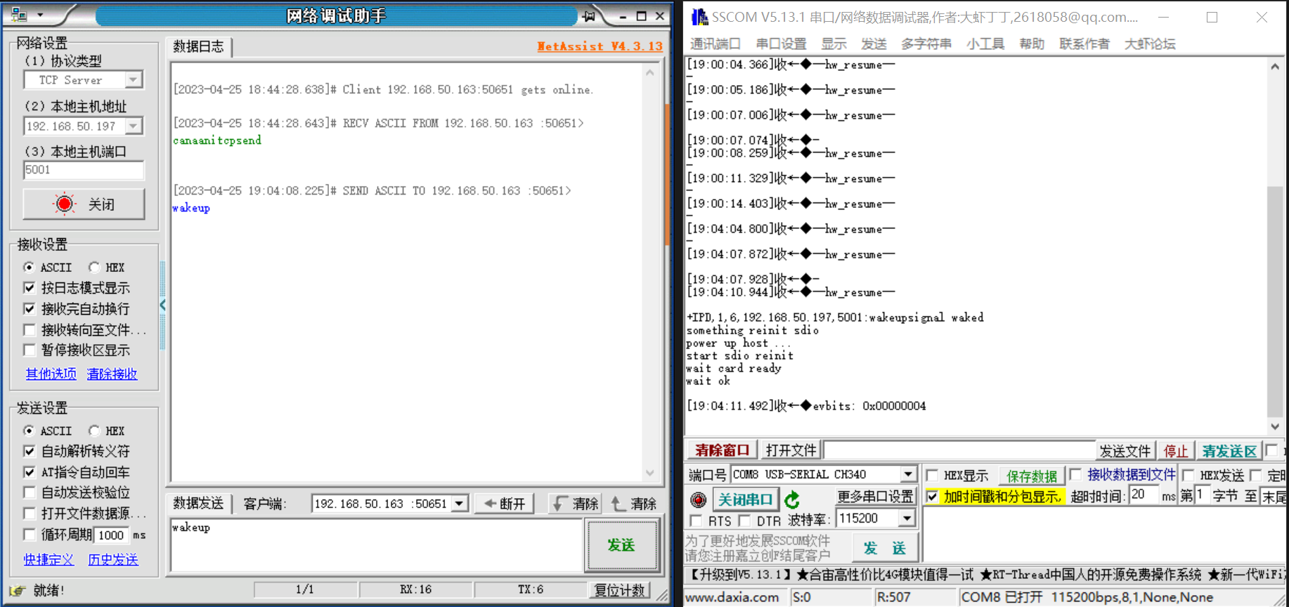

Figure 5-4 (A) WiFi access router and assigned IP (B) tcp keepalive server

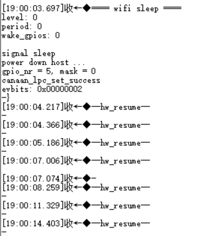

System Hibernation#
Configuring Hibernation Through Tools#
Run the configuration tool client to send a sleep command to trigger WiFi sleep: iotwifi_cli –dirsleep
Figure 5-5 WiFi enters the hibernation log

If WiFi has gone to sleep, simply press the K4 button on the AiW4211LV10 development board to wake up WiFi, WiFi will send a wake-up signal to the PMU of the K230 EVB, and if the K230 EVB is in the power-down state (non-cold start) configured in Section 5.4.3, it will be powered on.
Figure 5-6 Press the button wake-up log
Wake on LAN#
If the WiFi has gone to sleep, NetAssist sends wakeup to wake up the WiFi, WiFi will send a wake-up signal to the PMU of the K230 EVB, and if the K230 EVB is in the power-down state (non-cold start) configured in Section 5.4.3, it will be powered on.
Figure 5-7 Wake-on-LAN log
