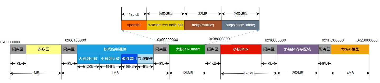

Version Usage Restrictions#
The current SDK’s memory layout on USIP LP3 EVB and CanMV-K230 is as shown below:
! EVB
Figure-1 SDK Memory Layout
You can configure the memory regions for each module by entering make menuconfig under the k230_sdk directory and selecting Memory->Configuration. Currently, configuring the memory for parameter areas and inter-core communication areas is not supported.
