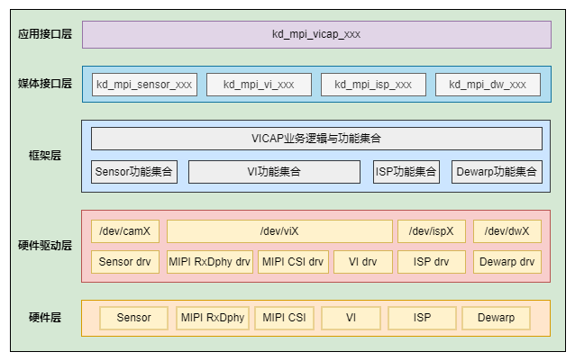

The VICAP software architecture is shown in Figure 1-2, from top to bottom: Application Interface Layer, Media Interface Layer, System Framework Layer, Driver Layer, and Hardware Layer.
Application Interface Layer: Provides API interfaces in the form of kd_mapi_vicap_xxx and usage instructions. It further encapsulates the functional interfaces provided by each sub-module of the Media Interface Layer to simplify the application development process.
Media Interface Layer: This layer consists of various sub-modules of VICAP, each providing its own media interface API encapsulation.
Framework Layer: Responsible for the control and management of the entire system software functions and business logic of VICAP. It integrates and unifies the interfaces and functions provided by each sub-module to form a complete VICAP system control logic and process.
Driver Layer: A collection of kernel driver functions for various hardware modules of VICAP.
Hardware Layer: A collection of specific hardware modules of VICAP, including sensors.
