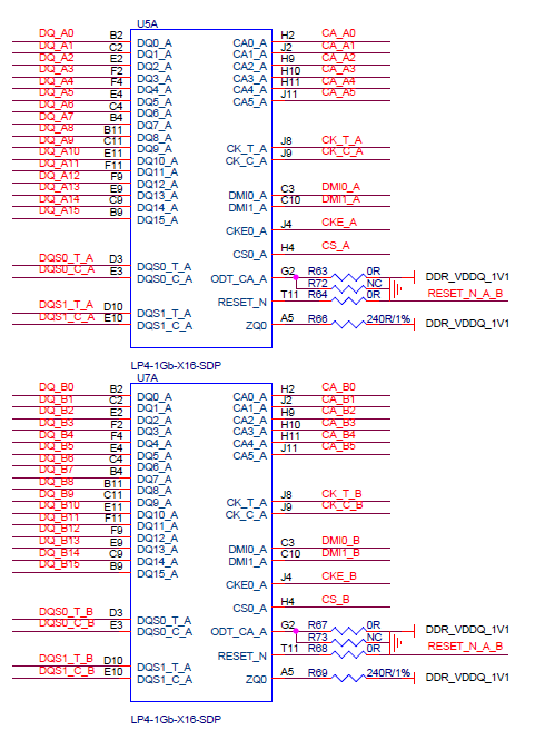

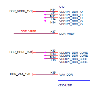

LPDDR4#
The circuit design of LPDDR4 refers to Figures 3-12, 3-13, 3-14, 3-15, and 3-16.
Figure 3-12 K230 LPDDR4 Circuit
Figure 3-13 K230 LPDDR4 Power Circuit
Figure 3-14 K230 LPDDR4 Reference Voltage Circuit
Figure 3-16 LPDDR4 Chip Power Circuit
When using LPDDR4, note:
The schematic of the DDR PHY and each DRAM chip needs to be consistent with the reference design, including power decoupling capacitors.
The DDR_ZN pin needs to be connected to a 240Ω (1%) calibration resistor to ground.
The RESRT_N pin is directly connected to the corresponding pin of the chip.
When using LPDDR4 chips with K230, the VREF voltage is 0.6V, and it is recommended to use 1kΩ (1%) resistors for voltage division.
