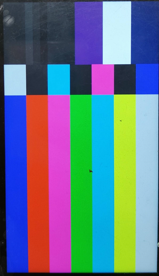

To run the DSI self-test mode demo:
./sample_vo.elf 2
A color bar image will be displayed on the screen, as shown below:

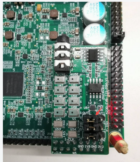

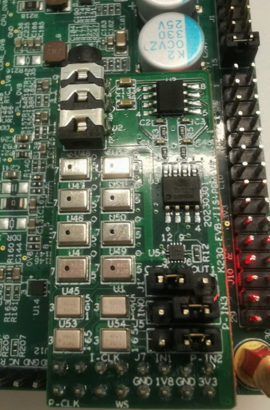

Dependency Resources#
Audio testing depends on the audio sub-board.

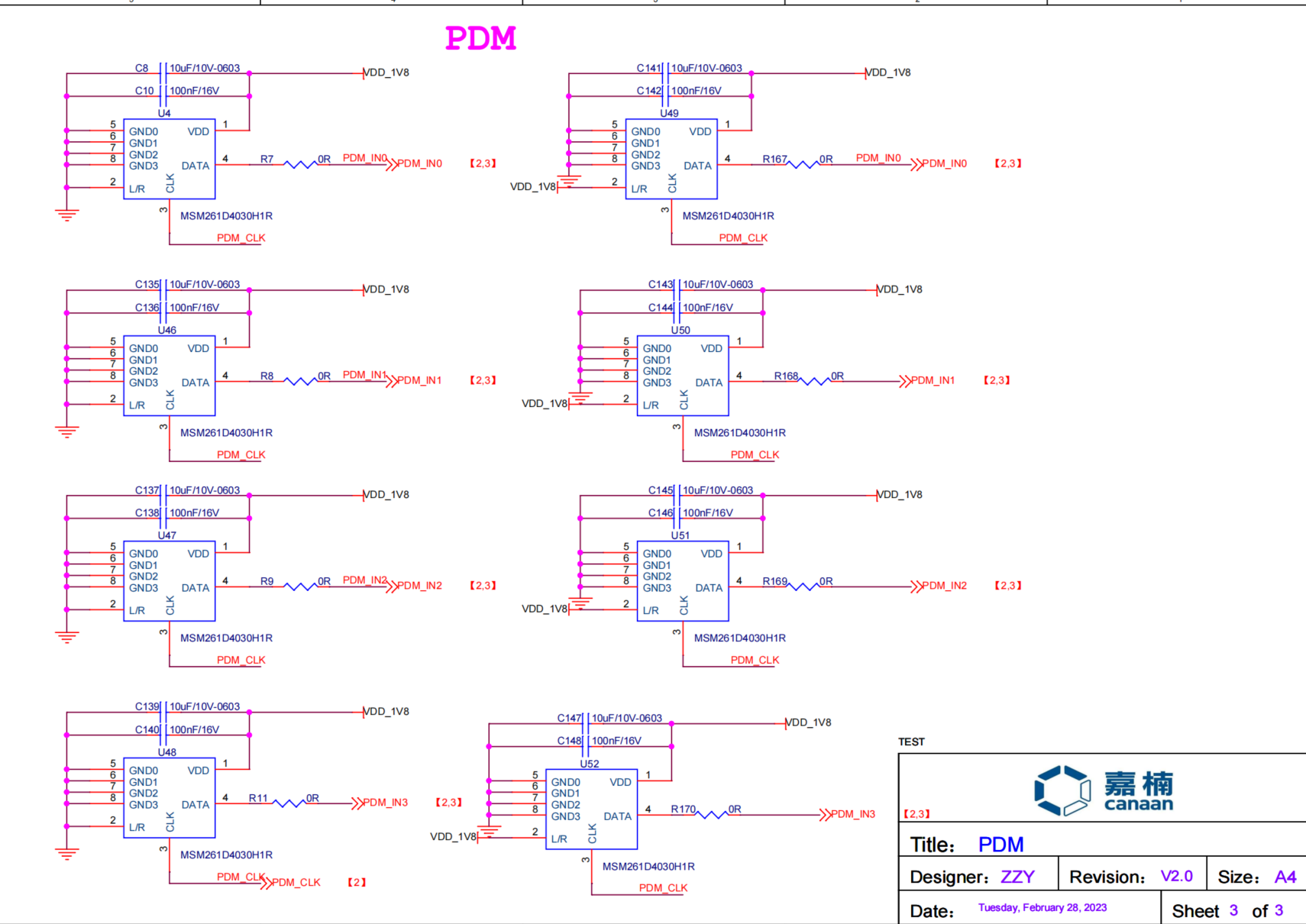

The audio sub-board schematic is as follows:
When testing i2s input and output, the audio sub-board can be connected as follows using jumper caps:
For pdm audio collection, when collecting data from the 0th or 1st pdm channel, it does not conflict with i2s pins.
When using the 2nd and 3rd pdm channels, jumper caps are needed to switch to pdm channel mode, as follows:

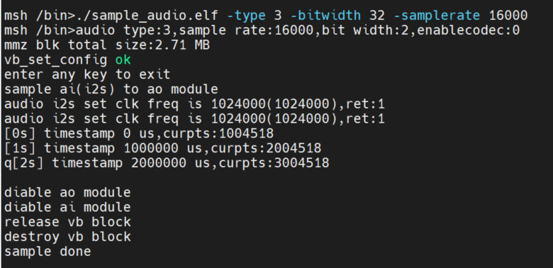

I2S Audio Output Test#
Supports playing wav files, which need to be copied to the sharefs path. This demo will loop playback of the wav file (any other wav file can also be used). Users can press any key to exit the function test.
The demo implementation idea: This test outputs sound in real-time by looping the API function: kd_mpi_ao_send_frame
Input ./sample_audio.elf -type 3 -bitwidth 32
to test audio input and output functionalities in real-time through the API interface.
The overall functionality of audio input and output is tested by calling the API interface: kd_mpi_ai_get_frame
to get audio data and kd_mpi_ao_send_frame

I2S Audio Input and Output Module System Binding Test#
Input ./sample_audio.elf -type 4
to test audio input and output functionalities in real-time by binding the ai and ao modules.
The overall functionality of audio input and output is tested by calling the system binding API interface: kd_mpi_sys_bind
to bind the ai and ao modules. Users can press any key to exit the function test.

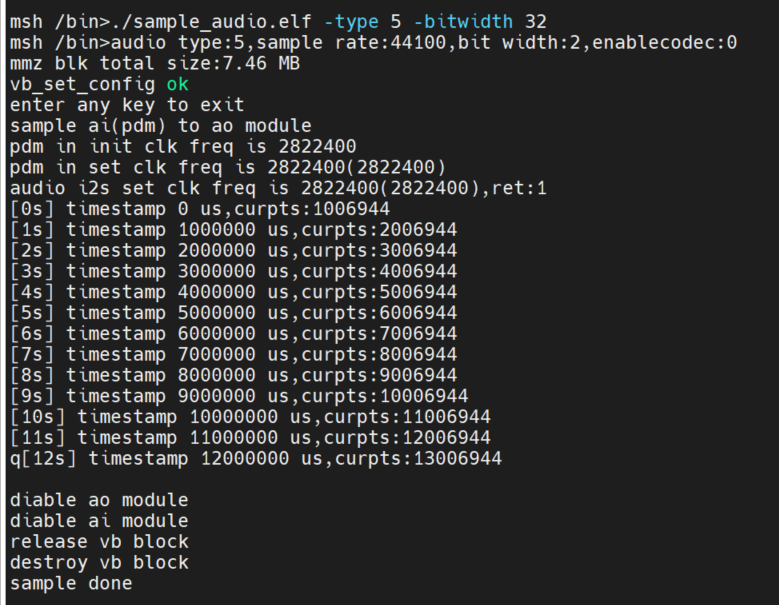

PDM Audio Input, I2S Output API Interface Test#
Input ./sample_audio.elf -type 5 -bitwidth 32
to output audio data. Users can press any key to exit the function test. During the test, the timestamp information collected by ai is output in real-time.

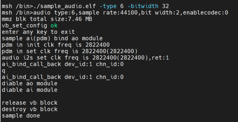

PDM Audio Input, I2S Output System Binding Test#
Input ./sample_audio.elf -type 6 -bitwidth 32

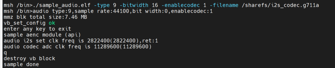

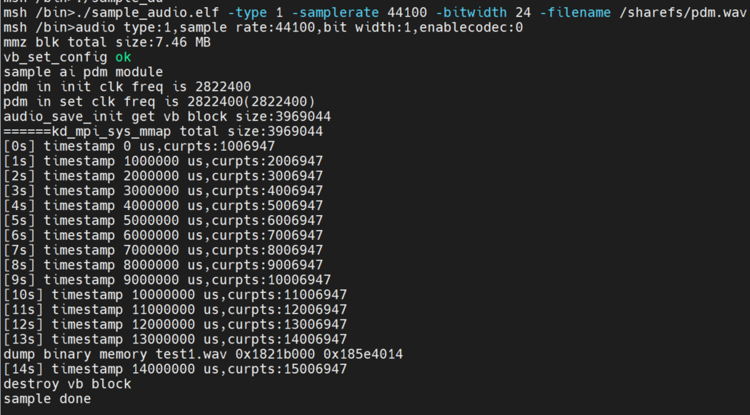

Encoding Test#
Collect ai data and encode it to save to a file. Encoding and decoding only support g711a/u, 16bit.
System binding method: ./sample_audio.elf -type 7 -bitwidth 16 -enablecodec 1 -filename /sharefs/i2s_codec.g711a
API interface method: ./sample_audio.elf -type 9 -bitwidth 16 -enablecodec 1 -filename /sharefs/i2s_codec.g711a

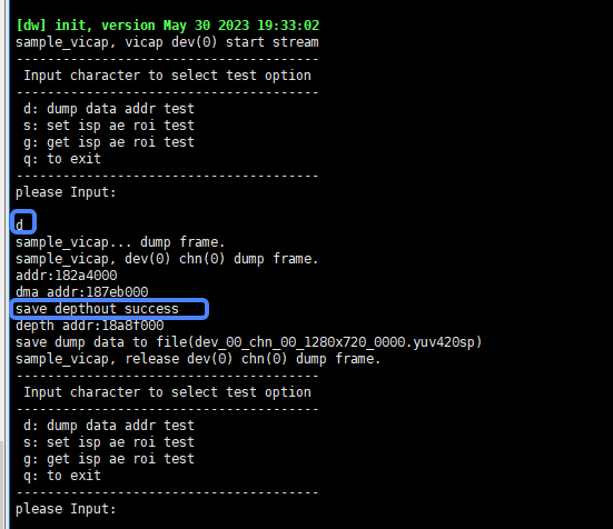

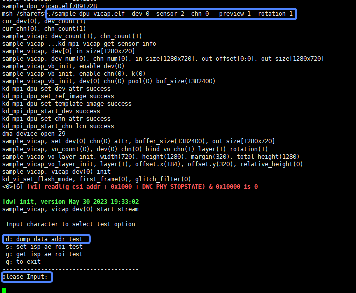

When the sample_vicap
command is entered, the following prompt information is printed:
Options:
-mode: vicap work mode[0: online mode, 1: offline mode. only offline mode supports multiple sensor input] default 0
-awb: awb status[0: disable AWB, 1: enable AWB] default enable
-ofmt: the output pixel format[0: yuv, 1: rgb888, 2: rgb888p, 3: raw], only channel 0 supports raw data, default yuv
-rotation: display rotaion[0: degree 0, 1: degree 90, 2: degree 270, 3: degree 180, 4: unsupport rotaion, 17: gdma-degree 90, 18: gdma-degree 180, 19: gdma-degree 270]
-help: print this help

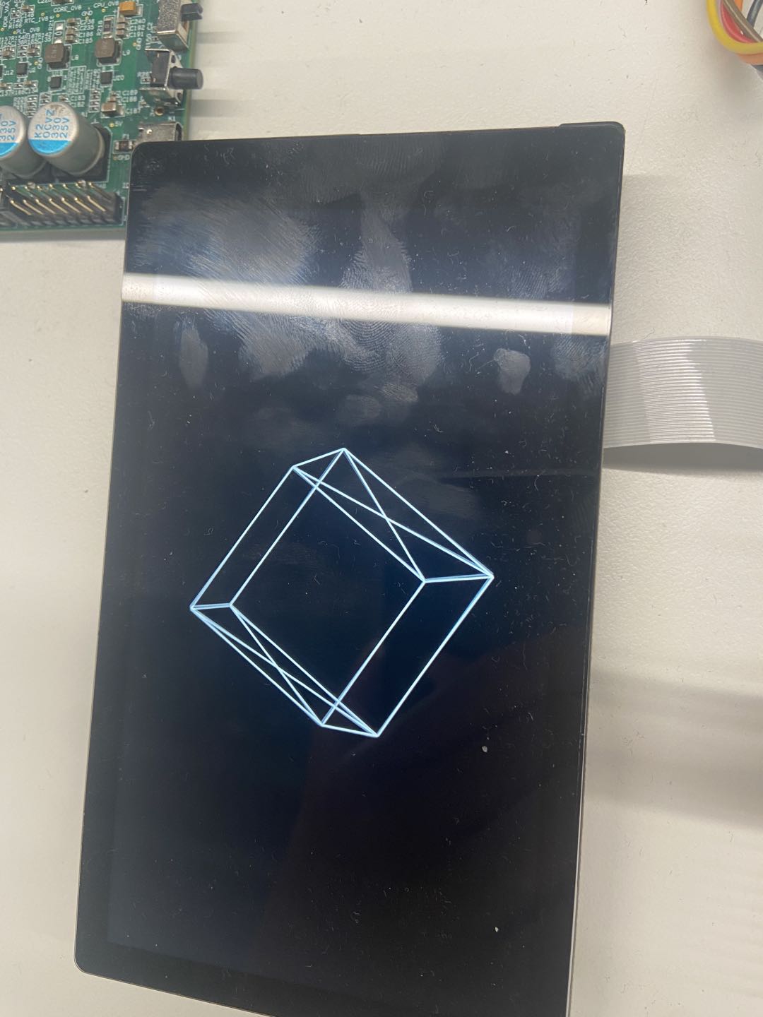

vglite_cube#
Run the vglite_cube
command. The GPU will display a rotating cube on the LCD screen, as shown below:

Usage Instructions#
Compilation#
Execution#
After executing the above command, a color bar will be displayed on the LCD screen, as shown below:

DPU_Vicap_demo#
Demo Introduction#
The demo process is as follows:
Start VICAP.
Dump a frame of speckle image in user space.
Send the speckle image obtained from VICAP to DMA for 90-degree rotation processing.
Get the rotated image from DMA in user space.
Send the rotated image from DMA to DPU for depth processing.
Get the depth image processed by DPU in user space.
Save it as a file in the large and small core shared directory
/sharefs
. You can share this file to the server throughmnt
and use tools to view the depth image.
Feature Description#
ISP captures images, DMA performs image rotation, and DPU performs depth processing.
Calibration files are needed, including configuration files and reference image files. The configuration files and reference image files need to match the sensor. The configuration files and reference image files are located in the path k230_sdk/test_resource/dpu
, and these files only correspond to sensor1.
Usage Instructions#
Compilation#
Place the configuration files and reference image files in the directory
k230_sdk/src/big/rt-smart/userapps/root/bin/dpu
, as shown below:Execute the compilation command
make
in thek230_sdk
directory.After compilation, the demo file
sample_dpu_vicap.elf
will be in the directoryk230_sdk/src/big/mpp/userapps/sample/elf
. The system image filesysimage-sdcard.img
will be in the directoryk230_sdk/output/k230_evb_defconfig/images
For more detailed compilation process, refer to the README.md in the release SDK package.
Execution#
Mount NFS using the following commands:
ifconfig eth0 up udhcpc # Replace the IP address and path below with your server's IP and path mount -t nfs 10.10.1.94:/home/user/nfs /sharefs -o nolock
After mounting successfully, the
/sharefs
directory can be seen on both the large and small cores. Copy the compiled demosample_dpu_vicap.elf
to the server’s NFS directory (here it is/home/user/nfs
). At this point, the corresponding elf file can also be seen in the large core RTT’s/sharefs
.Use the command
./sample_dpu_vicap.elf -dev 0 -sensor 2 -chn 0 -preview 1 -rotation 1
to start the demo. The output print information is as follows:Input
d
, the output print information is as follows:Input
q

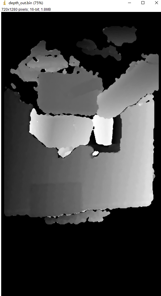

to exit the program.At this point, the
depth_out.bin
file is in the/sharefs
directory. This file is the depth image file output by DPU, which can be opened and viewed using appropriate software.
Results#
The actual scene is as follows:

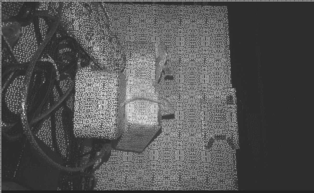

The speckle image captured by the sensor is as follows:

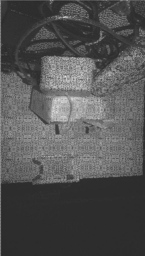

The speckle image rotated 90 degrees clockwise by DMA is as follows:
The depth image result output by DPU is as follows:
